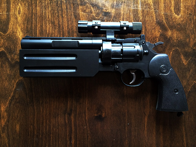

Here's a photo of my gun. (I still have to add the laser sight pad.)
The "cone" I was referring to is the front of the site. If you look at the screengrab of Kim Cattrall holding the gun you can see that the front of the sight has an inverted cone to where the laser emitter is.

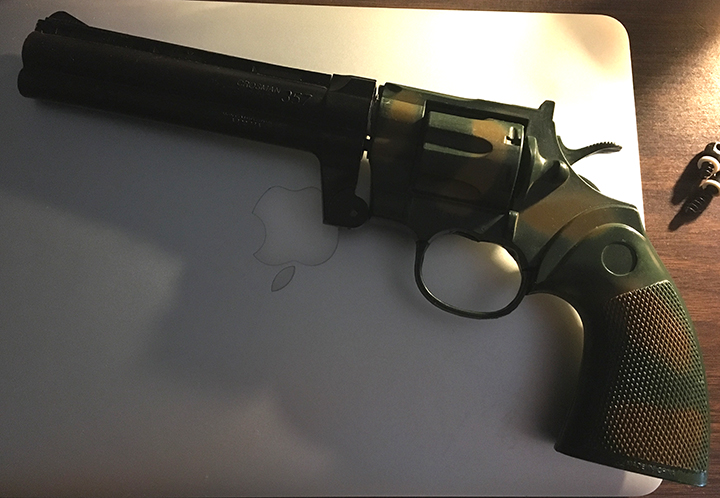

Well, it's taken me a few years to find a base gun for the project. I got this one for $30 on gun broker. It has the apporiate amount of weathering I think.

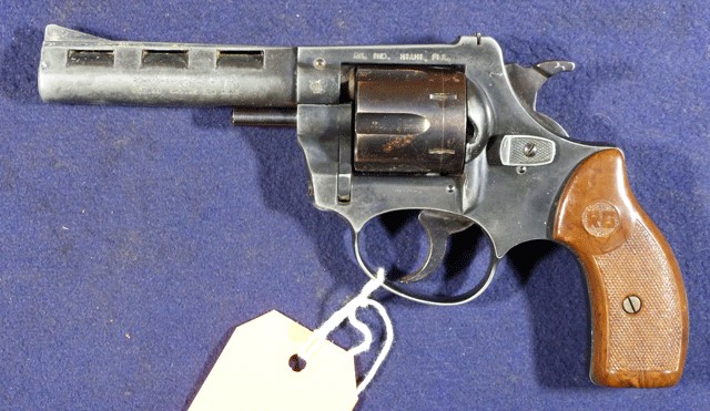

This is not the correct model, which is an RG 79 gas/flare/blank pistol. But this is the grand child of that design. RG came out with the model 69, and most of your ekol/zoraki type blank revolvers floating around today are based on the RG 69.
Yeah, I've done some research since last I posted in this thread. I have looked high and low, and then everywhere in between for a model 79, and I will continue to search for them.
But for now, it's a beginning. Plastic wood look-a-like grips on the way (from maxarmory.com), barrel and barrel block to be made! Probably this weekend.

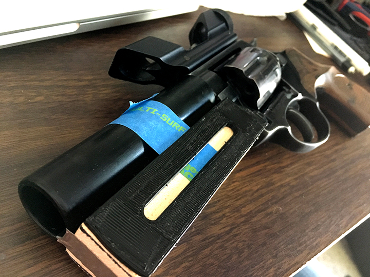

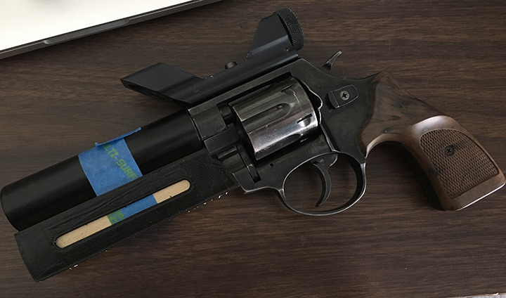

Just thought I'd throw a few update photos into this thread. I'll be posting threads for the builds once they are done.

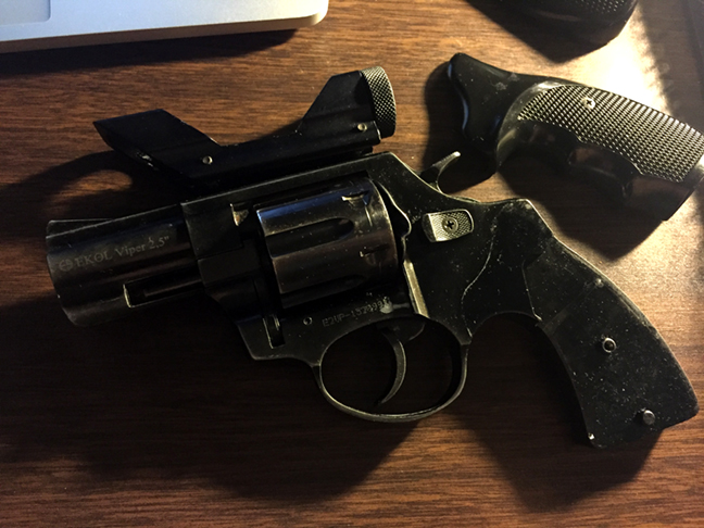

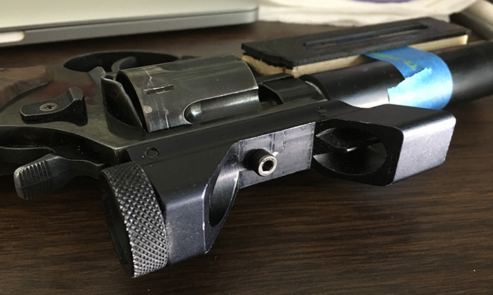

Got the site attached today since it was warm enough to get into the garage and make a mess. Also have the barrel and the underbarrel "block" in the works.
This is a blank firing Ekol Viper. It's not a perfect match by a stretch, but it was as close as I could get at first.

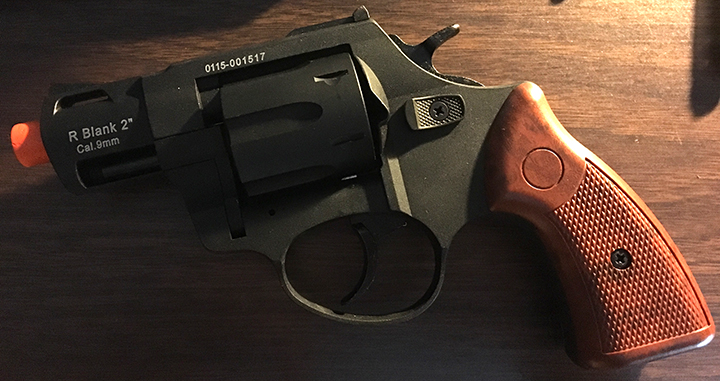

Now, I have a Zoraki R2 that is much closer to the original RG79 used in the film. Planning to build this one as a "new issue" versions.
