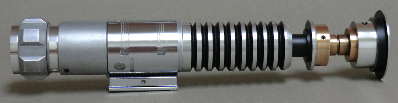

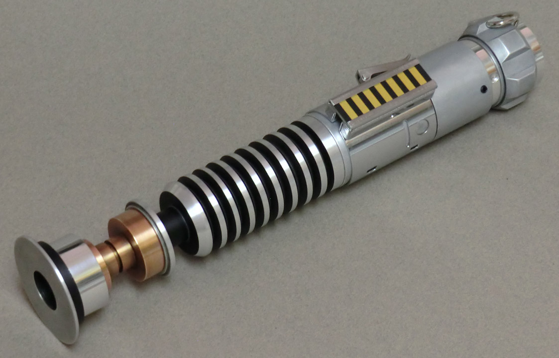

Finally got mine wrapped up...
Since this was an idealized version of the V3, I figured I'd give it an idealized finish. Rather than use aluminum tape, I polished those areas with Mothers Mag & Aluminum Polish.

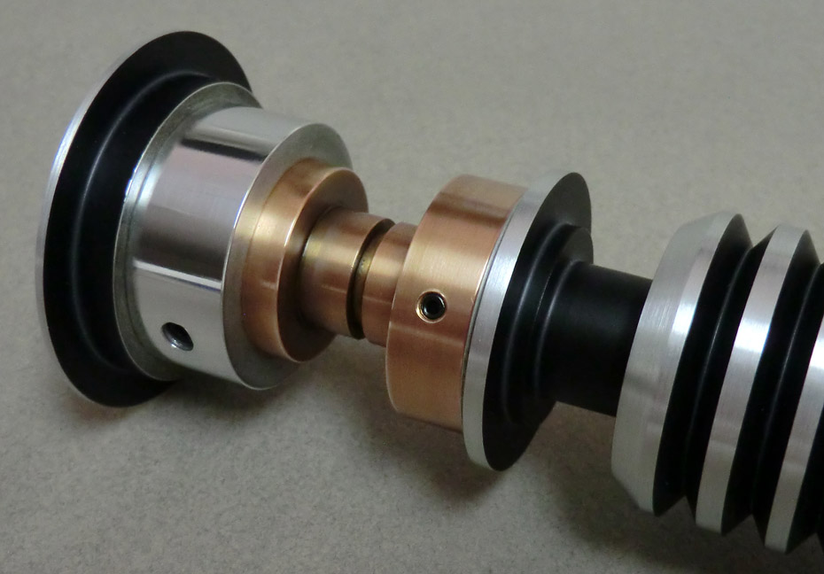

For the copper neck, I buffed it with #0000 steel wool, gave it a quick ammonia fuming (only for about 30 minutes) to give it a bit of color in the crevices, and buffed it again.

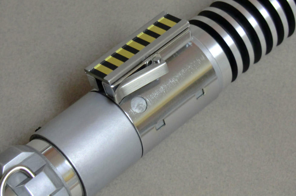

I also skipped the foil tape on the Graflex clamp, and used a Roman's no logo clamp instead. The finish was already pretty shiny (especially the side bars) but I also polished it a bit with Simichrome Polish. I buffed the clamp rails and the lever with a green Scotchbrite pad to knock the finish down on those. The card is a slothfurnace version 2.0

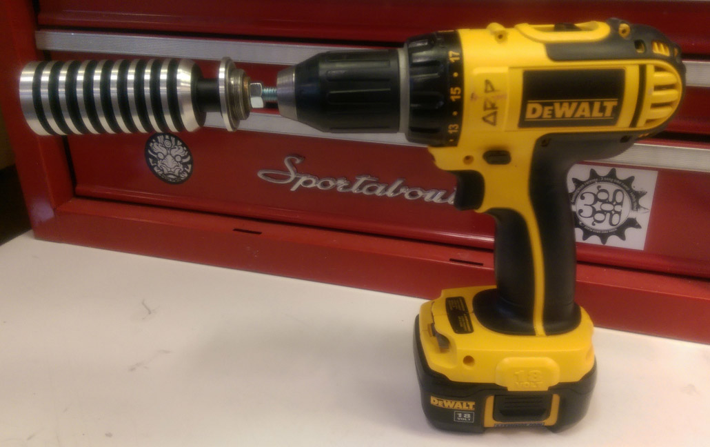

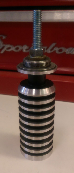

For the black paint I used Krylon flat black and sanded the paint off the ribs with 240 and then 320 grit sanding blocks. I dropped a 5/16" x 3" long bolt down through the neck hole from the inside, tightened it down with a washer and nut on the outside, and chucked it up in a cordless drill. Presto! Poor man's (lazy man's?) lathe. Definitely helped give a nice even finish with the sanding blocks.

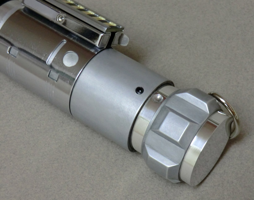

For the remainder of the aluminum I went over all of it with the Scotchbrite pad followed by the steel wool. The face of the emitter got the usual Easy-Off oven cleaner treatment, then a quick wipe with diluted Birchwood Casey aluminum black to dirty it down a bit, followed by some buffing with steel wool. I darkened the interior of the emitter socket with full-strength aluminum black and painted the socket of the copper neck with Krylon flat black.

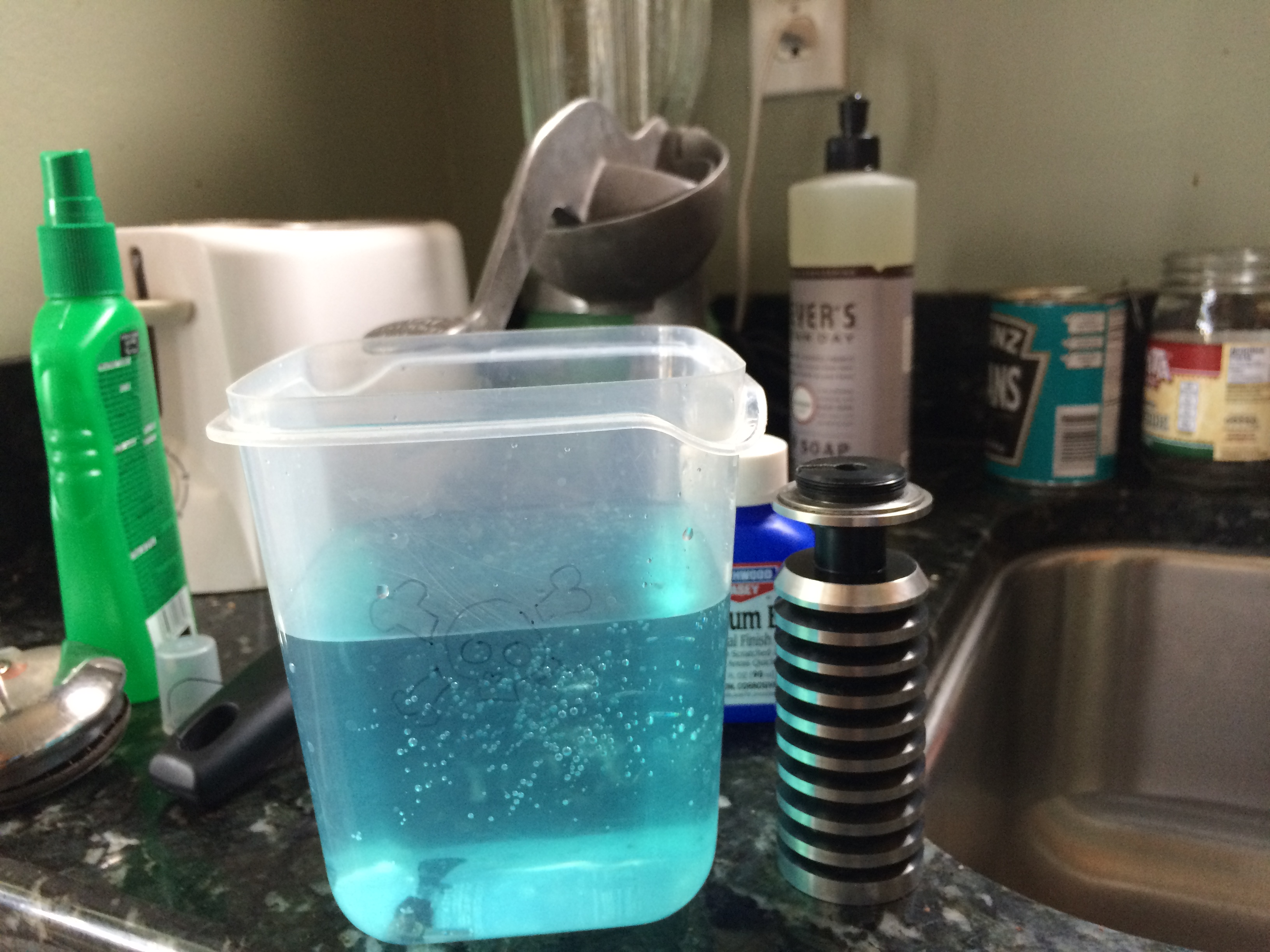

I had a heck of a time trying to age/darken the clamp/booster section and the pommel cubes. I thought I'd try the dishwasher trick first. No effect. :unsure I washed them a second time. Still nothing. :angry So I started in with the oven cleaner treatment... it went pretty well at first - I was getting them to look kinda' grey , but the tone was uneven. I kept going but it reached a point where it seemed like each application that I put on appeared to be cleaning off the grey finish that I had built up - it was weird. :confused On a whim I thought I'd try the dishwasher again. Disaster! The uneven oxidation from the oven cleaner treatment darkened into big blotches - it was like some sort of strange camouflage. So I stripped them back down to bare aluminum with the Scotchbrite and steel wool.
I saw in another thread that someone had used drain cleaner on a V2, so I thought I'd give that a try. I did the pommel first, soaking it in a shallow dish, and it worked rather well (and quickly). But as I was rinsing it off I started rubbing it and the oxidation layer came right off. Poop. :( Back to the oven cleaner...
As I was doing the oven cleaner treatment again I kept thinking about the drain cleaner. I tried the drain cleaner again, but when I rinsed the part off I didn't touch it. I let it dry overnight and that was the trick. :thumbsup I gave the pommel another quick soak and then did the clamp/booster section, but I got them both way too dark. Stripped 'em back down to bare aluminum and tried again. Again too dark, so after a couple more tries I got them to where they are now, which I'm OK with. The drain cleaner works fast - a minute and a half to two minutes is all it took.

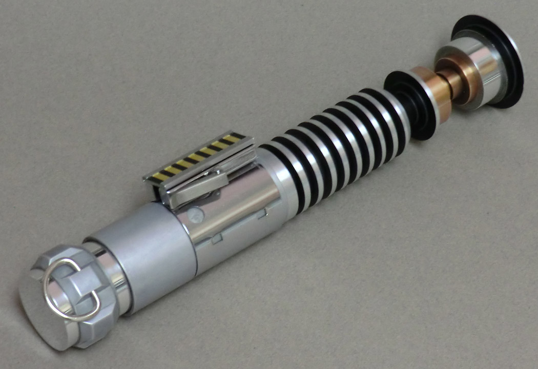

My install became just a momentary switch Laser. I couldn't power the picocrumble with enough mah, the speaker placement was muted (it should almost always be towards the bottom in my builds). So, if I can't have both, at least I've got one:
Below is the build:
The Lever in the background goes between the card graflex clamp. The card gets glued down to the lever.
This build has a kill switch and a momentary switch. The momentary is a double momentary because I was going to use it for dual install on this rig but had to abandon the initial plan.
I actually got a D-ring instead of the Tri-ring. The build remained shiny.
This build is done for now. Only thing left for me to do is build a beam expander. Enjoy.

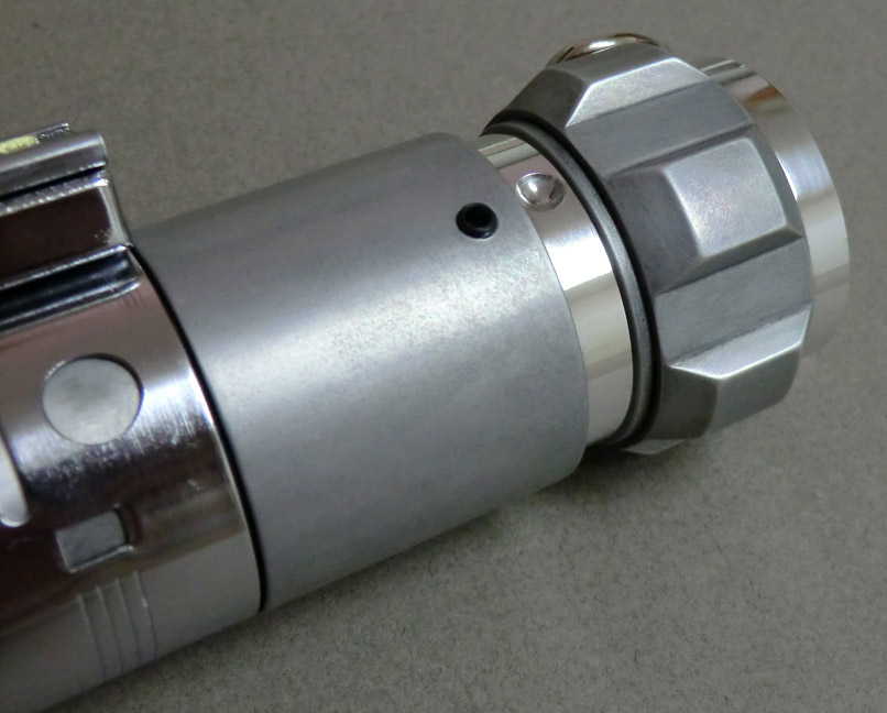

View attachment 731464 View attachment 731465
View attachment 731467 View attachment 731468
Overall I'm pretty happy with it. Thanks for the fun project Rudy!

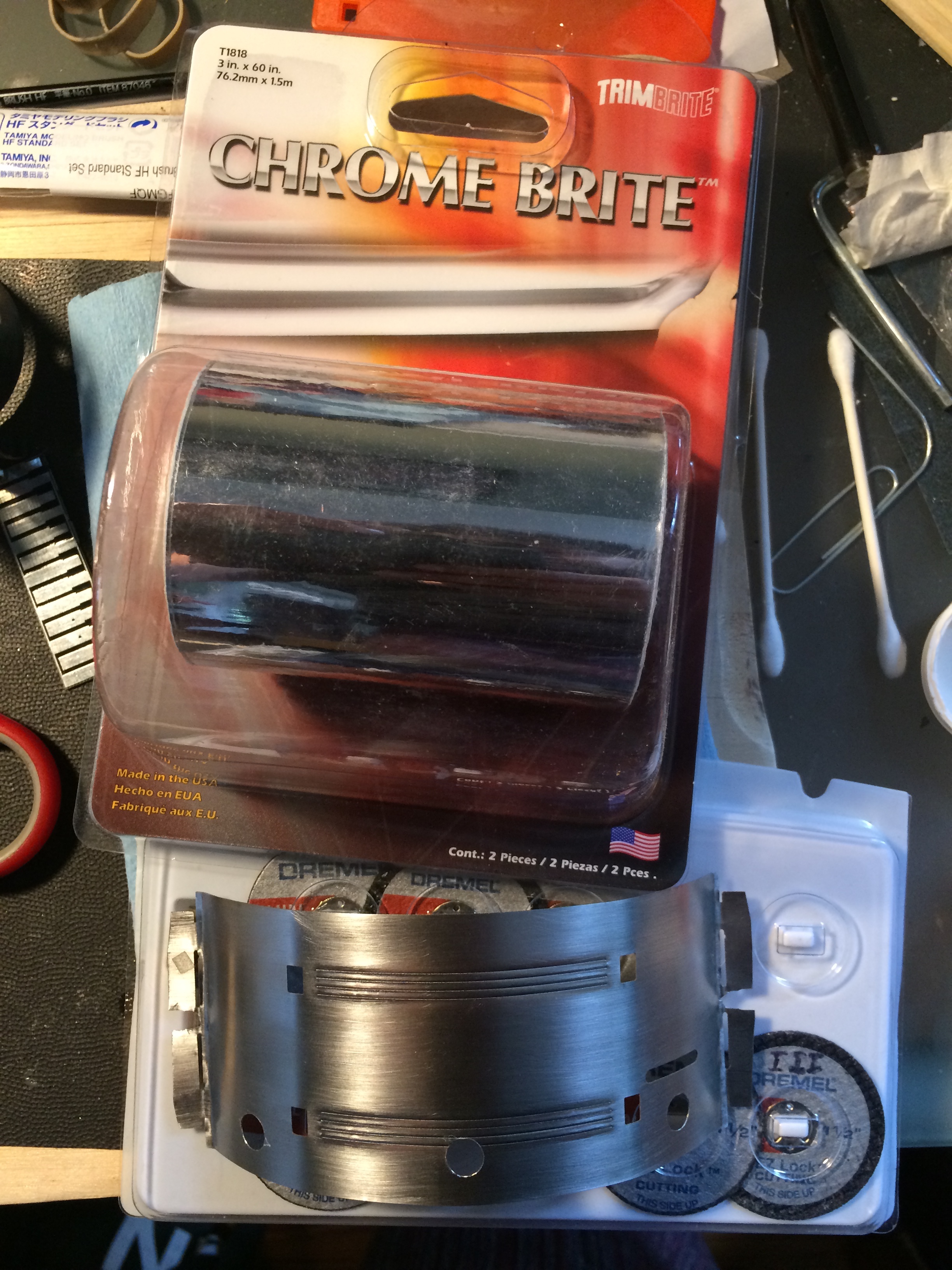

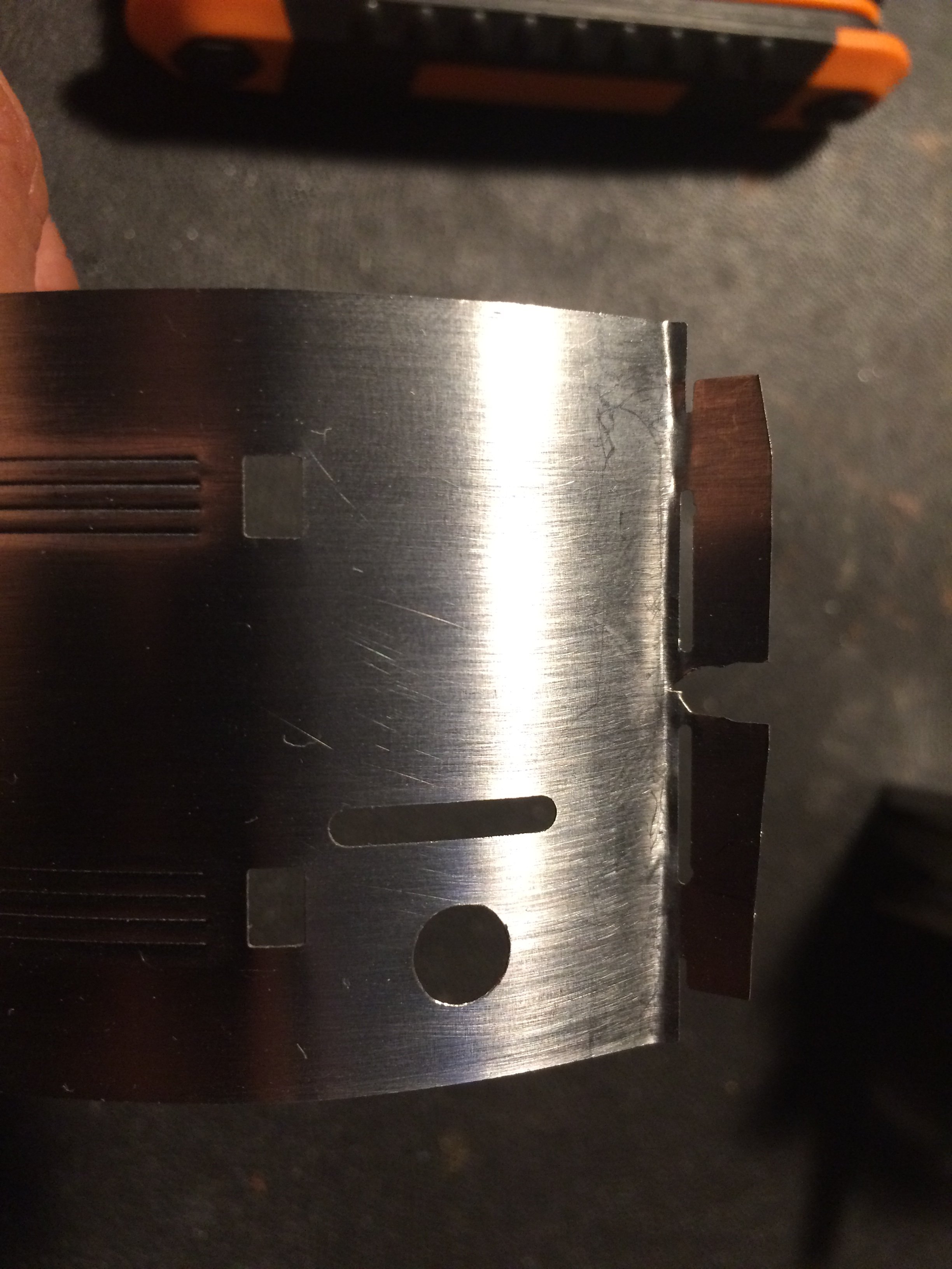

I got some tape! I am also experimenting with a Wannawanga's clamp cover with matching punched holes, but I'm having trouble mounting it on the clamp....
What trouble are you having with the clamp cover?
Mine went on like a glove but I did use a vice to bend the tabs at the points were the cover goes under the clamp bars.
Mine does not fit that well on the clamp. It's too long, so I had to shorten it ....
