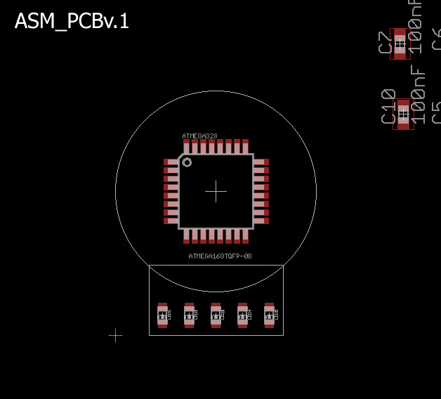

hi epilepticsquirl-
THANKS!!! I appreciate it! just kinda 'bugging me' to give this a shot..
(if all else fails.. maybe someone can modify the model a bit to accommodate a REAL working pcb)
anyways.. sorry if my post contributed to the 'derailing'.. Im really just trying to pitch in/be part of the community project.. not 'derail' :)
Along with the ID/OD' of the opening in the blue bezel piece.. & how much 'height/depth' clearance is there?
the bottom pieces.. what is the ID/OD there.. and how much 'height/depth' clearance is there?
Im thinking (hoping) the PCB can fit under the blue bezel piece.. with the CHIP & LEDS on top of the PCB only..
kinda taking on the same 'basic' shape as the blue bezel piece.. (like a key hole type shape)
bonus points for us if we can 'also' squeeze in an SD socket... -and- still have the coin cell battery in the bottom? (maybe a cutout/window in the bottom piece of kit?)
then I can probably make some code to do more than just blinkies on button push..
we can get the 'ffffffpppptttt,....ffffffpppptttt,.....ffffffpppptttt' sound too!
Anyways.. thanks! looking forward to some dimensions! :)

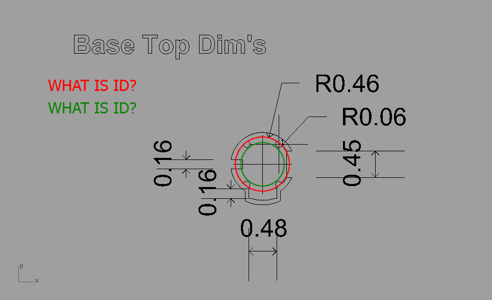

side note:
can I get some help on the dimensions? :)
My first approach is to try and fit in under the blue bezel portions.. (not sure if the height is going to hinder that or not in the end)...
but I need to know the dimensions for the HOLES/openings too..
the two colored circles here.. are the sizes Im looking for as well..
I think someone said the main opening where the bingo chip goes is 3/4" is this correct or not?
and under bingo chip hole/opening.. there is a little 'lip' (going to wher the legs/pegs extrude out)..
what is the OD of that circle/lip?
Im hoping I can make cuts in the pcb to accommodate to the poles/legs on the bottom.. and use that as a way to secure the pcb as well..
I think the bottom piece will need to be have a hole cut it in...(especially if we are trying to play audio).
anyways.. here is a visual for the size/dimensions Im after if anyone can provide
also if anyone can guess/gauge the height form the bottom of the BASE to the TOP of the bezel 'opening' (ie: to the top..where the bingo chip would sit)
the pcb will sit flat on the bottom.. and the chip will be up/inside the opening a bit.. (making sure I have enough room/space)
thanks

I'd like to add to my request the spacing of the led slots/windows (and size)... so I can align the LEDS under it correctly.. :)
(still looking for those opening/holes ID's) :)
shooting for something like this in the end:
with the rest of the needed components on the bottom.. (clean top except for the CHIP and leds)
side question:
I know the movie shooter has the top 'chip'.. have lines zig-zag form the chip pins?..
is this something we want to 'mimic' as well? (using silkscreen on the top off the chip pins?)
also like to get the room (depth) in the bottom piece? usually where the coin battery is seated?
Im hoping this can be done with little to no changes in the current pieces..
thanks!
