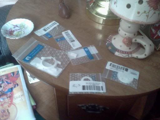

As you've no doubt noticed, the texture of the White Strong & Flexible polished prints leave a lot to be desired; it's by no means smooth. But with a little elbow grease we can soon fix that no problem. The secret to it all are three easily obtainable items.
