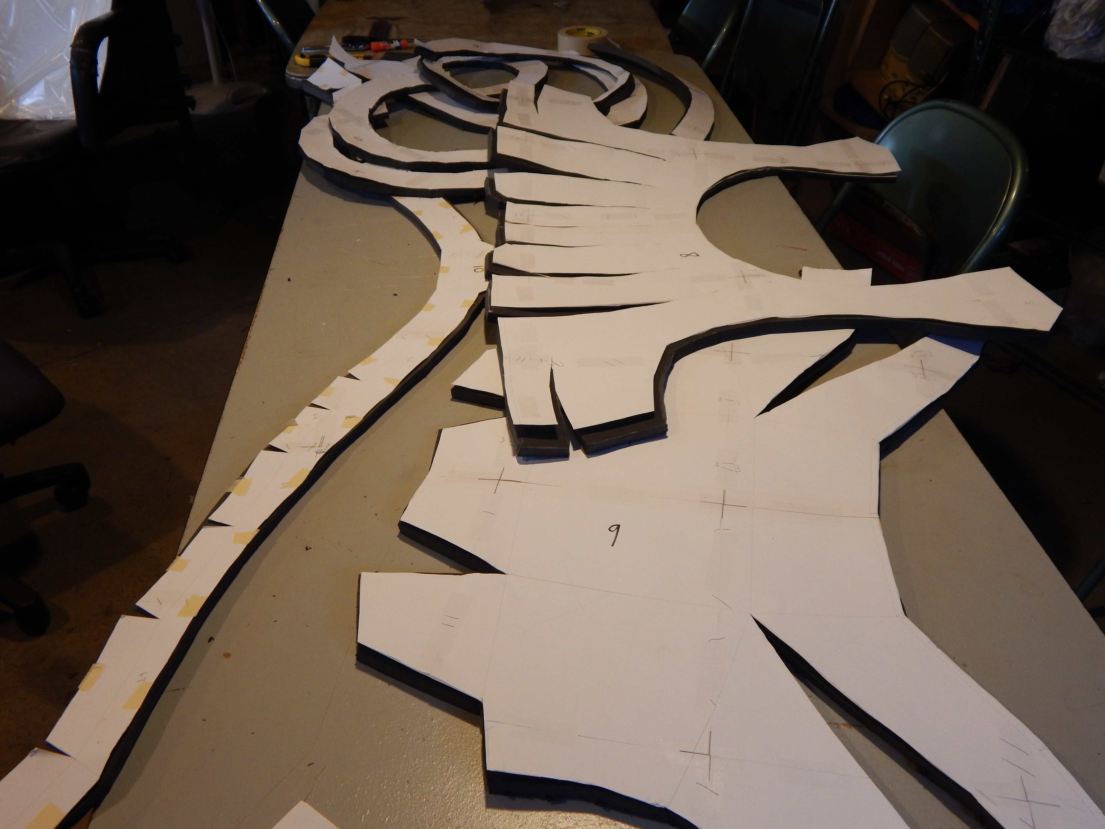

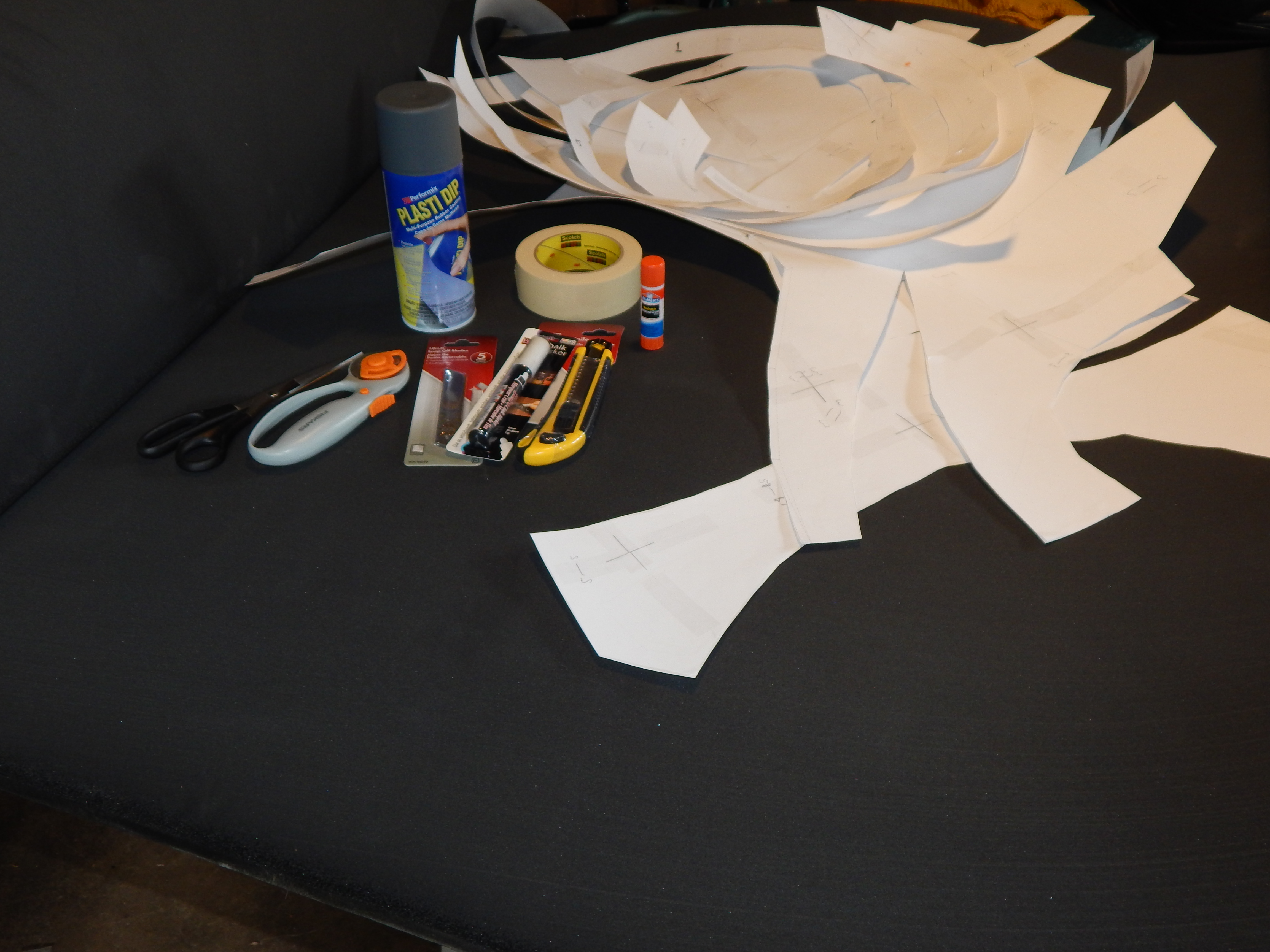

Initial supplies gathered, templates cut out and glued to poster board for a little extra support when marking/cutting the foam.

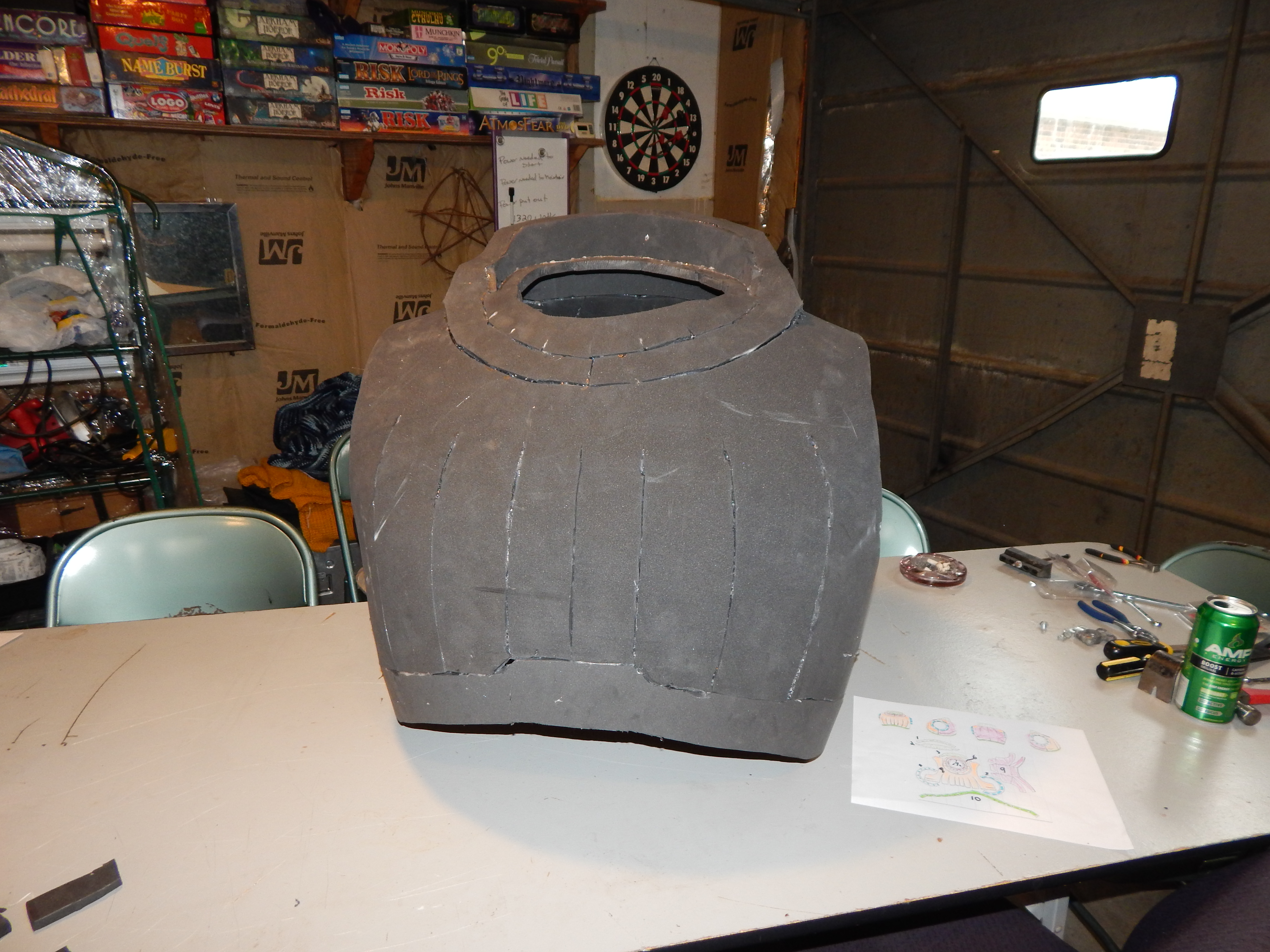

Day 1: Foam pieces for chest cut.
Day 2: Chest piece coming together nicely. Need to re-work the neck collar pieces and I am in desperate need of caulk for gap-filling and sandpaper. However, things are coming along better than expected for my first time doing any foam work.
