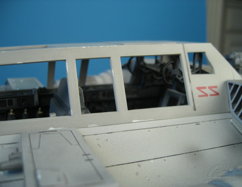

That's looking really good!! Did you take it apart to work on it or just tape it off? How did you keep the red lettering and stripes?
'Ancient Chinese Secret.......' I didnt take apart squat hahah. First thing I did was take a rag and some Acetone to the brown poo 'weathering'. Came off without a problem. Grabbed some leftover paints from my Deago Falcon build and lightly went over some panels with 'Close Enough' gray to give it some depth. A Q tip and black chalk replaced the dings on the edges with some flat black in the airbrush. Dabbed some thinned rust an a couple of areas and ran over the panel lines with a sharp pencil. Put some white chip marks here and there.
But no...I didnt do any invasive surgery and dont have a set of SS decals thus the light repaint. I lost my Dremel tool on the boat.....Ill dig it out tomorrow and properly grind up the factory edge dings and cut out the horrible windows. I have a Black Series Luke and display stand on its way. By then, I should have some more progress on this little girl and will take some shots in natural light as this is totally washed out.
The pictures of the actual model make it out to be really washed out color wise IE, not a lot of depth. Kind of boring in my book. Supposed to have crappy weather all weekend so Ill play with while it rains.

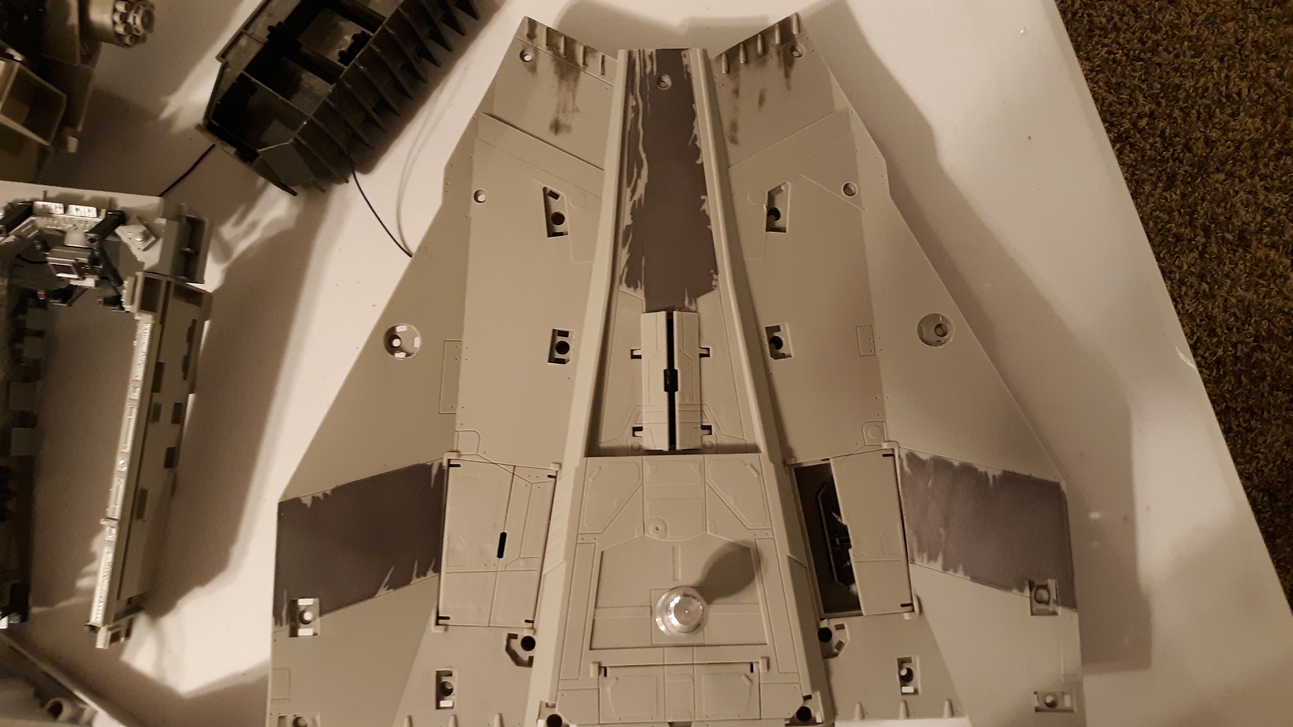

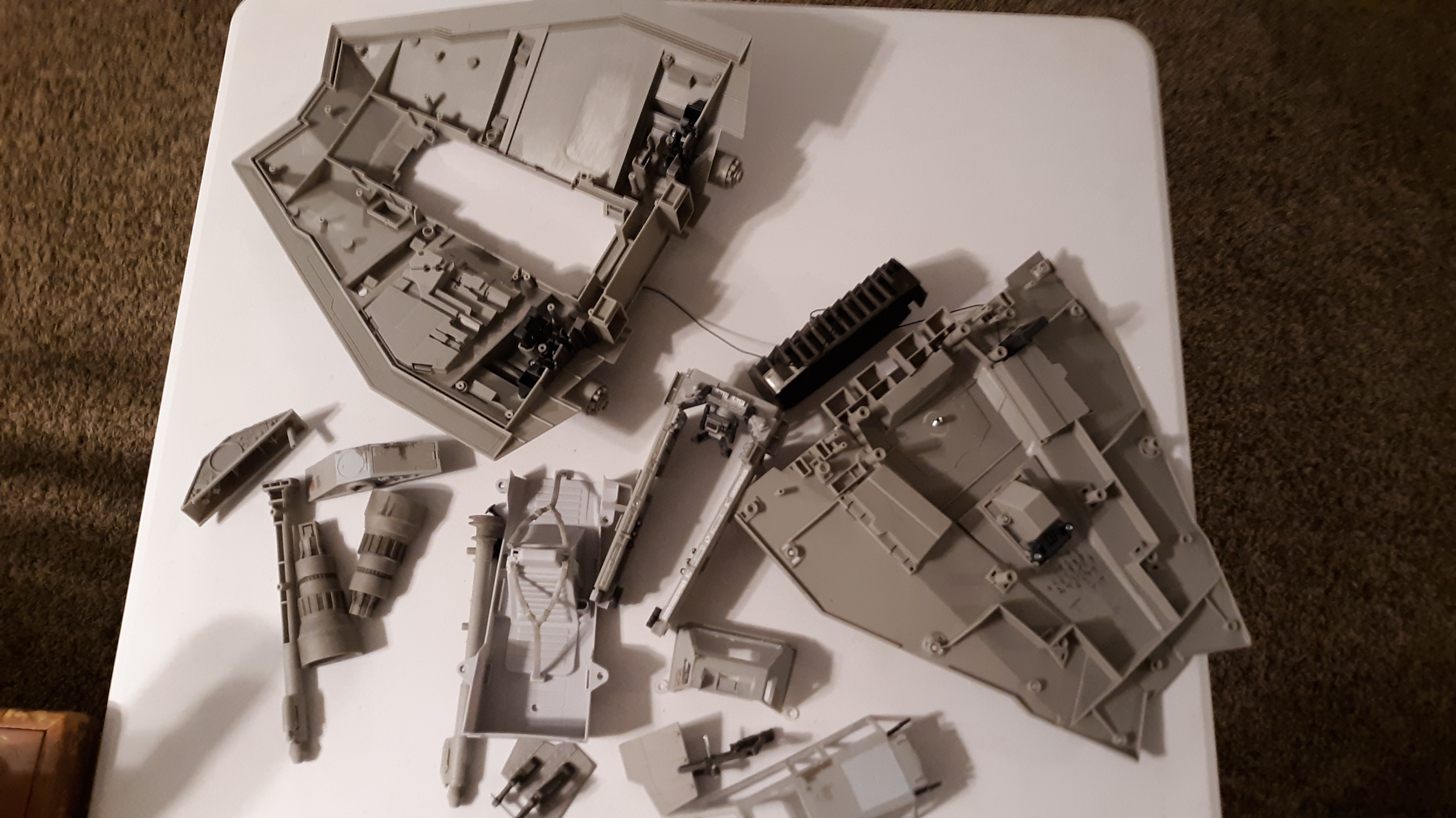

I took it apart. Lots of screws. The front few are showing but most those little hatches all around the bottom are covers for screws. Then you have to gently pry it apart from the front to get the entire one piece back engine part to pop off. It is a bit of a challenge but goes back together easy.

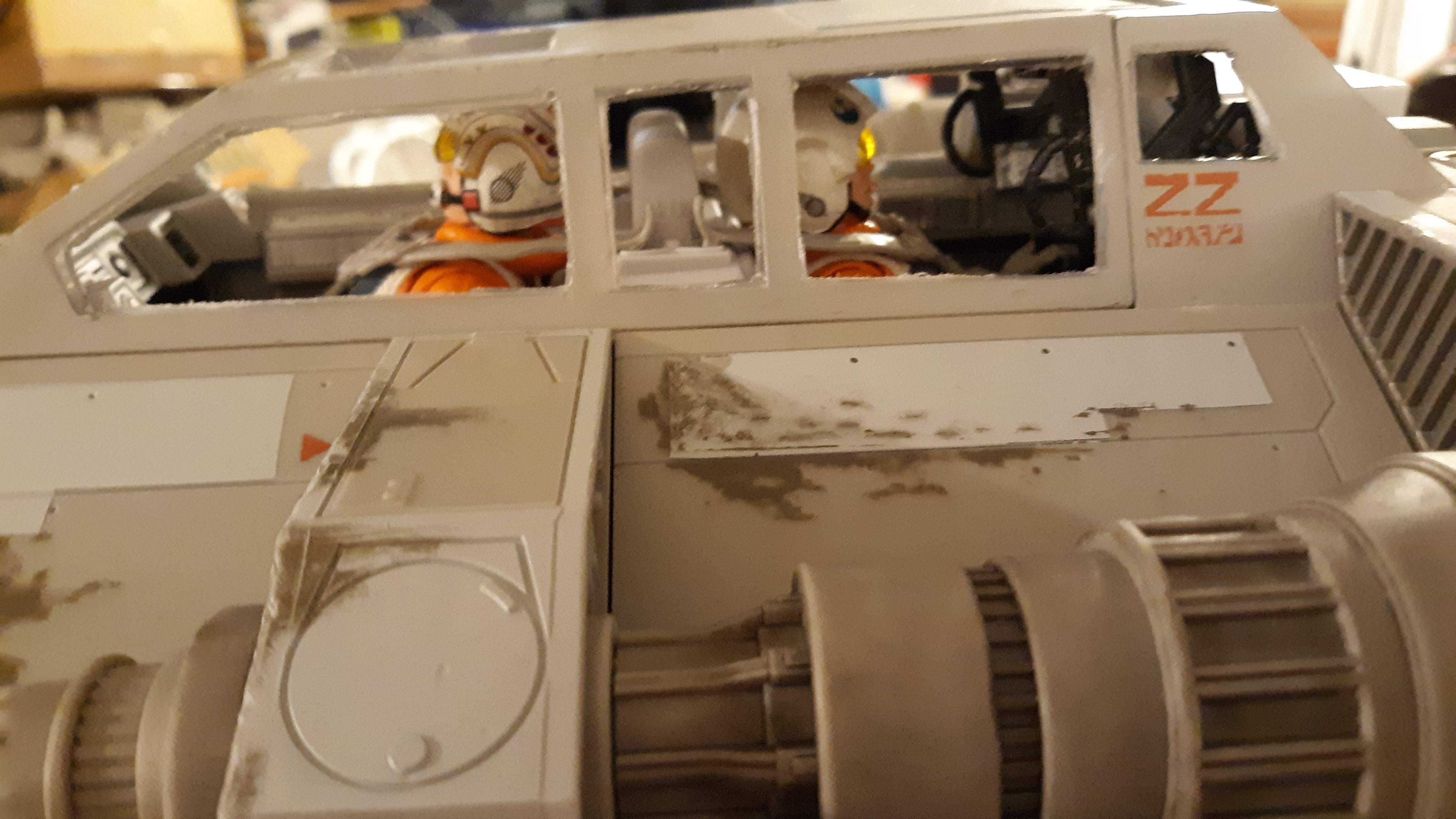

I also cut out those God Awful!!! windows. Since this is crappy plastic, so far is not filing or sanding easy. I dremeled the windows and then tried to clean them up with a box cutter. Next I will clean them more with a fresh xacto blade, remove the ugly weathering, add some paint detail and should be good to go.

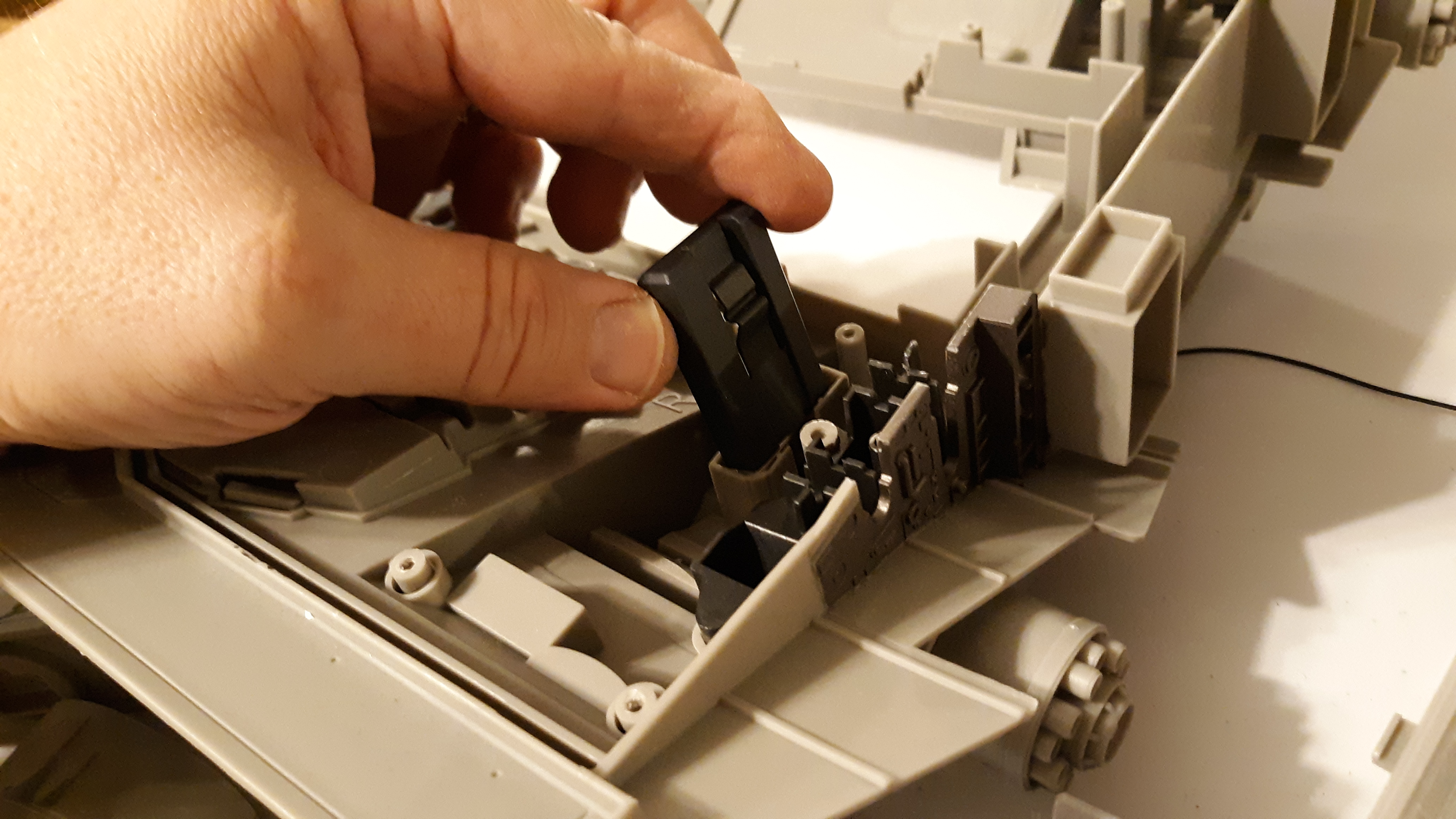

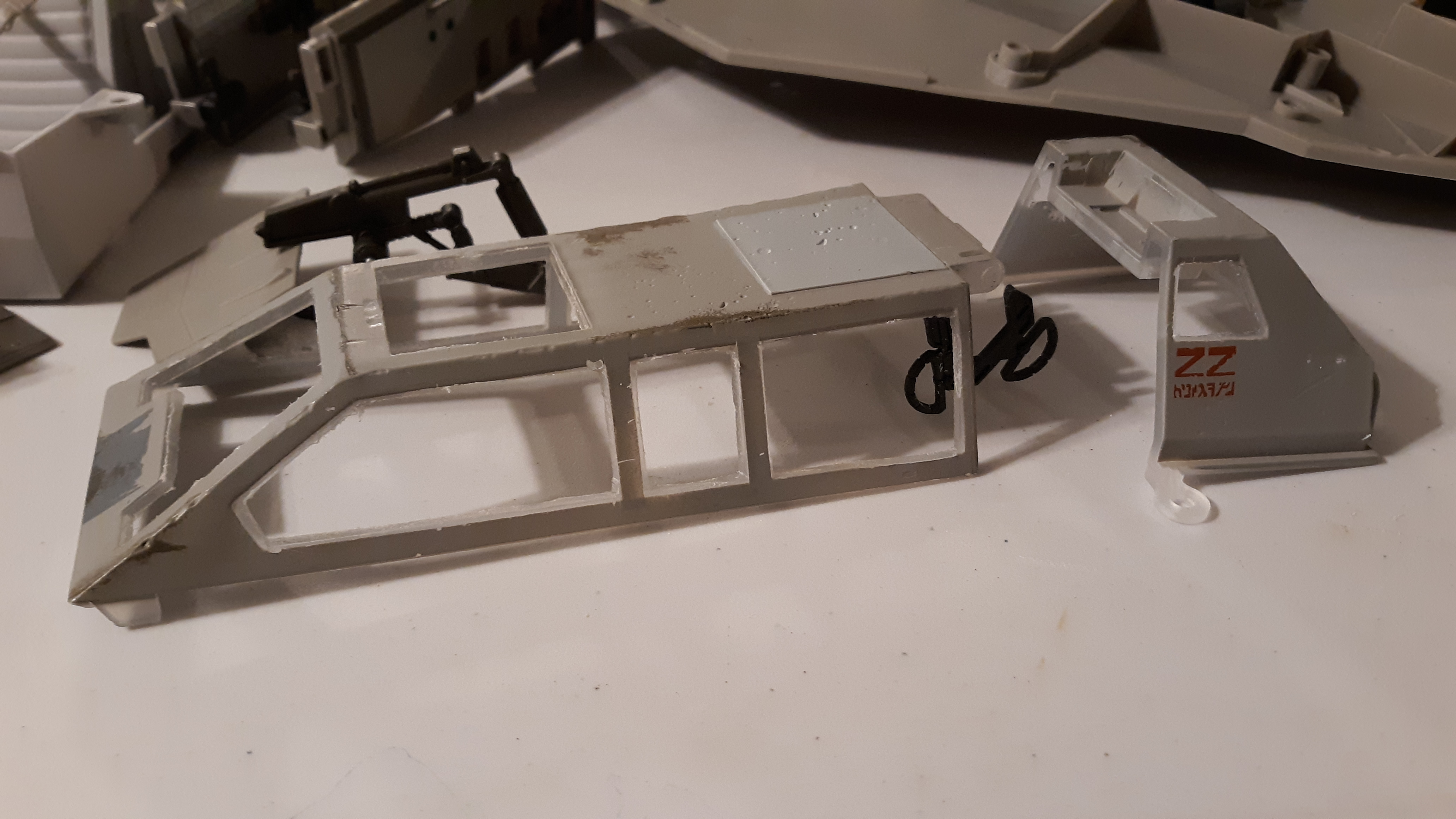

Here ya go. Try to pull off/pry the engine section as you pry the entire speeder from the front. I included a pic of a piece, two actually, that popped off when it came apart. Took me a while to figure out where it went and how it went in there.
Obviously more work is needed on the windows.
Since I had it apart I wanted to work on the rear canopy piece as that is harder when it's together. Filing, and using a brand new exacto knife. Still not great but a little better.

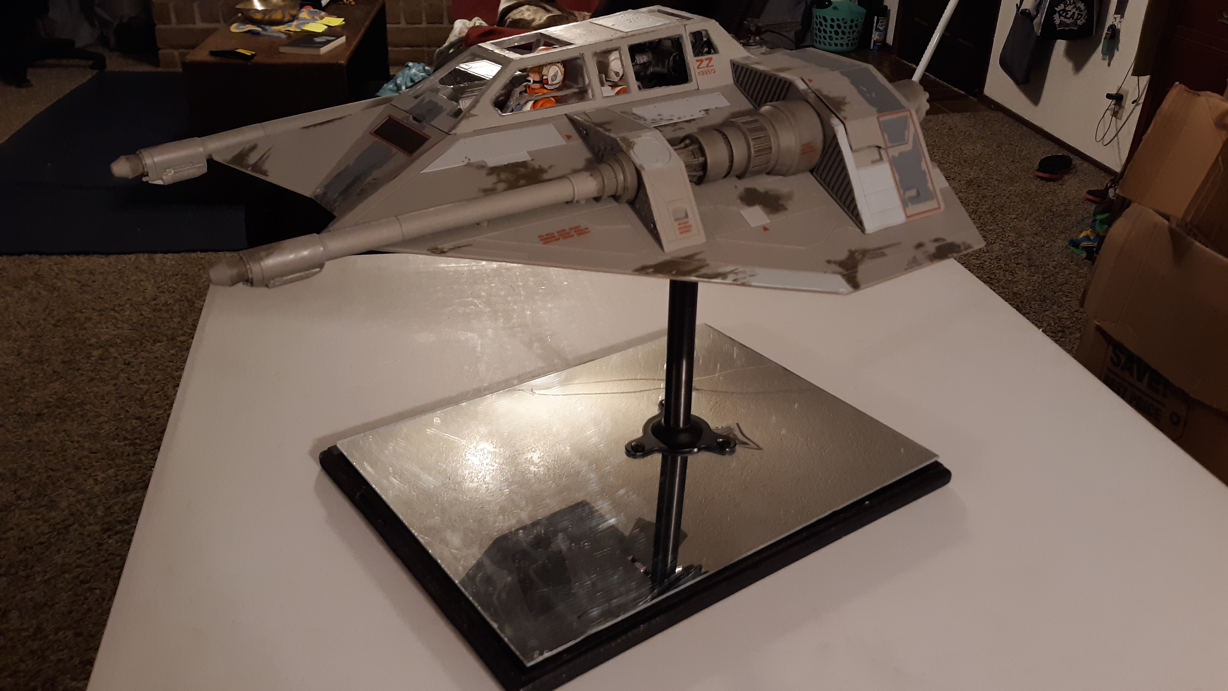

Okay this is temporary using an old piece of scratched acrylic and a wood base. It's too small and eventually will be on a larger mirror /wood base but you get the idea.

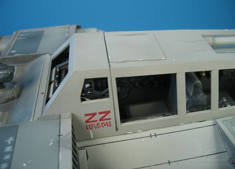

The Canopy should look like this:

What kind of mount did you use here for the stand? Where did you get it? Thanks! Great work!
