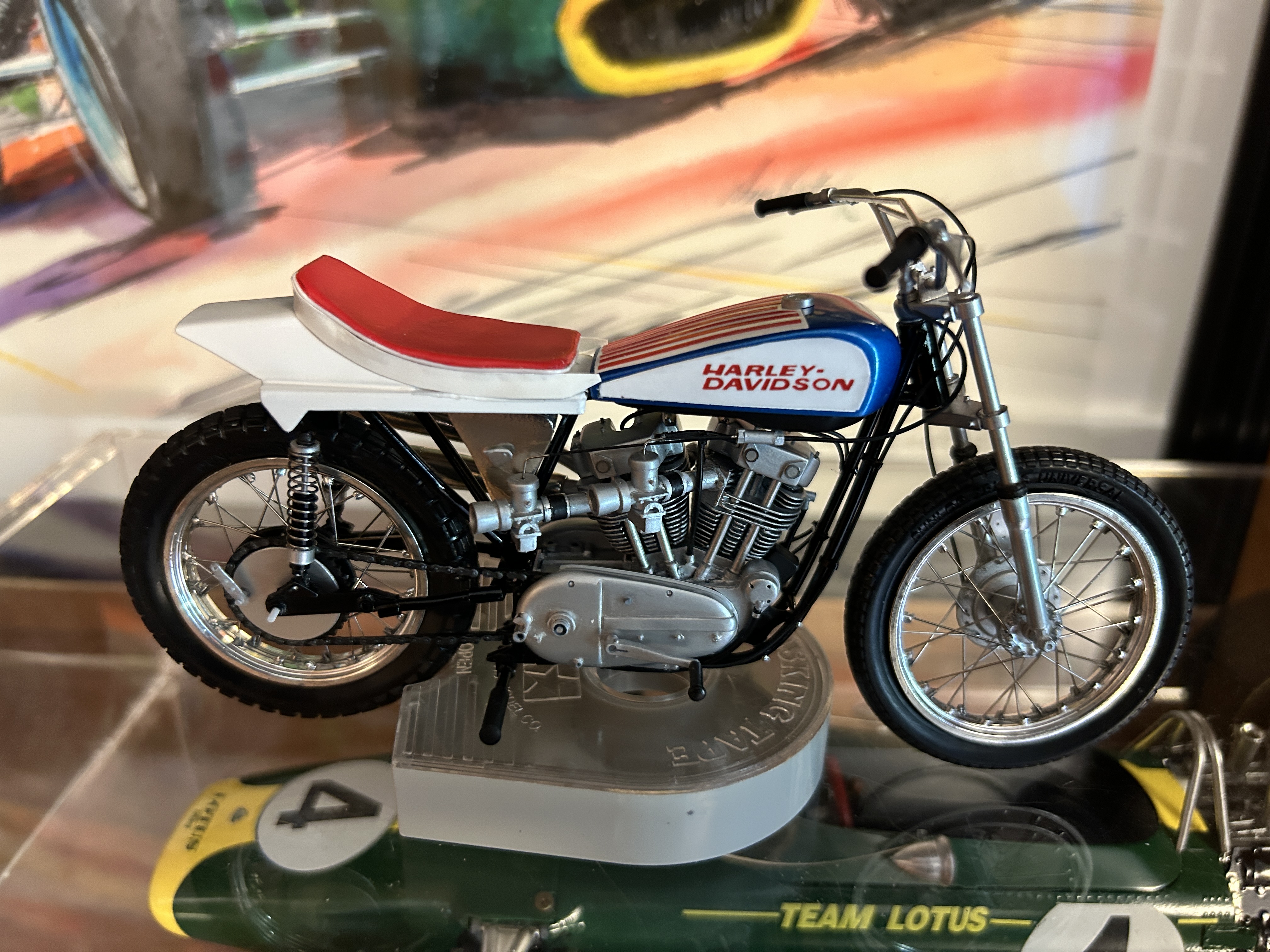

Not sure how many of you will be into this subject but you might appreciate it from an artistic perspective. In addition to Star Wars, I'm into 70's and 80's pop culture, toys, etc. My brother and I had Evel Knievel stunt cycles growing up. I have restored some of our originals and purchases other vintage Knievel toys. I've also been building model cars for many years. I decided to build a MPC model of the Fonz's Triumph motorcycle. The kit was so toy-like, I ended up scratch building a lot of extra parts from plastic and metal. I built so much for it that I started to question...could I build an entire Evel Knievel HD XR-750 from scratch? You guys with 3D printers are probably going to shake your heads at the amount of effort I took to basically be a human-3D printer. I started by printing a side photograph of the motorcycle in scale with a donor set of tires and rims.
I measured and calculated parts to scale. One of the biggest challenges was figuring out how wide things should be. I spent a lot of time searching for real XR-750 parts and bolts in order to calculate the frame width, the engine width, the tank/seat width. I started with some of the easier parts like the cover below the exhaust. This is multiple layers of plastic sheet glued together and then carved and sanded to the correct shape. The chrome part was then covered with bare metal foil.
I cut all the molded spokes out of the donor wheels and hand laced them with 0.3mm stainless steel wire. I also made the front fork out of aluminum tube and plastic layers for the connecting parts.
