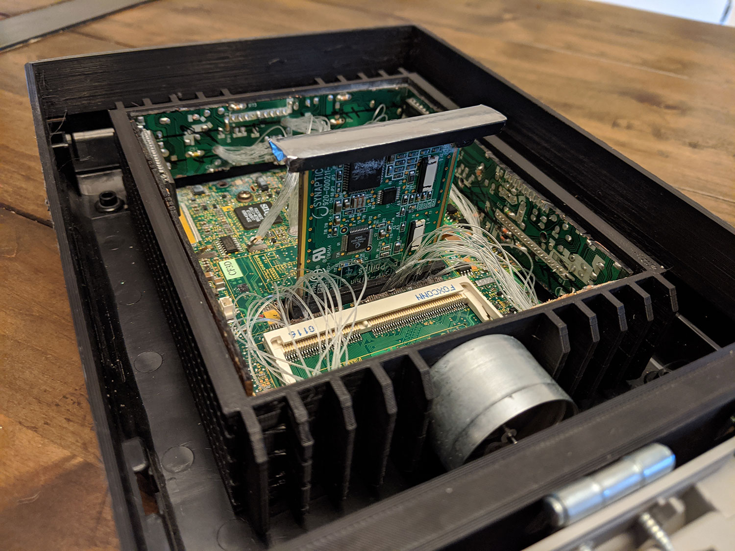

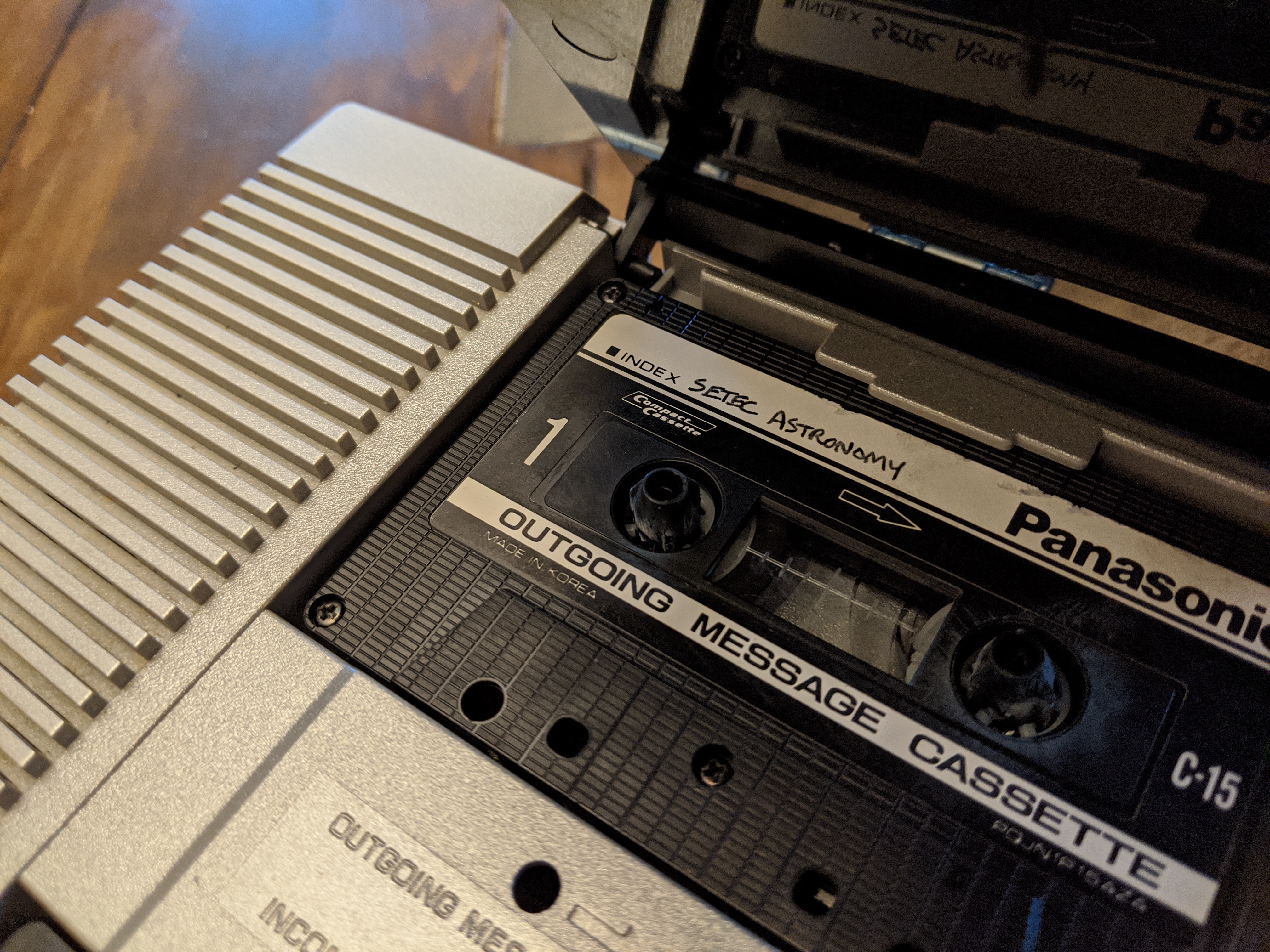

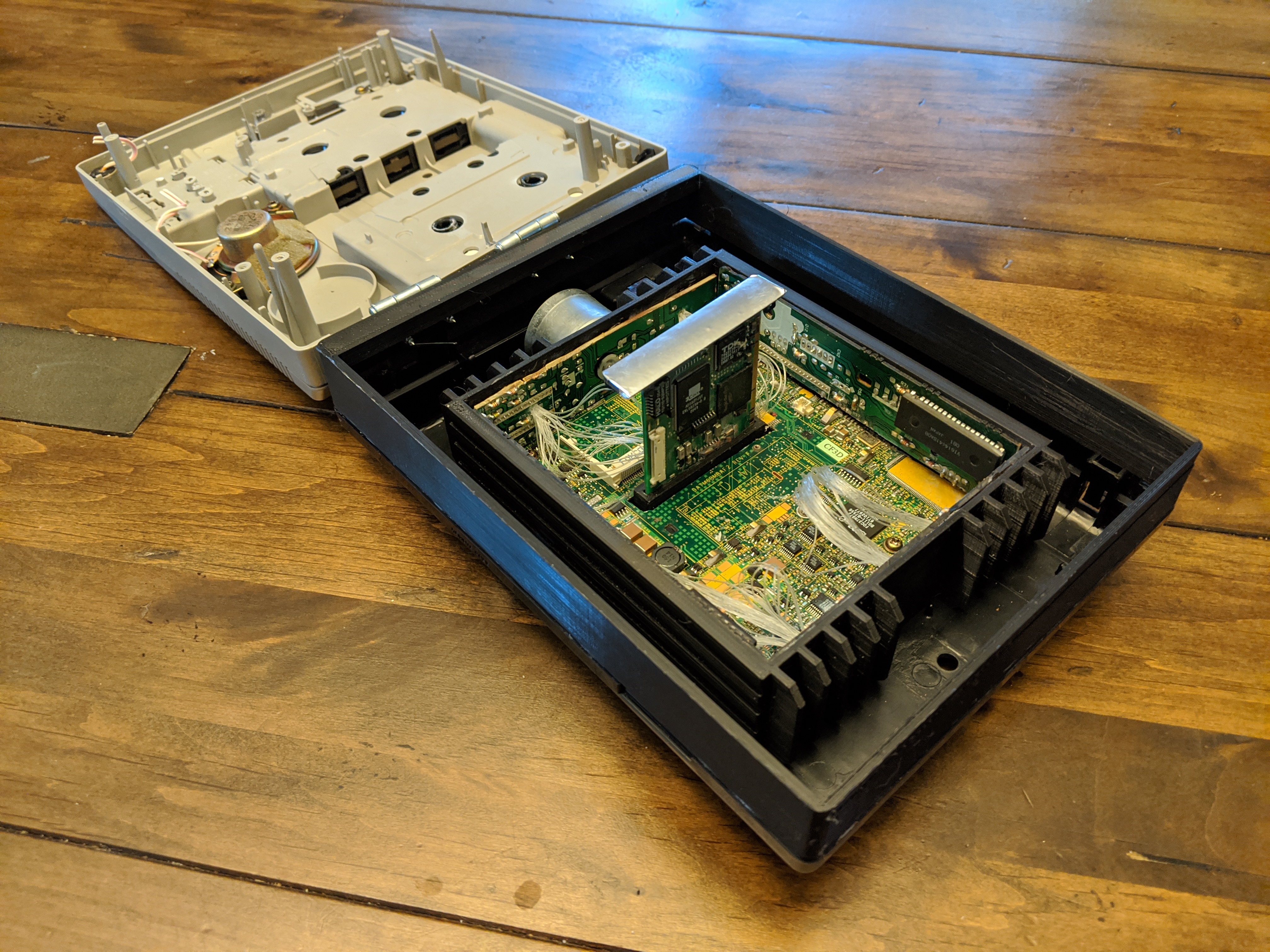

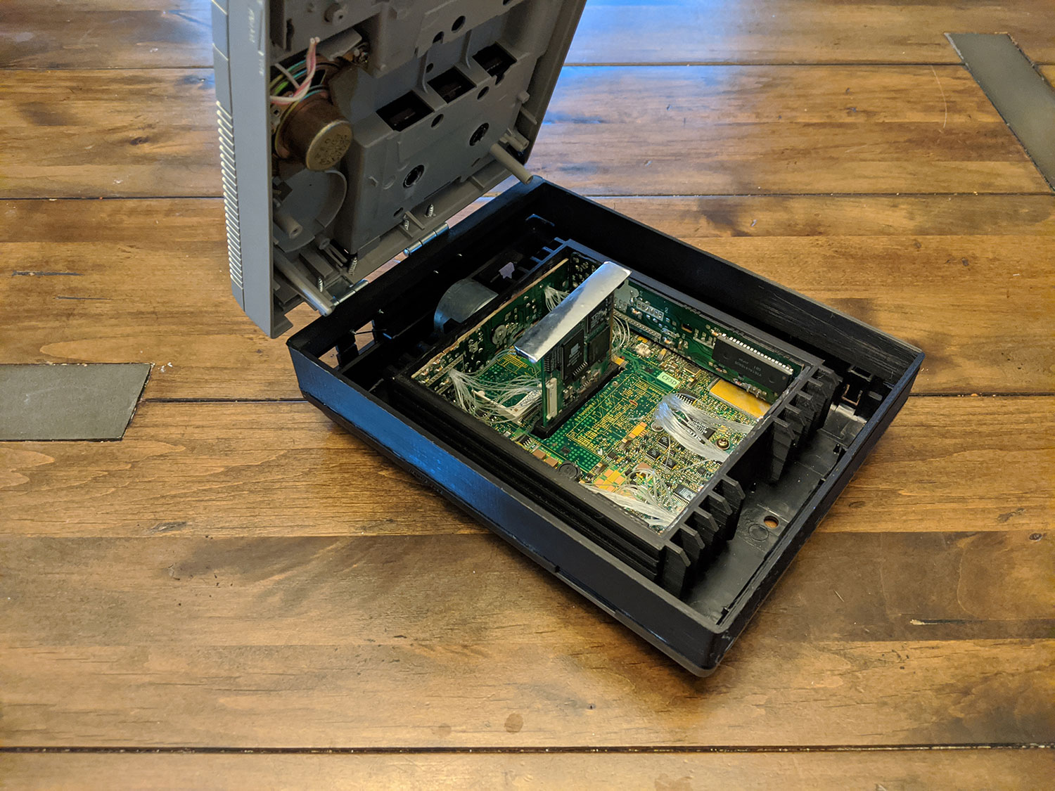

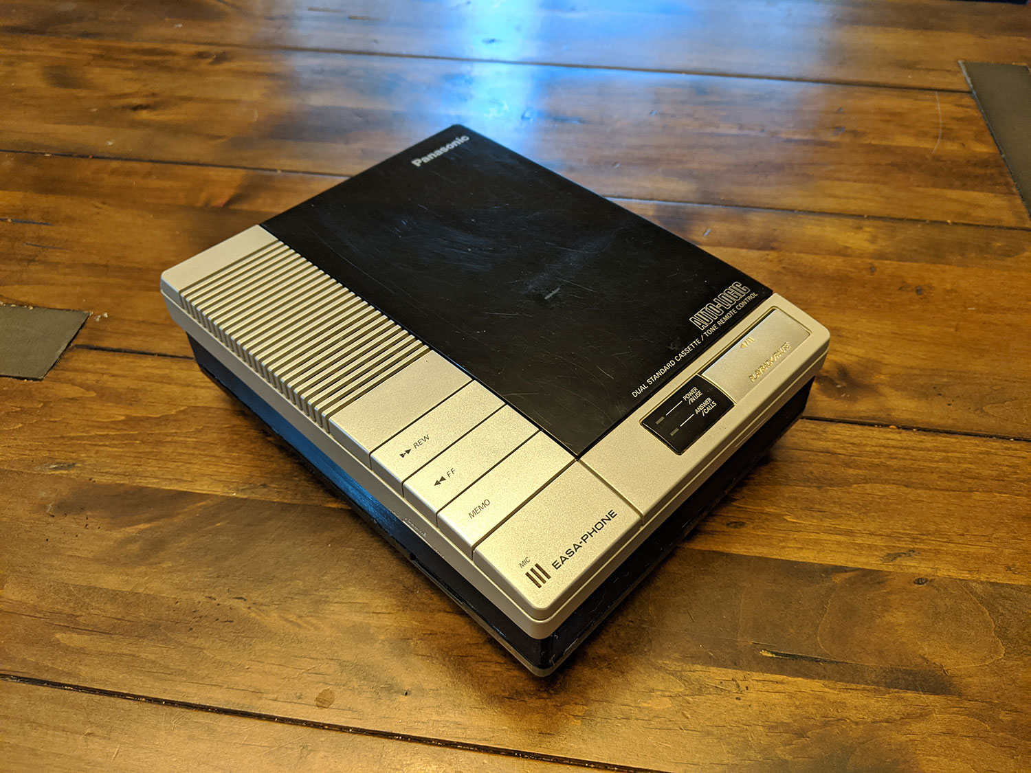

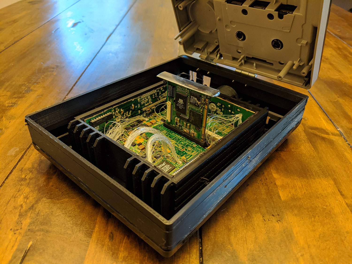

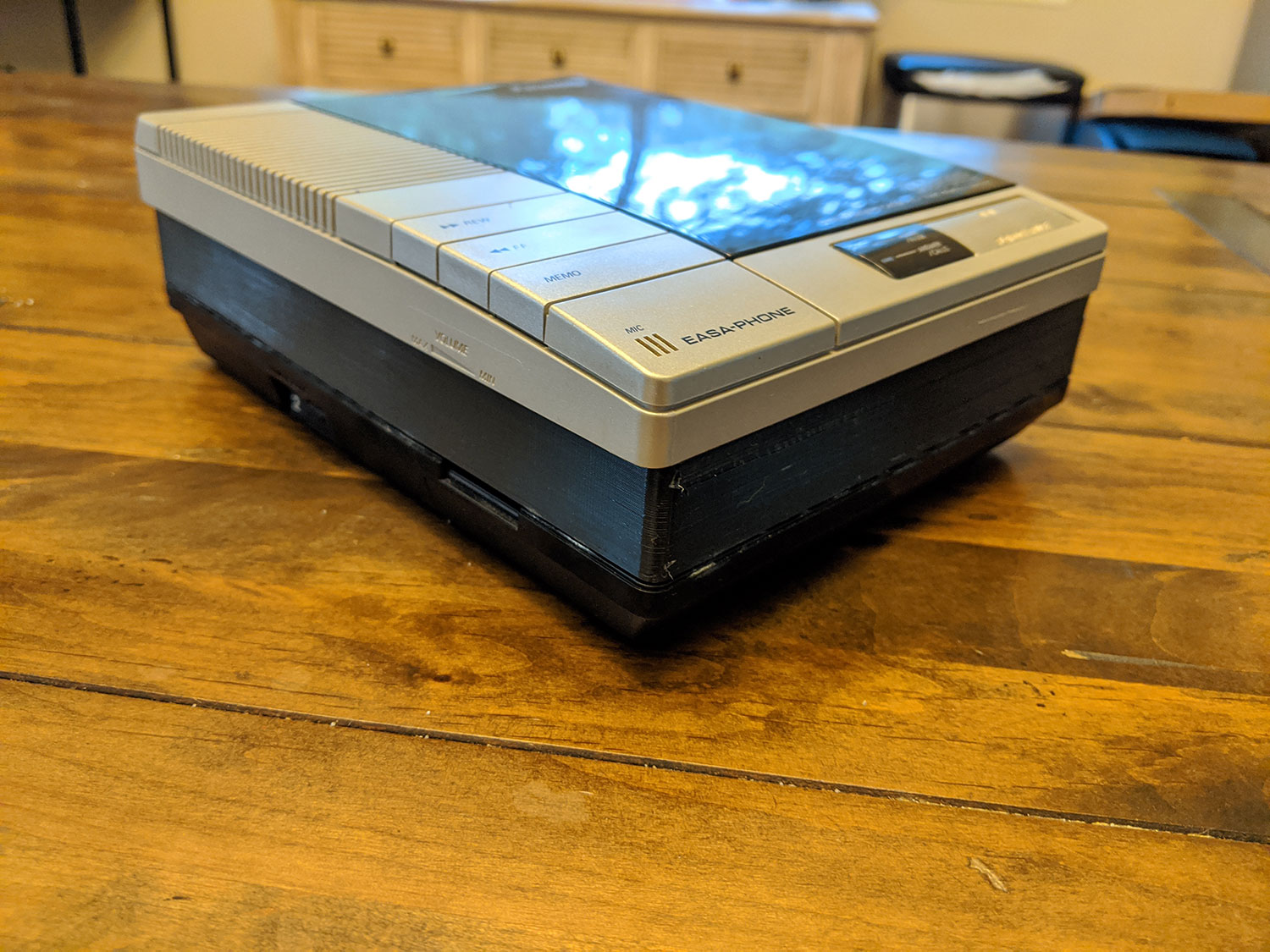

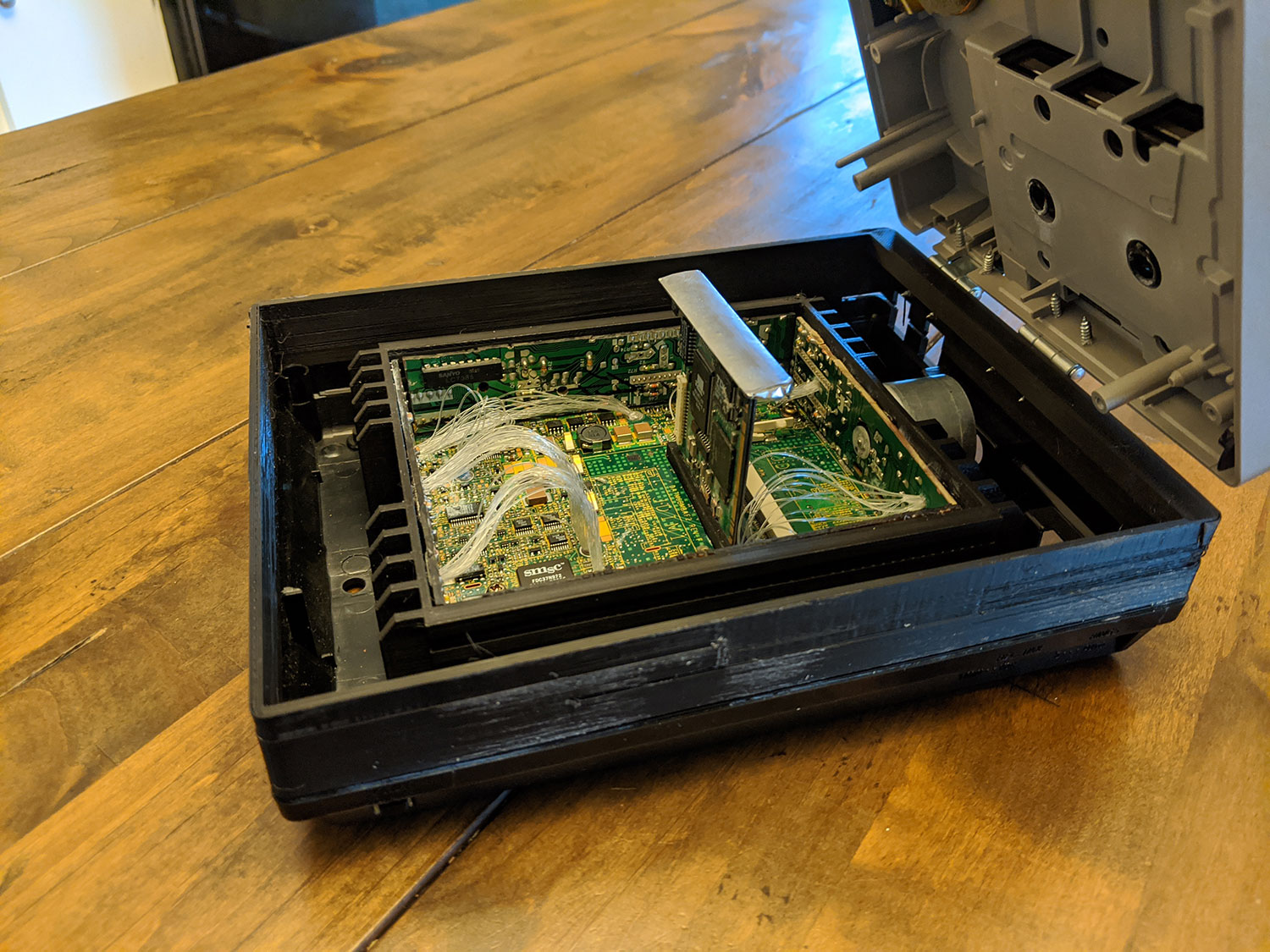

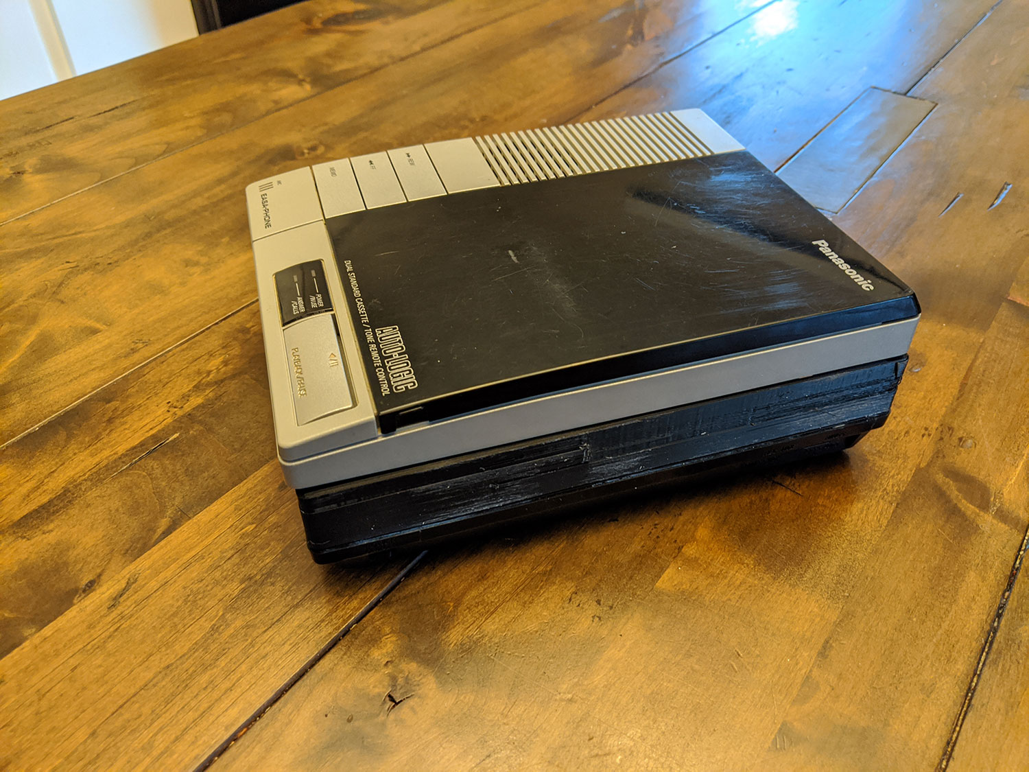

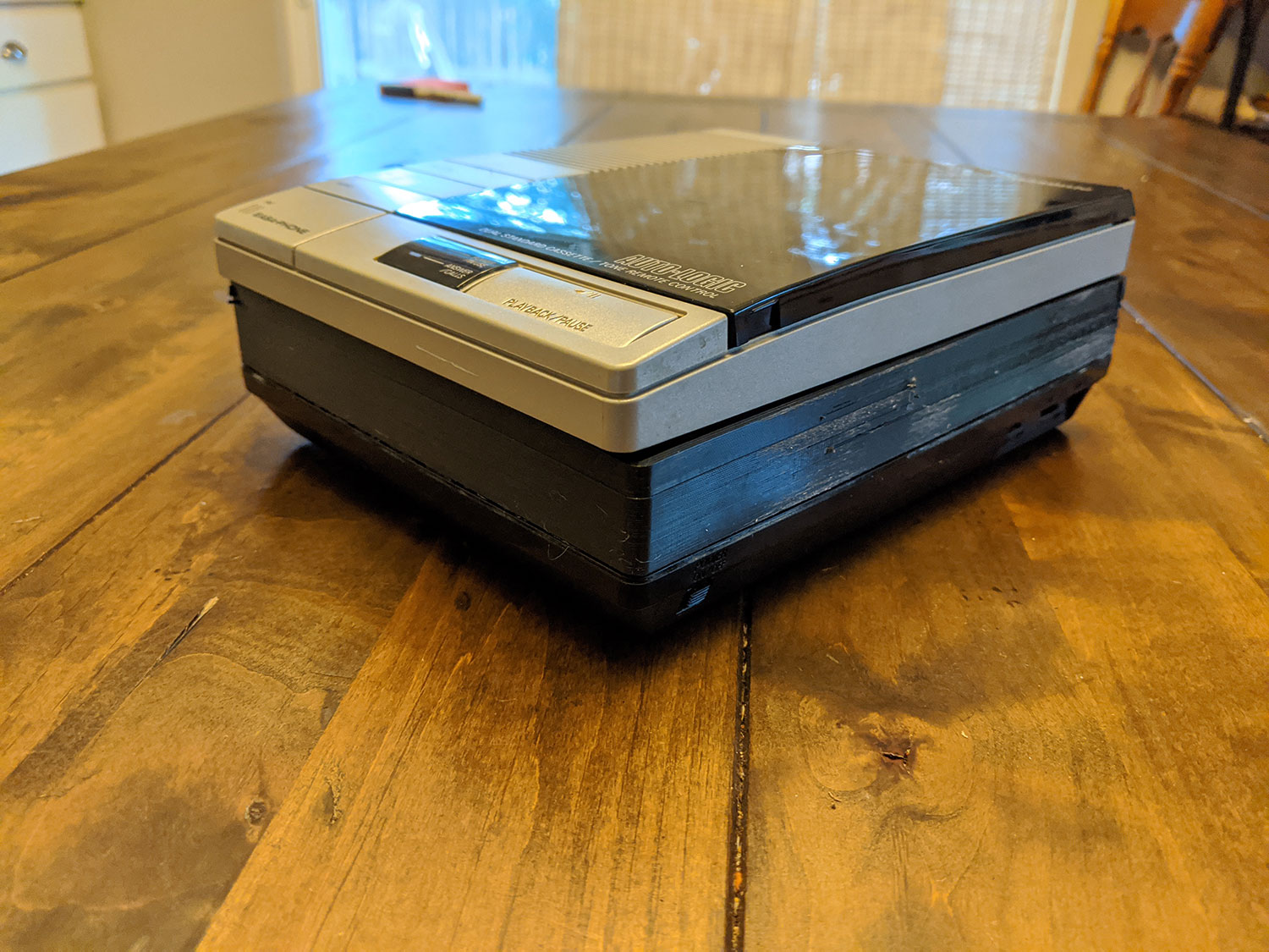

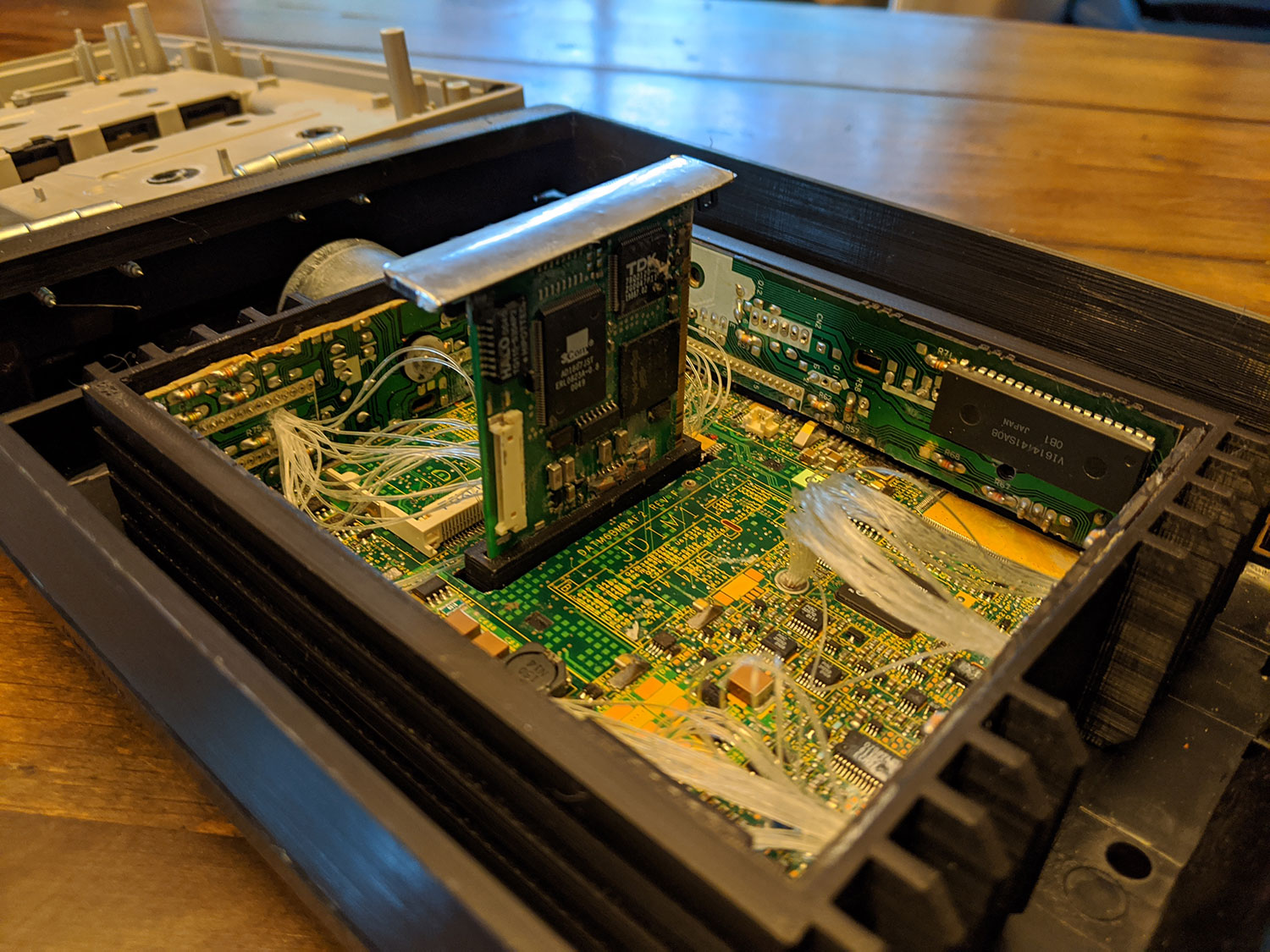

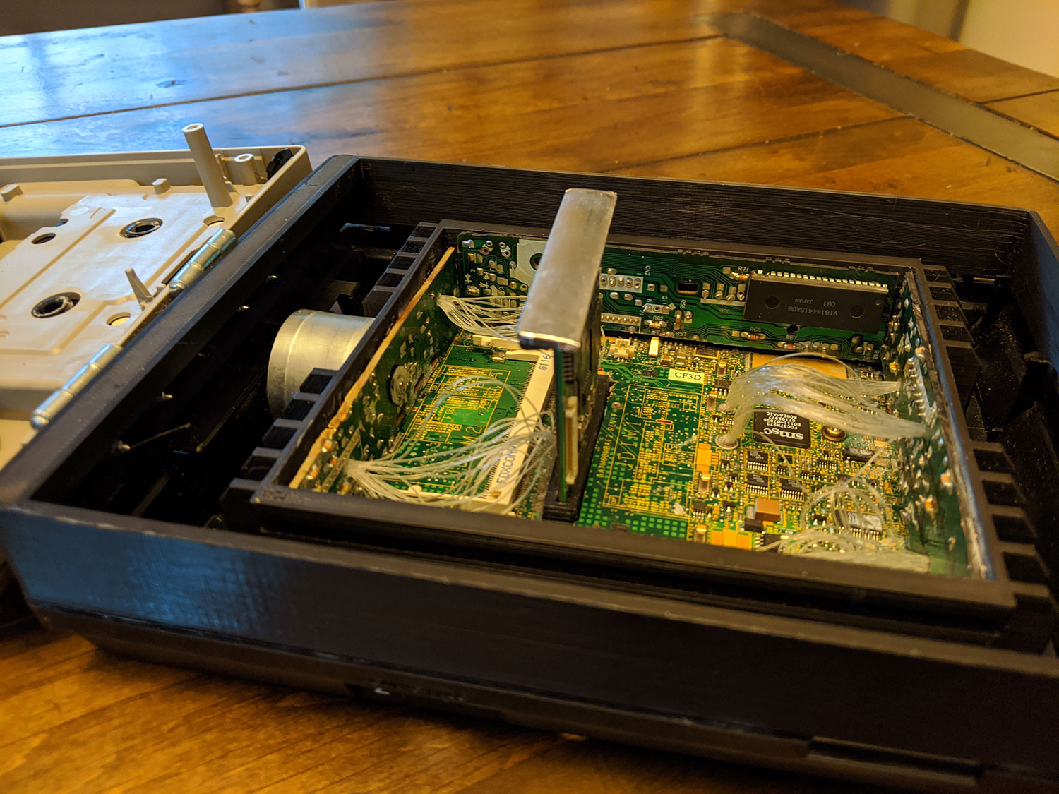

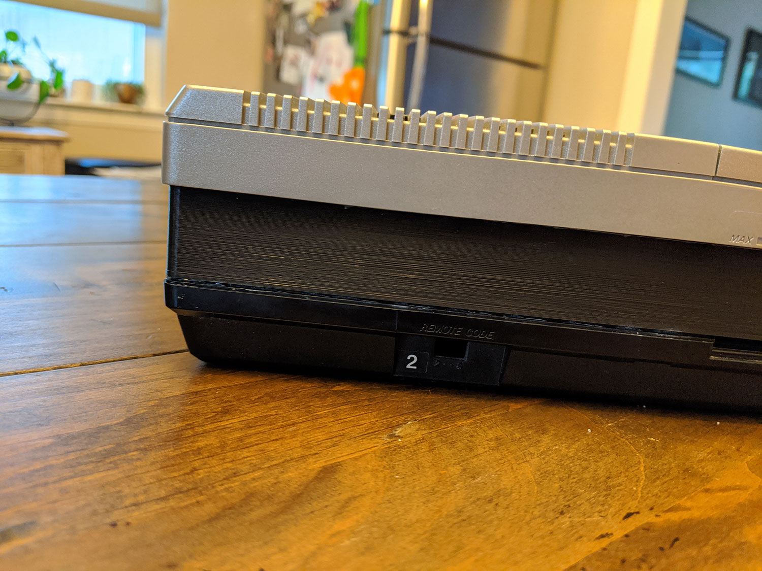

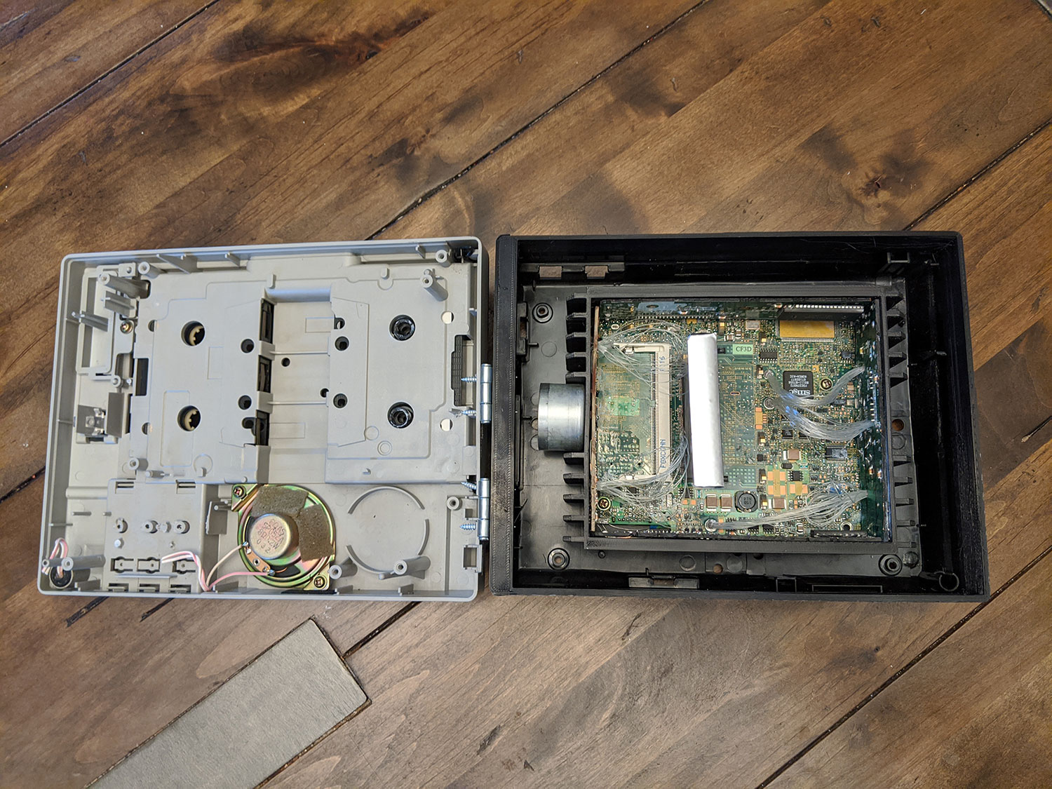

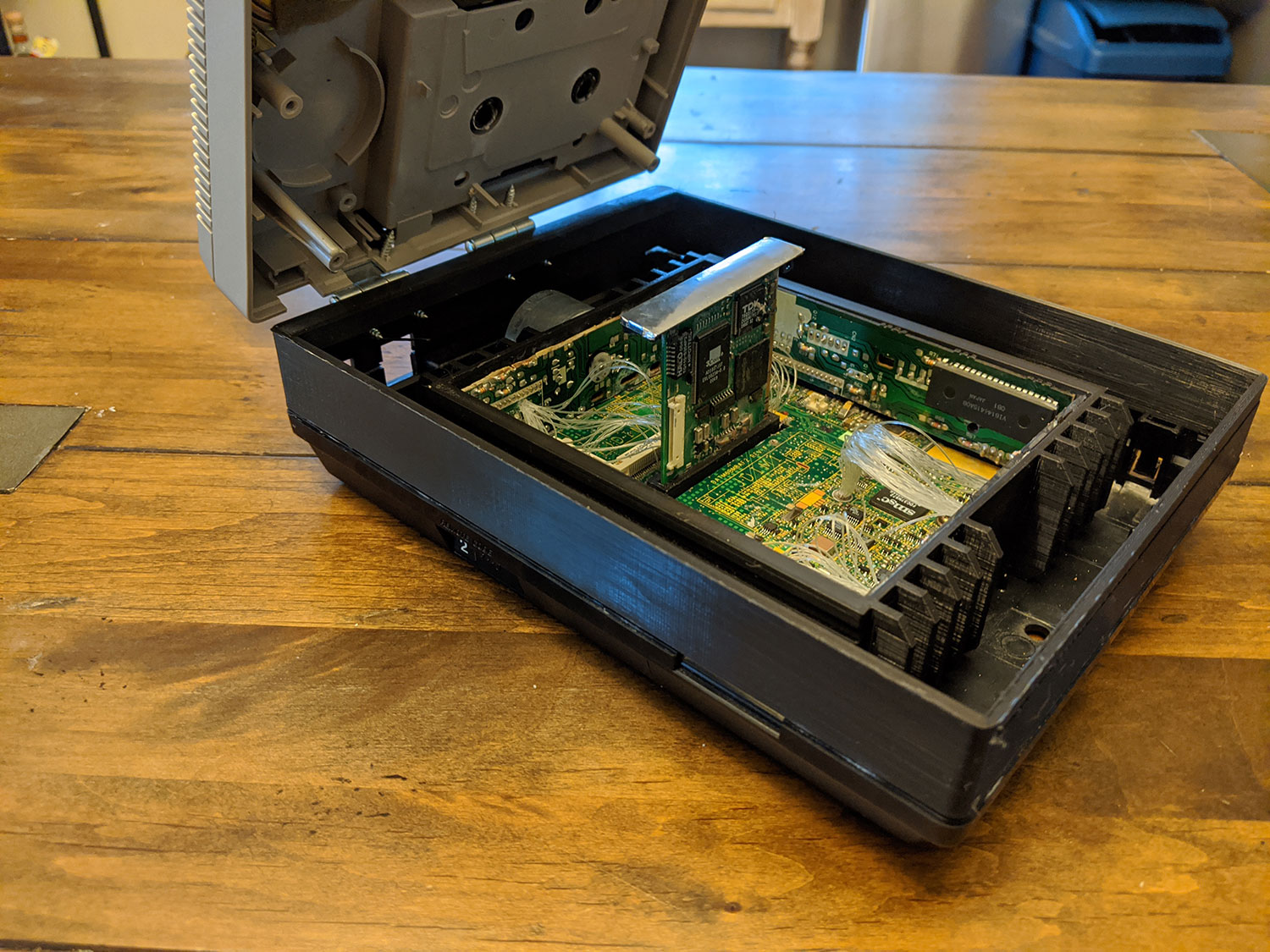

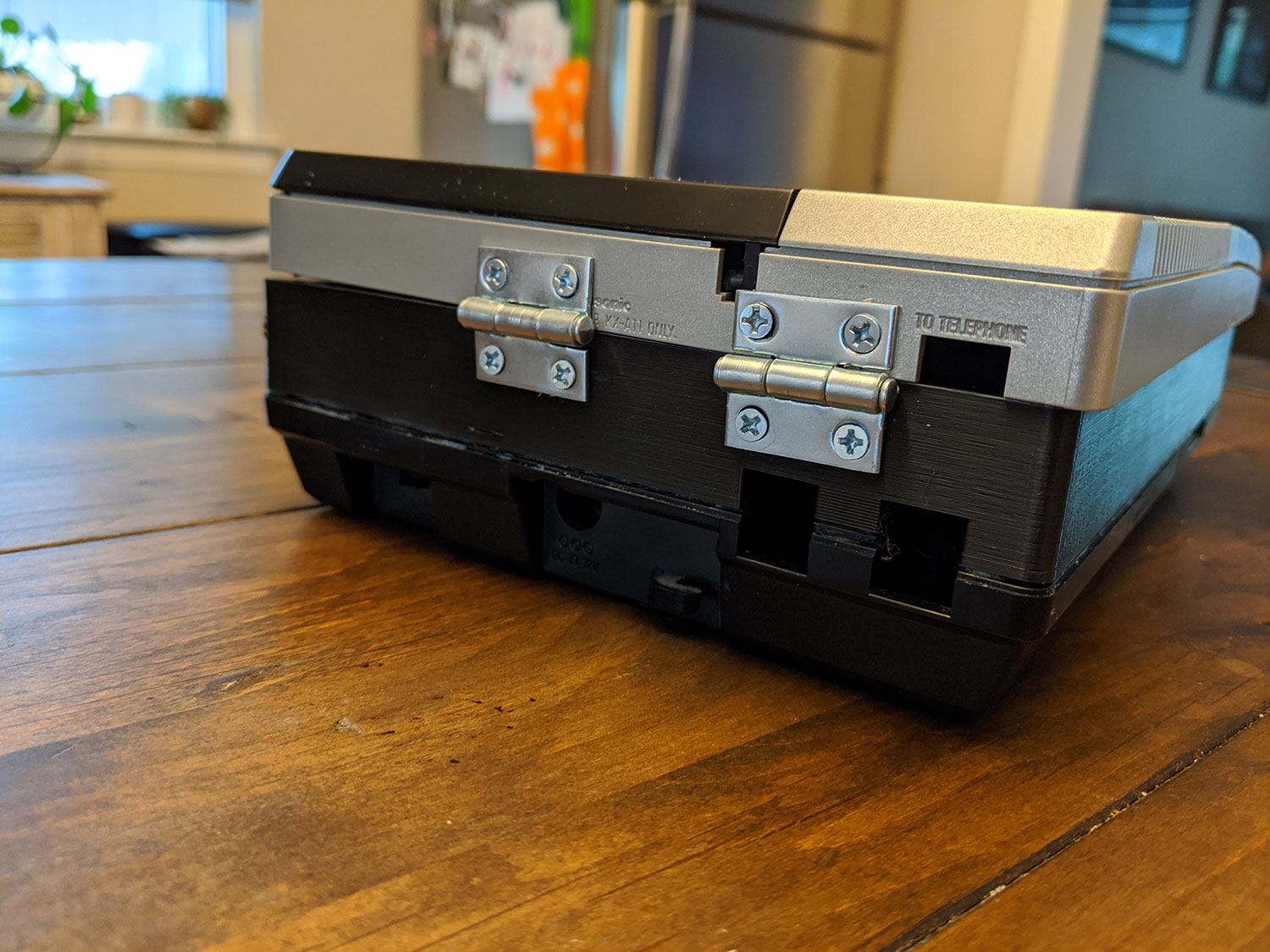

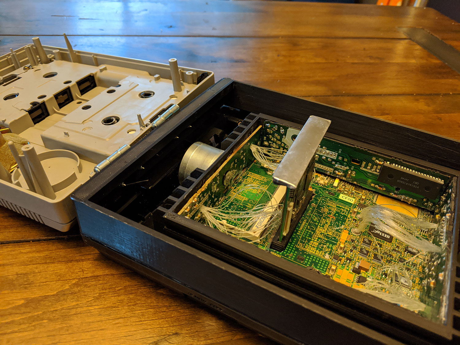

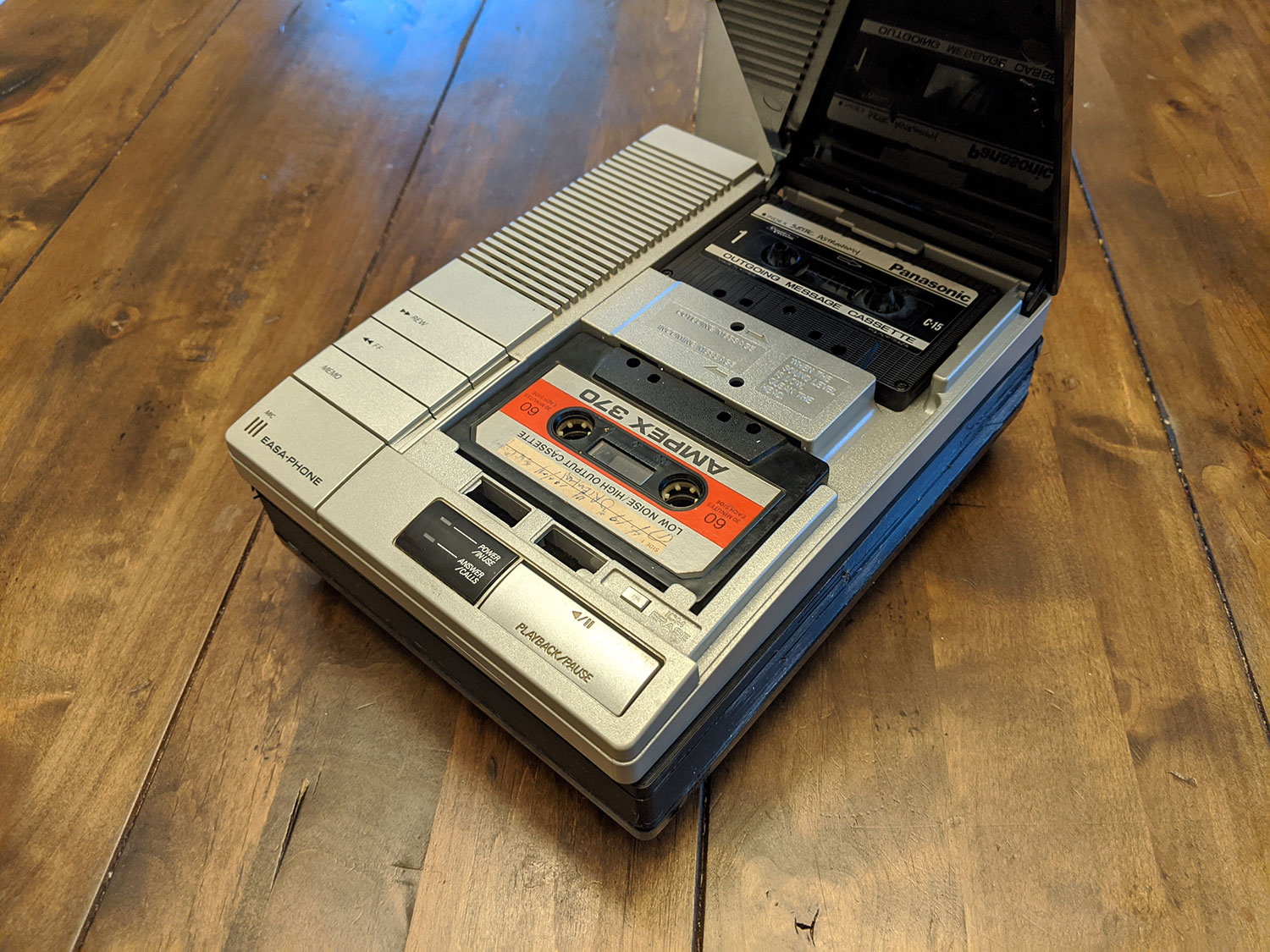

Well this thread has a been a HUGE help for me! A friend of mine mentioned that the black box from Sneakers would be his "dream prop" to own, and I thought "Hell, I can make that." Big shoutout to TankGrrl for the 3D print model of the interior casing and the 1.5" spacer!! Made this build a lot easier with that.
Ordered the answering machine off eBay ($20), gutted it, got a broken laptop from Goodwill for $5 to strip for parts (mainly for the circuit boards), had a friend doing the 3D print job for me, then it basically just cutting the circuit board pieces to size and supergluing/screwing everything together.
Only ran into 2 problems when putting it together:
- During the 3D printing, one of the corners of the spacing box delaminated a bit, so I had to sand it down, which left it a bit scuffed up. Not the end of the world, though.
- When I was installing the small hinges for the "lid", I was REALLY hoping that a single hinge in the middle would be enough for a sturdy support. Unfortunately, it wasn't, so I had to install a second one off to the side. In hindsight, definitely should've put them evenly spaced apart on the far left and far right edges. Ah well.
All in all, though, pretty happy with this for a quick (and fairly cheap). Going to leave it at my friend's doorstop in a box labeled "To (Friend), From SETEC ASTRONOMY".

Hooray! Glad it was useful. And great job populating the black box!
BTW, if anyone's interested. When I built mine I found that Krylon Metallic Shimmer was a fair match for the shell color.
UPDATE: Apparently they don't make the same nickel/silver Metallic Shimmer any more. I think it was K02338007 :/

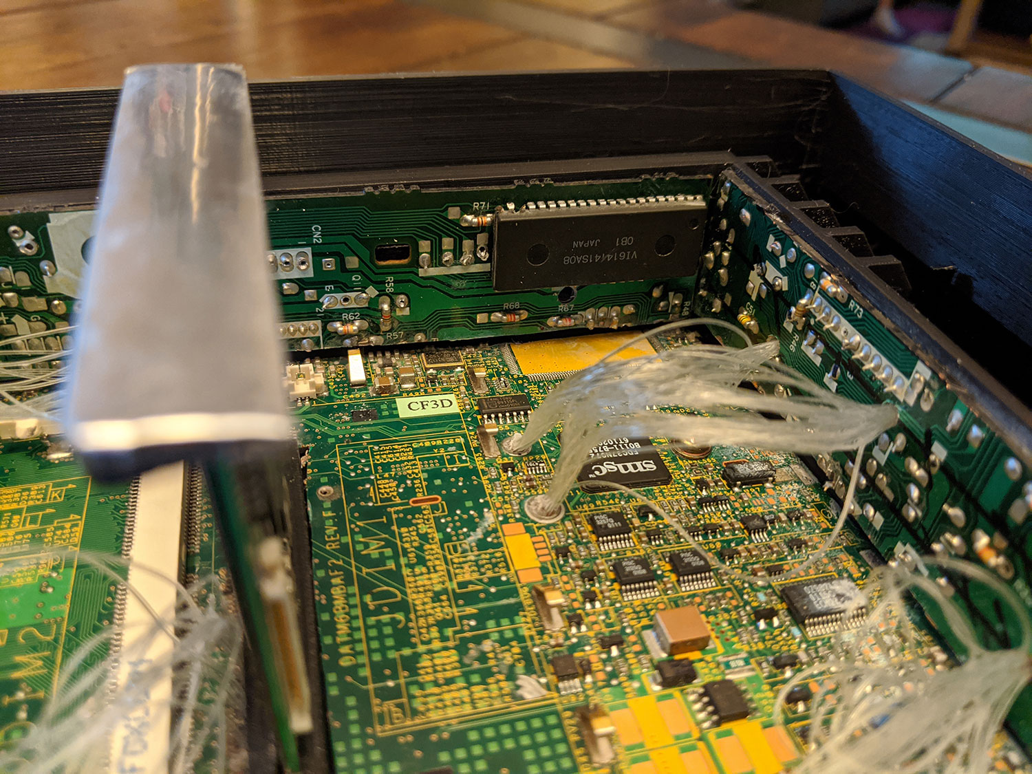

For anybody still chasing this muse, here's my best reference on the Black Box contents. I'm pretty sure that the tangle of wire is what we call in the business "bodge wire" which is thin solid gauge wire used for prototyping and fixing. Doesn't look like fiber optic to me. The little board in the center is, I think, not a Found board, but an assemblage built up on some kind of substrate on which somebody has drawn circuit-boardish shapes which don't make much sense electrically. But we can still identify many of the parts! We never see the other side of this thing, which makes me think it was not screen-ready.
