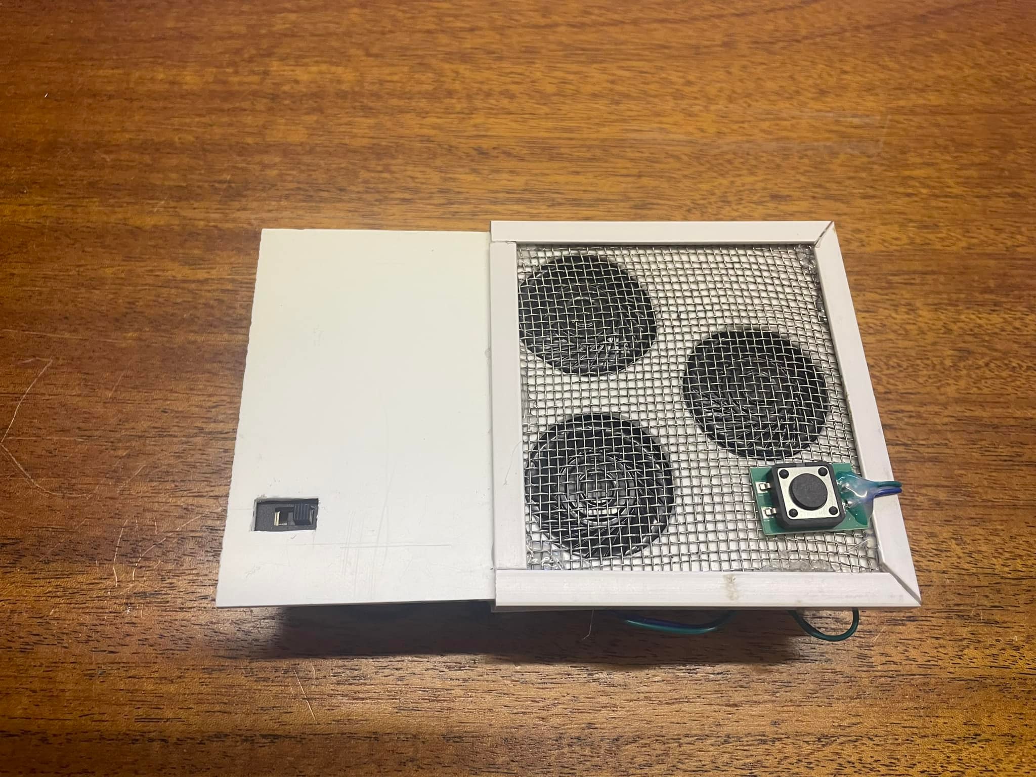

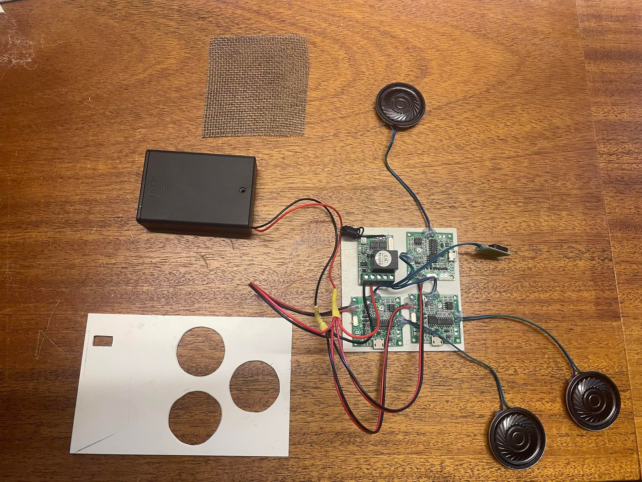

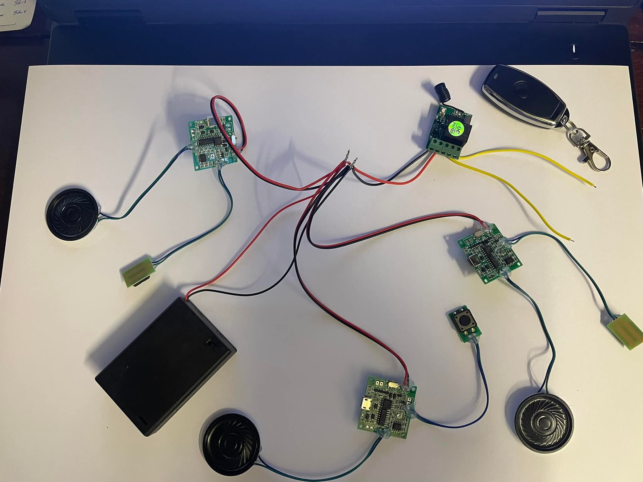

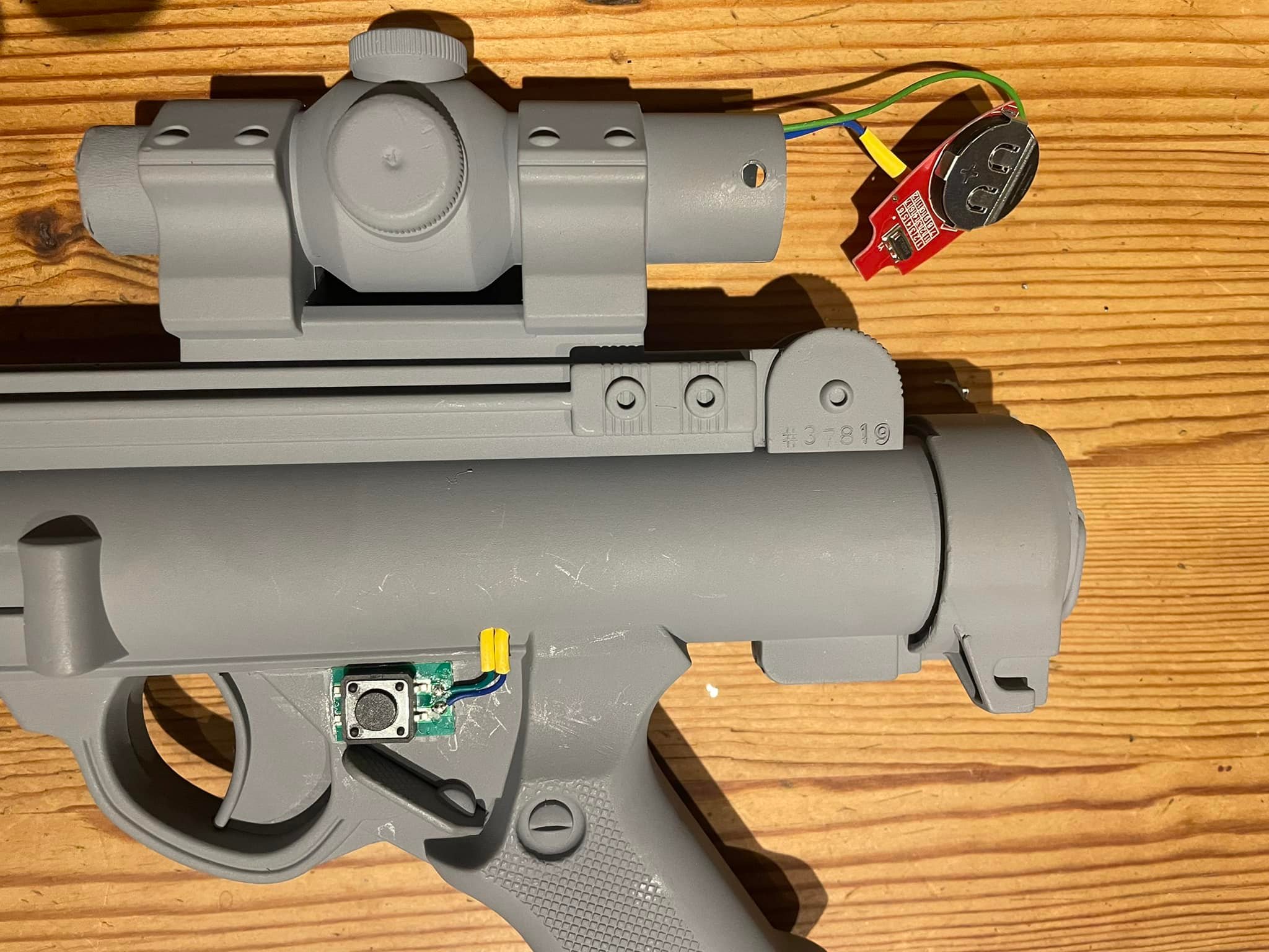

Are you still looking for something. For my Star Wars rebel costume blaster I have used cheap sound effect modules that you can download MP3/WAV files onto. I have 3 each with a separate sound file (and speaker as I dont know if they can be linked to 1 speaker) all mounted together with a battery pack which I have in my pocket. 1 module is triggered from a switch on side the pack to play an alarm sound. Then I have used a remote control relay switch to trigger the other 2 effects. I have hacked the transmitter fob to use an external switch which I mounted on the blaster and hid the transmitter circuit board inside the blaster. The receiver relay then triggers the other 2 sound cards. 1 plays a single blast sound when you press the switch and the other plays if you hold the switch down and plays a continuous fire. Attached links to Amazon parts.
