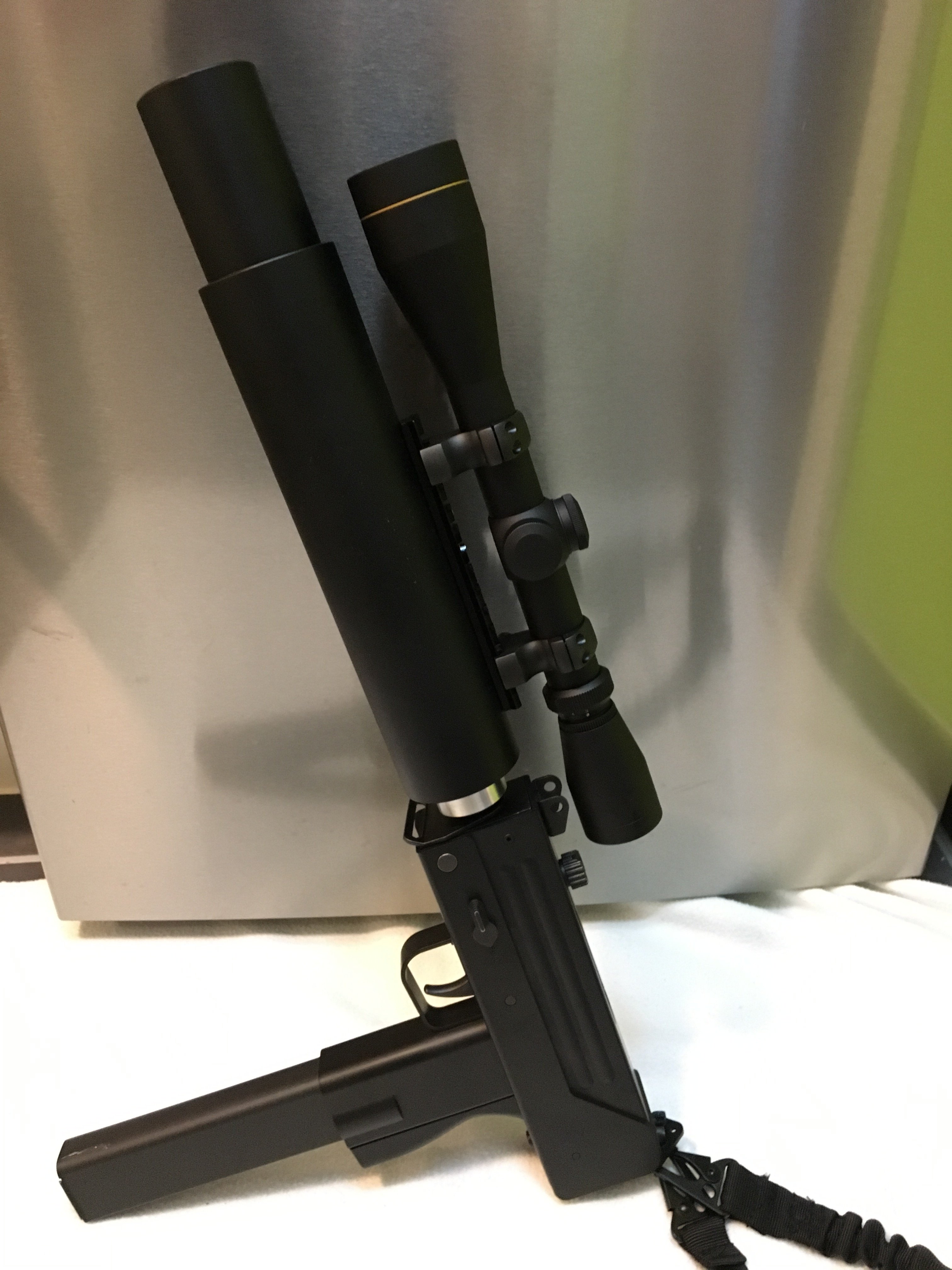

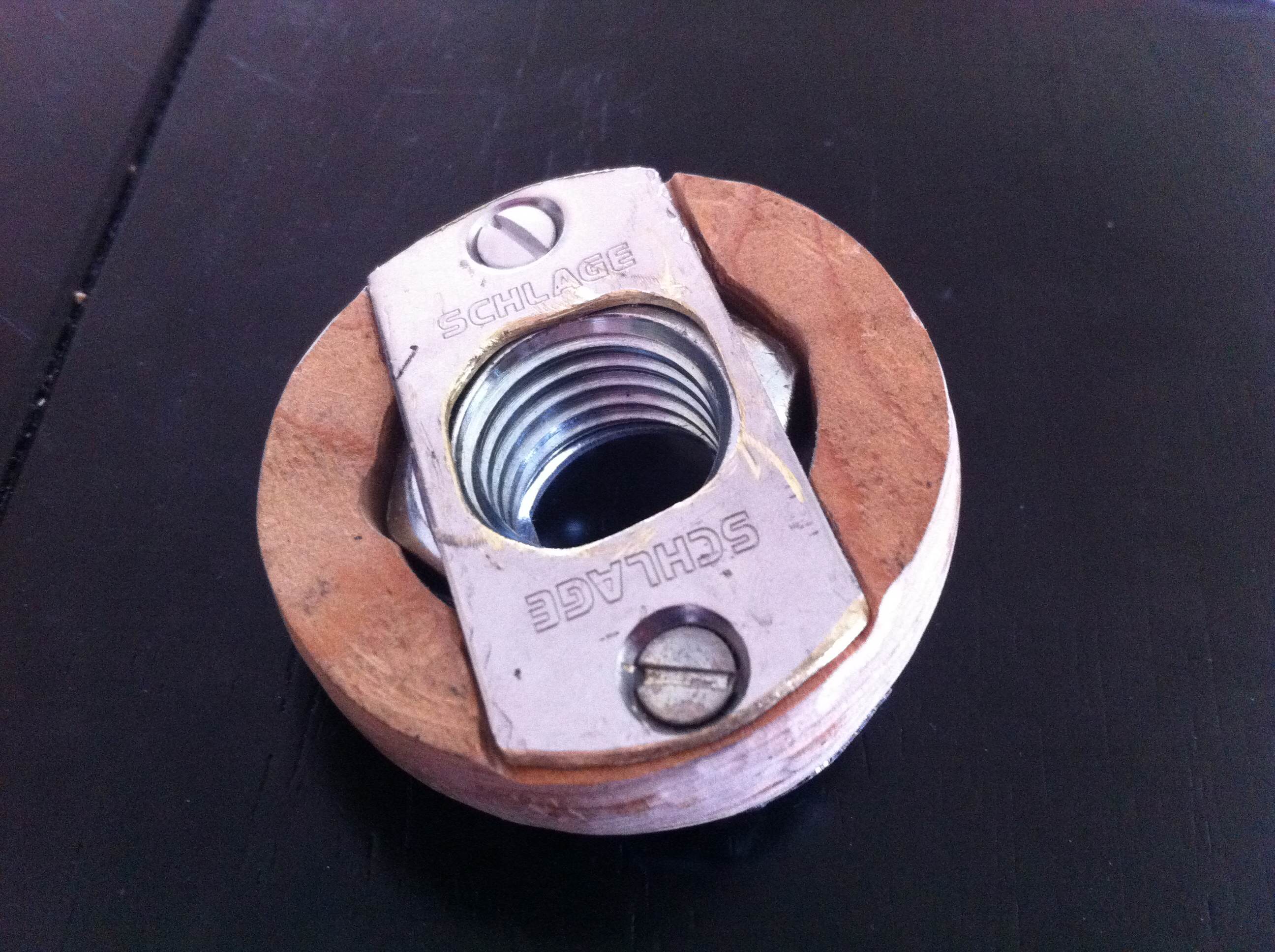

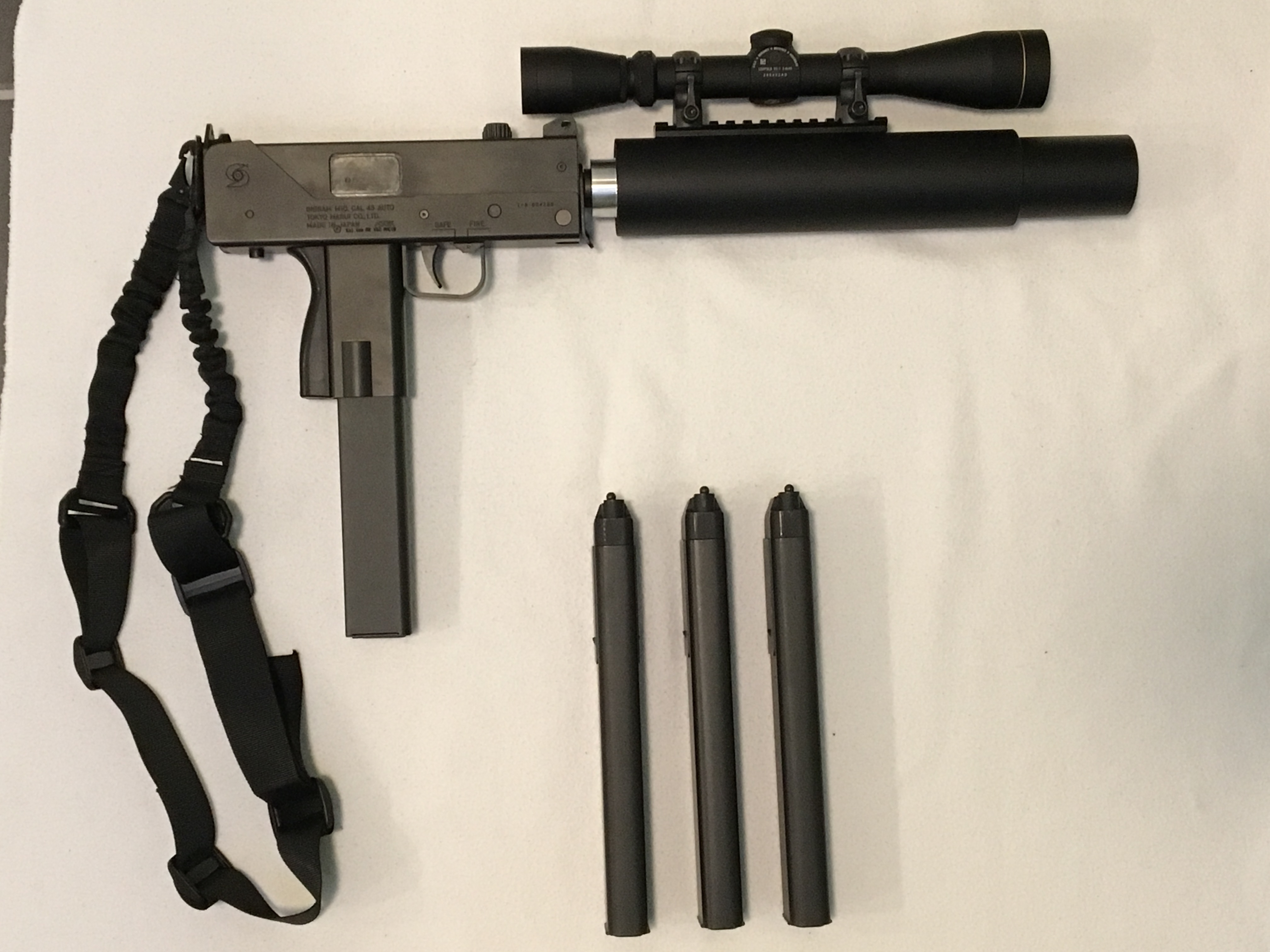

I finally got a Mac-10. Progress pic of my full automatic, Snake Plissken Escape From New York, Mac-10 Build. This is the Tokyo Marui Mac-10..NOT a Mac-11. Scope isn't mounted yet and no lanyard...but we're getting there. I now have the correct scope and silencer. I'm very happy with the progress. Getting closer. The tough part was making the PVC silencer threaded to the be able to screw on and off the gun.
I took a circular piece of wood, put the correct size bolt in it. Then I fabricated two pieces from a door knob to hold down the bolt. Then fit that into the silencer.
So Far...so good. Thanks for looking :)
