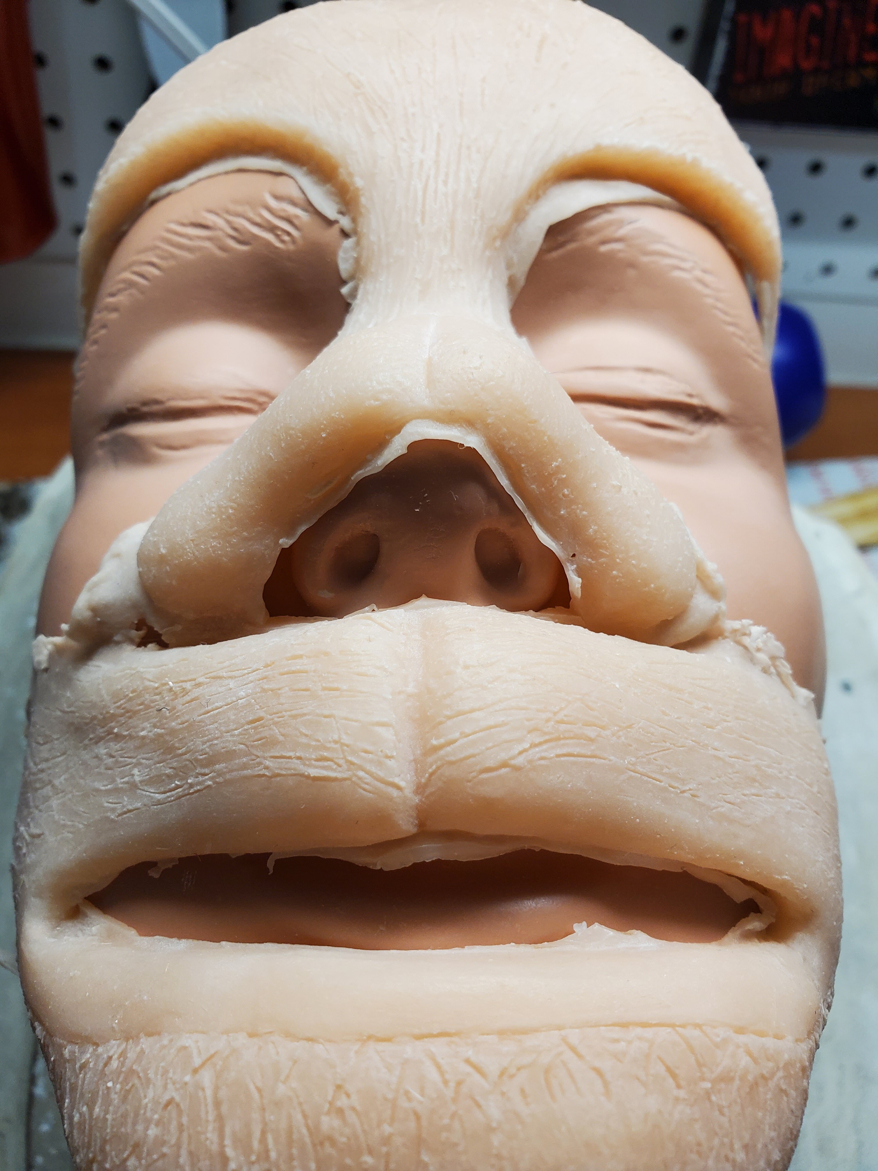

So, yeah, waaaaay to much Slacker! Smooth-On Called me back yesterday and said the same thing! Because I was using the DragonSkin Pro especially, I was using too much Slacker. It needed to be 50g A + 50g B + 50g Slacker. And guess what folks....it worked!!! The edges didn't come out as smooth as I wanted, but they should be workable with Skin Tite...all in all, not too terribly horrible for my first attempt ever! Thank you all for your insight, comments, help and encouragement; I hope this is the beginning of a long lasting relationship, here in this forum!
That´s a tricky part. You cant first work it out in the sculpt stage, I´m sure you´ll find videos of how to get feather thin edges using IPA alcohol and/or talc to smooth down the clay. Also there are ways of preparing the molds that will aid to get thinner edges (look for prosthetic molds and take a look at how they´re done).
Another route to get good blending edges is to investigate about encapsulating with bald cap material (baldiez or similar). Edges can be easily blended with IPA alcohol that way.
