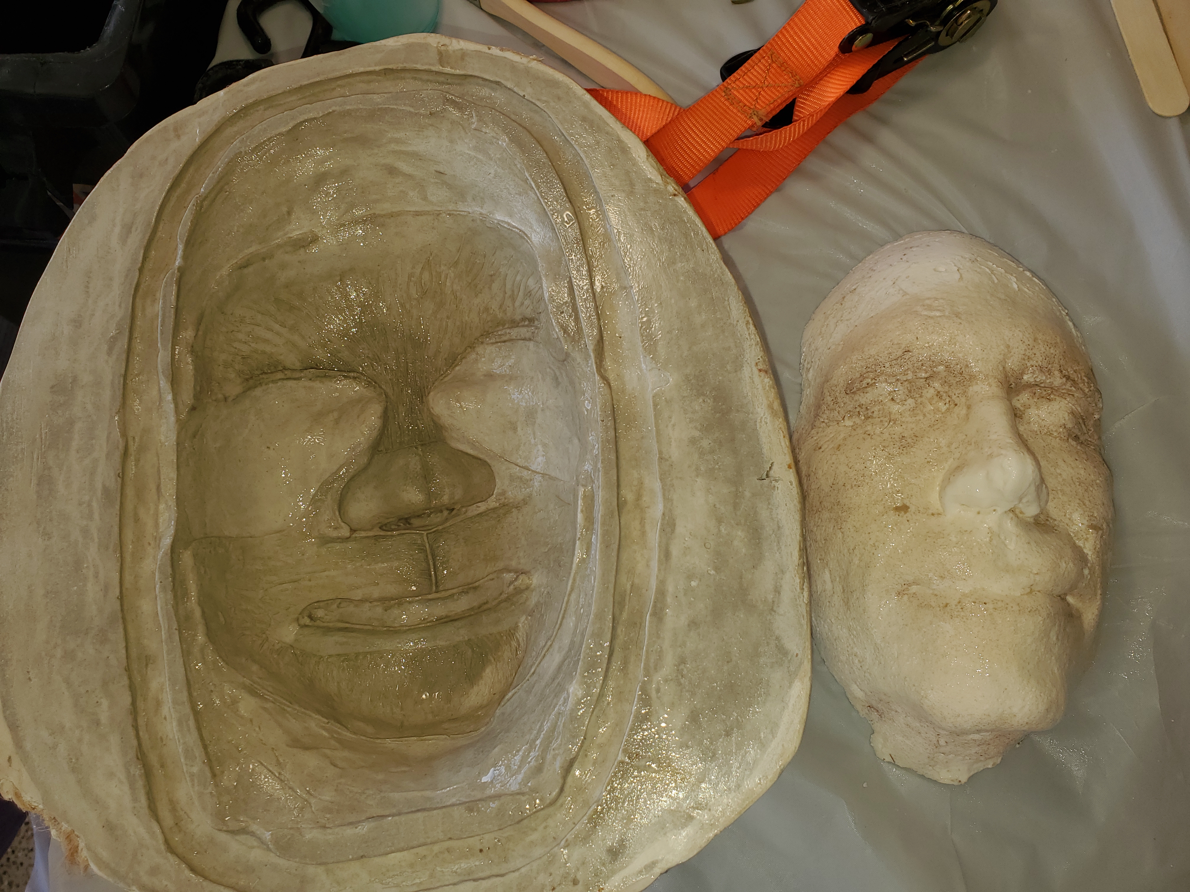

So, I've now attempted twice to make my silicone face prosthetic that I am making for a short film...its Chewbacca-ish! I followed all the directions on paper & the smooth-on videos to the letter. Both times it came out beyond sticky and not really solidified...meaning, I could alter its shape simply by pulling on it and it didn't go back to where it was meant to be. I'm wondering if it's the Slacker at this point? When I do the mix up for the encapsulate membrane, what hardens in the leftover cup is perfect....why does the slacker worsen it...I thought it was supposed to help. Should I just make it without the slacker?

The plain DgSkin does cure properly in the cups. The DgSkin + Slacker does not. I used 50g part A & B, 100g Slacker...twice. I weighed it for measuring to be sure. It has been a little colder as of late her in Vegas, but nothing crazy (upper 60's). My workshop is currently my garage. I have a project room, but it's not ventilated properly; so, I moved out there for this project. My point being, I tried to check off all the boxes. I realize that doesn't always make for a perfect outcome, but my fingers were crossed, lol!

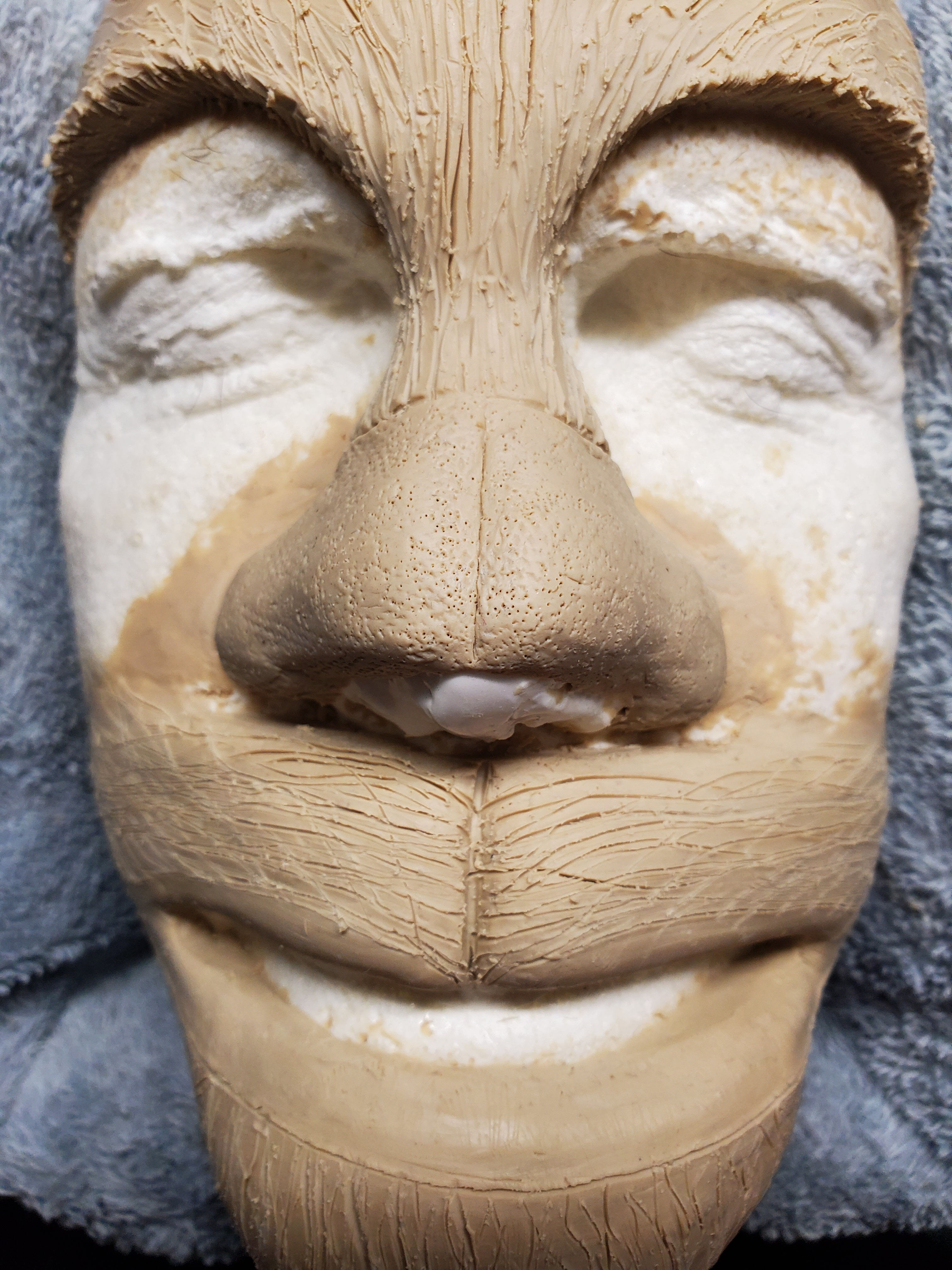

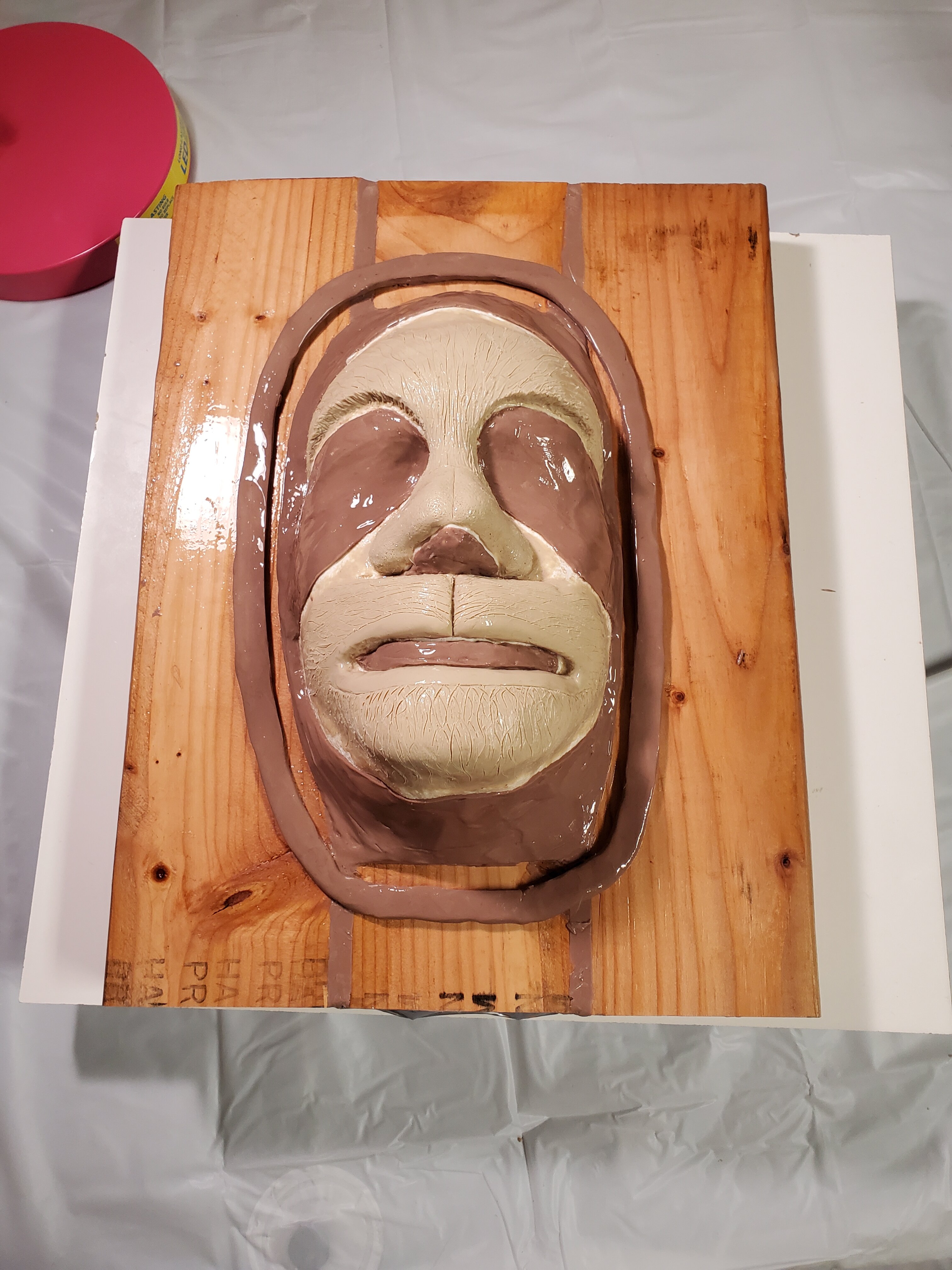

Love the mold n trick!! Thank you! Sculting I actually enjoy quite a lot!

I like your sculpt!
