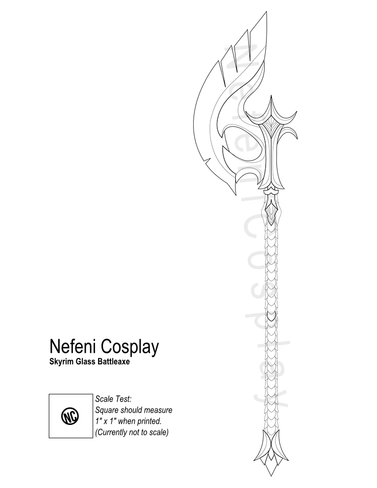

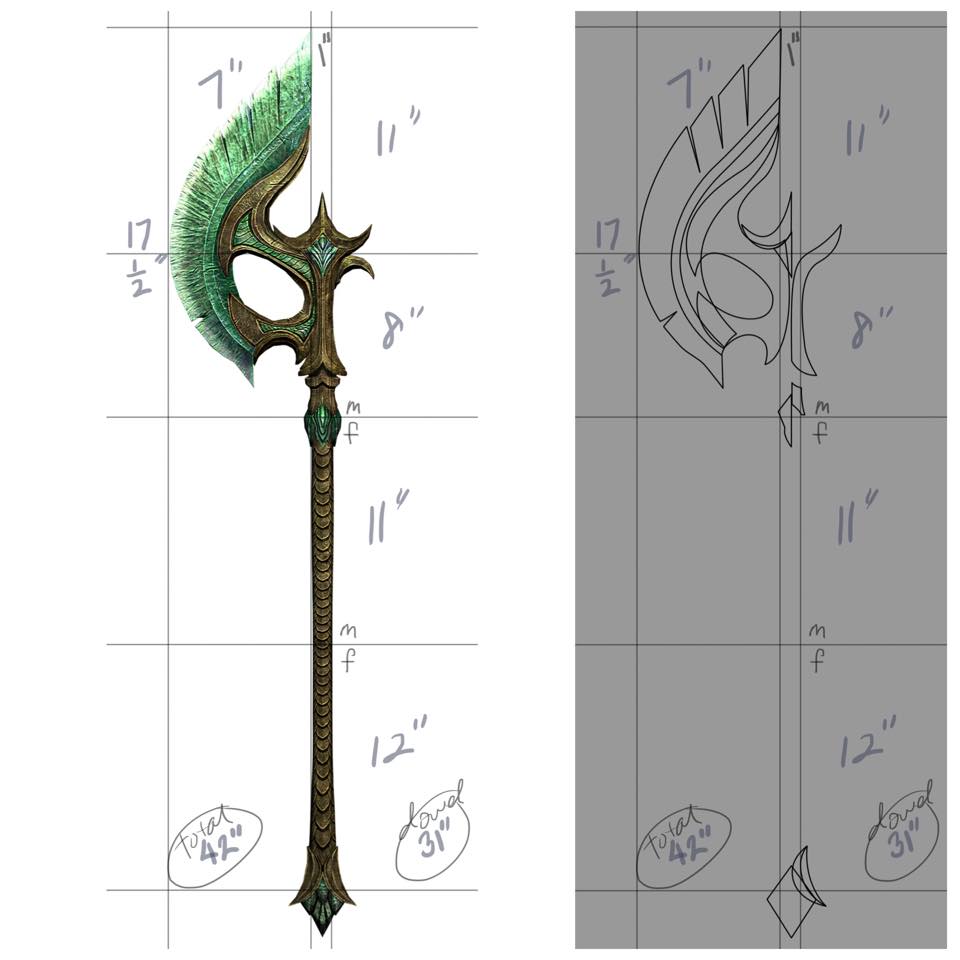

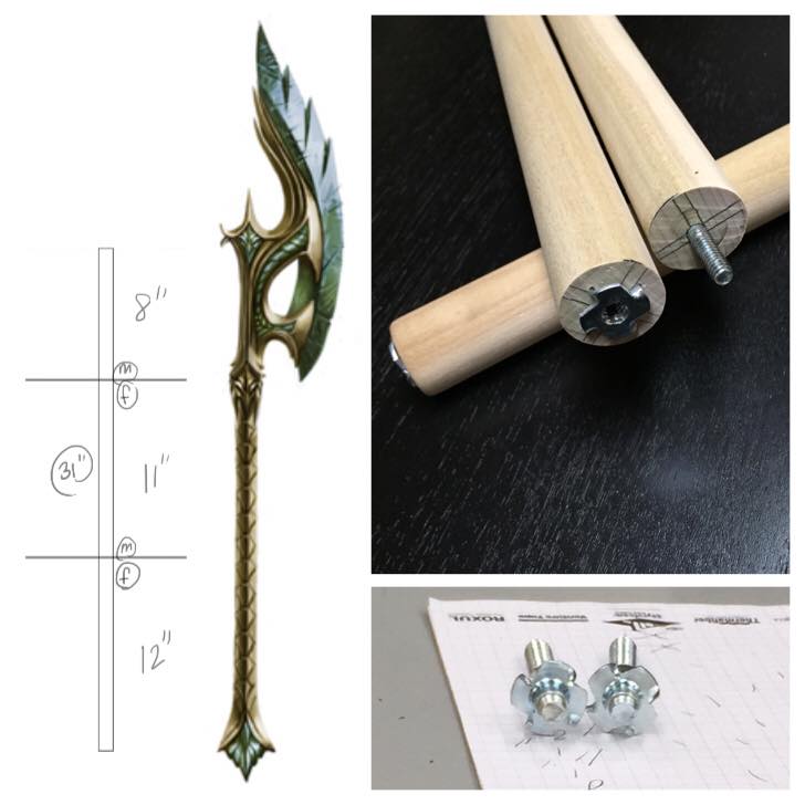

@GhostMinion @graphixmon Thank you! I'm going to construct a Glass Battleaxe. Here is a quick blueprint I made with photoshop and wood pieces that I've cut and drilled. I used t-nuts and a thread so that I can screw them apart and put them back together for easy transportation, but the t-nuts were not the best choice and I should have gone with a threaded insert. I've ordered some but do you think I can save the dowel and remove the t-nut and replace it with the threaded insert? Or do I have to start the whole thing over?

You should be able to replace it. It depends on the size of the insert and how well it would fit into the hole from the t nut. As long as the treaded insert has some grab to it, it should be fine I would think.

coregeek Hey! I didn't know you were here too! I bought the rockler threaded inserts to replace the t-nuts in the wooden dowels, The quality is great! The ones I got was 1/4 inch and screws into the threads nicely. But the hole that was drilled for the t-nut is too small to accommodate the threaded insert. I will need to make that hole wider. Do you have a suggestion for the setting I should use for my power drill? Or which drill I should get? It says that the pilot hole should be 20 for 1/4 but honestly, I haven't done my research for wood working yet and I'm pretty bad at it haha.

Update: I'm starting the Glass Battleaxe build and I just finished the blueprint. I'm going to be making this the cosplayer's way and not the prop-maker's way unfortunately. I plan on traveling with it and I need to be able to take the axe apart and put it into a suitcase. I will be using a wooden dowel cut into 3 sections with EVA foam as the base of the axe head. Then I will cover everything with worbla and add details on top. That's the plan so far!
