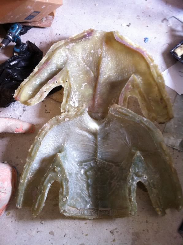

When i did the P1 head mould, i used BALLS as location points and bolted it together, the balls were ok but a couple got stuck, so this time i decided to try the grooves instead, the gaps between the grooves will indeed be the places for the drill holes and then bolts. I will be drilling and bolting prior to me splitting it, to make sure they line up well.

Well, i got it finally finished at 11.15 last night, so i got up early today and decided to try crack it open.
5 minutes into the attempted opening and .......... DISASTER !!!!!!!!!!!!!!!
I got a fibreglass splinter in my finger which put my time schedule back by 2 minutes :)
haha, another 5 minutes and POP , the mould sprung open and off popped both sides. I have since washed the mould out , then bolted it back together, looking down inside the mould, the seems appear to be very tight which i am uber happy about. I have moved it to my shed to sit in a nice warm room for a few weeks to finish curing completely.

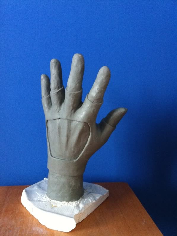

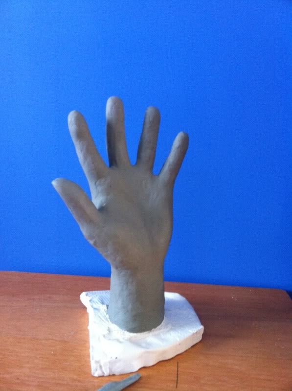

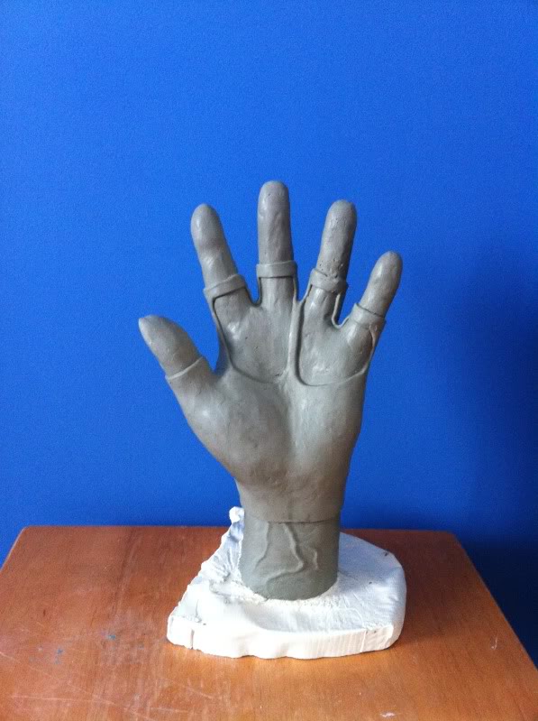

Back to the clay throwing. So i spent 3 hours on this today getting it mostly blocked out, still quite rough but the details will hid most of that.
1st i coverd the hand in about 1-2mm in clay giving me enough room inside for my hands when the silicone glove(s) are made.
Then i just used a roller to thin out some clay and make the glove. I added a couple of veins just for the hell of it, but next i will be amending the glove and then elongating the fingers by approx 1/2 inch before i add the nails, to give me a overall look of the shape and structure of the hand before i move into detailing.

Looking awesome, Lee! Jerk, getting that far in three hours, :down:
If I may, before you get too far along, don't forget the wrist tendons...
