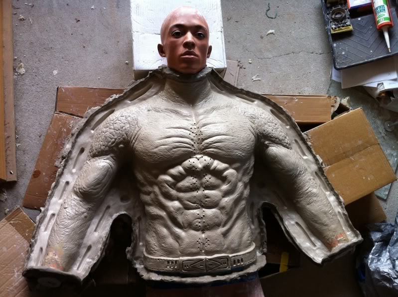

heres a pic pre GELCOAT.
I have done 2 layers of gelcoat, but I am waiting to do another gelcoat layer as it is alittle thin in certain places. i have to finish this today front and back, so wish me luck eh :) i could be here till stupid oclock.

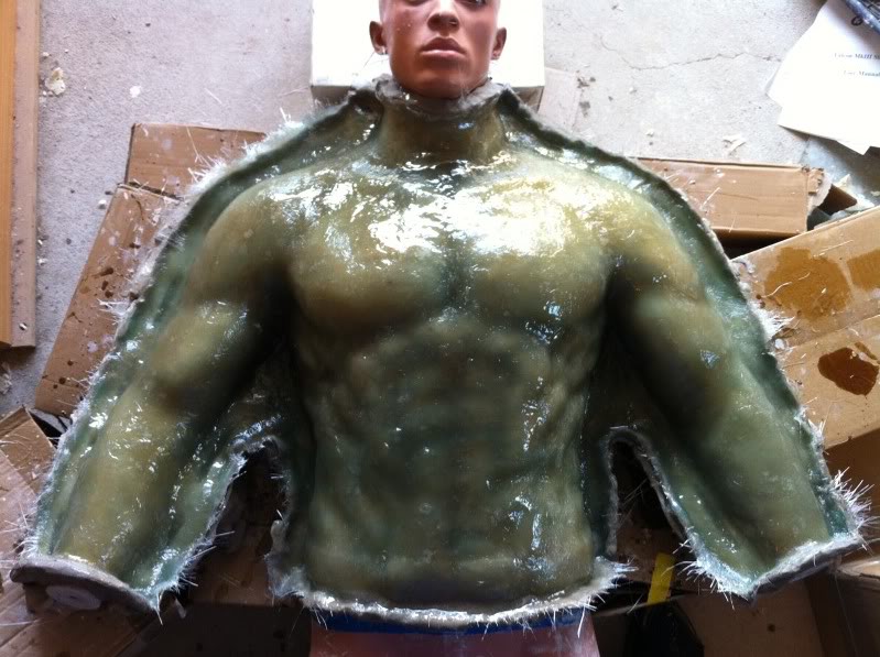

Anyhooooo, picture of the gel coat layer, i have actually also done 2 layers of cloth and resin, currently debating if i should do a 3rd or not. hmmmmm
i will post pics of the fully moulded front before i move onto the back.
After a quick chat with George, i added a 3rd cloth coat, the temp seems to have dropped here alittle so i think i have a hour or 2 before i can flip him over and ( Lee choses words very carefully ) work on the back half of the mould.

ok ..here are a few concerns about the mold. you decided to clay wall your mold instead of bending metal shims to make your registration keys. Your current wall has long keys sculpted in, but not much space separating each key, and not much room above them. To really get this mold together tight you will want to drill holes and bolt it together. You could band strap it like a stone mold, but im still worried about the seal considering you are using silicone. On that note, are you planning on painting the silicone into the mold? Im not noticing any pour spouts ( if you had a lycra undesuit, you could place it over the core ..the mannequin ..then replace it into the mold) you would drill very small "bleeder" holes through out the mold, with two pour spouts at the high points ( shoulders) ..as you pour the silicone into the spouts, the bleeders will leak silicone, letting you know where the fill is at. As each hole starts to bleed you plug it with klean klay. The silicone will bond to the lycra suit giving you a fabric re-enforcement for the suit as a whole.
Just let me know when you want a hand with the leg skins :)
I don't know if this is a daft question as I've never moulded anything bigger than a bio, will you be doing a support jacket, as I would have thought the fibreglass on something this big would flex a fair bit?
