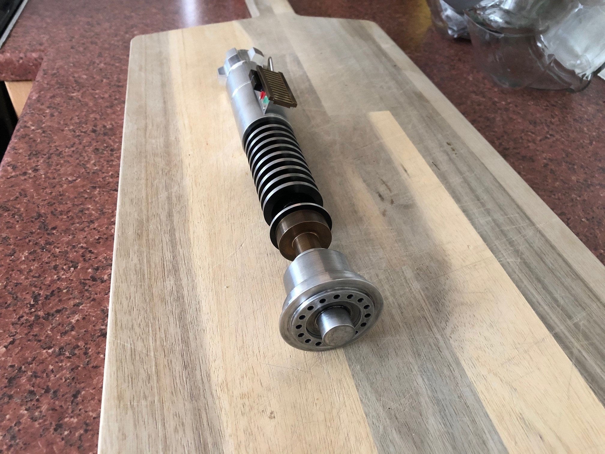

I love romans v4 as well. Once I’m done fx-ing it I’ll show it off.
I’ve upgraded my control box and emitter, and done some custom machine work to it
My issue with the control box is kind of unfixable. I just don't like the way it kinda juts out out of the hilt, like it was just glued onto a round tube. Which, in fairness, it sort of was
Hmmm... I don’t follow. When I get home I’ll look at mine see if I understand better
I was referring to the bigger arrows and the deleted arrow plate
Now his new box is smooth with larger arrows
The the emitter has been reworked
It’s one of my top 5 favorite hilts I own
It's mostly not liking the way the control box connects to the hilt. It mimics a Graflex control box, but where that connects with curved lines and the sidebars, the Hero has straight lines and right angles. It's a small detail that's just not to my tastes. Which is a bummer, since I do like the black buttons, and arrows, and the copper rails and clamp card

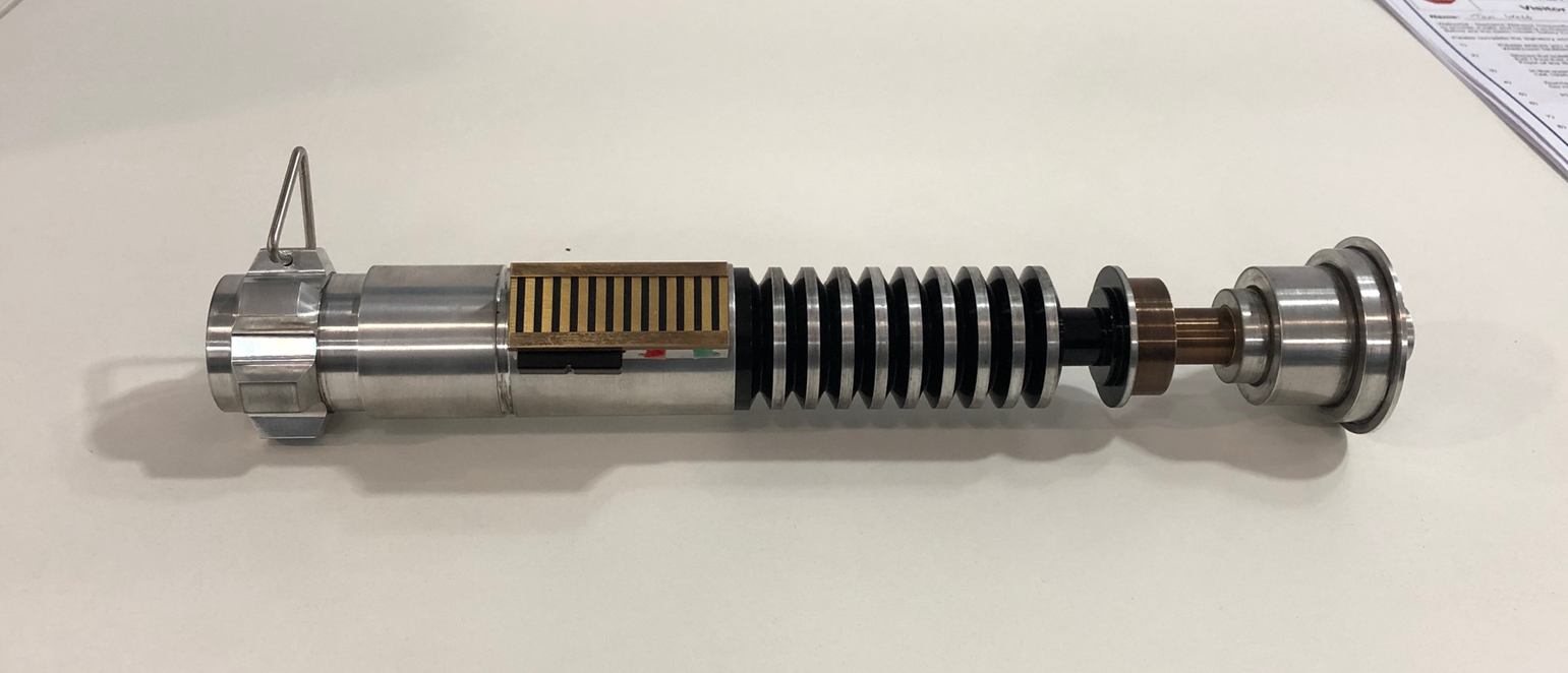

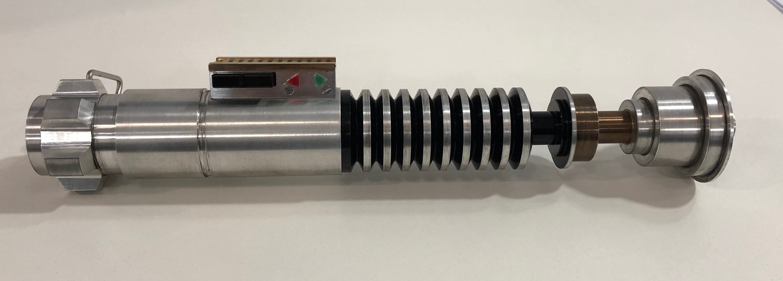

First off all joking aside, I am totally blown away with Roman Props new Balance v4! If anyone is wondering about the creepy uncle, Seths gave lukes green lightsaber in TLJ the nickname "the creepy uncle" and once he said that it has stuck with me! so from there on out i have always referred to this saber as just that! so thank you seth!
This isn't really a tutorial because i took many liberties with this project, and its more of a fun free wheeling afternoons work. The saber came to me mostly assembled, minus the tri ring, and arrows.
so right away i had to take it all apart and see what makes it tick
all beautiful cnc'ed aluminum, and copper, anodize... just gorgeous!
my goal was to mimic the saber's look in the picture below, which to me had some heavy aluminum weathering, though in TLJ i think the creepy uncle may be a tad bit cleaner... still up in the air until the bluray. but since this is a fun saber for me, anything goes!!
so before i start beating this up, and weathering it out, i took a nice clean shiny pic of her. before she goes off for the chemical burns!

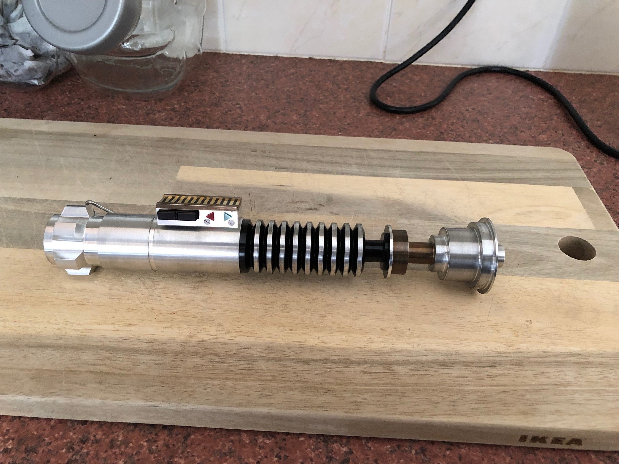

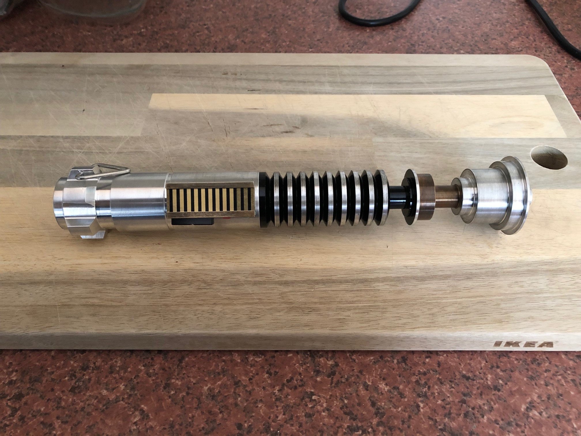

in my haste, i e6000'ed the arrows in. i wasn't thinking, i should have waited, because it would have made the oven clean bath much easier
a few hours later i just used a skewer to remove the extra e6000 webbing, cleans up great!
the pommel cubes i ended up wet sanding with 320, then polishing with my dremel with jewelers polish to smooth them over
soaked and scrubbed the pommel with alcohol to remove the polish, and then off to the driveway for the oven clean bath!
I ended up soaking them for 20 minutes. i also used a cheap paint brush from the toy section from the dollar store, with this brush i was able to put the over flow of oven clean on the control box and avoided the black button and arrows. it would have been much easier to just wait to glue the arrows on... but live and learn
let soak for 20 minutes then washed in warm soapy water, same pink water as last time! lol
it darkened it but not much....
so i let it soak again for another 20 minutes, and i got my desired look!
while i was oven cleaning the parts, i put 2 vitamins water bottle caps in a tupper ware container, poured white vinegar into the tupperware but just below the vitamin bottle caps, put the copper neck, and copper lid (not the card) on top of the bottle caps, and closed the tupperware up! they stayed in there for 4 hours to darken alittle
i began weathering the emitter with some aluminum black, and broke out the acrylics to start a wash
the rest of the body just got washes of acrylic
i screwed up pretty big on this one though... usually with D rings, i cut alittle off each side to help slide over the cube. so i didnt even attempt to put the tri ring on first, i just cut... which turned on horrible because the tri ring slides in the hole and can expose the giant cut... very disappointed in myself on this one...
WARNING:
dont cut the tri-ring. i would try to put it on without cutting, you will end up seeing the gap removed.. i never thought of this, and this was my first tri ring install so live and learn :(
When assembled, i am very happy with it. this was a fun project and have to thank roman for doing this run!
