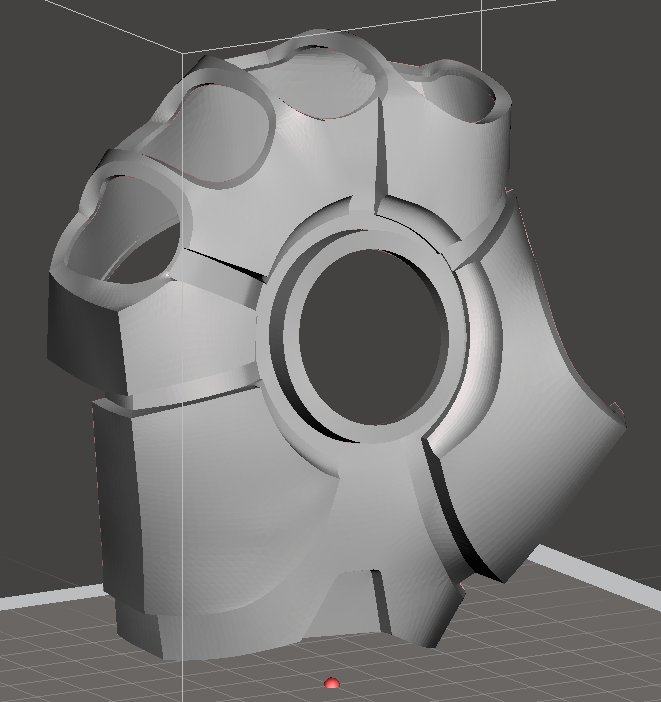

I might be on to something on the gloves issue. The latest files from do3d for the MK45 included seperate lower palm pieces.
Maybe a picture is much easier to explain it:
Now, these are devildog's files (I think) The lower palm is one piece

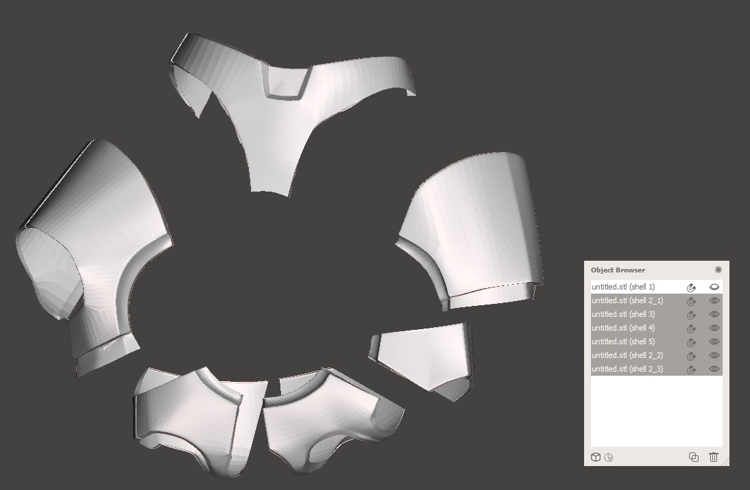

This is how do3d did the palm:
2016-06-22 17_24_04-Autodesk Meshmixer - palm-left-full-body-mk-45-3d-printable-model-stl-file-b.png
You are able to remove/hide the inner part which gives you this
2016-06-22 17_24_34-Autodesk Meshmixer - palm-left-full-body-mk-45-3d-printable-model-stl-file-b.png
All these parts are seperate and will no doubt grant a lot more movement than the fixed lower palm.
However, these files are not for free, but maybe someone with modelling skills can create something similar.
I am going to try and do it this way. The only thing to check is where to put the wires of the repulsor. A bit of foam might do the trick here.
Here is my quick stab at separating Andy's hand file that I had stored in a way mentioned above. I didnt bother splitting it into just the palm, just wanted to see how cleanly i could cut it up.
I think with a little more time spent on it, it could clean up nicely. Foam underneath or even a ninjaflex sub layer would give you decent movement, and the section on the heel of the palm would still be rigid to run wiring.
