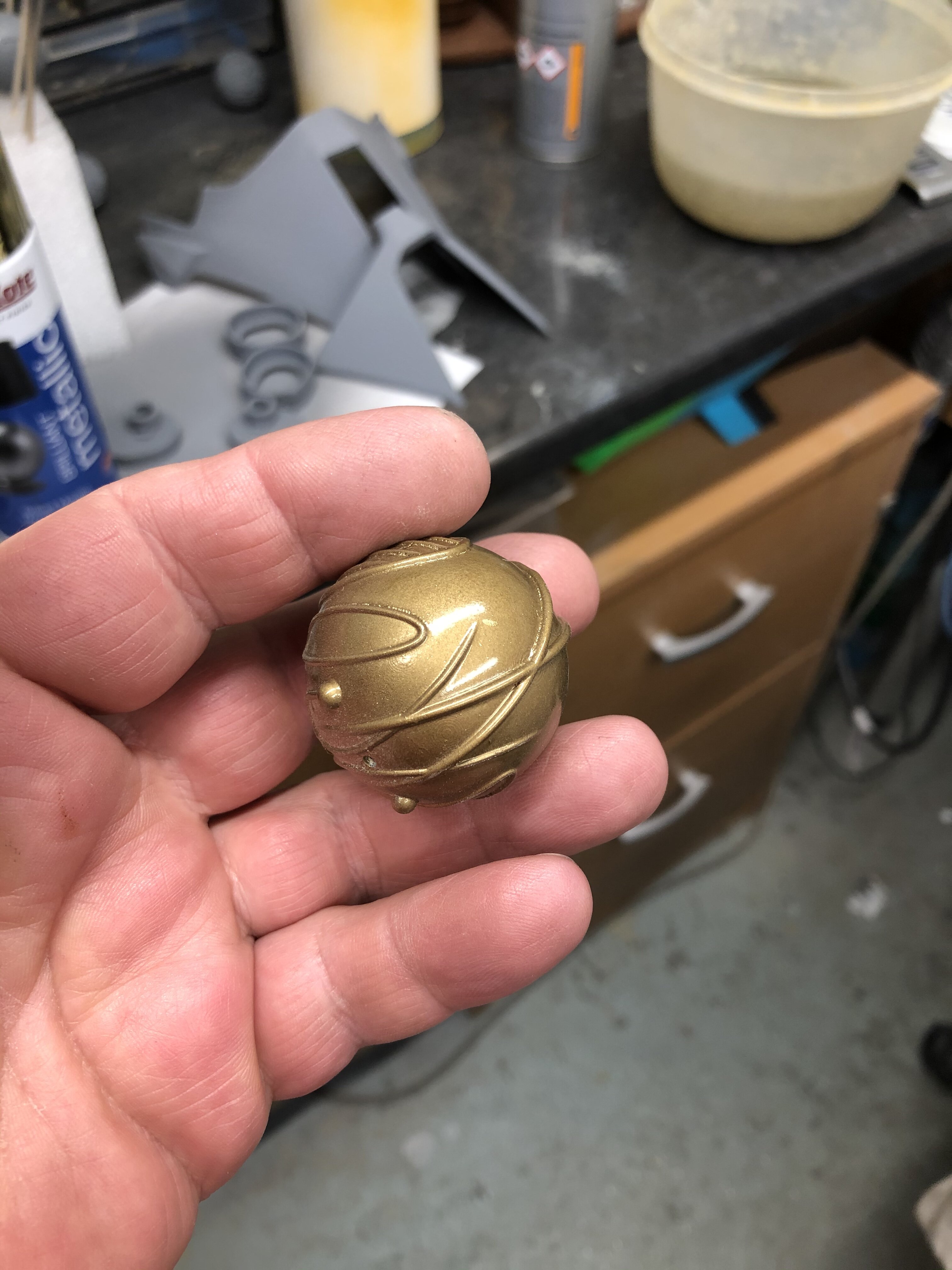

I really need some advise on some shiny gold paint for my golden snitches,
I have makes of fantastic shiny gold rattle can paint but the problem I’m having is when you touch them, over a small period of time the paint dulls, if I cover them with a clear lacquer it ruins the gold shine.
I’ve tried all 3 gold types and 2 types of clear coat, they all end up dull.

this is the result after 1 coat of gold
This is the result after they’ve dried and a layer of lacquer

For a kid's birthday party do not use gold leaf. It would be a waste. And you have to lacquer it - you don't want paint rubbing off on their fingers. Also, when using clear lacquer, try misting it on first, as the dulling is caused by the gold paint being reactivated by the lacquer - misting it on may prevent that reaction. Otherwise, it seems the Alclad clear coat is the best option to coat shiny metallic colors.
