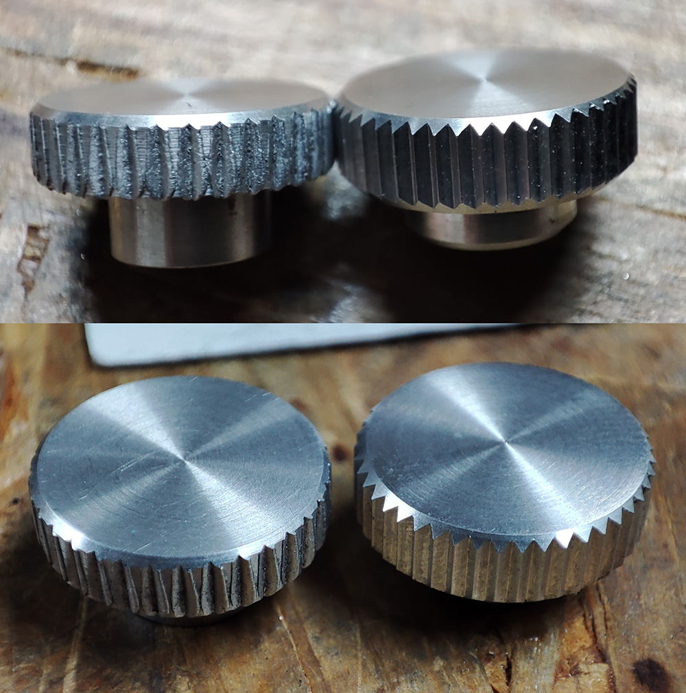

That looks beautiful! What kind of machine did you do that on?
that's a rod turned on the lathe, but then, I milled all the line on my milling machine, Otimum MH 20VL.
then I cut the rod into tiny rods with my bandsaw and beveled the edges with the lathe again.
This should have normally be all done on the lathe with a knurling tool, but as I explained before, it is very troublesome to do knurling on a small lathe as it requires a lot of pressure from the tool and the tool holder on my lathe is just not strong enough for this.
It works better with diagonal knurling, but parrallel knurling like this is always hell!
