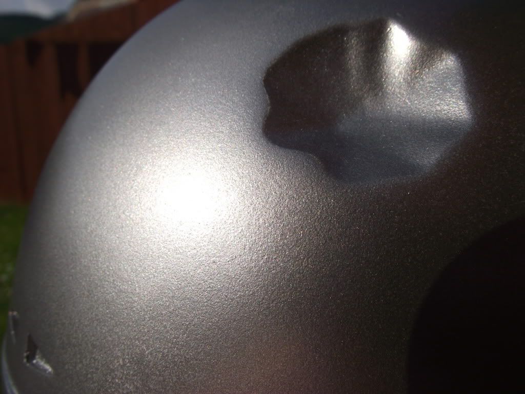

Okay so ive been busy working on the helmet, its taking a little longer than usual but I'll explain that once the paintjob is finished. So having prepped the helmet and applied the physical damage, I then added the first layer.
The silver is the only rattle can I use other than the primer. I find that once applied and prepped, it really does look like a metal finish that I really like.
Only downside is that if you apply it to heavily, the paint will start to have that orange peel texture, so thin misting layers are done, takes about 2-3 hours going to the lid every 20 minutes but its worth it.
After leaving the silver dry fully over night, I then gave it a very gentle buff with some 1500 grit wet & dry. This will hopefully help the other paints to stick to this, while also removing any imperfections that were on the paint.

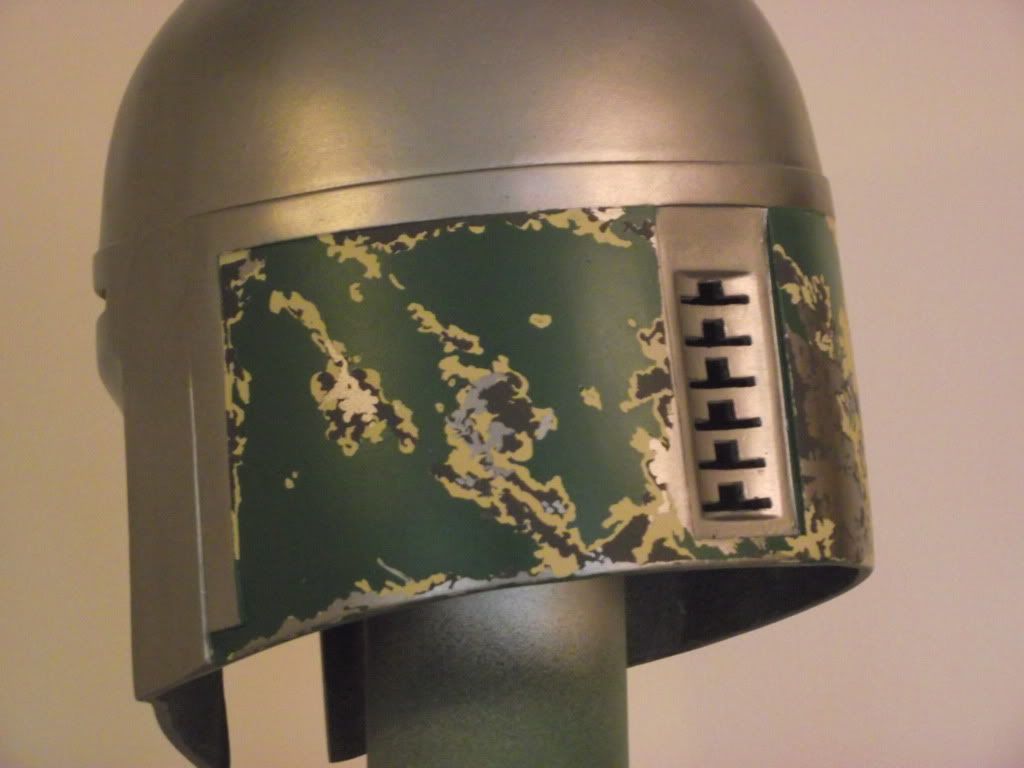

Update time,
Managed to go out and get all the paints, thinners etc... for the project.
So firstly Using the stencils I printed out and some graphite paper or wax paper,
I then placed the graphite paper underneath the stencil and placed it on the helmet. Then drawing around the details and scratches, it transfers straight onto the helmet.
Then its the usual masking process followed by applying the correct layer of paint.
I then repeated this process using the different layers of stencil for each color, when each colour was dry, I buffed it over with some 1500 grit sandpaper, this was done until I completed the back panels.
Really happy with how it turned out, I think the scaling and positions is decent as well. I found Using the stencils is so much quicker surprisingly than free handing it. If the weather is still nice now over the weekend I'll start working on the dome and lower cheeks.
