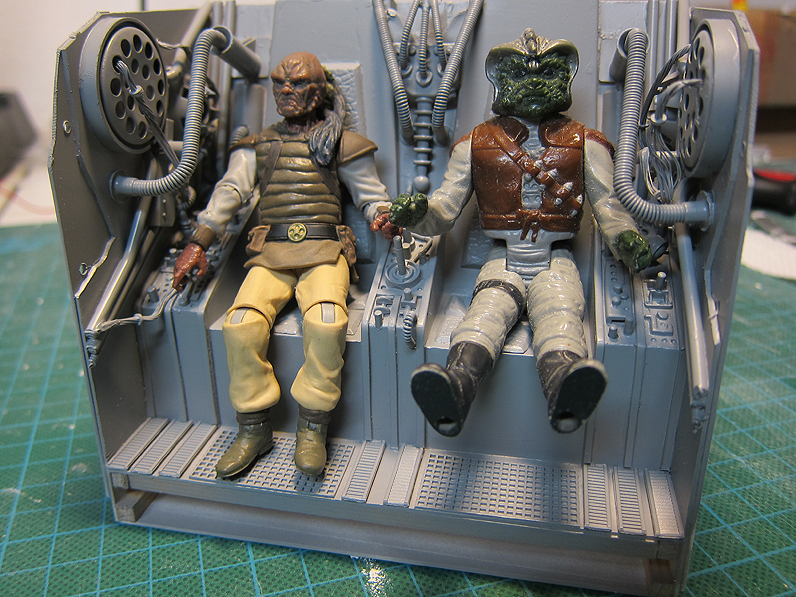

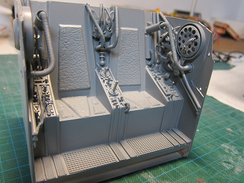

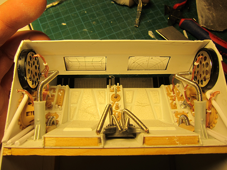

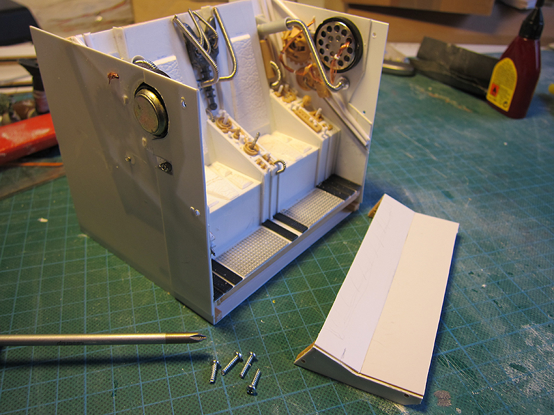

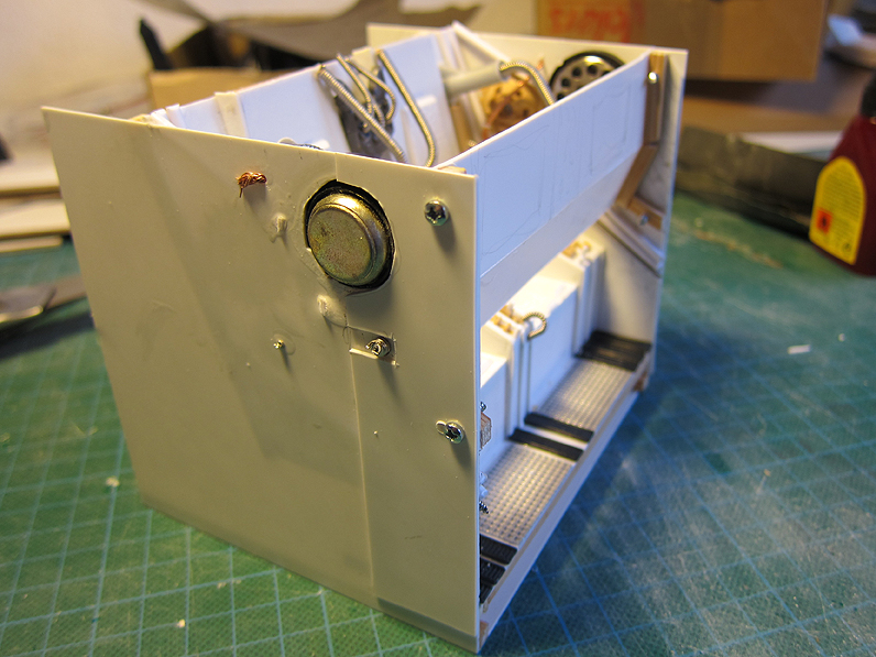

First up I decided to cut off the front part of the cockpit. Otherwise I would be in real trouble painting it. So it's now detachable with 4 screws holding it in place:

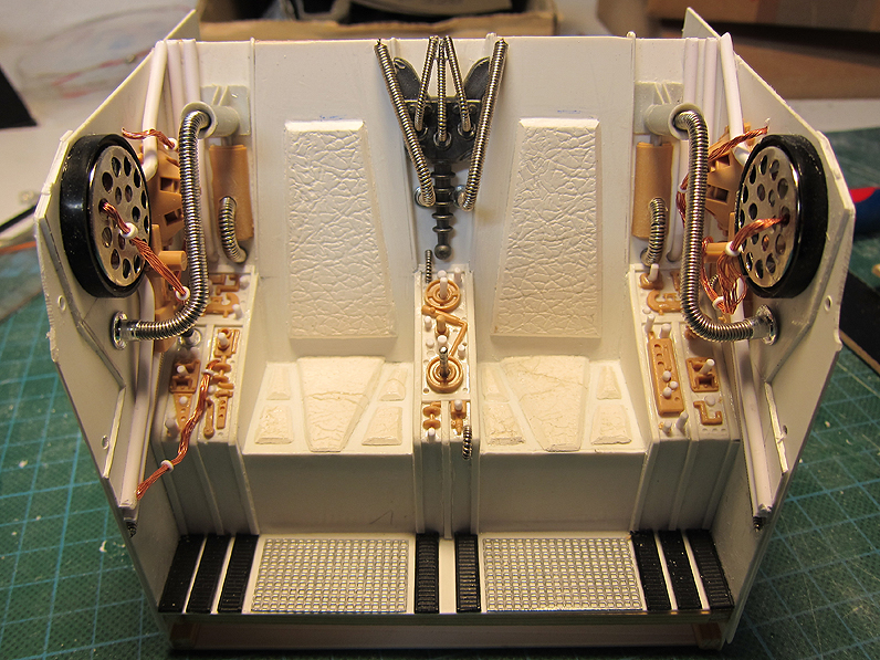

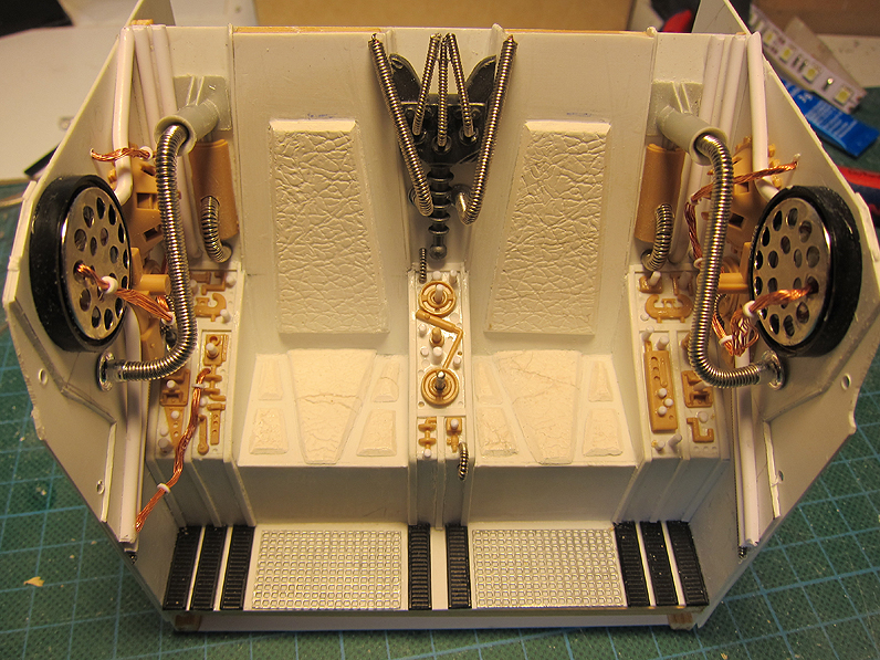

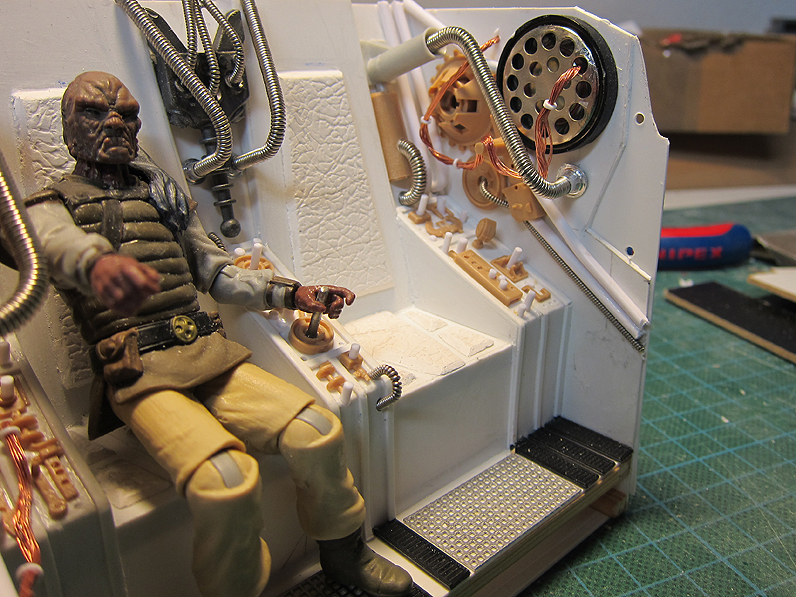

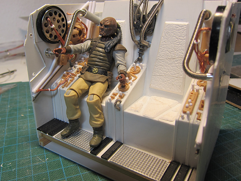

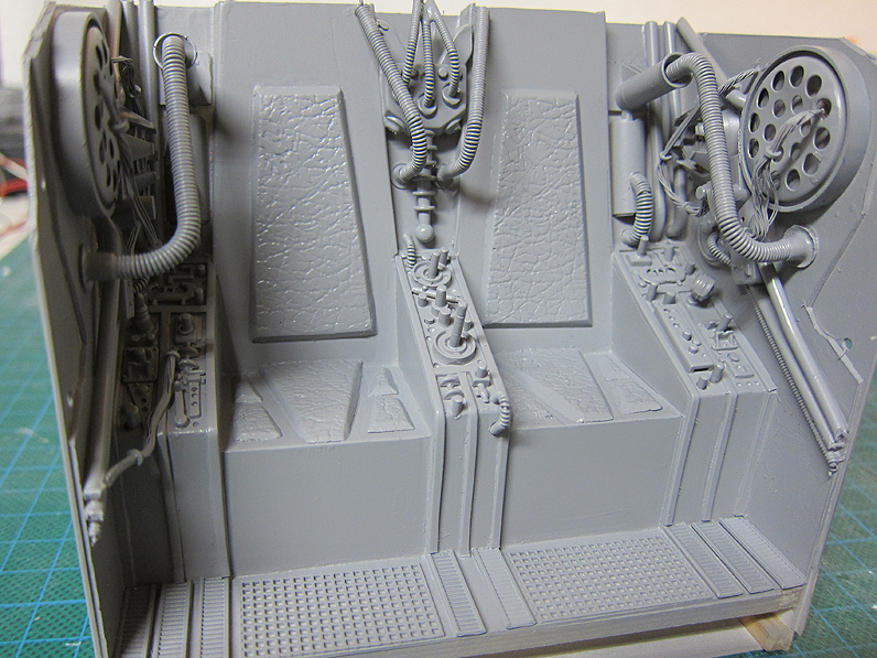

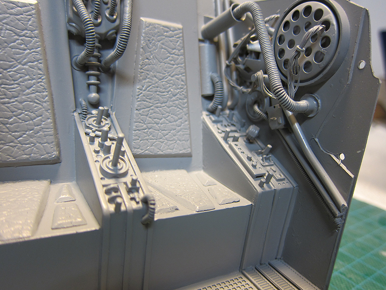

Finished the cockpit by now. The seat is an homage to the vintage AT-ST. The lever to the middle broke twice by now so it was replace by a metal lever. Some additional cables and the foot area was also completed:

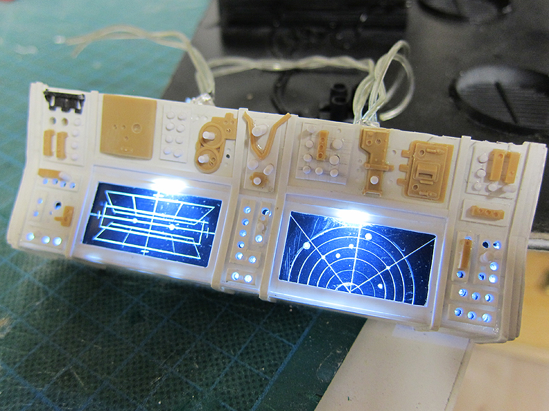

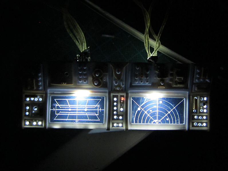

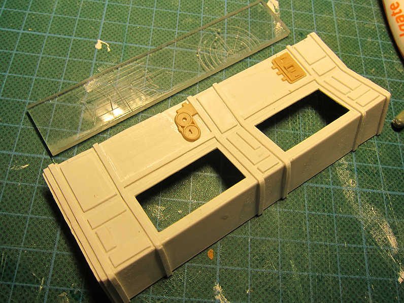

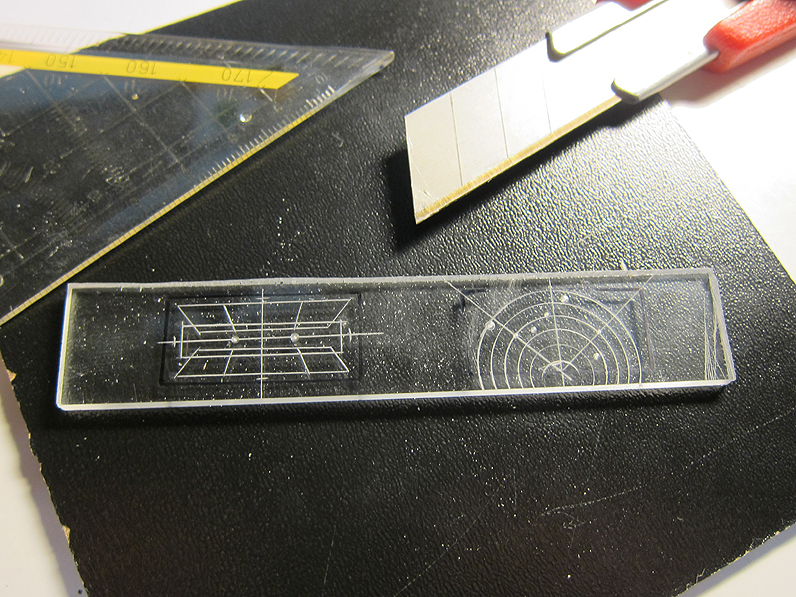

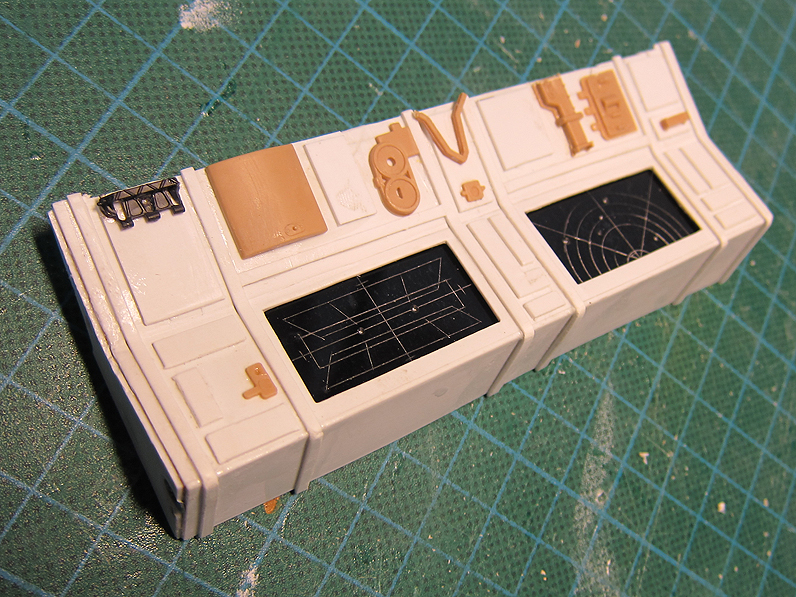

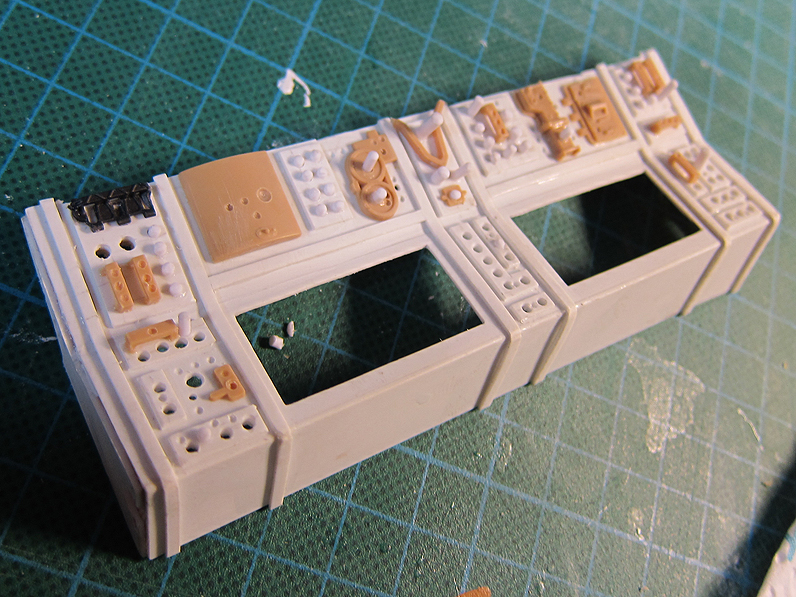

After that I wanted to do the front part. Some screens were added. Some acrylic with scratched in forms does the job very well:

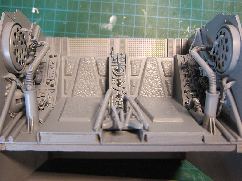

Now on with detailing this part of the cockpit:
Some ligthening check:

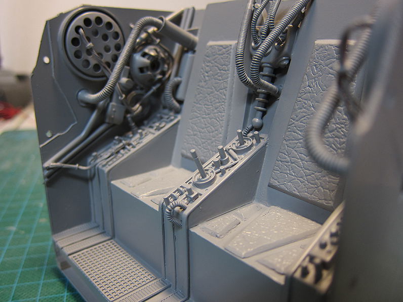

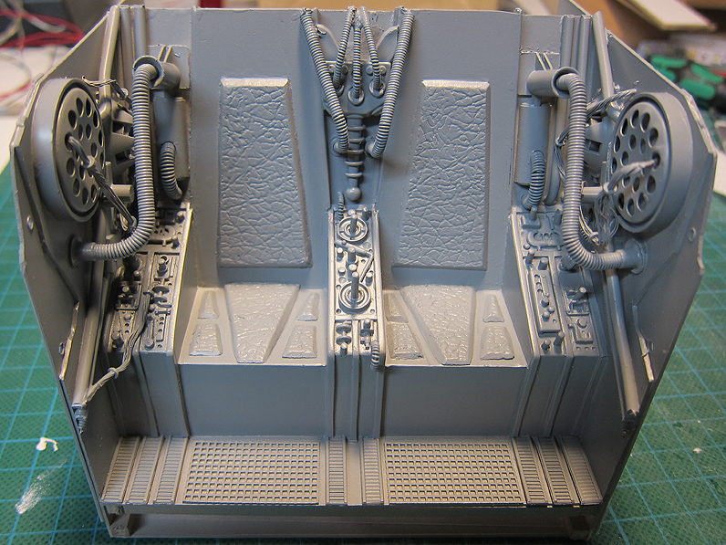

And finally the back part was primed...mmmmmmmmmmmhhh....I love priming ;)
Hope you like it. Thanks for looking.

The cockpit is now finished....well nearly. It is missing one more LED with glas fiber illumination for the arm panels. No material yet, so I will do this later.
I also primed the nose. Sadly my last rattler got empty while doing this, but it's nearly done.
Cockpit and nose mounted together:

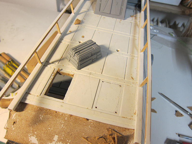

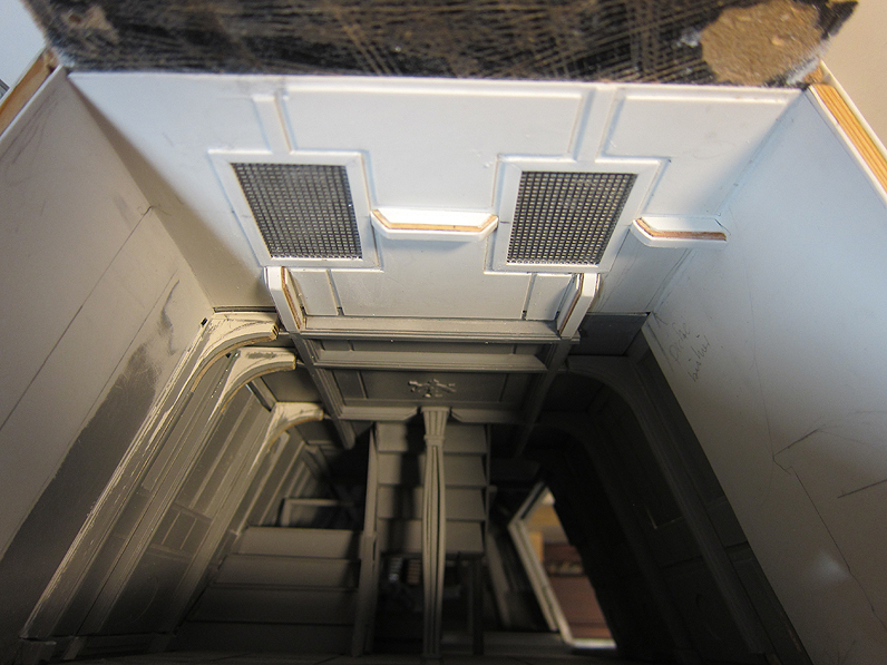

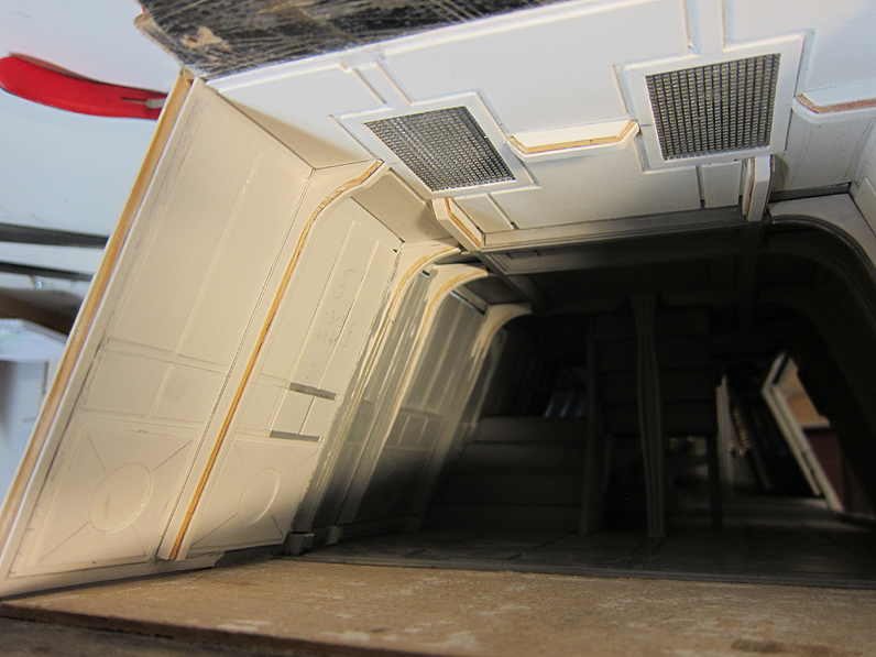

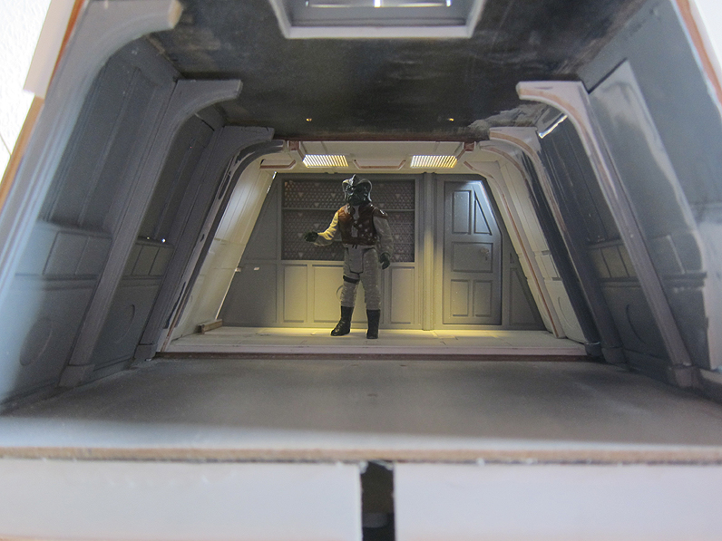

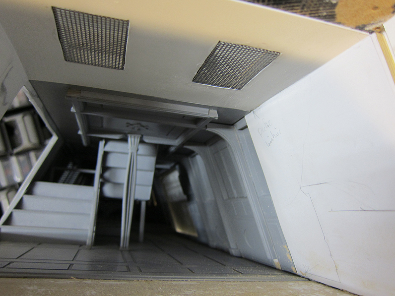

Starting with the middle part.
First up are some greeblies to finish the look from the side:

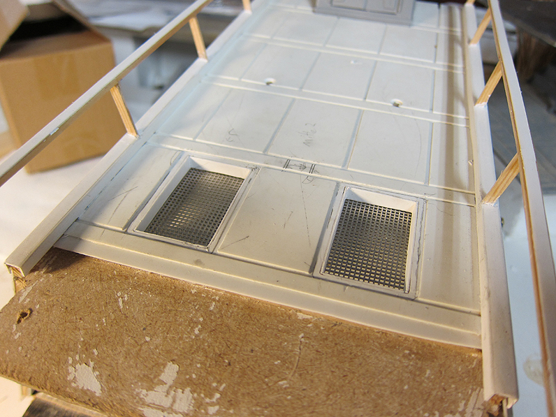

Next up was the break through for those hatches. These will be closed with some grills. Figures cant go through those hatches, so I am useing them to give some rooflight to the bar below.

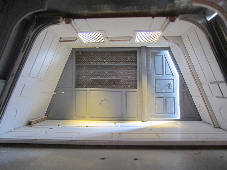

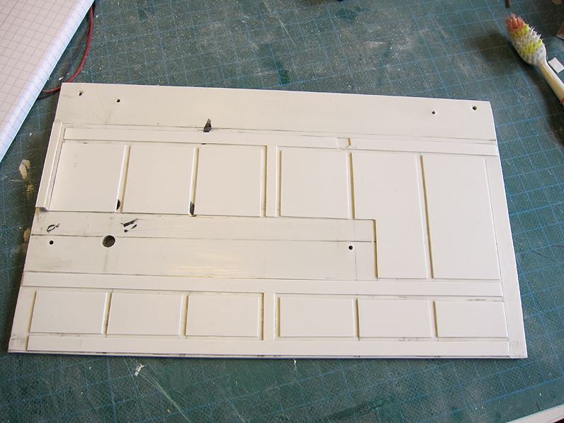

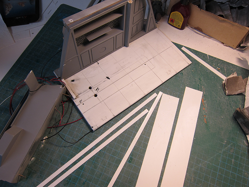

Below I needed to do the walls and ceiling for the bar part which was actually added at a later point to lengthen the ship. I also noticed some inaccuracy to the door from inside that needed to be fixed...a lot of extra work sadly:
To finish the inner of the barge the bar also needed some floor paneling.

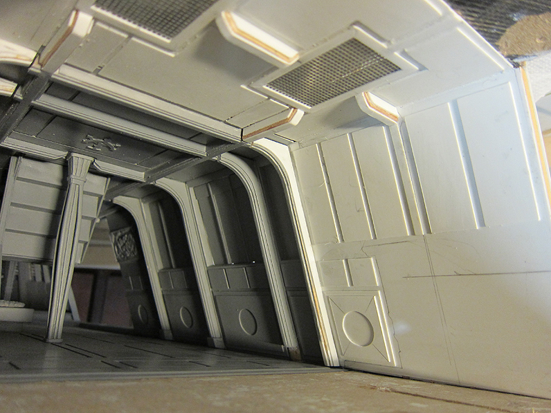

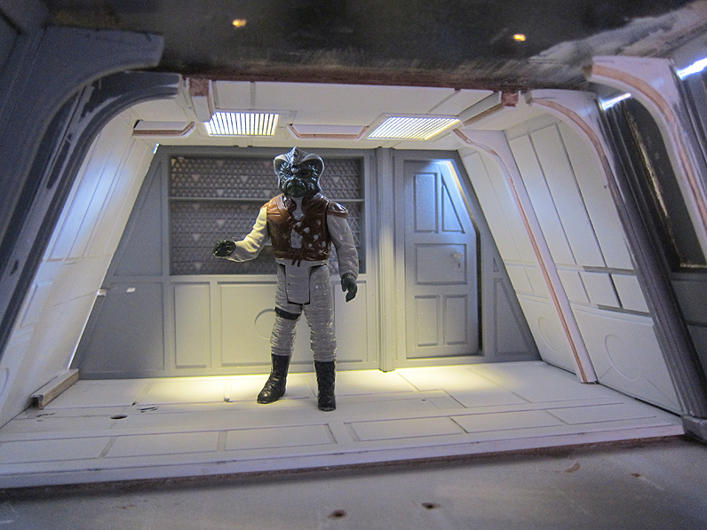

Almost done. The inside with sanded panelling to the walls, floor and ceiling:
Hope you like it. Thanks for looking!
