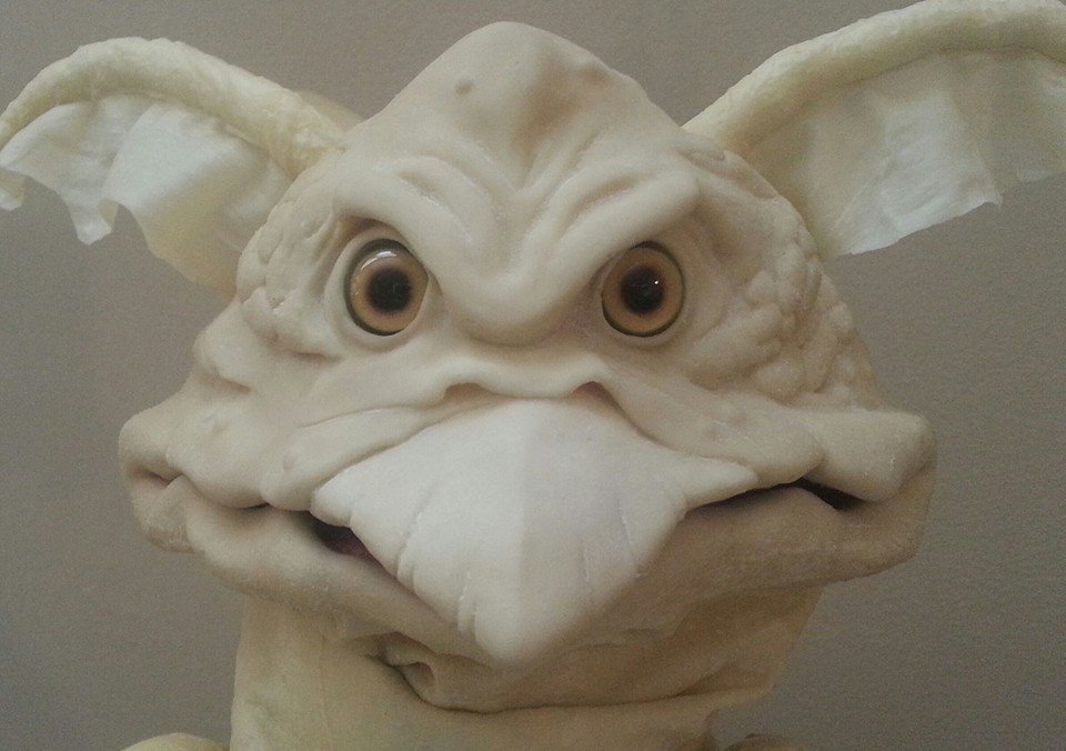

Ready for paint.

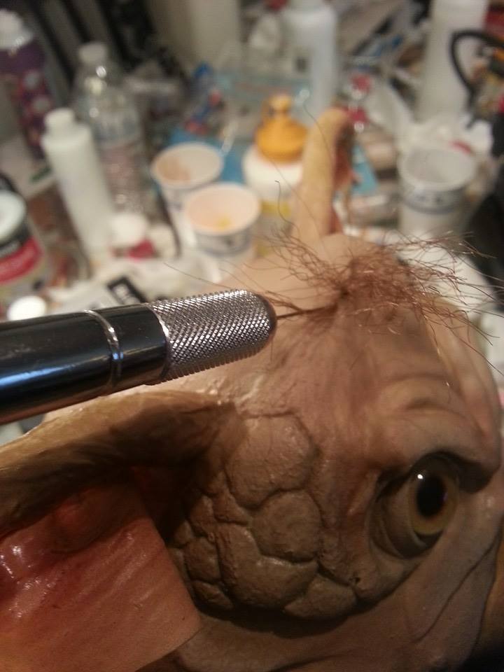

A little teaser. Starting the tedious process of punching hair. He'll likely be completely finished by tomorrow afternoon.

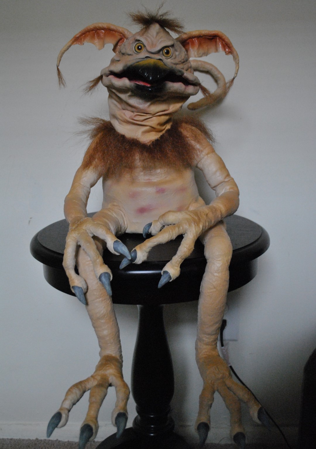

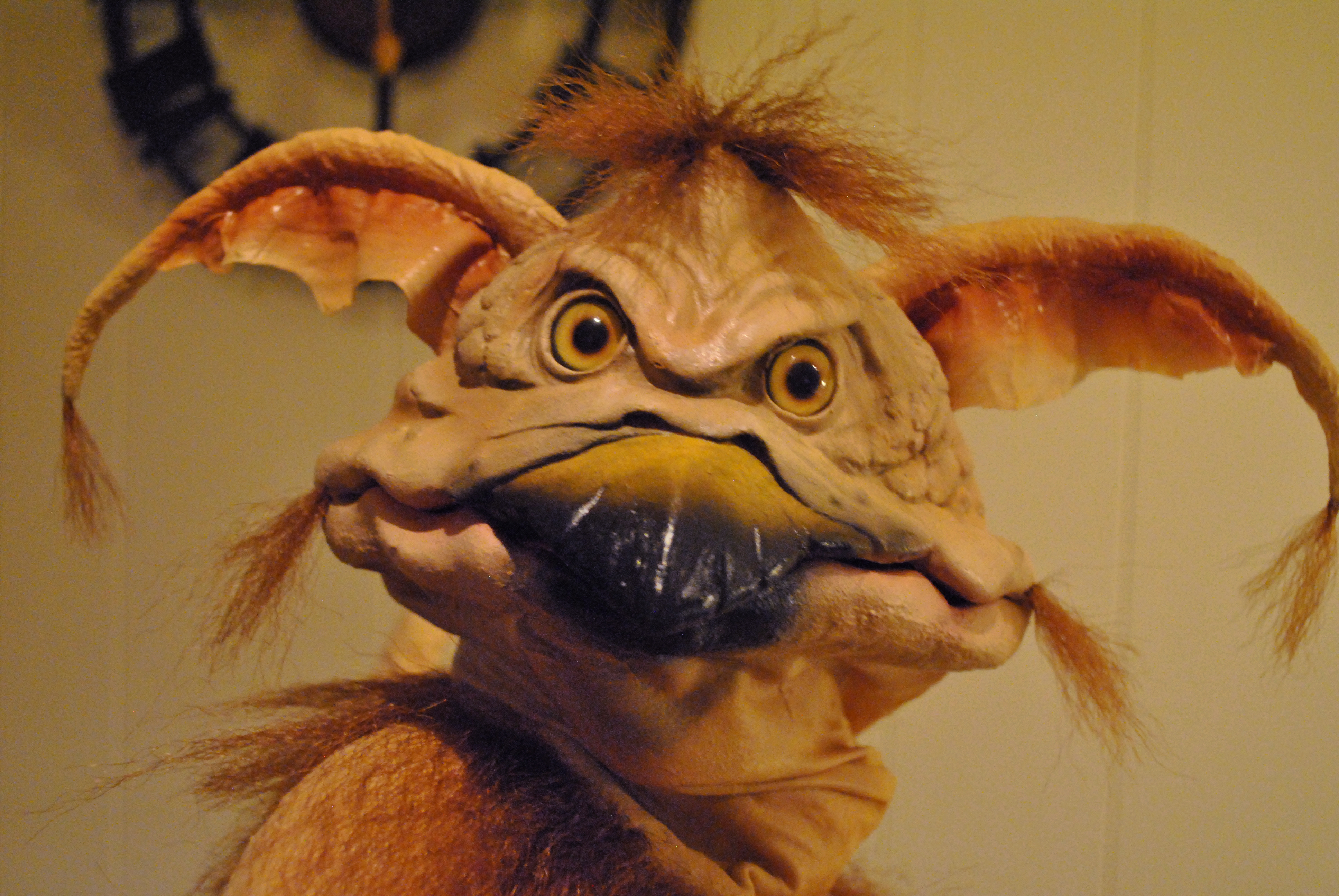

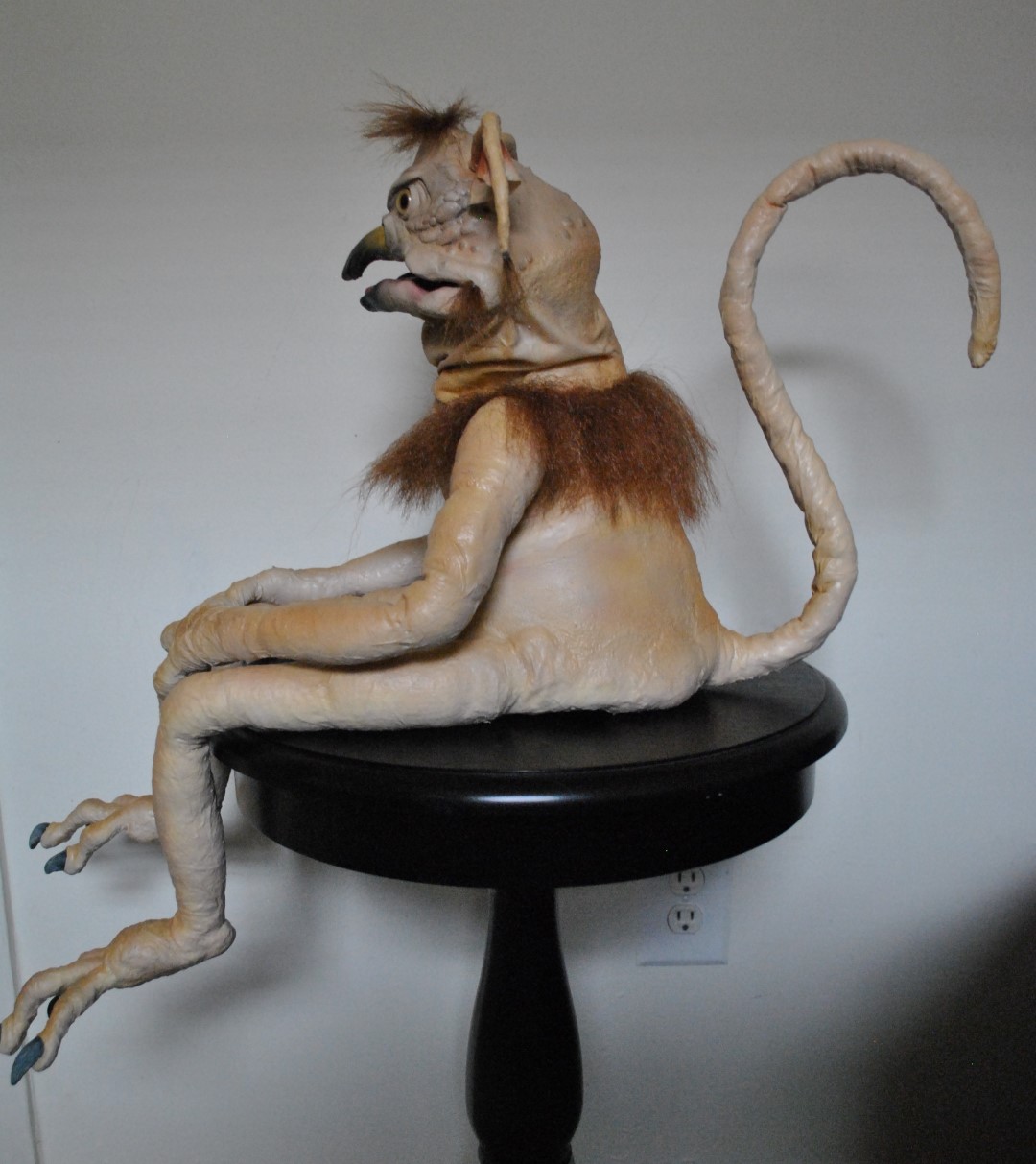

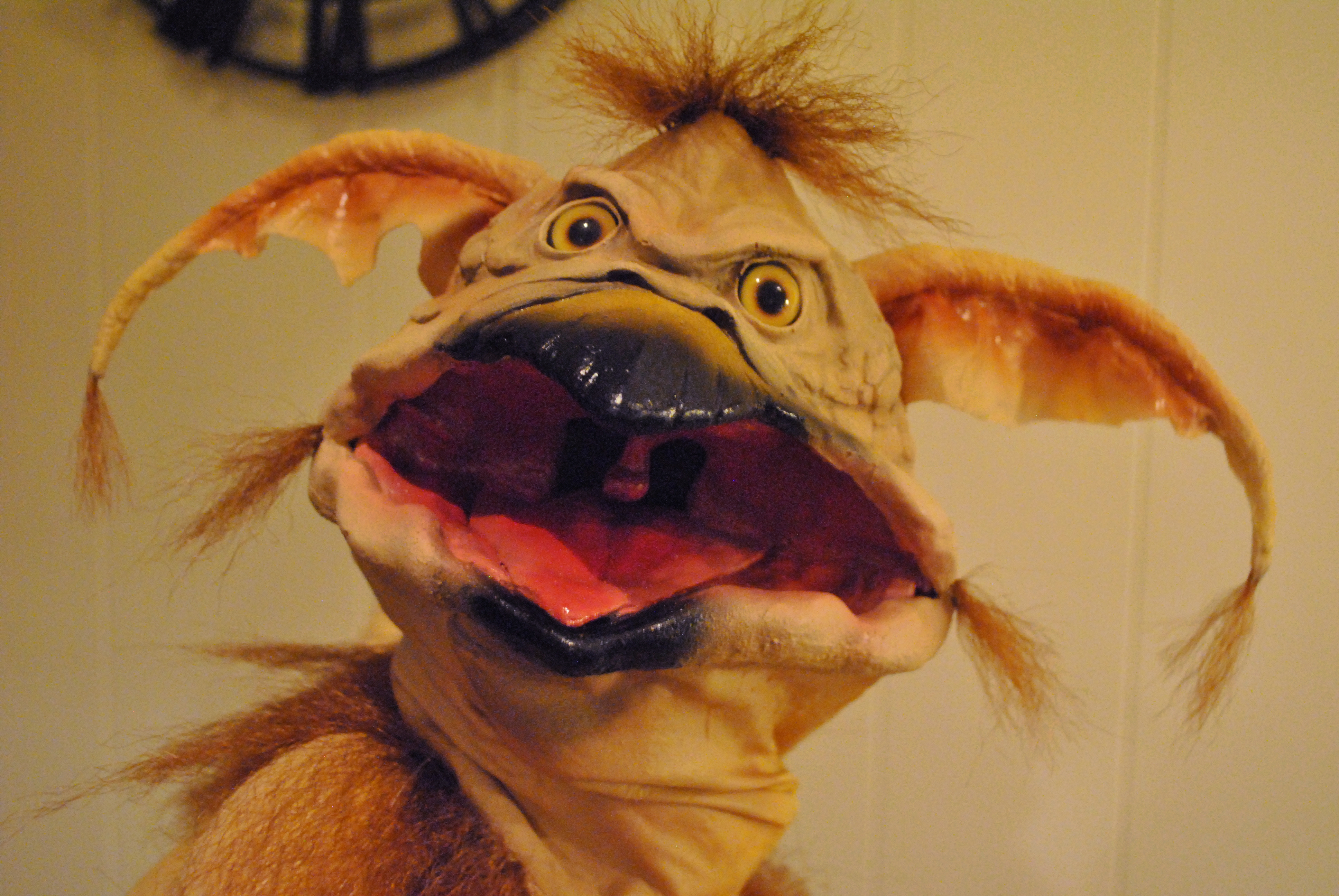

Thanks for all the compliments! I'm very happy with the way he turned out. I've learned a lot about this character. I'm going to make more of them, and improve a bit on the process and body.
Here are some more pictures of Salacious in natural light:
What kind of paint did you use?
I used acrylic paints with a latex base. I struggled a lot getting it to work with my internal mix airbrush, and discovered that is was best to use a cheap external mix brush. The mix is simple if you use a latex base (I used this one from FX Warehouse) I want to say I mixed about 4-5 parts base to one part paint. You need to be careful though, the paint will dry much darker than it looks in your bottle, the base mixes in white but dries transparent/opaque. When you use a latex base to paint latex, it adheres VERY well, with no cracking. I followed up with a very light coat of latex sealer just in case (this one).

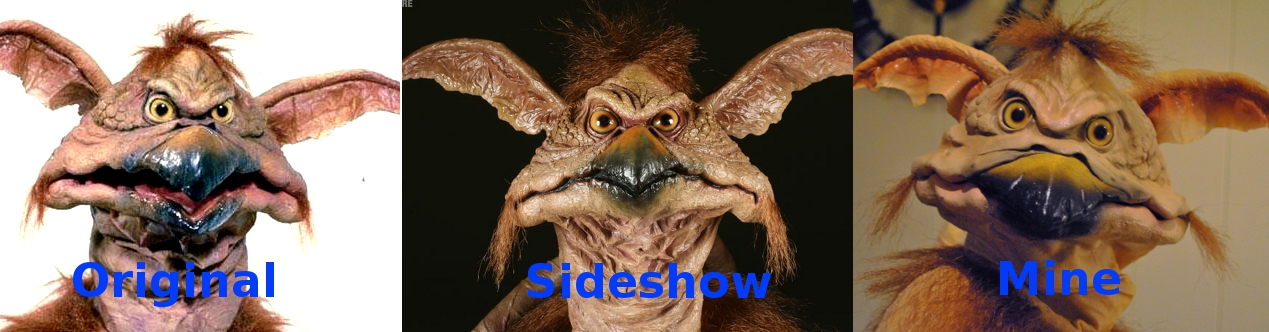

So if you are planing doing more of them and offer the for sale eventualy......would you think about a casting material which wont rotten with the years? I think thats a major problem with normal latex stuff. Remember the stuff from Illusive Concepts. I would also like to know if you have compared your version with the Sideshow Lifesize version. Are there any differences in scale? And again...really fantastic work.

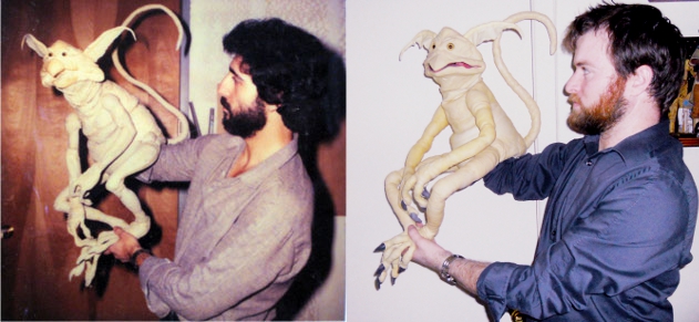

I have not yet had mine next to a Sideshow salacious. I am pretty confident with the scale of mine though. I printed out a full sized outline from on a picture of the original, and lined my parts up to it through the build. I also had quite a few pictures of people standing next to the original puppet including the one above in post #28 (which shows the scale of mine as well as that of the original). While the sideshow statue was sculpted by the original sculptor, which is really flipping cool, but I think they tried to make him look more realistic and lifelike, and there were a number of issues with it that caused me to shy away from it as a reference source. I have no real sculpting experience, and certainly no reason to brag as mine has issues with it as well, but I do feel it is a bit "truer" to the original puppet than the sideshow statue is.. but I'm sure im a little biased :angel
