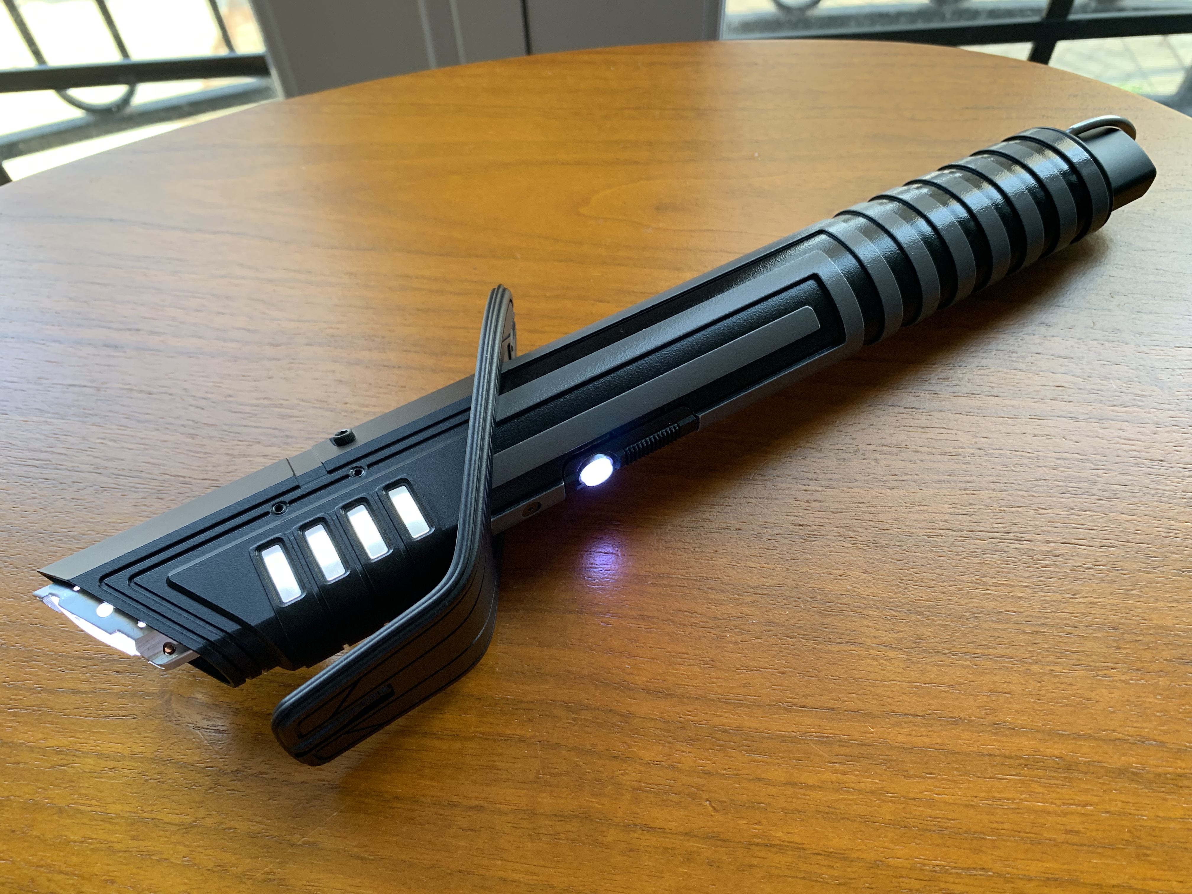

I had this issue as well. I put 112 in my config and that still didn’t light it all the way. Setting it to 160 fixed it for meYa that wasn't it. There are 111 LED's on the blade, plus the pixel in the chamber for 112. I've changed that number from 112 +/- 20 and still no luck. However, I think it turns out that I've got a short somewhere in the system because if I touch the top of the proffie board in a certain spot, the saber will light up almost all the way to the end. Will only happen if I touch the proffie board tho. I've now resoldered this thing four times. This is quickly turning in to a "hang on the wall and admire from a distance" project lol.
EDIT: Although the board is still acting funny when I touch it, in the configurator on the proffie site, I ticked "RGBW" under Blade options and that seems to have solved my problem. Not sure if it's the *actual* solution, but there ya go.
