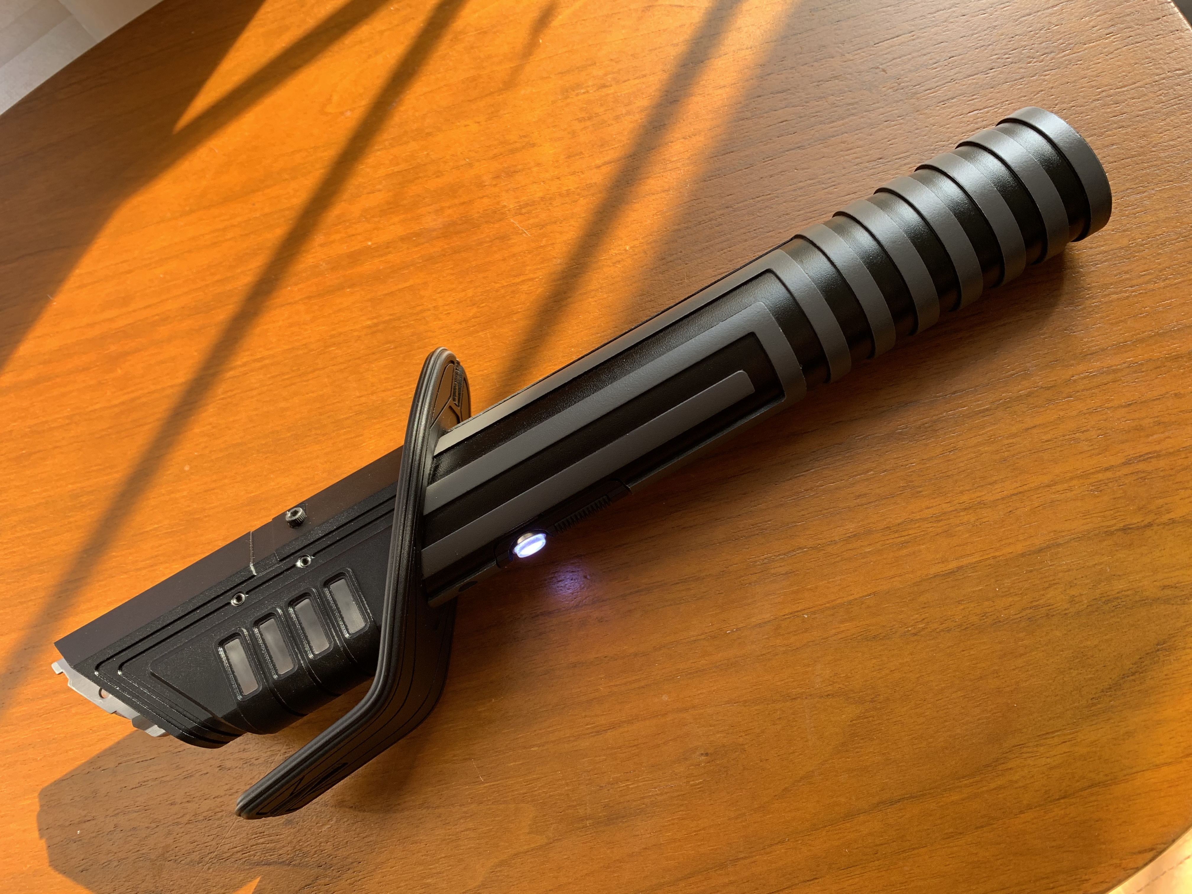

Another take on the grips. Will cover with semi-gloss clear next.

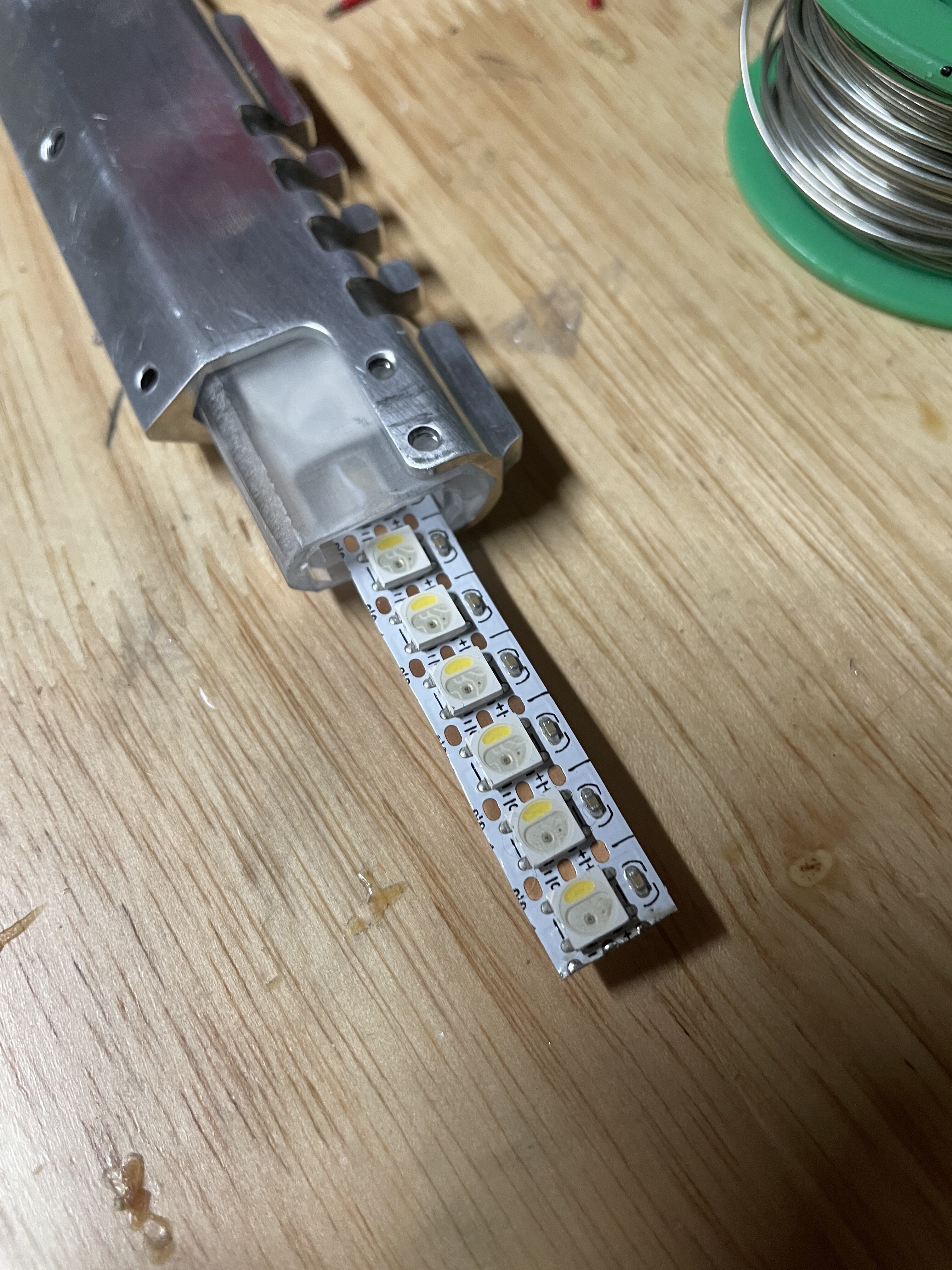

I haven’t wired a blade in a bit. So kind of a dumb question, is it from left to right. Negative, data and positive? Or data, negative and positive? I feel like the last time I did this the data was in the middle, but the writing says negative, thanks for the help!
Thank you! Going to let it cure another 24 hours then do a semi-gloss clear coat. It’s Rustoleum 2X Satin Charcoal Gray.
Potentially dumb question so I apologize in advance: did you tape/mask the recessed portions and spray the raised portion? Thanks and again it looks incredible
I masked the raised portions so I could use aluminum black on the grip walls, which had inconsistent anodizing.
After removing that tape, I masked the black anodized areas and the grip walls leaving just the raw surface exposed. I used Tamiya 6mm masking tape which worked great.
Well it’s says negative to the left of the center pad, and to the right of the center pad says positive
The middle is data

Ya that wasn't it. There are 111 LED's on the blade, plus the pixel in the chamber for 112. I've changed that number from 112 +/- 20 and still no luck. However, I think it turns out that I've got a short somewhere in the system because if I touch the top of the proffie board in a certain spot, the saber will light up almost all the way to the end. Will only happen if I touch the proffie board tho. I've now resoldered this thing four times. This is quickly turning in to a "hang on the wall and admire from a distance" project lol.
EDIT: Although the board is still acting funny when I touch it, in the configurator on the proffie site, I ticked "RGBW" under Blade options and that seems to have solved my problem. Not sure if it's the *actual* solution, but there ya go.
