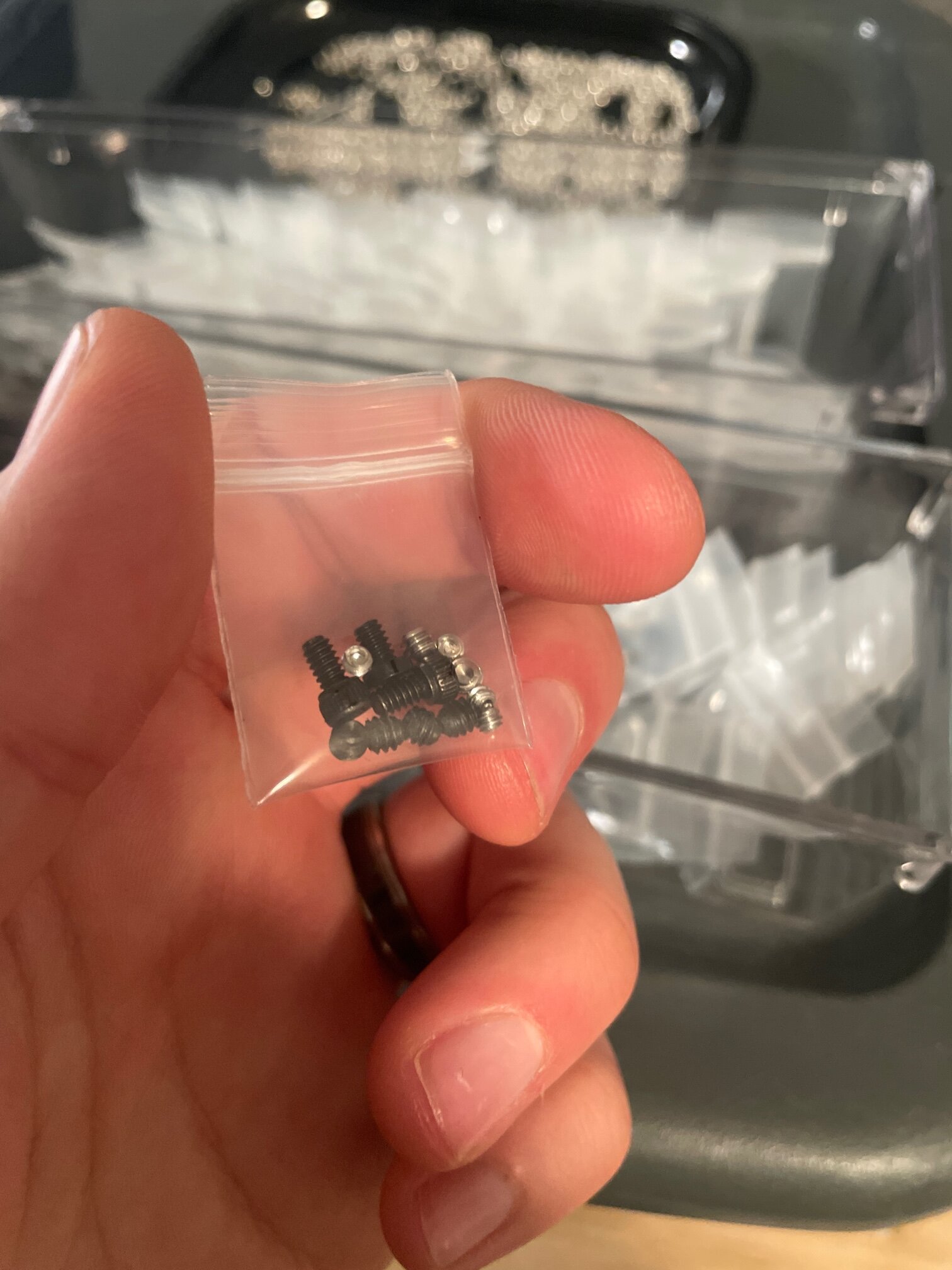

Placing these screws and extra magnets in the kits has eaten up so much time
In a perfect world they would have arrived before qc was done but they weren’t
So after qc was done had to baggie 2x6-33 screws for the blade sleeves, 4x4-40 screws. 2xsocket head 4-40 screws and the screw that keeps the main handle on
Then had to baggie 4x 2x2mm neodymium magnets and then throw those in a baggie
After doing that over 250 times then had to go back thru each box try to place them in the boxes

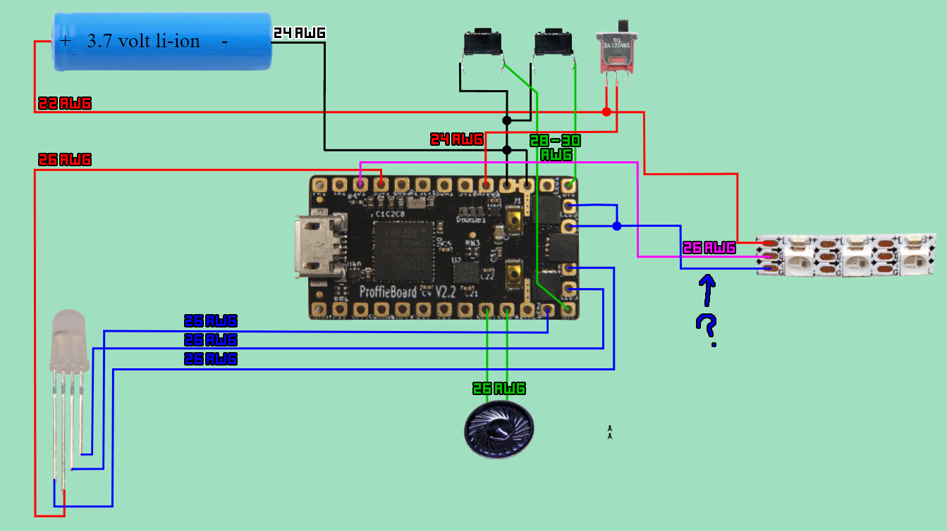

I think I've made a semblance of a proper diagram with all the instructions listed. Just one point of confusion. There might be more wrong with it, if anyone can grade my work.
View attachment 1657148I think I've made a semblance of a proper diagram with all the instructions listed. Just one point of confusion. There might be more wrong with it, if anyone can grade my work.
everything looks good except that accent/chamber led.
As per the instructions goth posted the chamber illumination led is pixel, same as the switch led. You can wire those as second pixel blade to have max control of them
Ah, gotcha. Besides that, there's still that one wire I put a "?" On that I don't know what gauge it's supposed to be.
Already answered in his first reply
