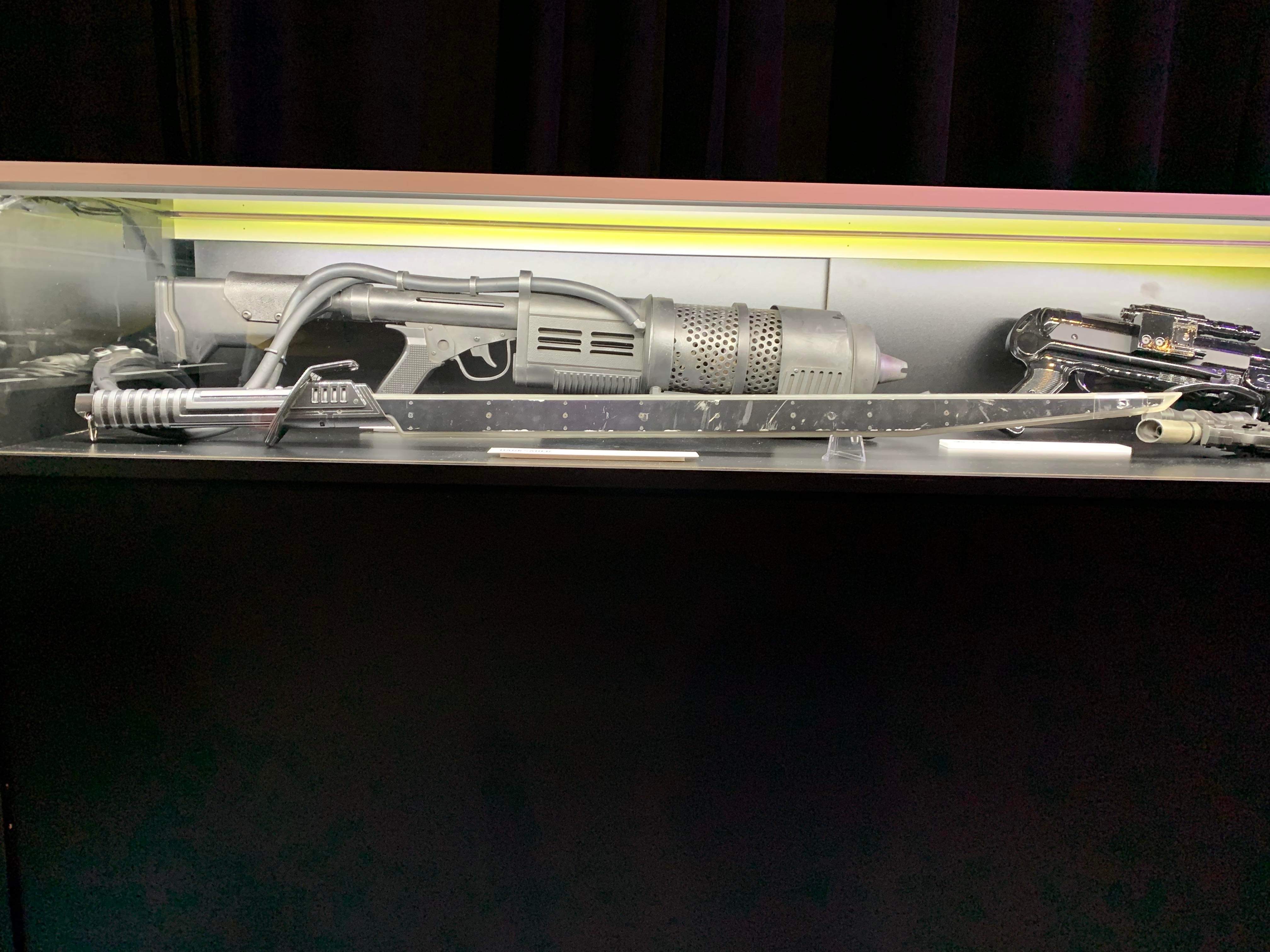

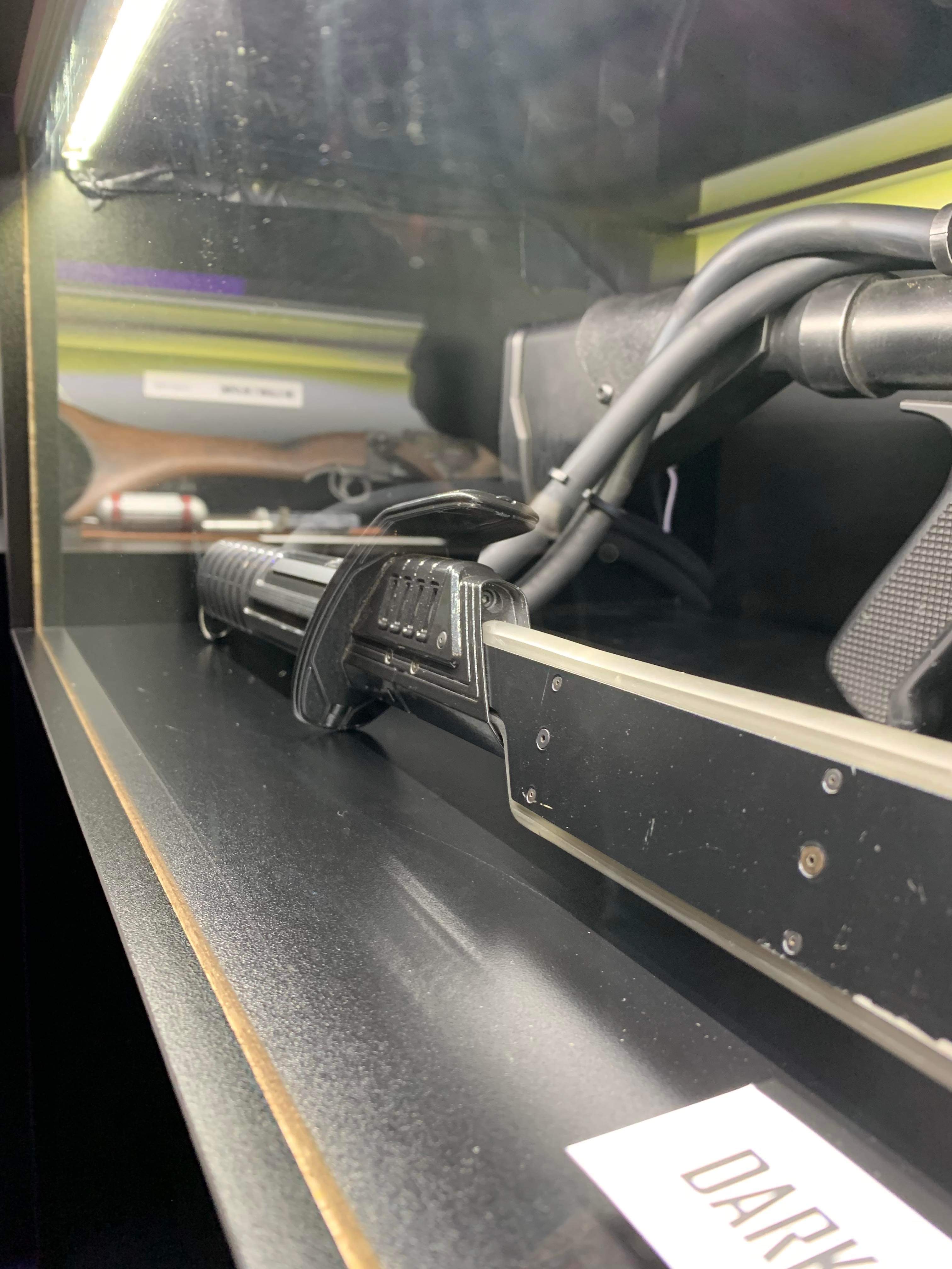

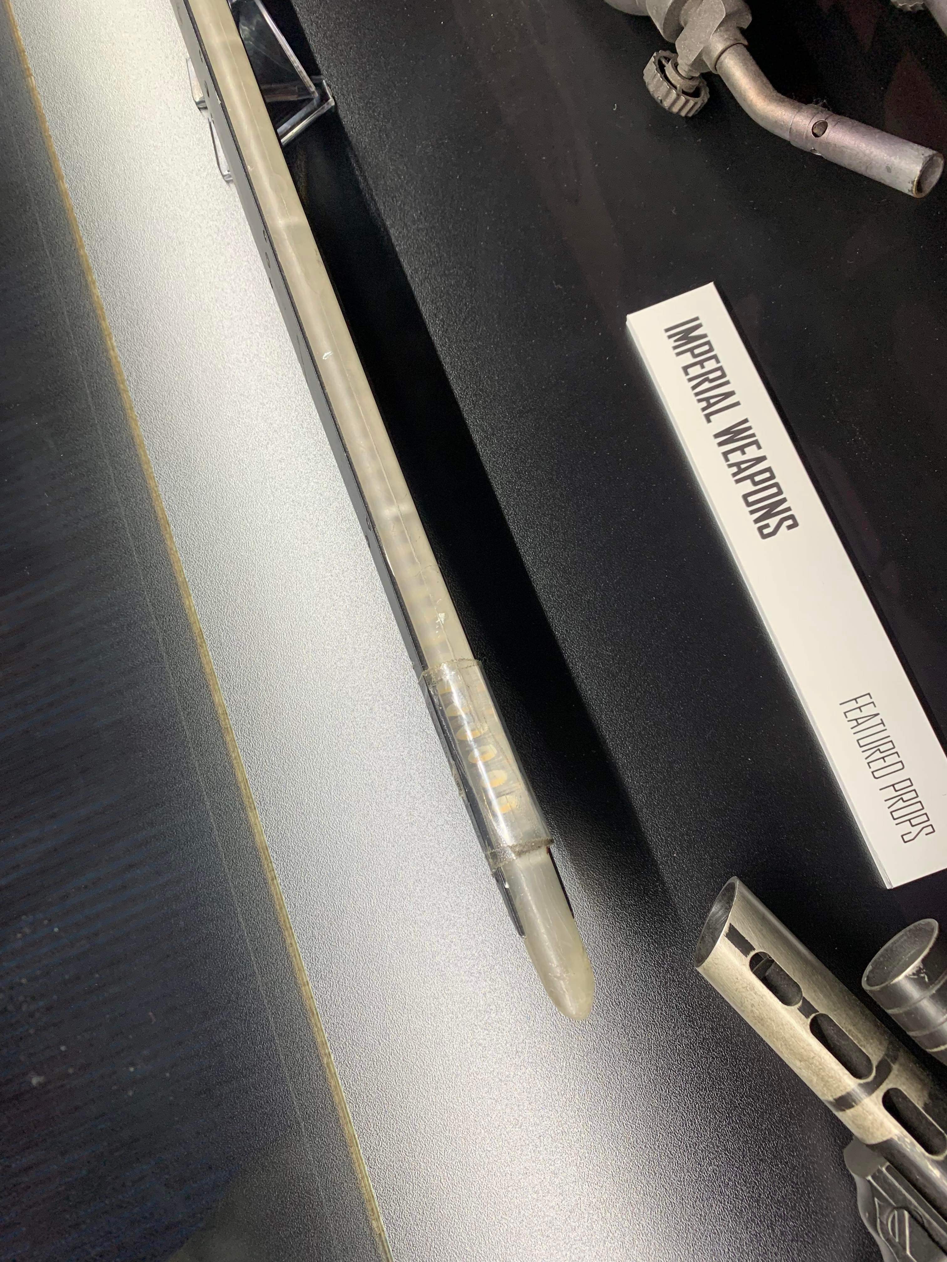

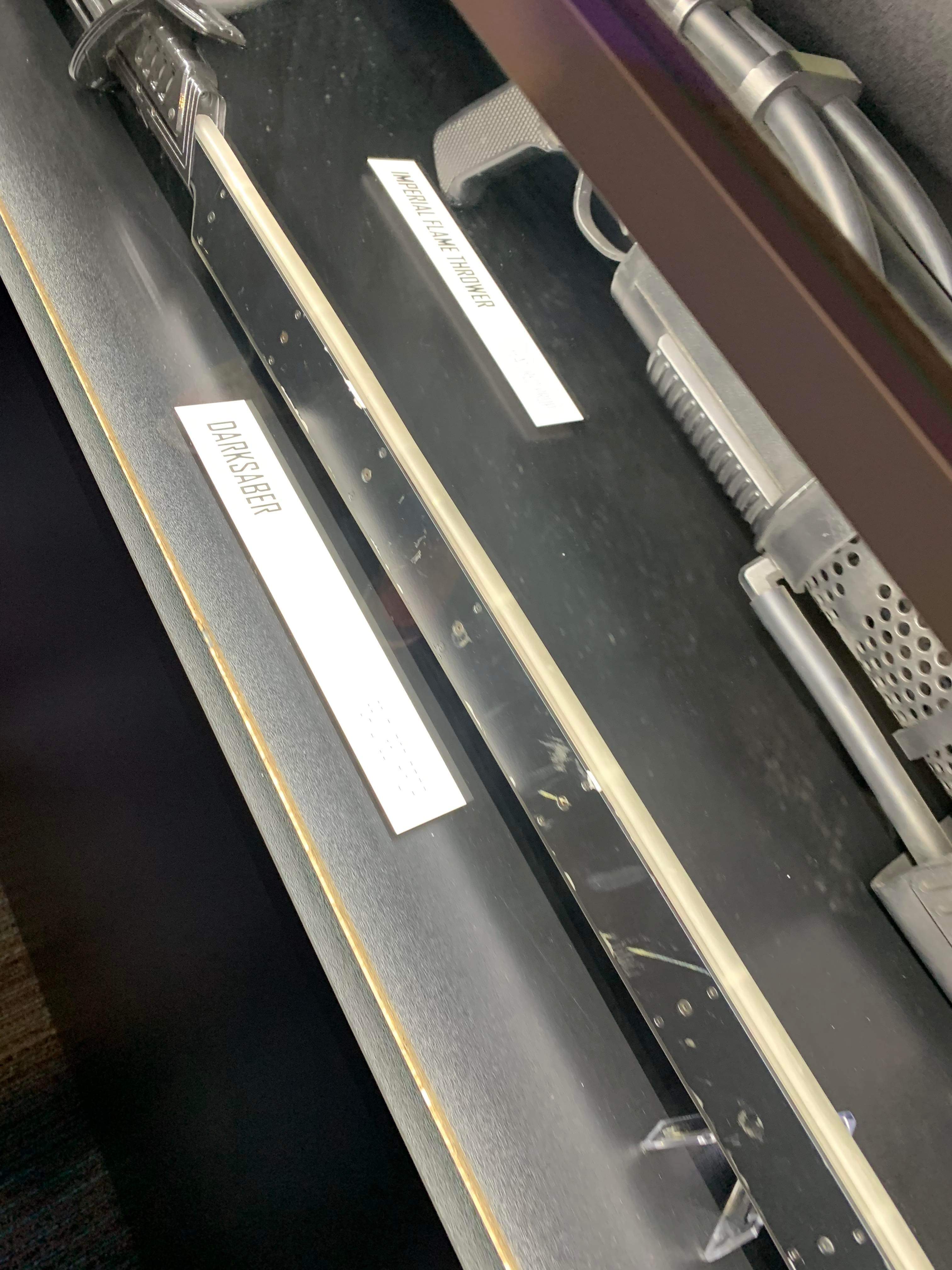

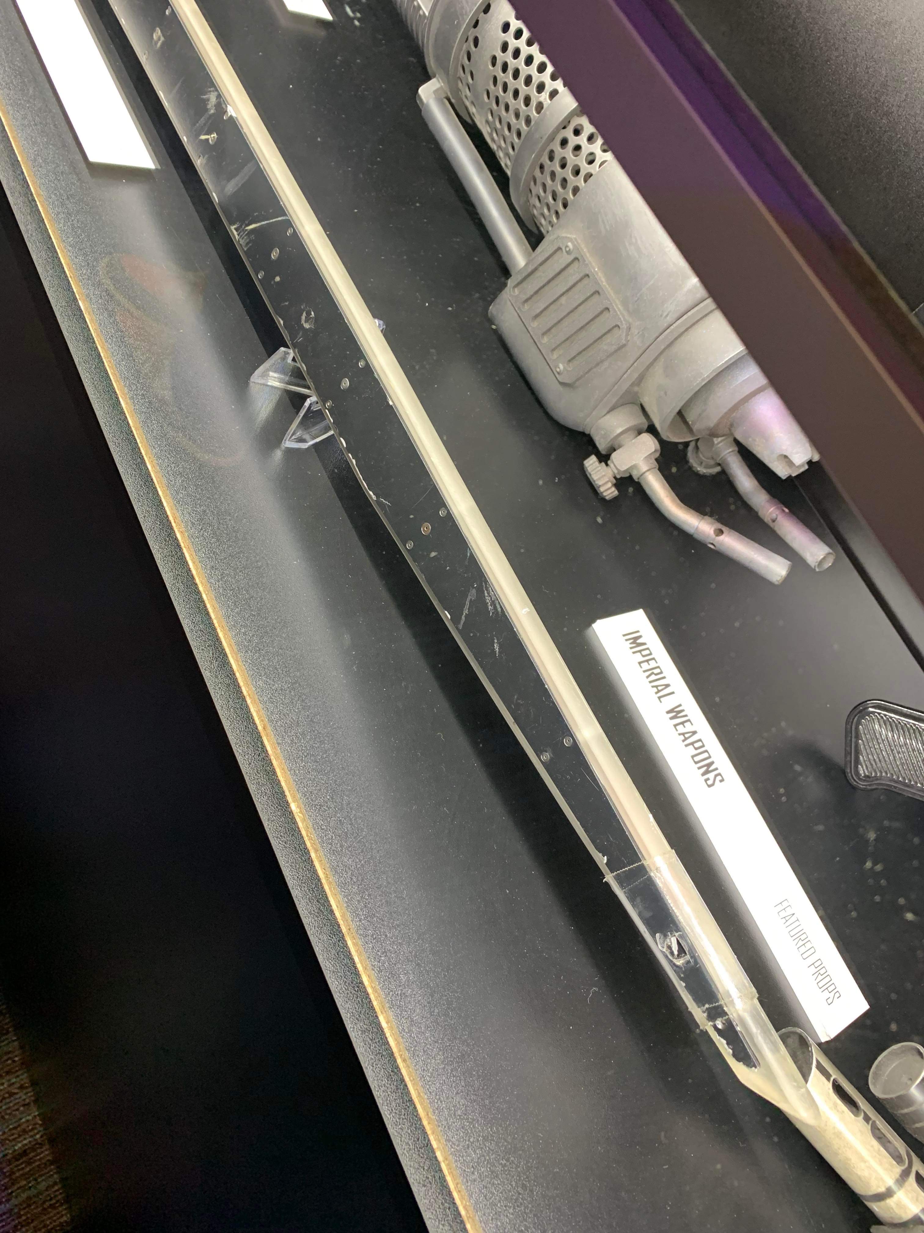

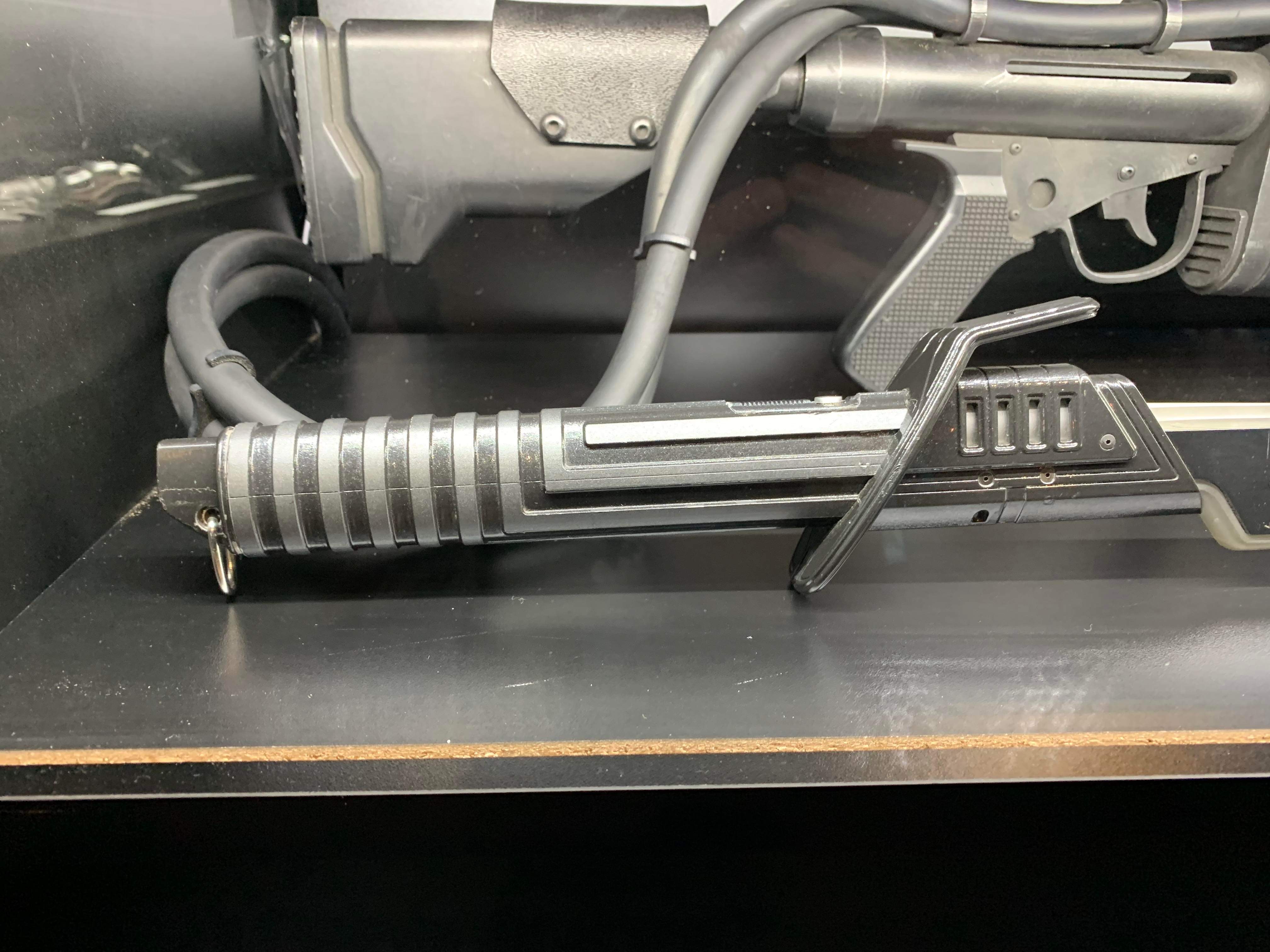

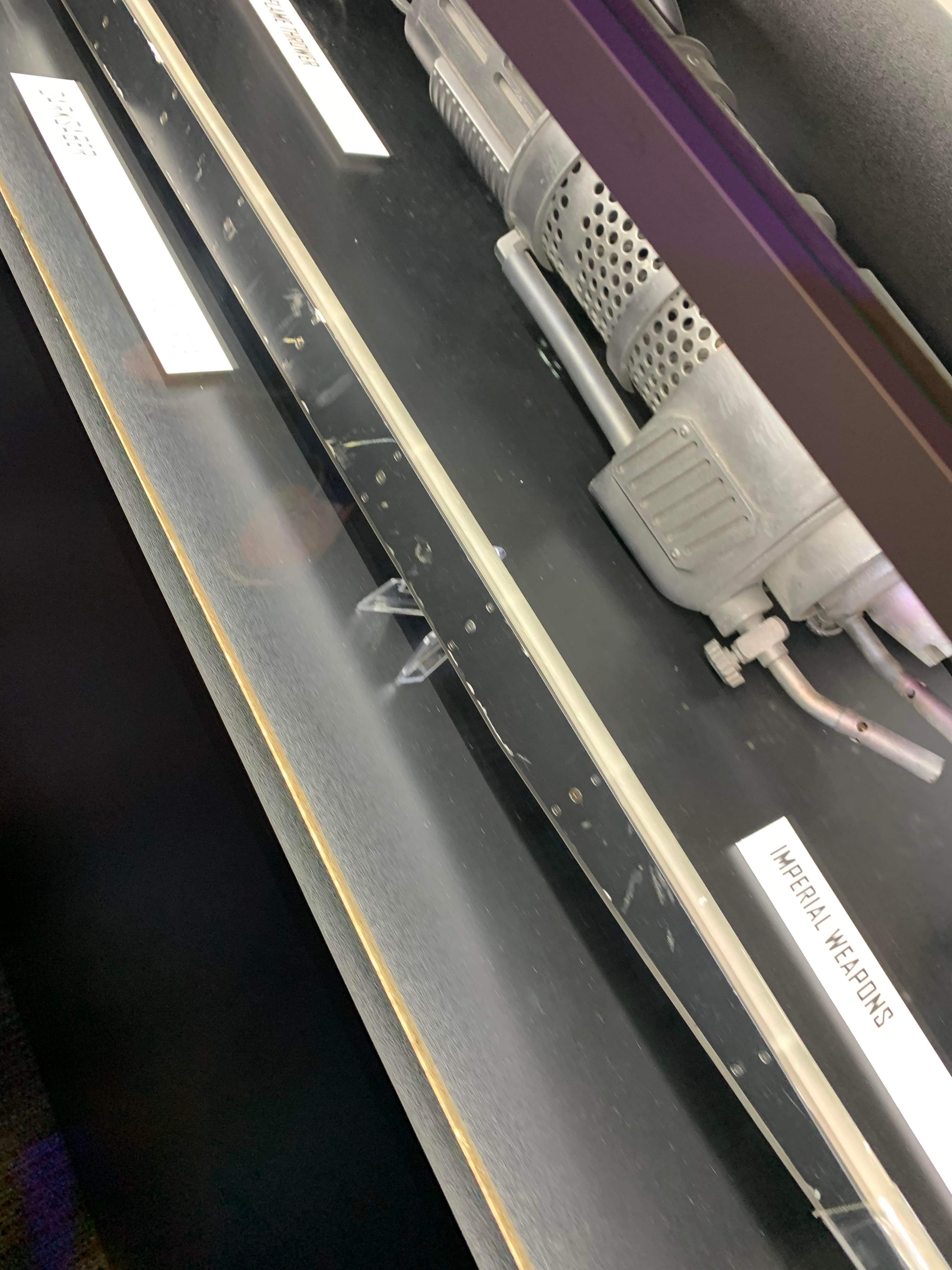

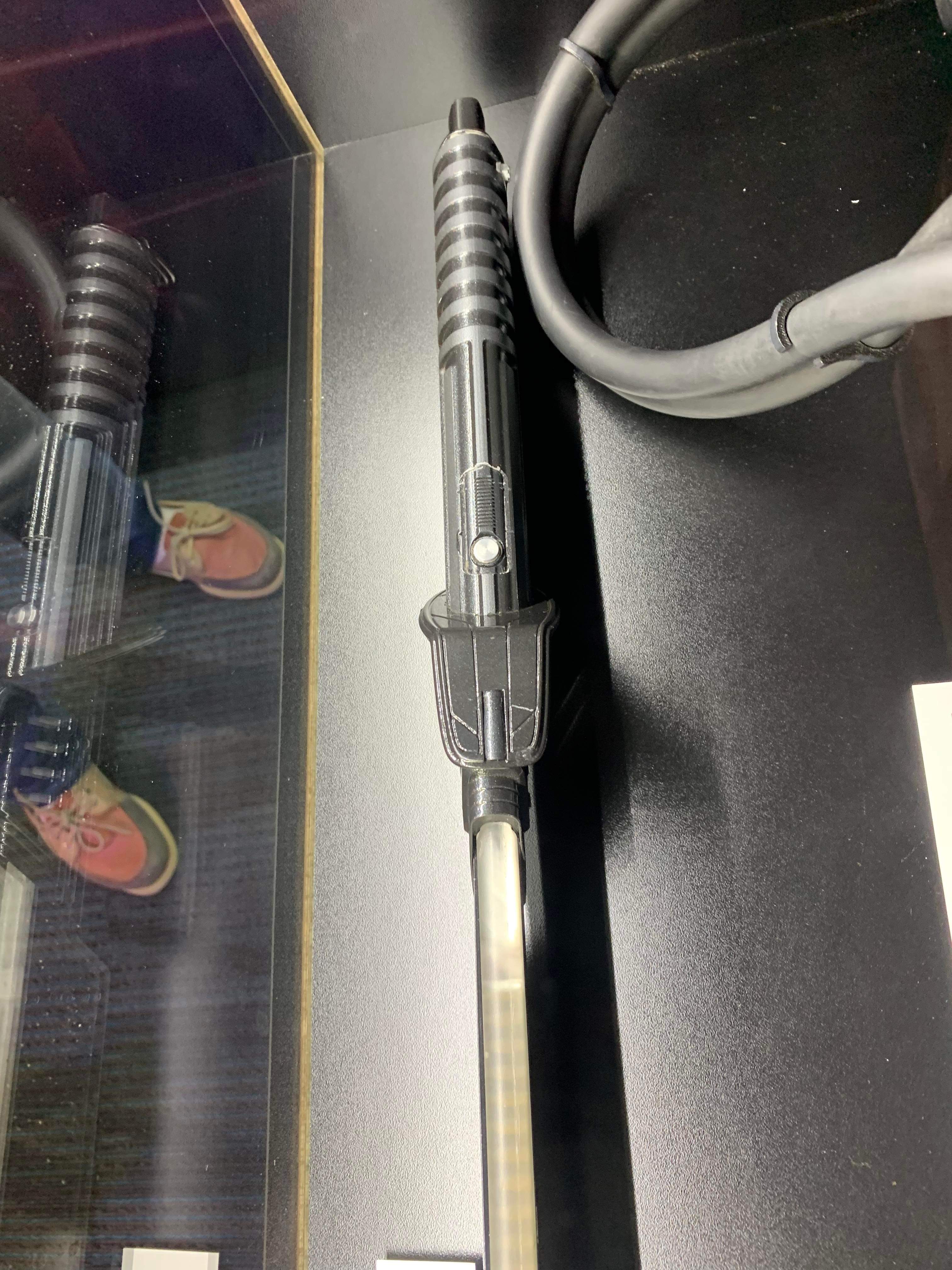

Devin shared some photos of the mando prop
It looks resin or 3D printed
The colors look pretty attainable via a method that Malibu here on the rpf has helped us with
Regarding masking
It can allow us to mask the recessed areas so the grips get sand blasted before anodizing so it gives the two tone effect or we can anodize the whole piece then mask the recessed areas again the sand blast to give an effect more like what we see here with the fx prop
Regarding masking
I was there too, i noticed how thin the handle was, is the one you’re making as thin too?
sure is, profile looks identical imho. Here is a video of Goth 3d Design testing how well the switch assembly
stays in places and how it pops off.
It is a method that Gustavo and I came up with. I asked him to move position of two of the magnets after our first proto and change the shpare so removing handle would break the magnetic force and allow it to pop off without a fus
