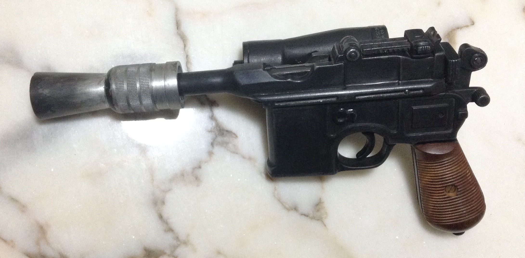

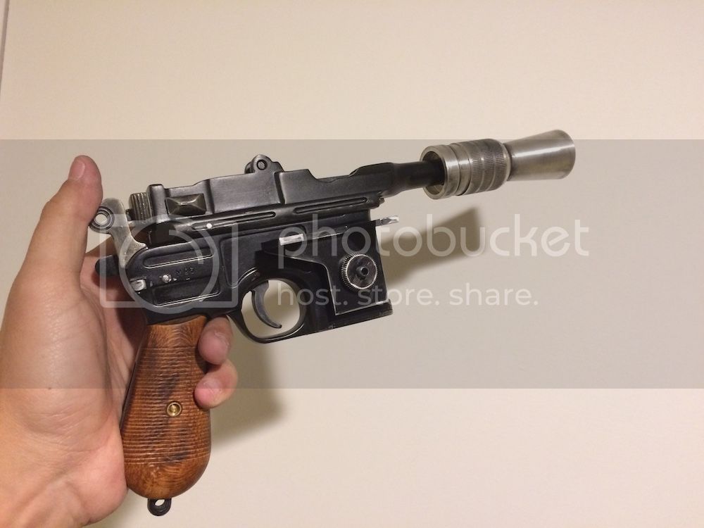

You inspired me. I replaced the flat grips with 1896 Mauser repro grips from Numrich Gun Parts. I know I paid for the deluxe Denix but after handling it it was missing something, that was the round support in your palm. These are walnut and I shaped them to the Denix frame, unevenly again. Both my ANH and ESB now have gaps near the lanyard ring :lol
also, another layer of black briwax
