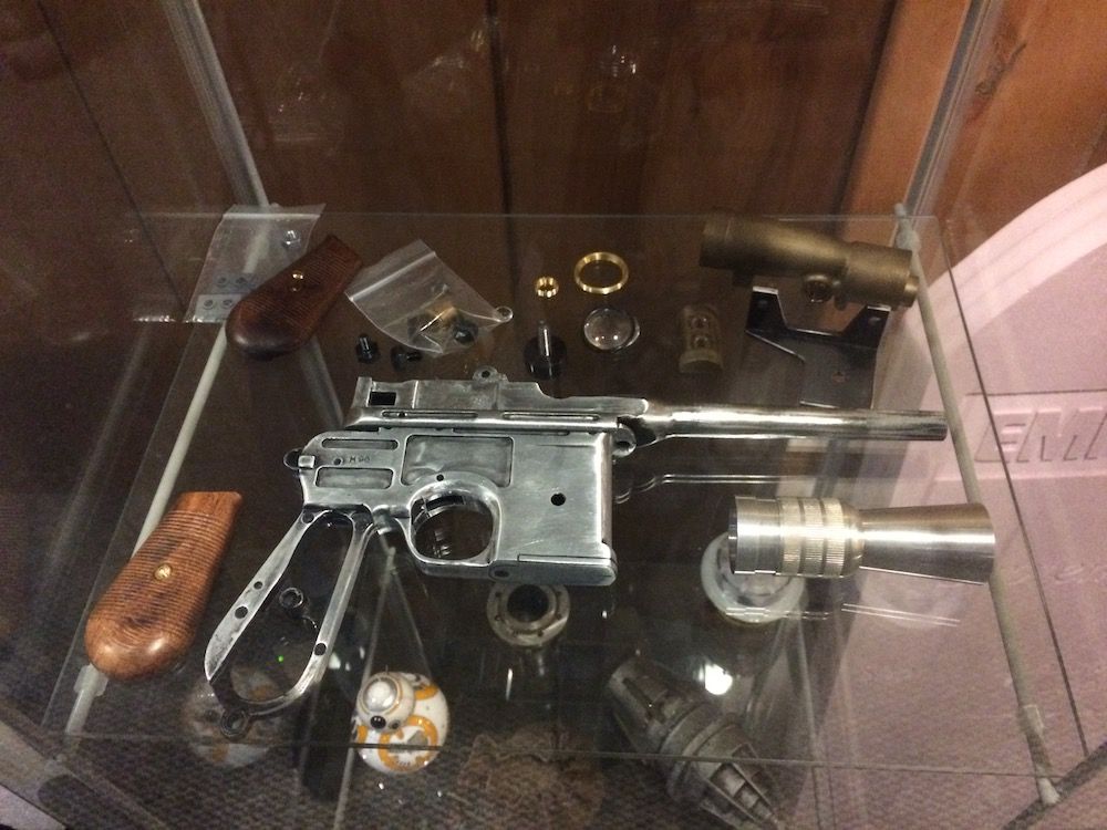

i finished stripping mine today.. still more in the cracks and crevices

Did you use anything special to strip off the paint? Or just old fashioned elbow grease?

tons of sand paper... living nightmare. this is the second time i've done it
first was the factory denix paint which was easy, but at the time thought it was horrible
this second time was my paint job of high temp flat black, then 3 coats of BBQ black... living nightmare removing that....
i was tempted to use the aerosol stripper i use on super charger rotors but was afraid it would eat the denix

I think you would've been fine with some simple paint stripper, but I understand your concern!

I've never had a problem with the rotors, but they are a different aluminum. i also am wondering if the aluminum black is the reason for the pitying on my denix? so chemicals right now are kinda scary to me
It's tougher stuff than you may think. It really is.
Still, I'll say I understand your trepidation!
Edit: Whoa, I like, never use that word! I feel like such a smarty-pants today!
I had my Denix's bead blasted and there is a significant amount of casting defects that are noticeable on the mag wells. They are more visible when the surrounding metal is cleaned and the pitting retains the prior coloration. I use aluminum black and then give the surface a coating of a stove black product that fills those voids. I find that the voids add a bit of a used look to the props.
http://i1026.photobucket.com/albums/y323/lightningdan/Han ESB DL-44/denixbare.jpg

What I should've done. Ha! Sometimes while disassembling a thing, I DO remember to snap a quick photo, but not this time!
