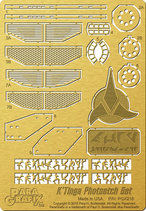

Looks like Para Grafix is coming out with another PE set for it.

Yeah, I'm on the fence about it. In terms of the LEDs it offers, it's not worth it. Unfortunately, R2 isn't selling the photo etch separately. So we'll have to pay at a minimum $70 for photo etch that normally would cost maybe $25-30. Buying models shouldn't be like buying cable TV.

:lol: Not trying to start a fire. I'm excited for the kit. I'll be buying it. I'm all for bundling products if it means buying multiple products together is cheaper and a value. If the photo etch and lights were sold separately for, say, $30 each and R2 made a bundle deal where you could buy both for $50-55, that's a good bundling. But bundling photo etch worth $30 with LEDs that we can buy separately for $15 but then charging $70-- that isn't offering a deal. It's using products like hostages. Given the fact that the kit's scale makes the windows so small that photo etch is almost a requirement in order to decently light the kit, it's just a little frustrating.

So no "mission critical" need for the photo-etched window strip?
The separate Photo Etch due seems to have more pieces that then one in the light kit. That's not cool if it ends up having more.

I really don't see any reason to us photo etch for the windows PHArchivist. The kit windows are probably not going to be as crisp but they are so small that I'm not going to bother with it. You'll see what I mean when you get the kit.
