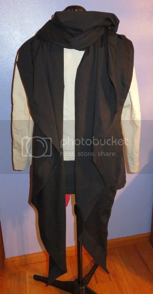

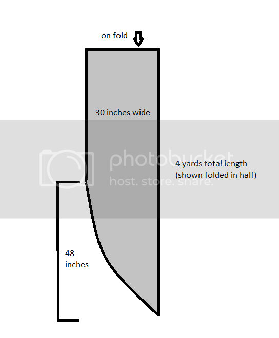

I finished my scarf (aside from weathering it). I used a piece of fabric 30 inches wide and 4 yards long. The curve starts approximately 48" inches from the ends of the scarf. On the straight edge, I did a rolled hem approximately 1/2" wide (so 1" total hem allowance); the curved side has the edge turned over 1/4" ish and then folded up to make a 2" hem - I eyeballed the measurements but followed the original's pattern. The original also has a seam about 1/3 of the way up (left shoulder) as if the scarf had been lengthened, but I left it out. Here's the basic pattern:

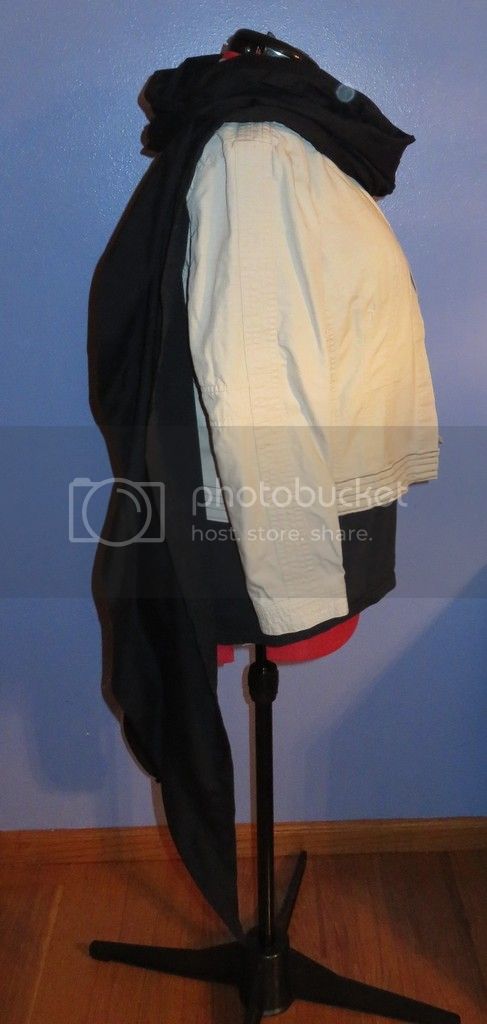

And here's my scarf. I think this was some kind of polyester cotton blend - it has a good weight and stiffness, but the original has a looser weave. I'm also going to try to fade it a bit - it looks greyer in full sunlight, but it's still pretty dark. Also shown is my "close enough for now" jacket, which is a thrift store find. All I had to do was shorten the hem and remove the buttons and pockets. I'll add the sleeve stripes and dye it to the proper color once I can determine what the proper color is!

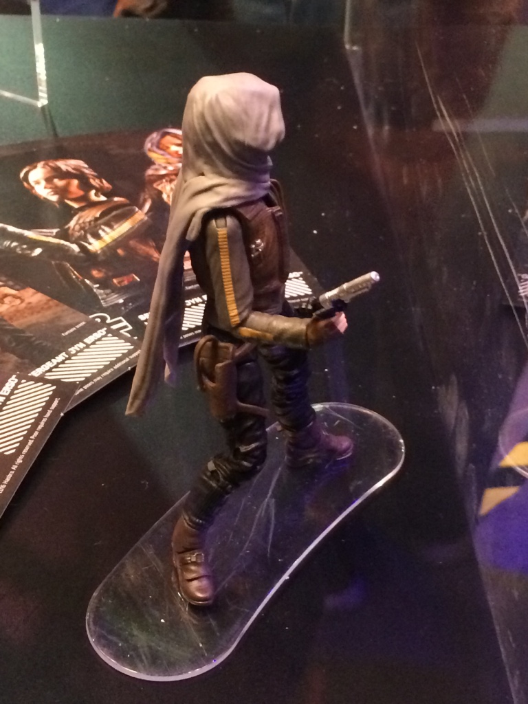

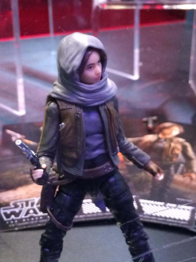

Viewed in person, the jacket looked green and the stripes appeared tan with a yellow undertone. However, when they displayed the toy, it had a very blue light over it and appeared to be closer to color corrected version seen in the trailers. As you can see from my two photos of teh same toy, lighting makes all teh difference. The one on the left looks color corrected while the one of the right looks truer to the pieces on display.

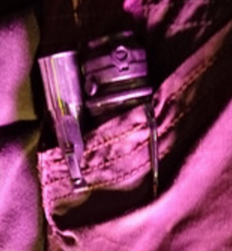

Looks like we've finally got the full view of Jyn's chest pocket greeblie from this photo you took:
Screen Shot 2016-07-28 at 5.31.21 PM.pngScreen Shot 2016-07-28 at 5.32.26 PM.png

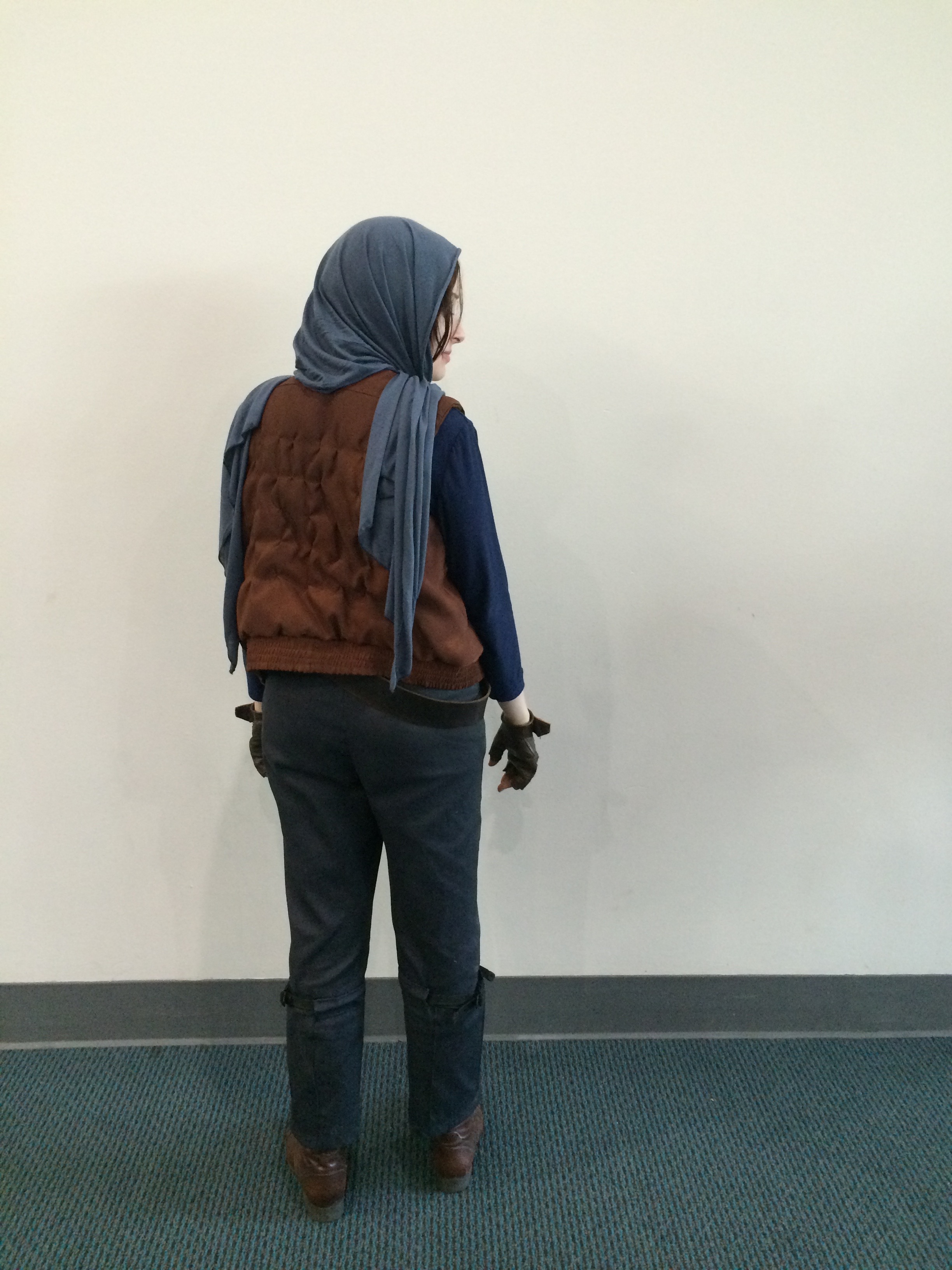

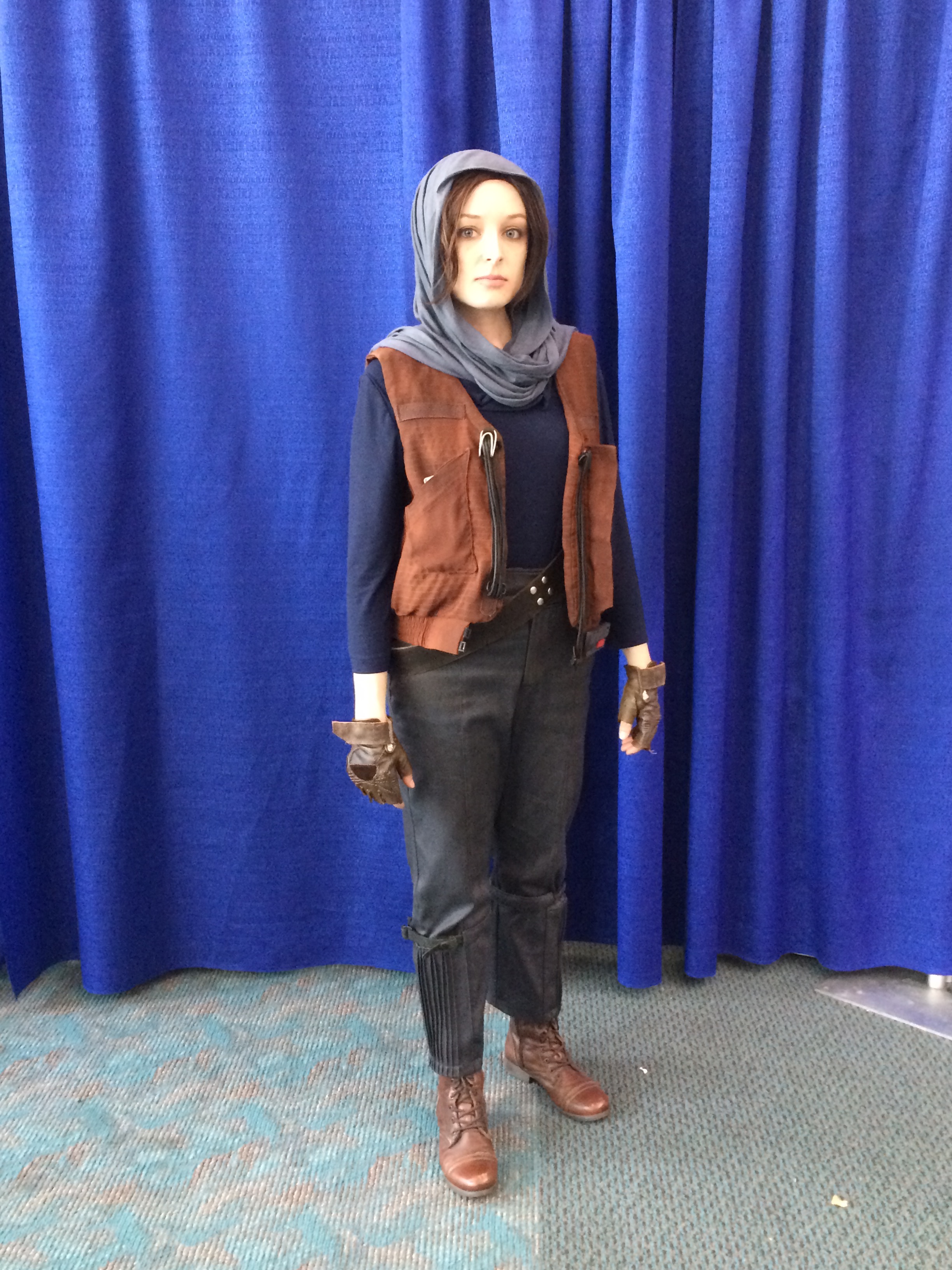

Also, here are a couple of shots of my Jyn costume from SDCC:
The pants color actually turned out to be a pretty close match for Jyn's. My vest photographs more brown or burnt orange depending on the lighting. It could probably be lighter, but I might wait to experiment with that. The scarf color could probably be more gray and it shouldn't be stretch fabric. Also ended up way too short, so I'll fix that with the second version.
The shirt matches the color we see in photos and clips of Jyn but it's too navy compared to the costume in person, so I might remake that at some point. Same problem with the gloves -- pretty good match for the color edited version, but Jyn's gloves in person are a light tan. I actually think it's possible that they just took the yellow coloring off of the Black Diamond gloves and then they didn't redye them. Another interesting note from SDCC was that the gloves are not restitched with a thicker waxed thread, which I was sure was the case from the photos from Nuremberg. Unfortunately, I went off those photos and dyed the gloves and restiched them so I'll probably need to remake those at some point.
I still need to do the boots, and sculpt the greeblies from her pocket. I'm waiting to make the holster until someone starts 3D printing Jyn's blaster. So there's still a bit of work to do but I'm pretty happy with version 1 of the costume.

What color is everyone using for the scarf? In person it reads taupe but in the sizzle reel and teaser trailer it looks anywhere from dark brown to blue/green depending on the shot. And on the toy it's a light grey/blue. Not sure which direction to take it at this point.

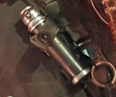

EDIT: Since my original post in July there have been more detailed photos and the release of the Visual Guide. What I call the Code Cylinder here and in other post is now identified as a Crozo 2-MAL personal comlink. There are a few changes required to improve the attach diagrams but there are still some unknowns. Perhaps the release of the video or details from the hero props if they come out will provide the final answers.
Since Yutani Exec and spectreseven have been good enough to add some important information to the mix I decided to use their additions to produce some diagrams of the Rogue One Code Cylinder. There is one "blind" spot where we do not have complete information but I believe this combines all of the information as it currently stands. As always I am looking for other to challenge any and all of my assumptions.
View attachment Rogue One Code Cylinder.pdf
View attachment Code Cylinder Layout.pdf
I'm aiming for a medium gray / very weathered and faded black.
