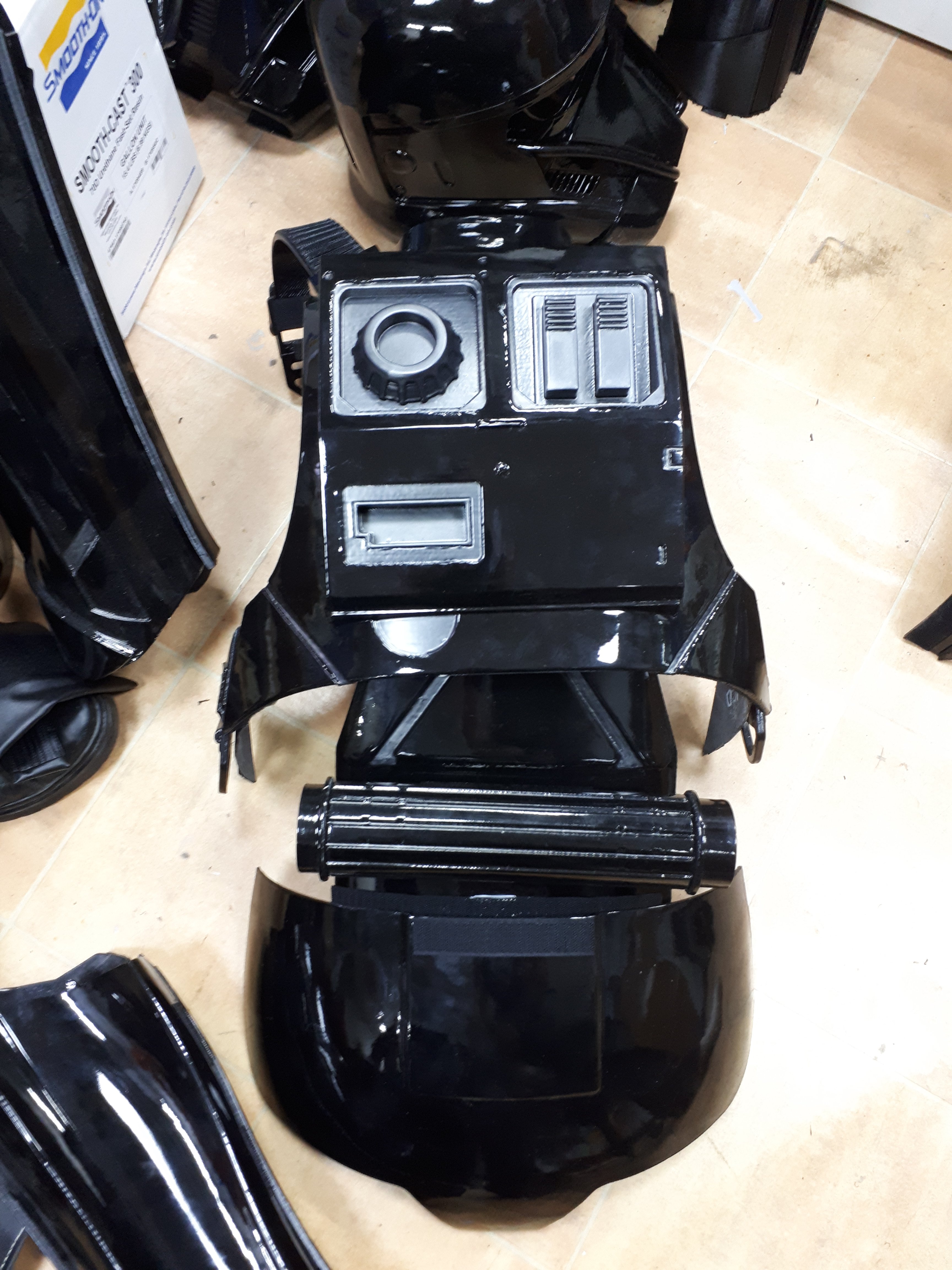

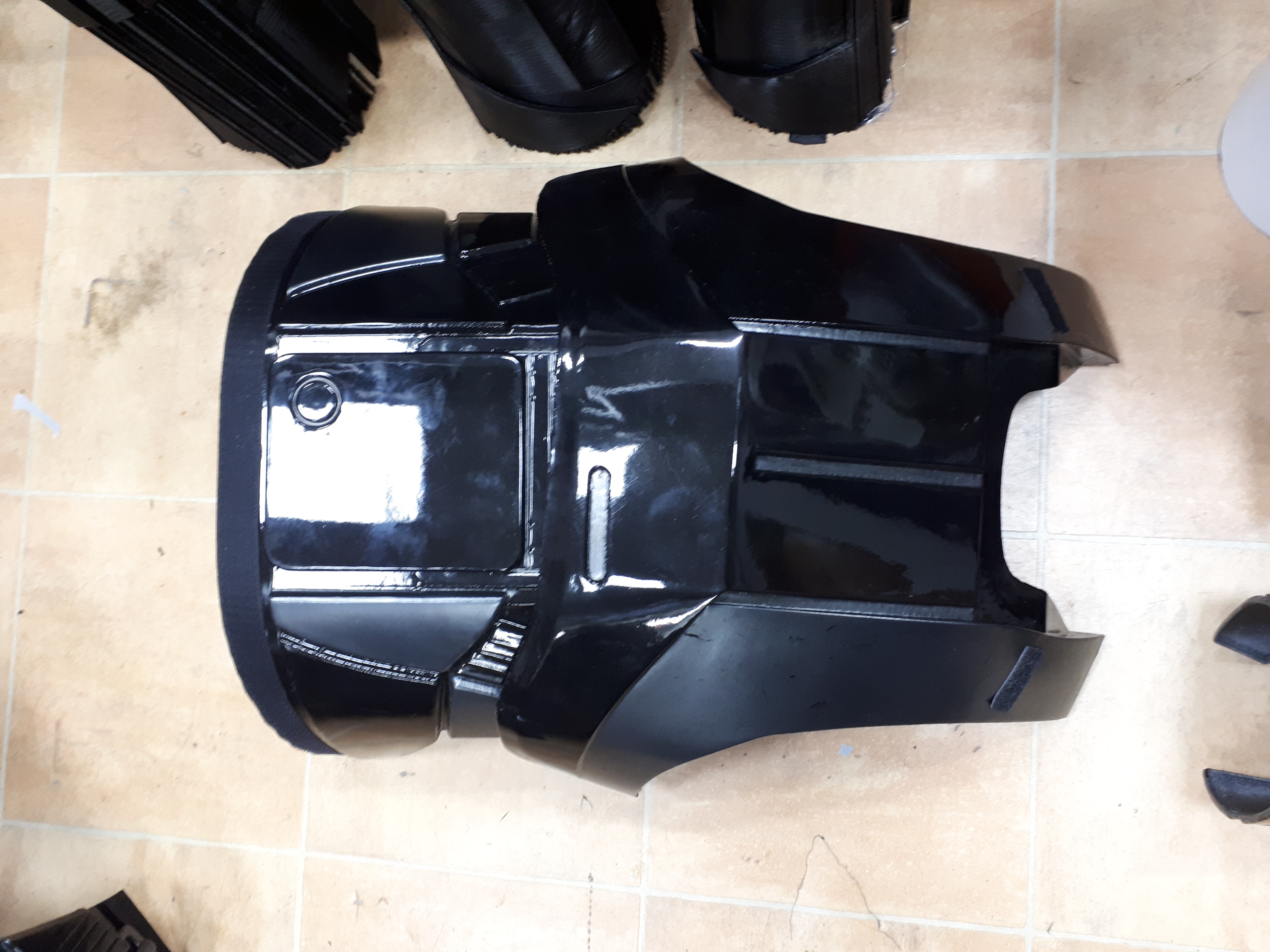

From my experience with 3D-printed armor - try to apply MOTIP Spray Putty first, directly to print. ;)
Sand it a bit and then - paint!
Will obtain excellent result!
For example-my DeathTrooper 3D printed armor.
Cheers! :)
View attachment 812627View attachment 812628
Cheers! :)
