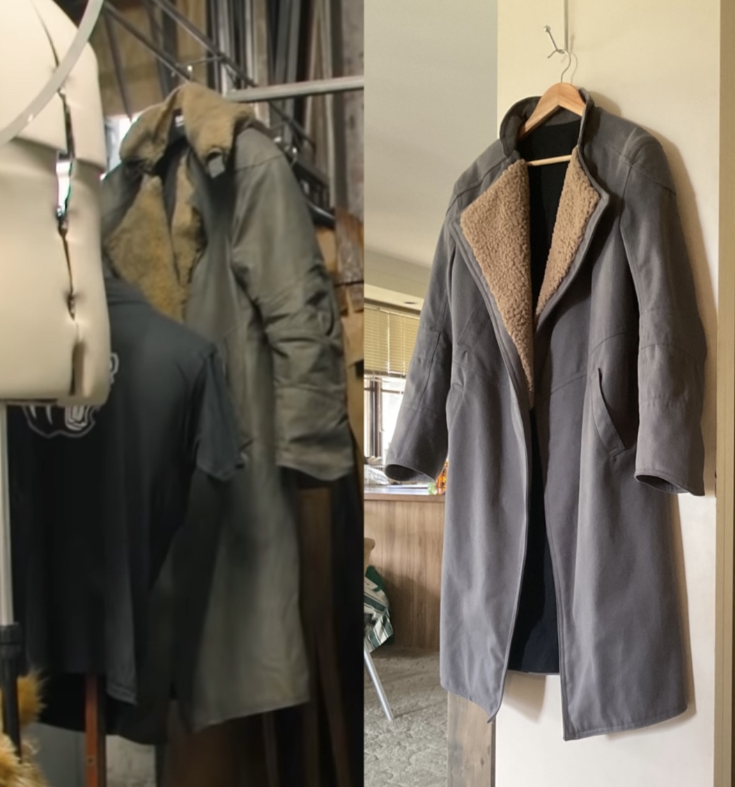

Well this is only *mildly* embarrassing…the more I look at it, the more I’m not convinced it’s my coat.
I took a shot of my twin coat (still unfinished), at a similar angle and yeah, I dunno. Some stuff matches up, but the sleeves look…different. The sleeves on the one in the shop look like they are bigger around, and are maybe rotated inwards a little? That could just be the hanger as well…
The shop one appears to be coated and weathered too, which could be messing with my perception of it. Also, it looks like the main collar has been detached from the lapel on the left side and some of the lapel fur has been unpicked too.
not really sure what to make of it.
