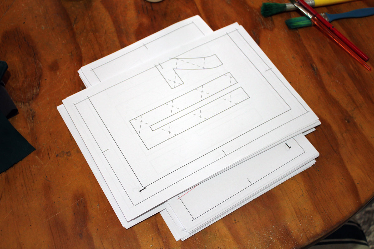

I then spent the next few days drawing up the proper, final patterns in illustrator and printed them off:
That, my friends, is 83 A4 pages of pain that I now have the joyous privelege of cutting out and sticking together with tape.
