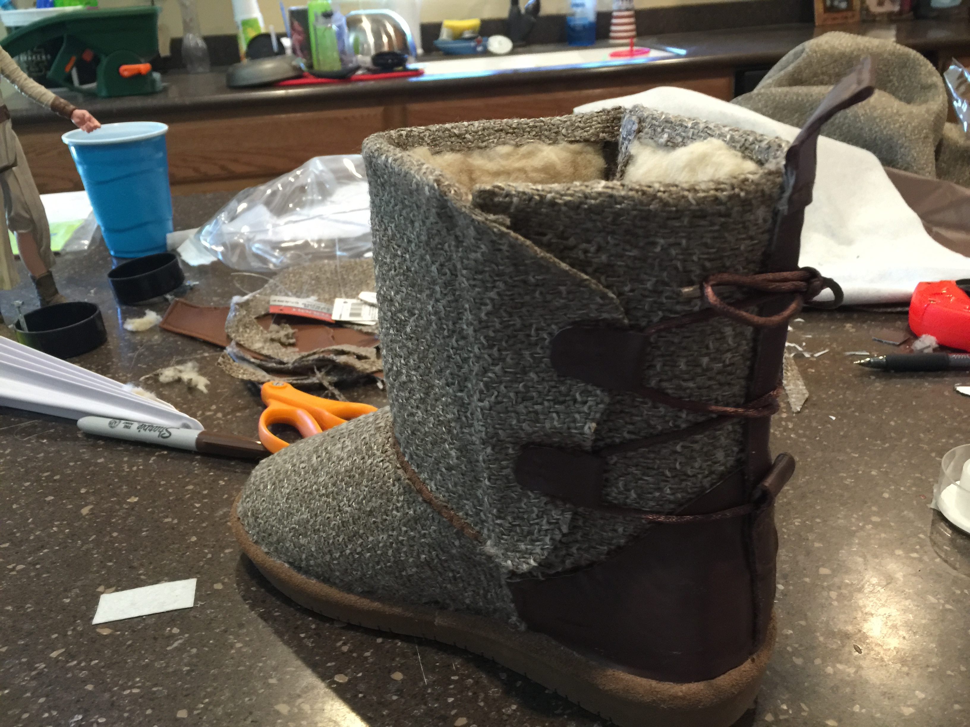

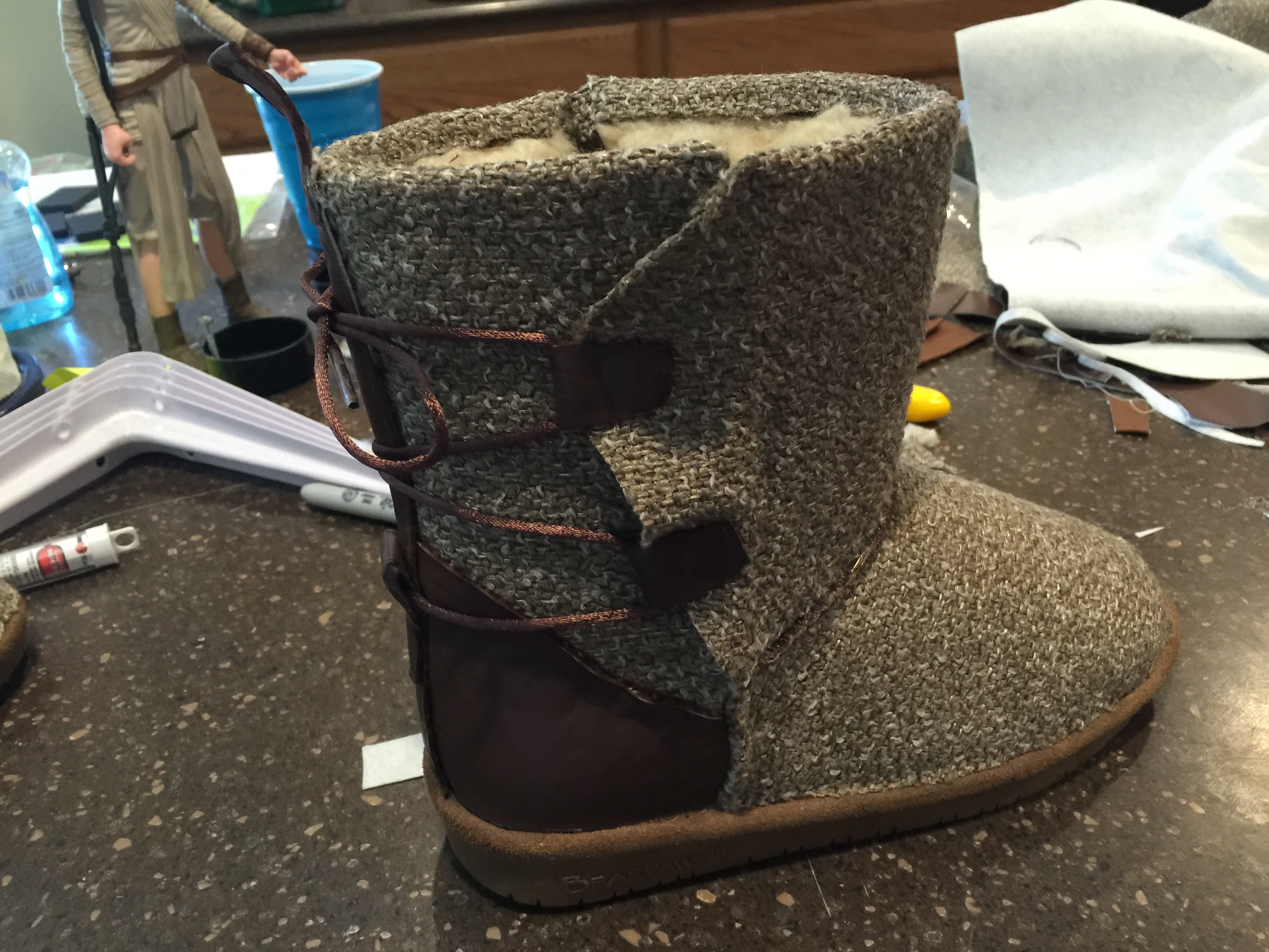

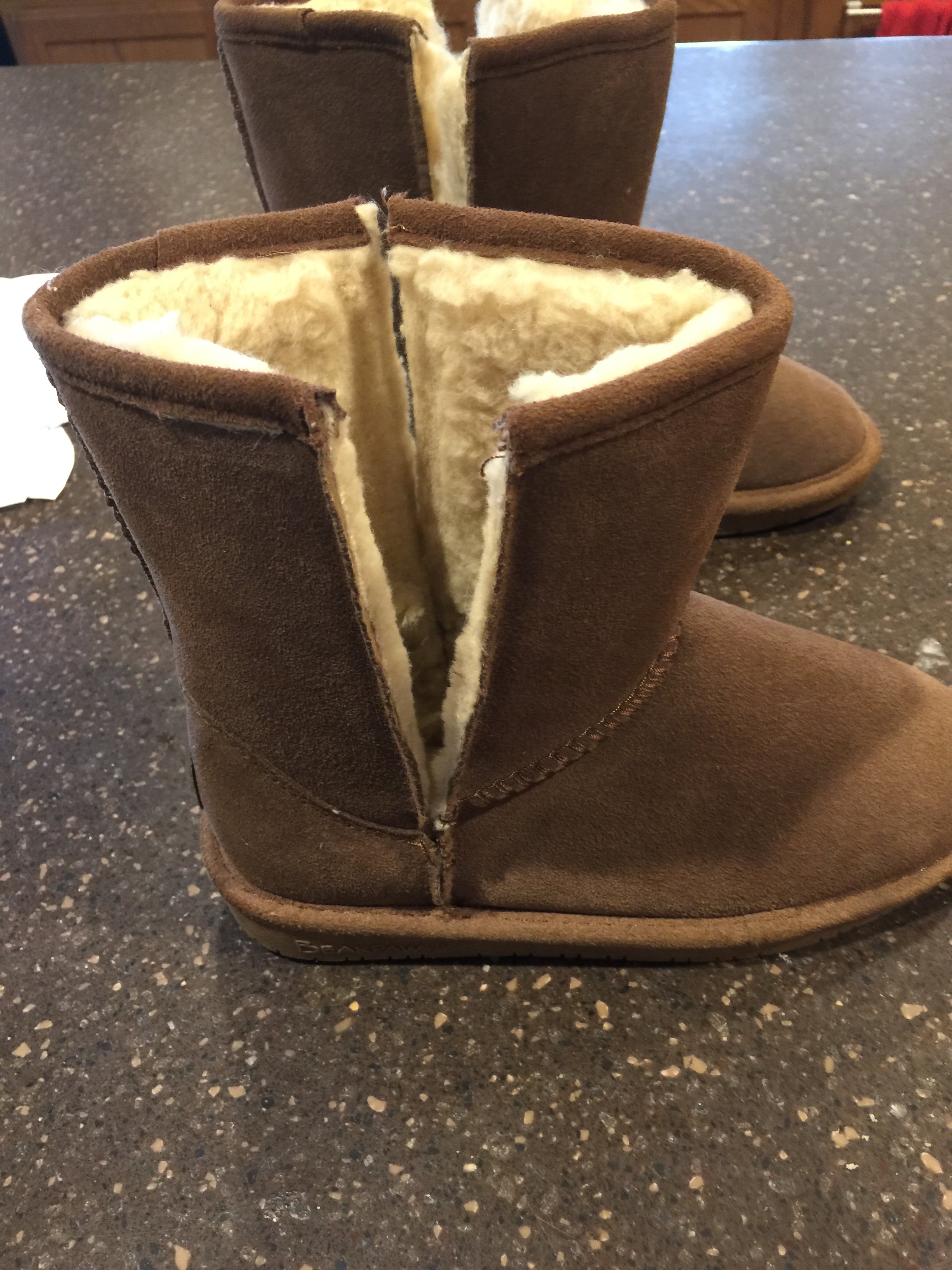

Finished my daughters boots. Went from a generic brown UGG style to a somewhat Rey looking boot. My daughter was very excited when she came home from school to see what Daddy had worked on all day. IMG_6493.JPGIMG_6497.JPGIMG_6506.JPGIMG_6507.JPG

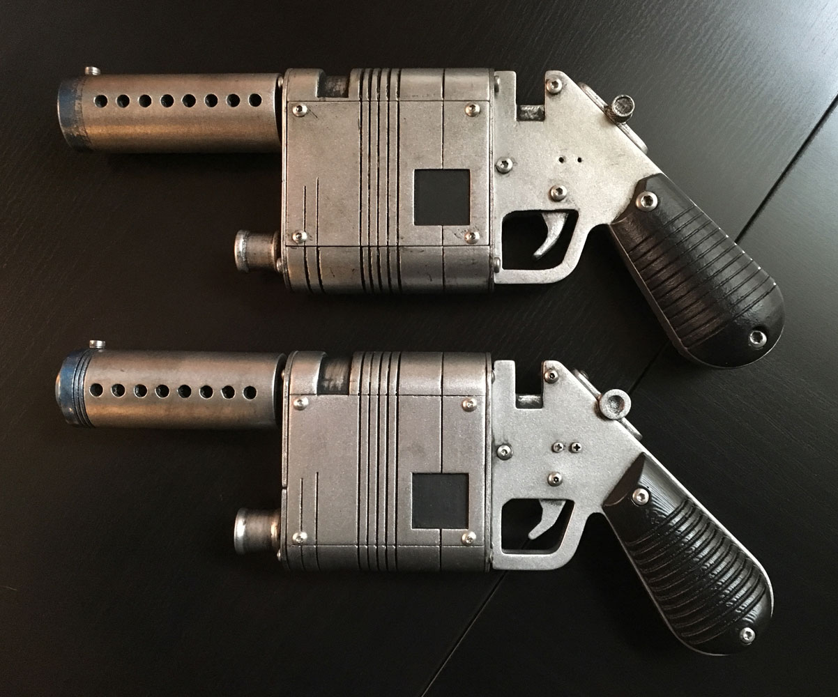

And here is the Rey blaster I painted up for her. Hers is the top one the bottom one is mine.
