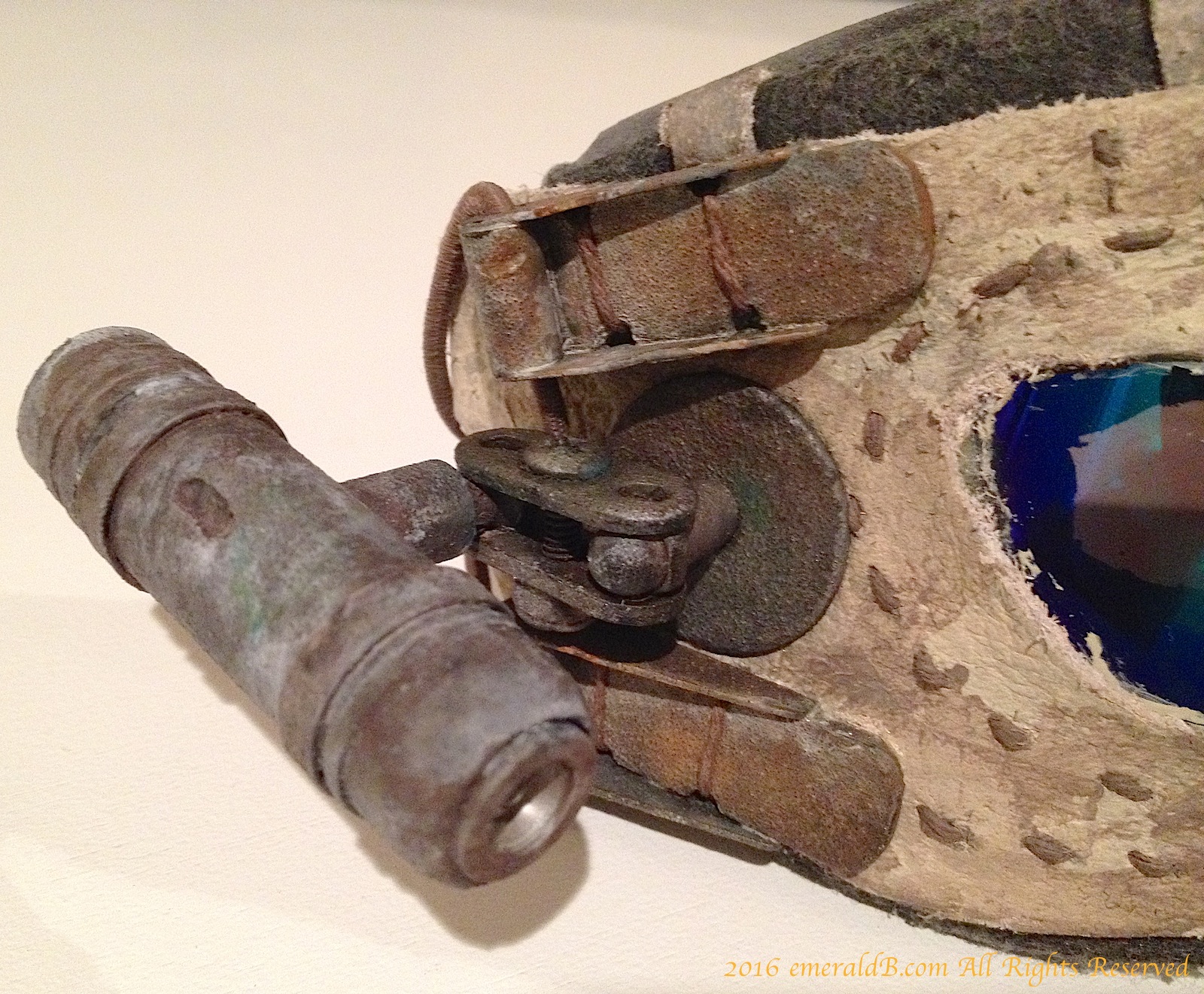

Still experimenting with casting goggle clips, it's quite addicting.
From this:
To this (real rust):
Nice job on the rust, very authentic.
i just noticed that her goggles in the star destroyer have the fender washer on the side, but the goggles when she comes outside do not. Also the outside goggles look more narrow on the top between the lenses.
I would guess that in the star destroyer she is wearing hero goggles with a working light, probably with metal parts so the washer is needed to support the weight. Outside are probably stunt goggles where the light is probably not metal, for comfort during filming. Just a guess.

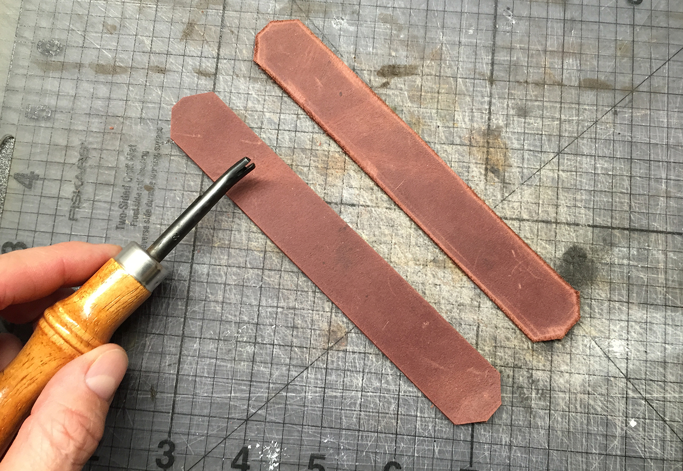

Jo's tip for the day: :p
I've been making a few of the leather strap sets, and I thought it might be helpful to post a handy tip. :)
One thing I see a lot of from peeps when they are costuming and working with leather, is that often times they just straight cut it and that's it.
To really finish the piece and give it that nice completed look, it's best to use an edge bevel. They are available at Tandy leather or online for less than $20 I think.
It's all in the details baby!
Jo you might want to try and take a piece of wood and rub the edges of the leather....it gives a nice finish to the edges also. For less $$ too
Absolutely true! The edge beveller is a must-have. It truly completes the look of your cut, and allows for a much more finished look. :thumbsup
