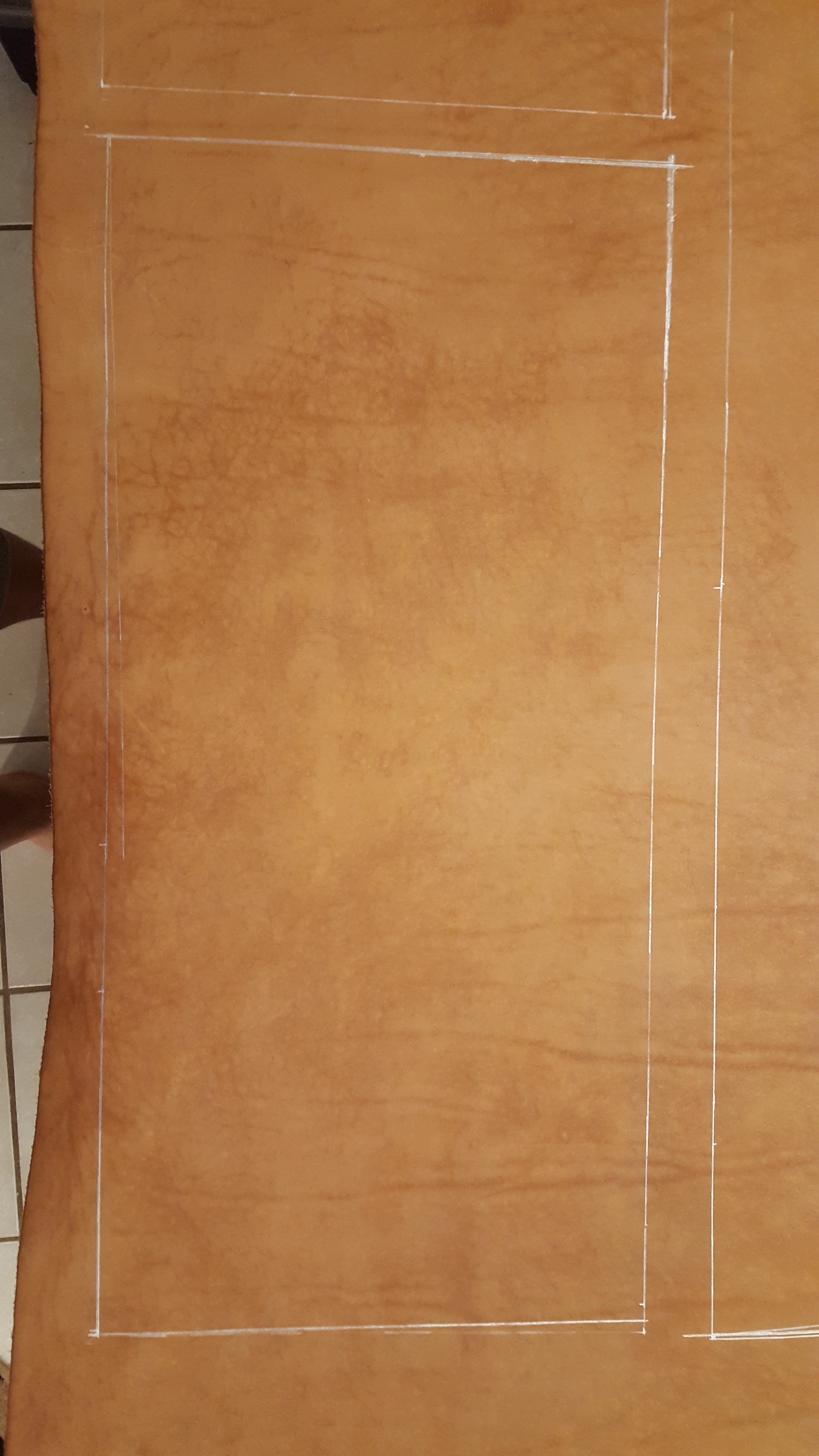

I just marked off on the leather and cut.

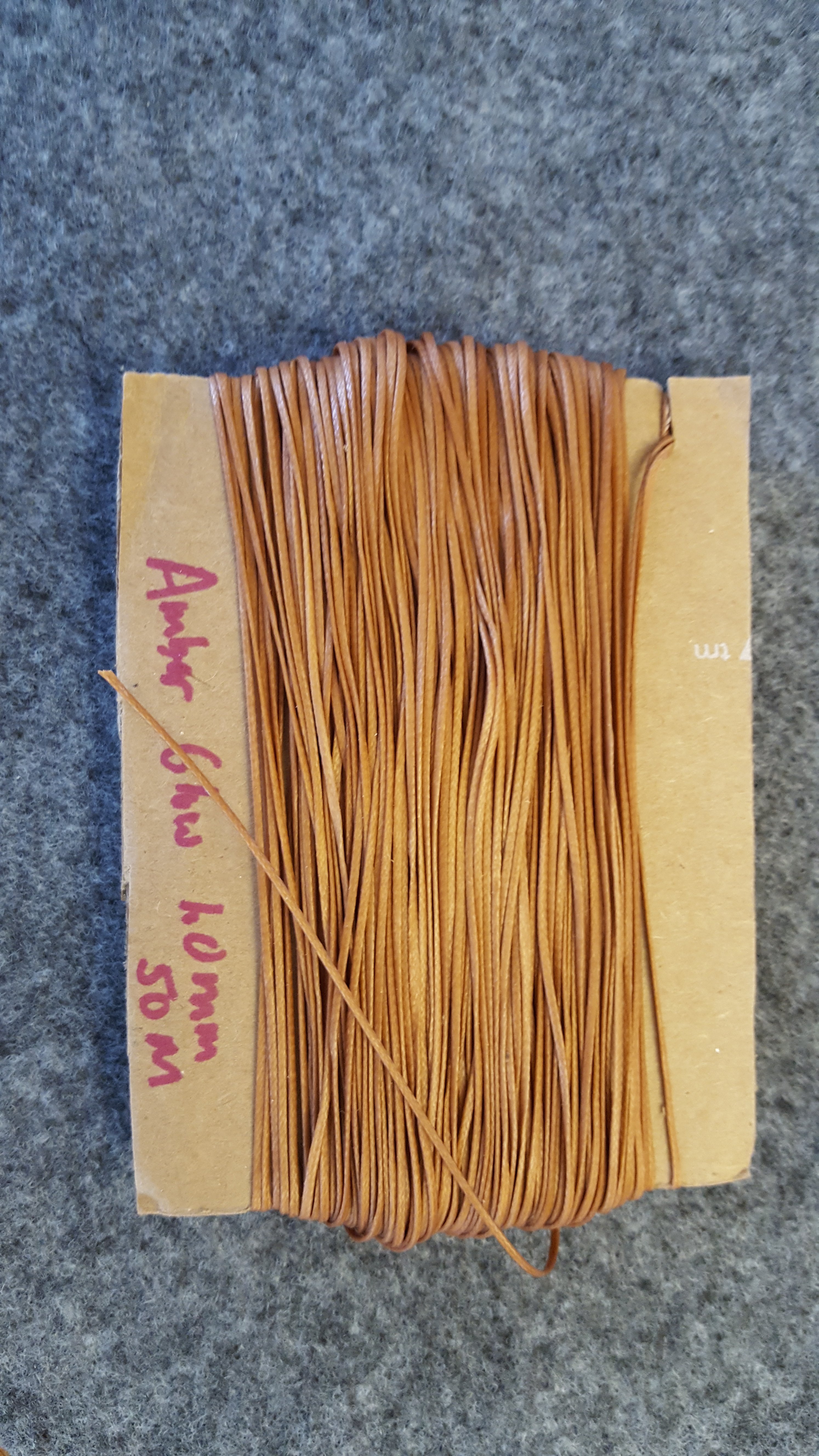

Alright, I have the thread for my backpack, Tiger thread in Amber Glow, which perfectly matches my leather.
Beautiful, right?

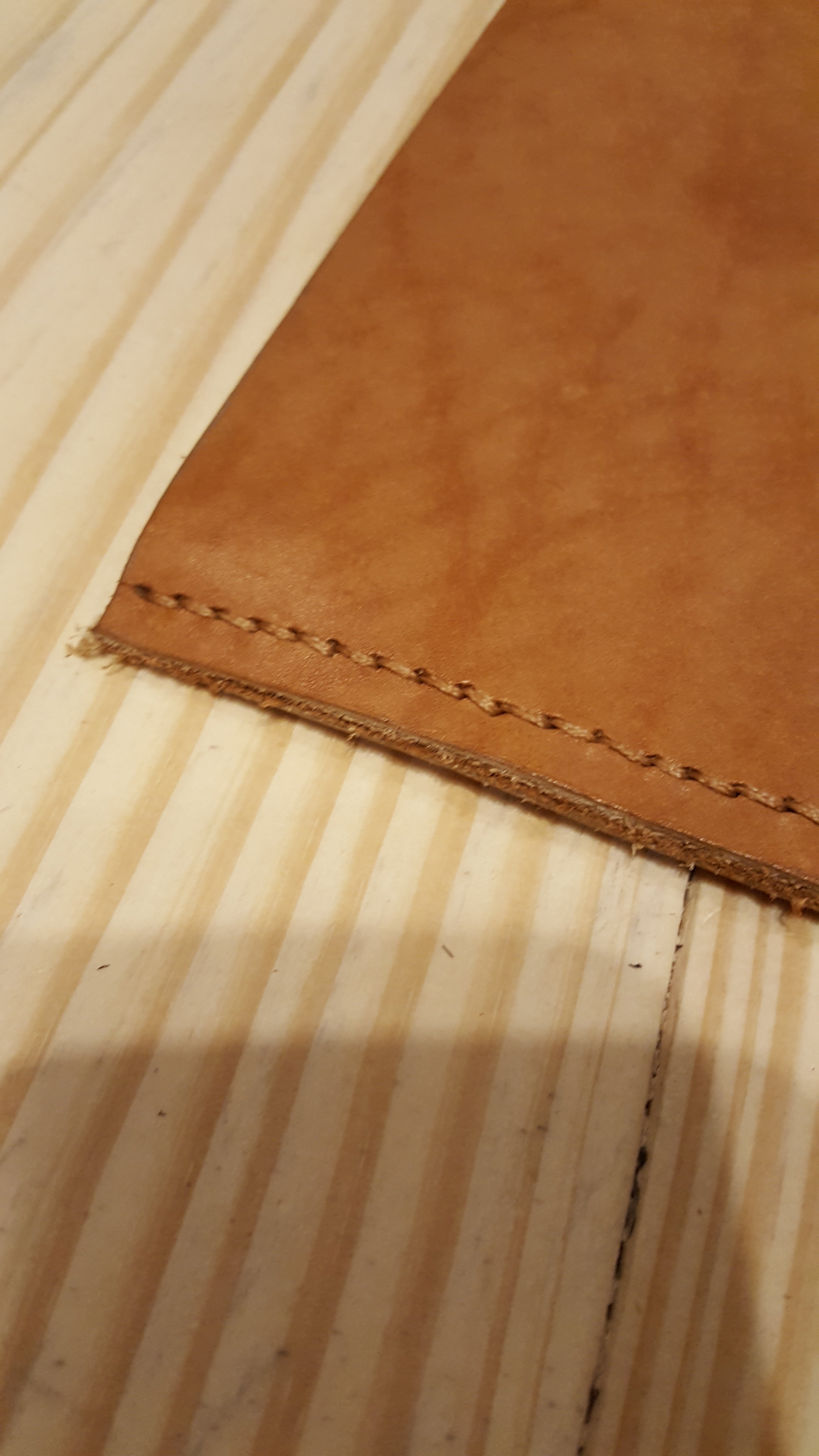

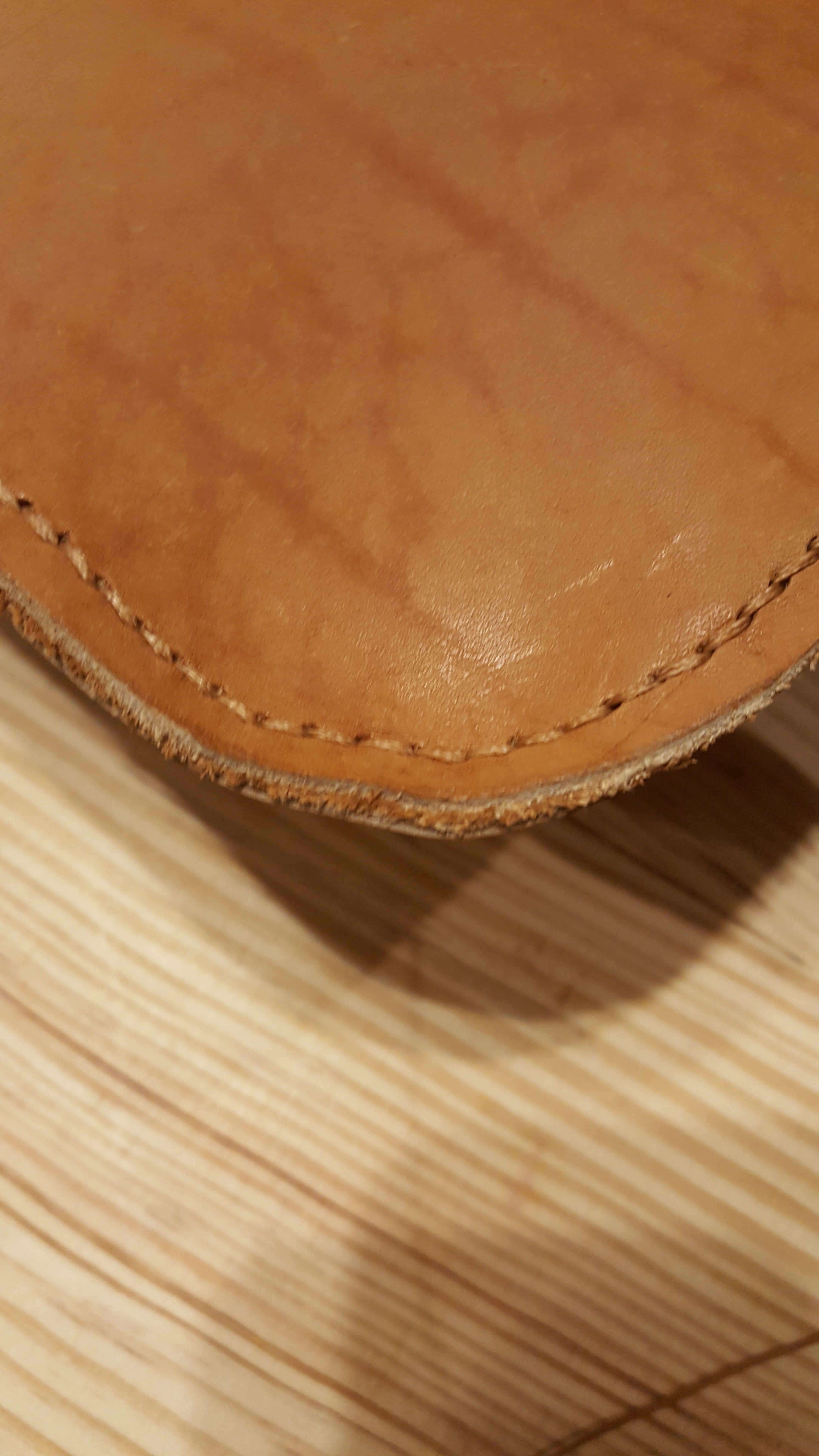

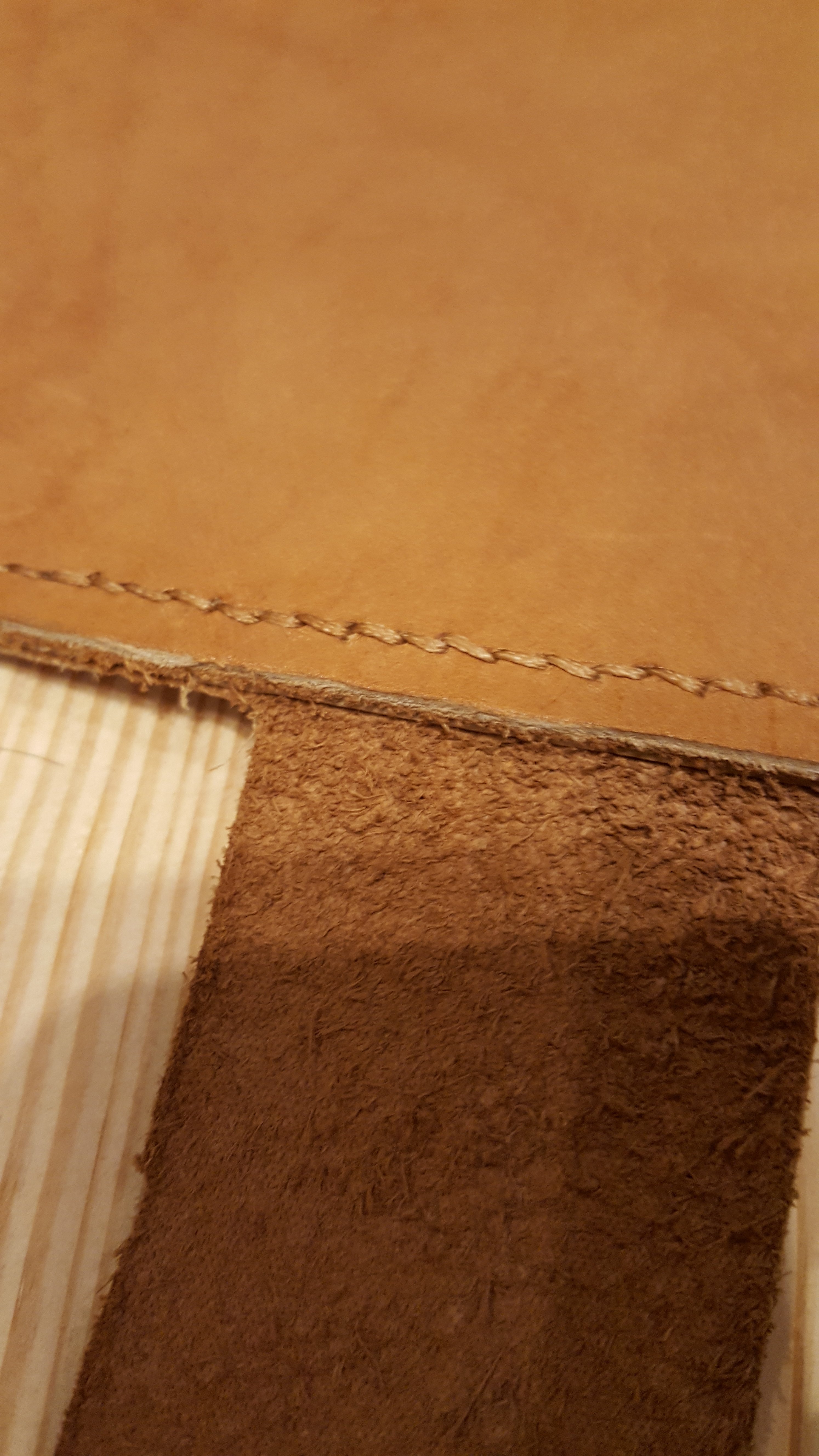

And the stitch length I'm thinking of using on the backpack.

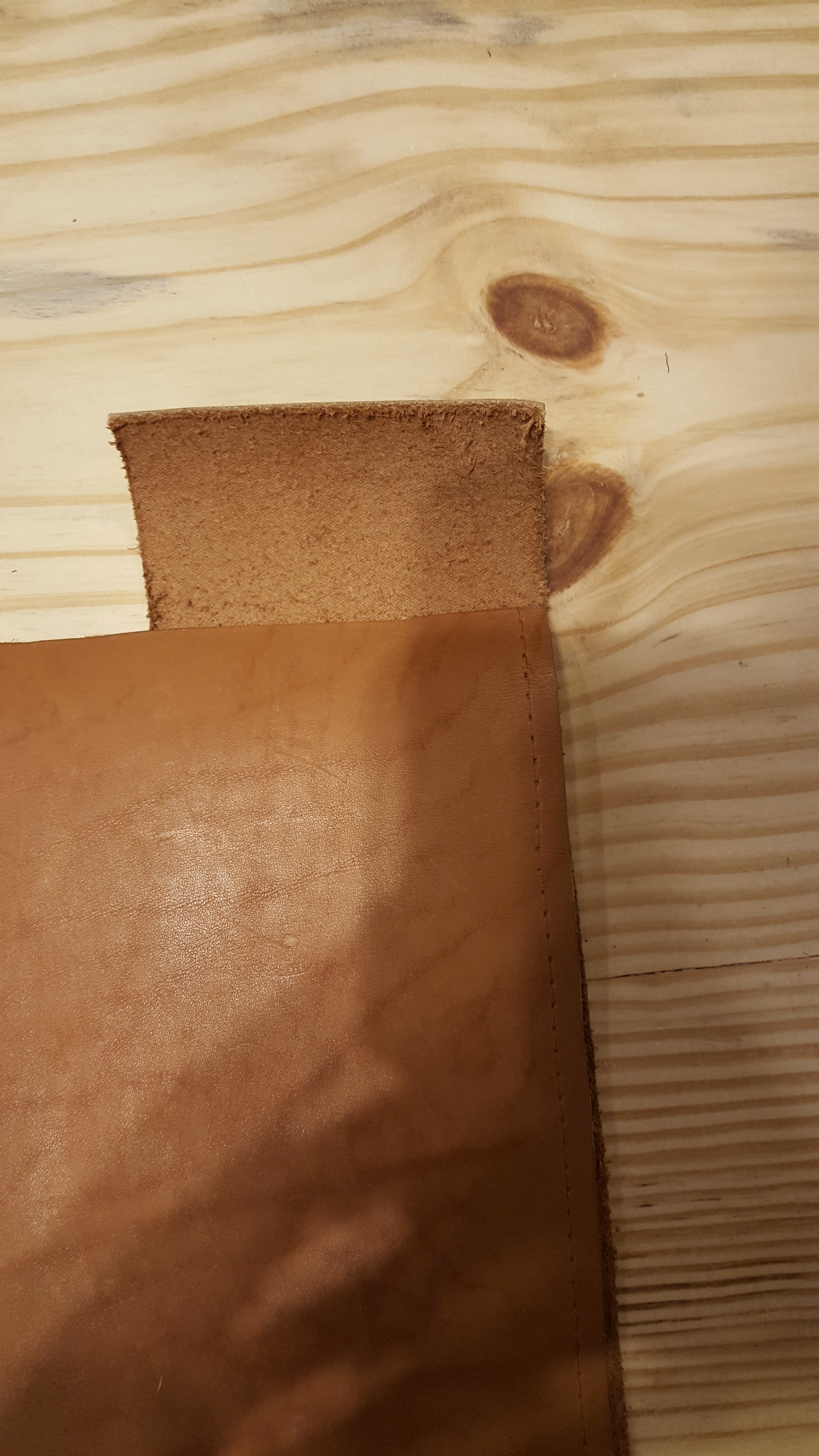

Slowly but surely, Progress! Oh, and I also had enough leather to cut my belt and the bracer! The belt is currently just a 3" strap, but that will change soon. In the meantime, backpacks rule!

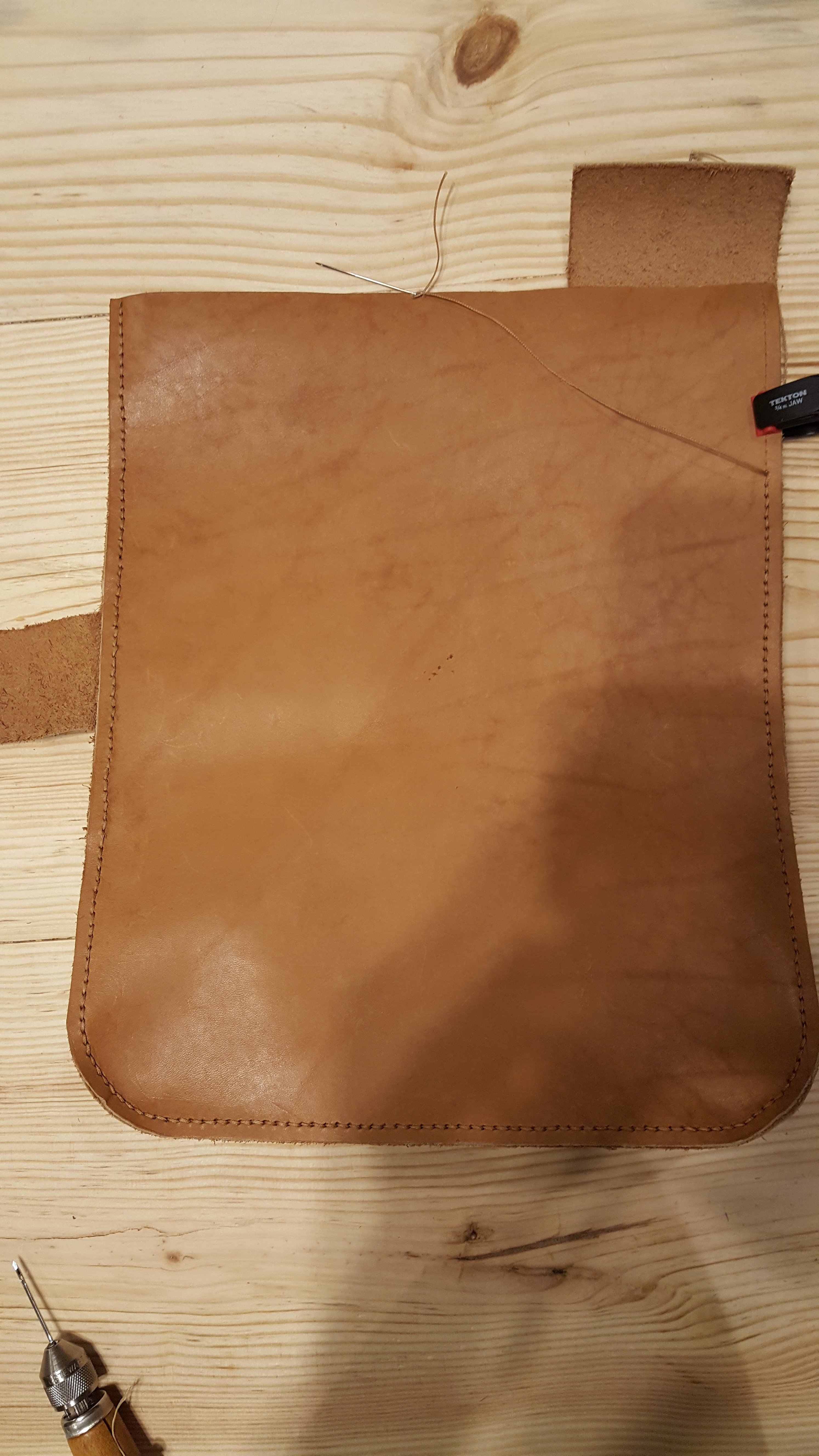

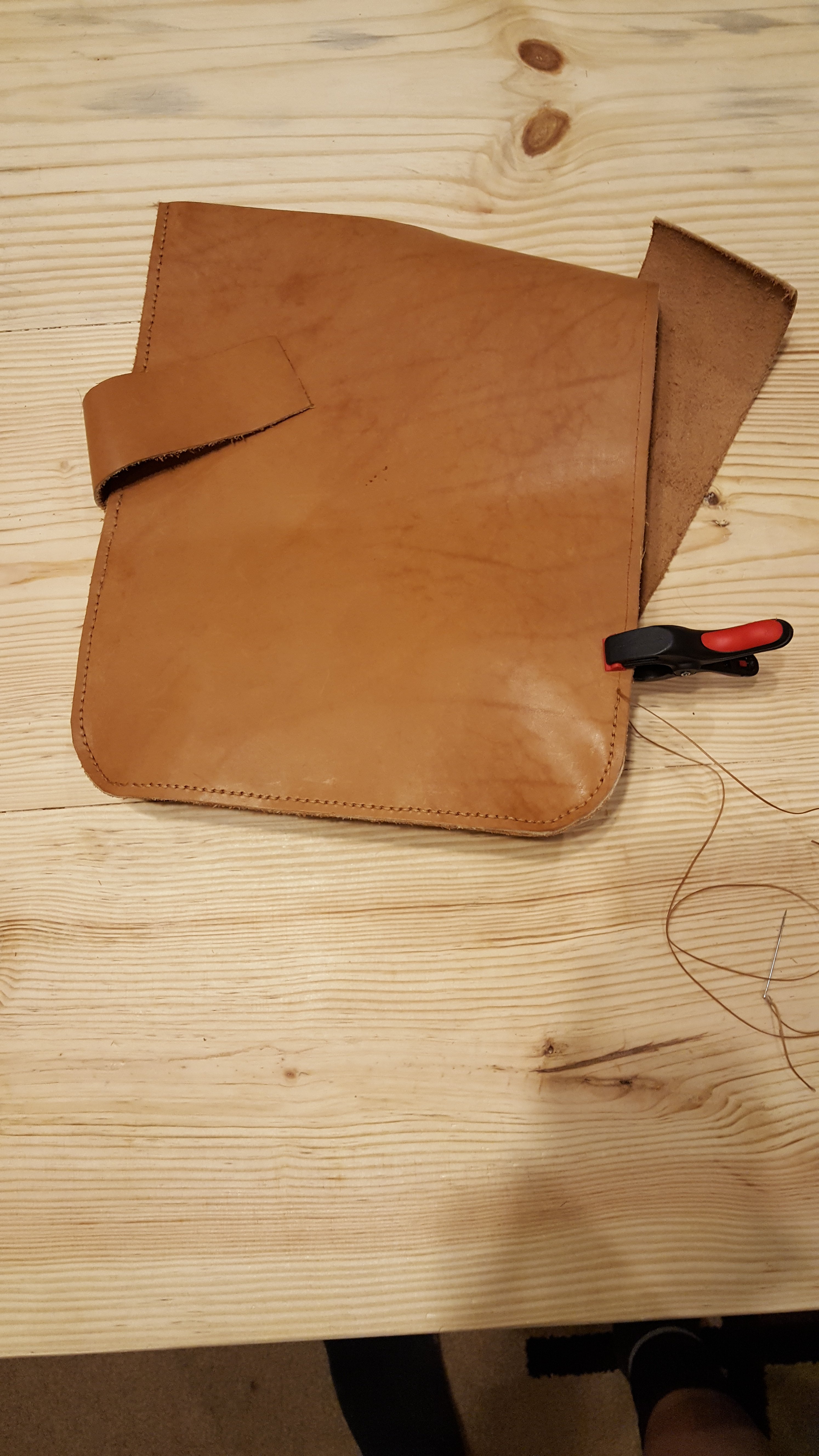

The side pocket was successfully sewed to the gusset and the gusset is now almost sewed to the front. I have now clue how I ended up with an extra inch and a half on the gusset when I only had one inch extra in case of mistakes. Ah well, better to have too much than too little.
20170126_213743.jpg 20170126_213750.jpg 20170126_213802.jpg 20170126_213805.jpg 20170126_213812.jpg 20170126_213827.jpg 20170126_221118.jpg
