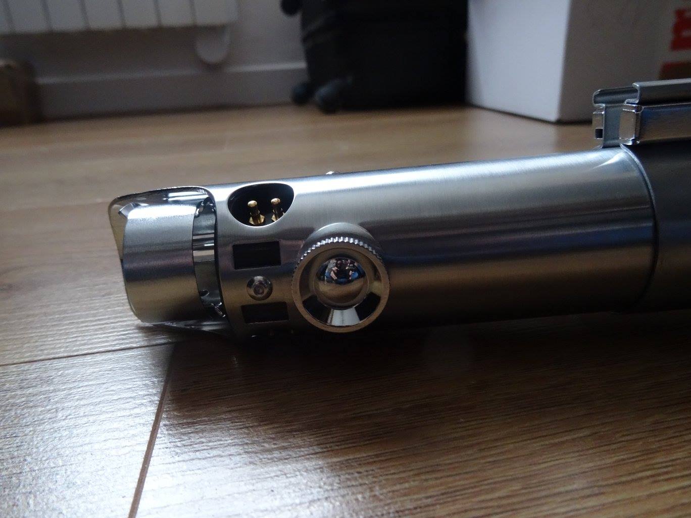

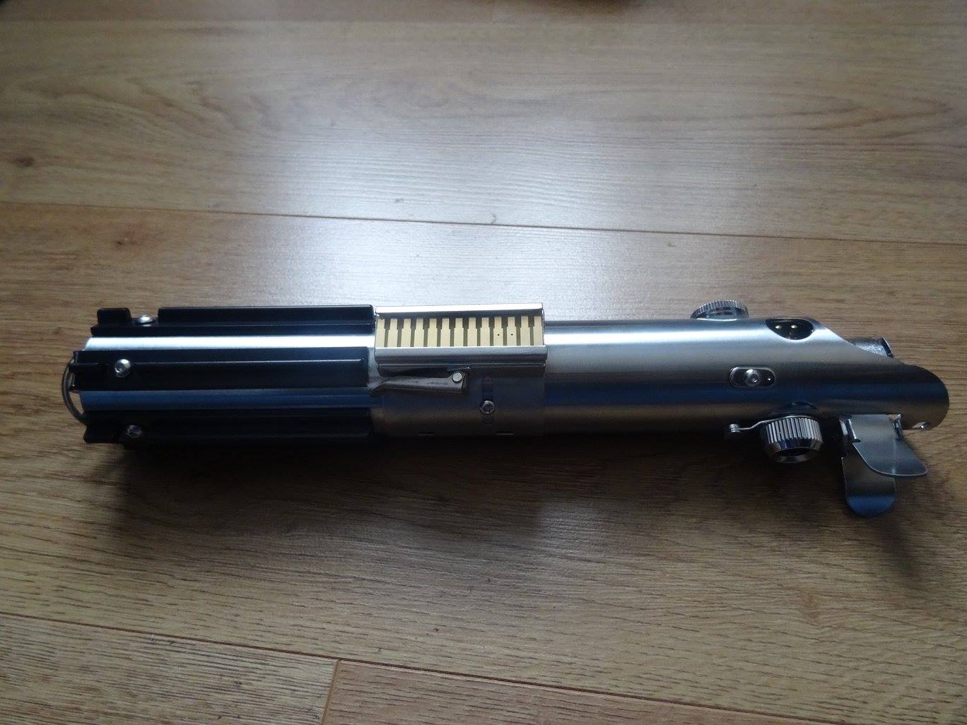

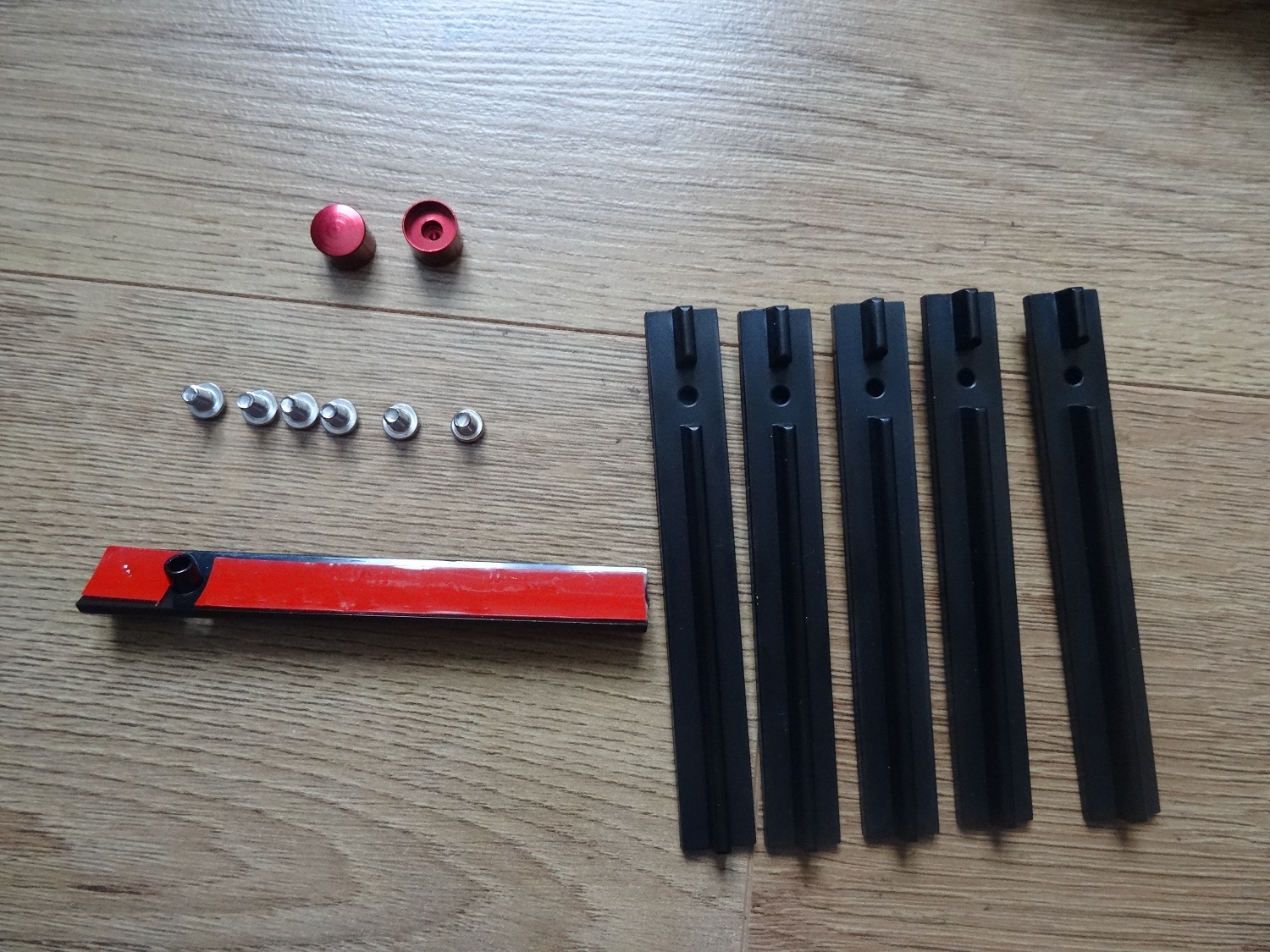

Here is a great video tutorial if you want to assemble a graflex 2.0 lightsaber : https://www.youtube.com/watch?v=UKOd8CxavVU&t=2998s
For TFA version, you'll need the ESB kit (with 6 graps) + ANH lens blade tension knob
almost finished... need to add the electronics and blade :)

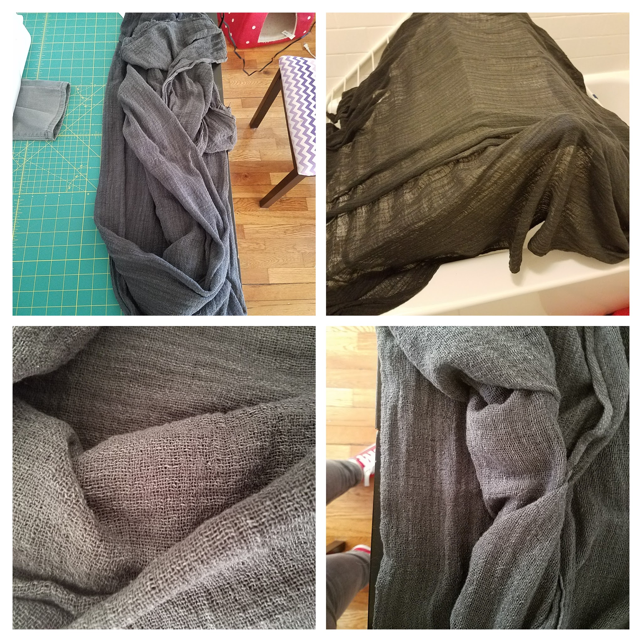

I dyed my Dharma wool gauze after much procrastinating. I was nervous. But it went great. Noteworthy is that I didn't really get any shrinkage. Just about an inch on the width.
I dyed 6 yards using Dharma's acid dye in silver grey. I put all the cool water in a big (huge) pot added the dye ( the fabric is light so only weighed about 9oz. So I did 1.5% of the weight to figure out the amount of dye. Came to .03 ounces. But I doubled that because I knew I wanted it to be darker). Then added the fabric before heating it all up. It took well over an hour to reach 185° so I could add the vinegar. But the slow heating and gentil agitation kept the wool from felting and shrinking much. The dye never really fully exhausted (I think because the pot was so big) so I pulled the wool out and let it sit in a bowl to cool before rinsing. Very little dye rinsed out, so it's nice and color fast. At first I was super afraid of gone too dark but after it dried and after seeing new pictures from the recently released behind the scenes feature I think I'm pretty close! Phew! I hope this long ramble is helpful to anyone else using the wool gauze. It's lovely stuff! I want all my clothes made out of it now. Soft!
Her are some initial pics. The darker fabric is my obi. I'll try and get more with the tunic soon.

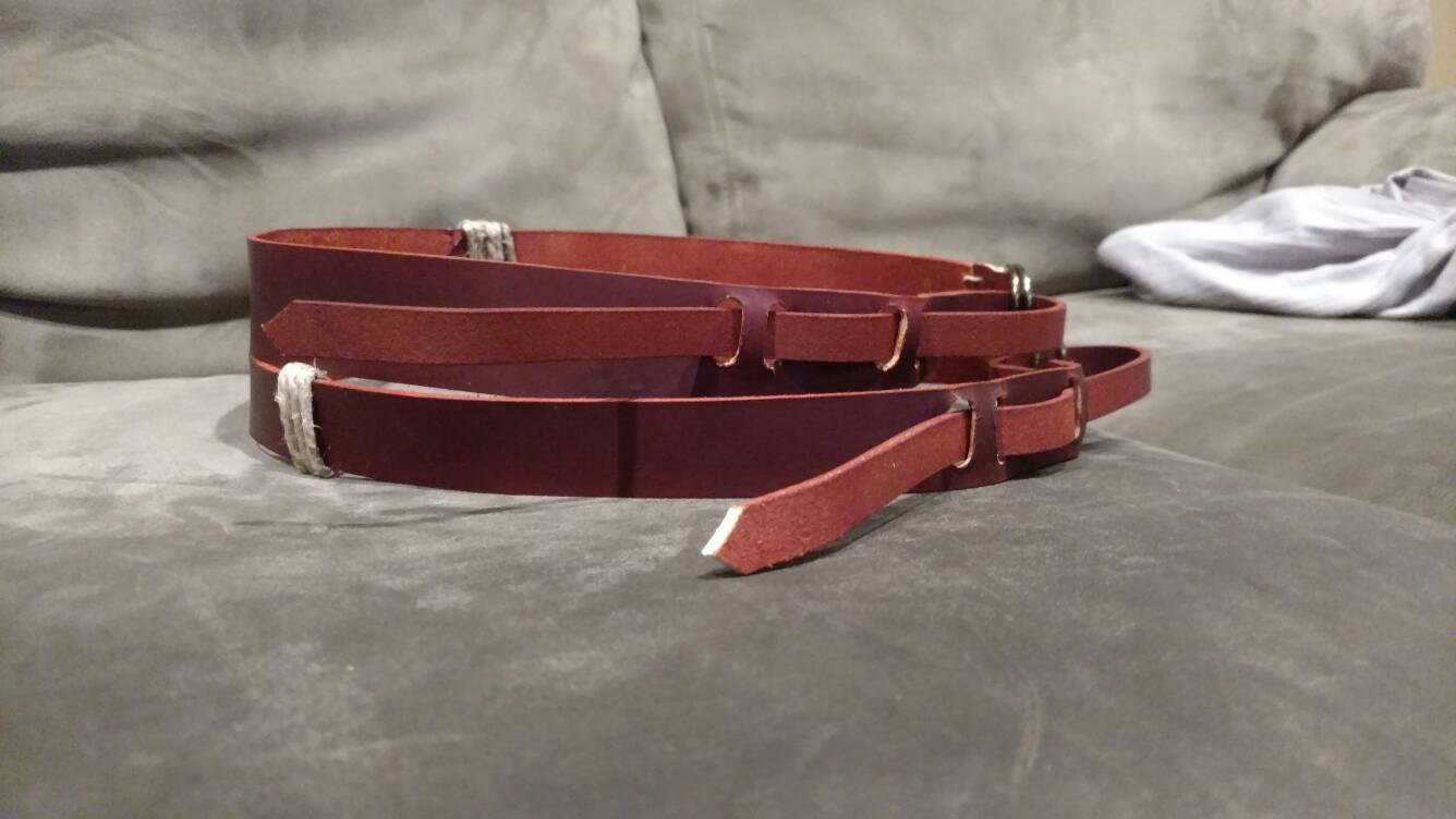

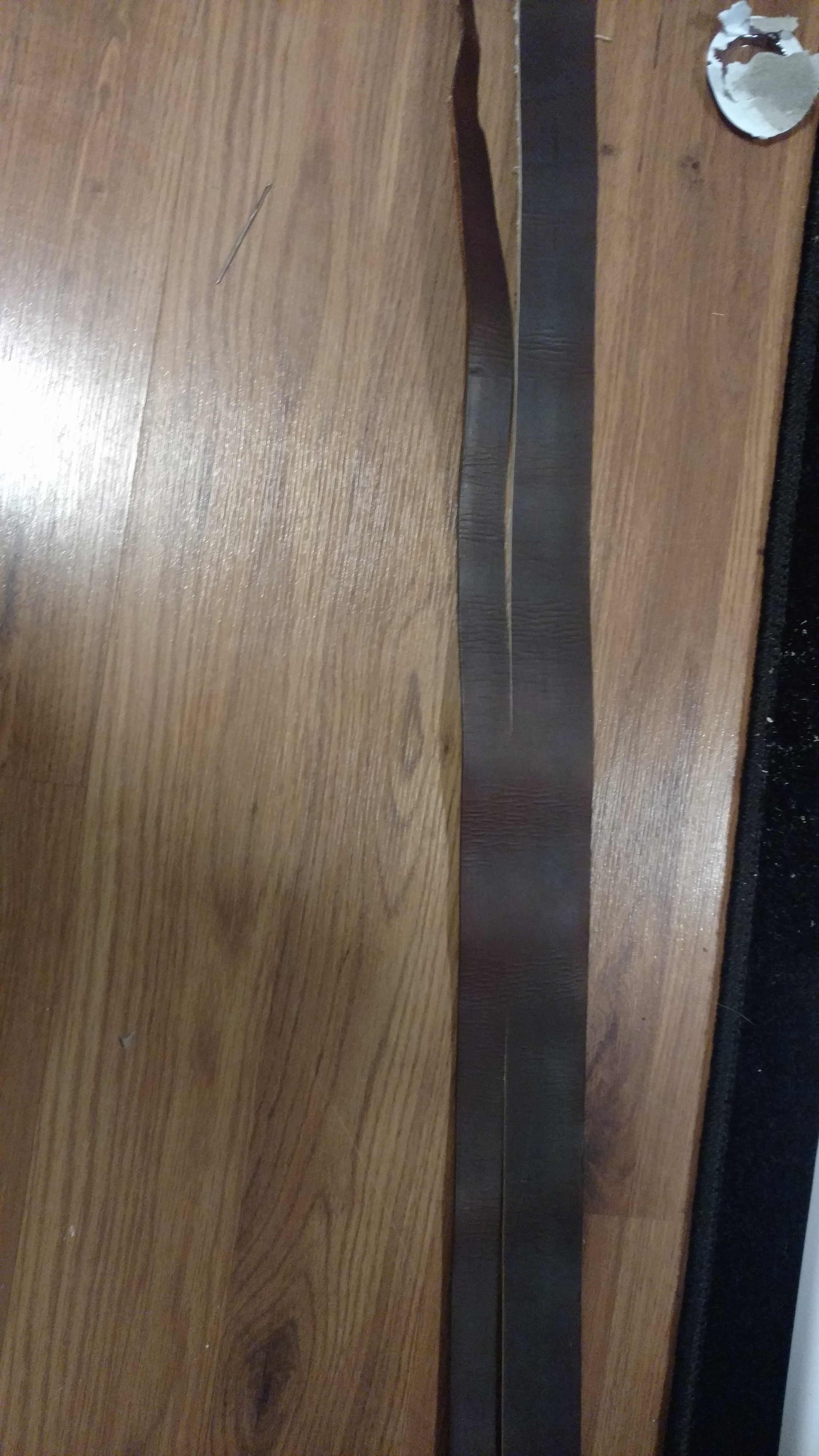

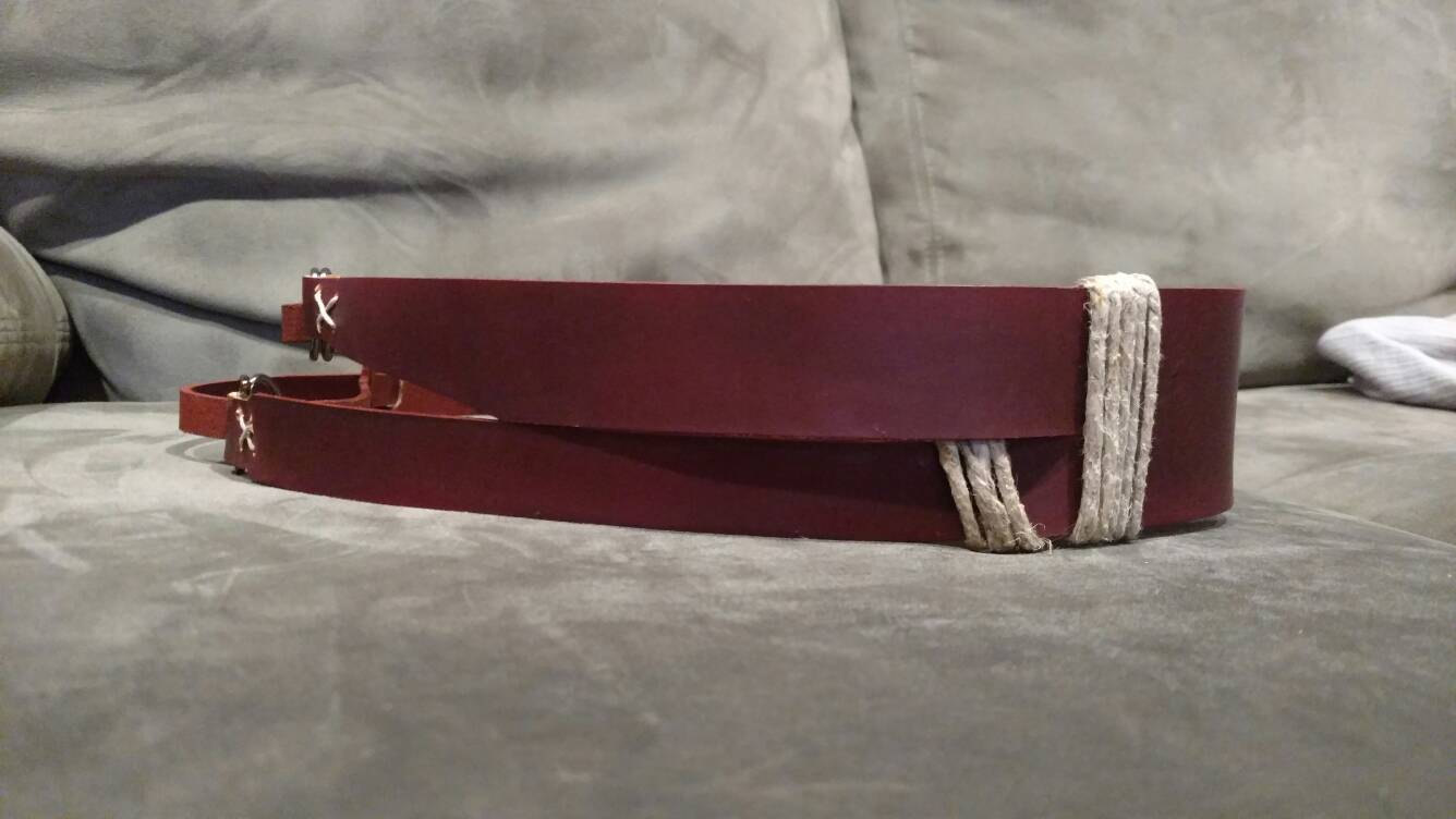

Alright I really didnt like the color of the belt I posted before. So I did what any idiot would do and started over from scratch. This is the new color of dye that I created by mixing many different other dyes together. It is much more brown than the one from above but still has the hint of red that I think is there. I really like this one and I think it might be my final product. I just want to see what the right side looks like before I do my final cut.beltNewColor.jpg
Does anyone have any pictures of the right side hip so I can see what the belt loops look like and what she will be using to hang her lightsaber?
Edit... found some. Would still like to see how the lightsaber is clipped.
