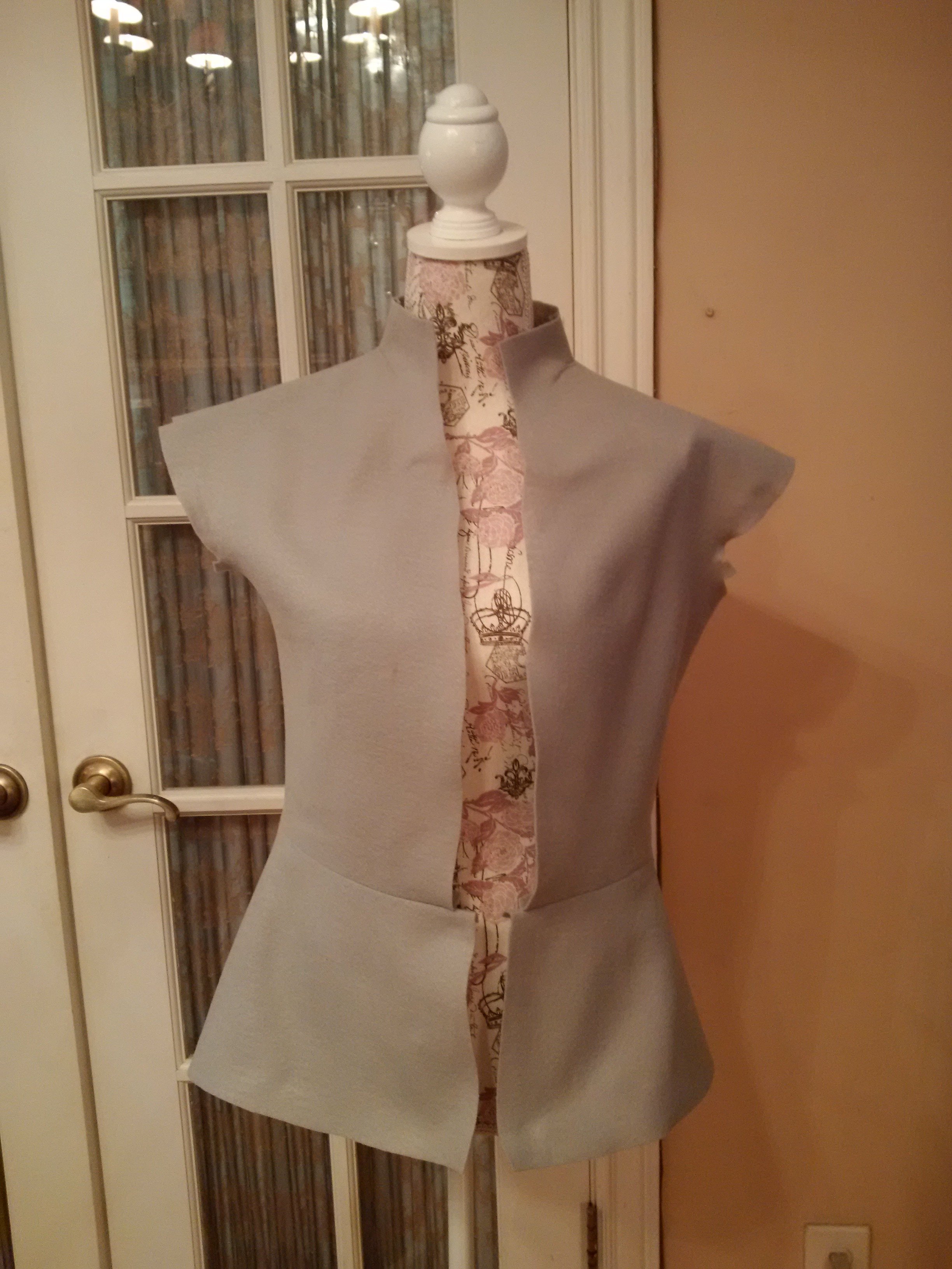

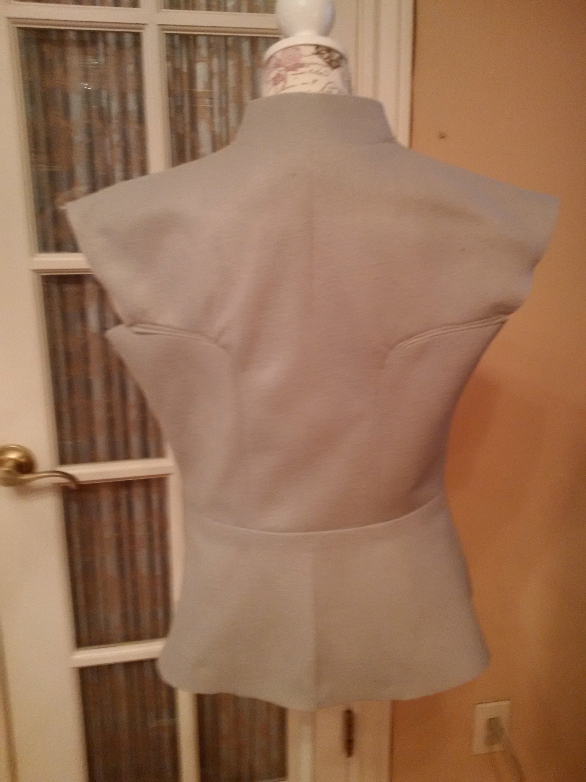

Holidays have taken over but I'm slowly making progress, here's my felt version, still with some unresolved seam allowance decisions which appear in this version as mismatched seam-sewing.
It fits me but I am hating how unflattering it is when it falls open, it just turns me into a giant block up top which I am still convinced would be fixed if there were darts or princess seams. Or does the front not line up? Is it supposed to fall open in a triangle shape, instead of a straight match (as if you could put in a zipper and it would fit perfect? Sorry I'm probably not using the correct terminology.
That's great progress.
I dont think it's supposed to look flattering, it's supposed to look like she just scrounged it from the Resistance Base Goodwill Store.

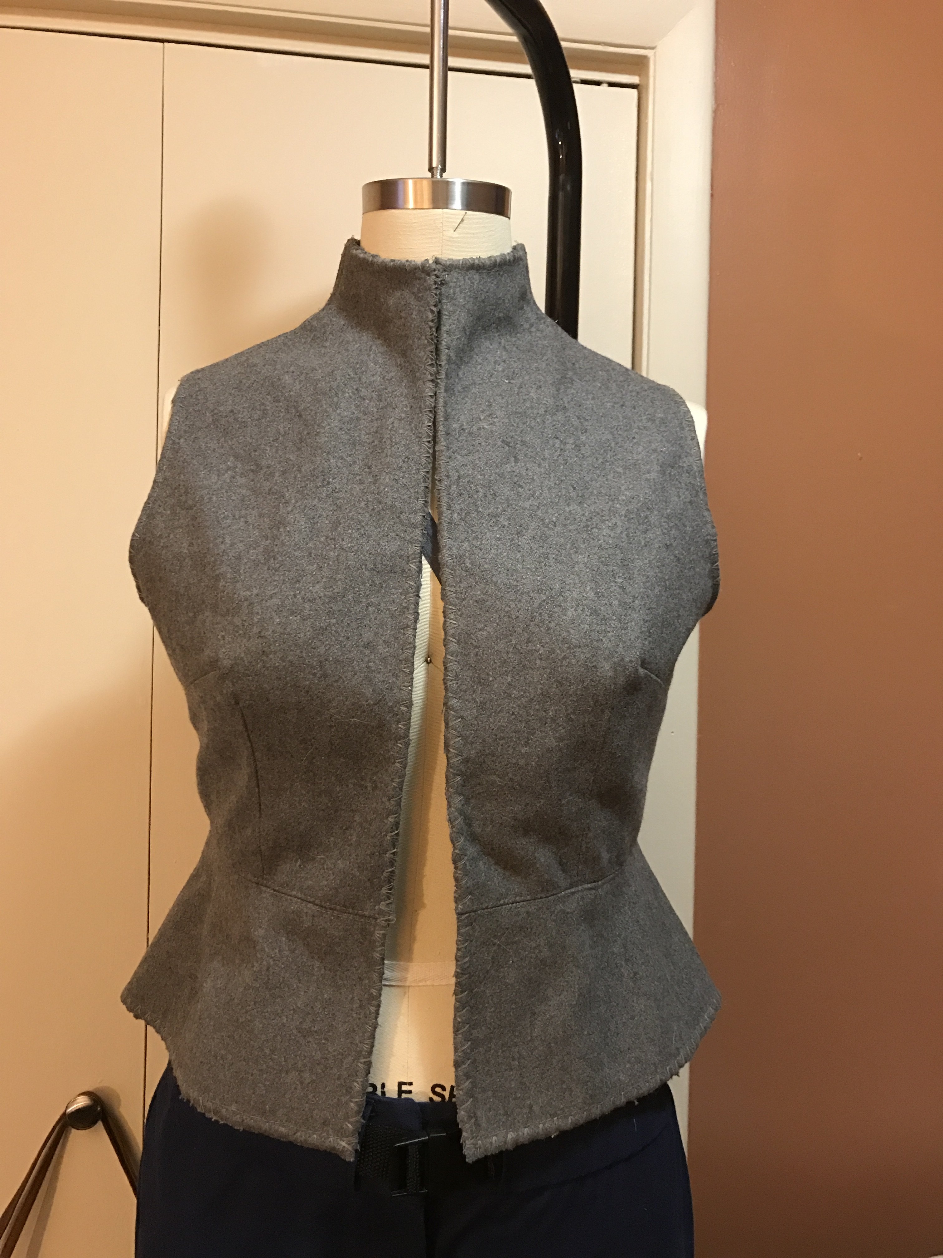

Thanks! Just to clarify, what I linked before (the boucle fabric) was a mock up. I am nearly done with the actual jacket now. Will post photos tomorrow. I need to do the internal stitching in the casing seams. will do that while watching Westworld tonight! :D

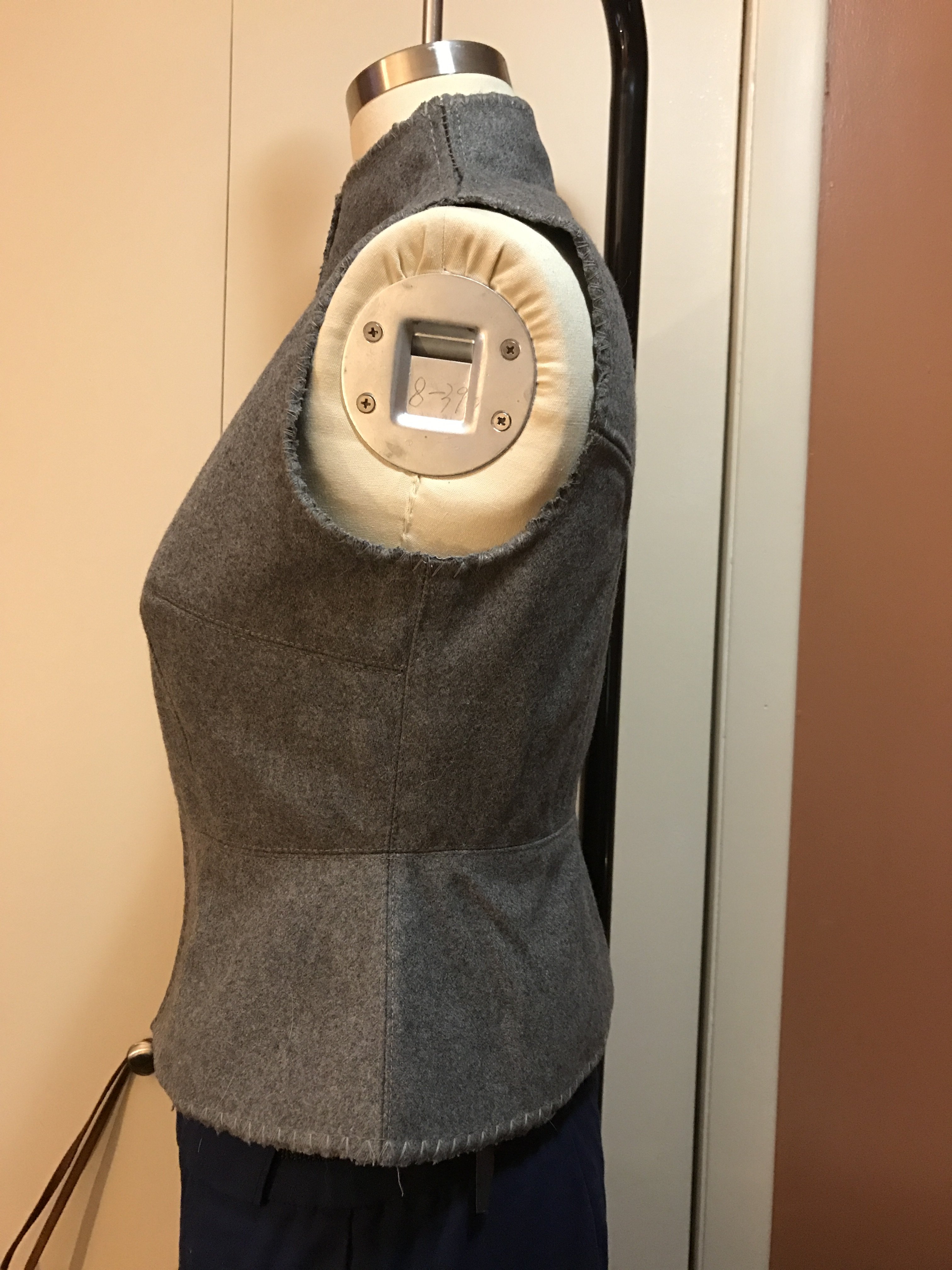

I didn't use a princess seams thought - I used a waist seam dart and then a side seam dart. I will probably remove the waist dart in future versions.
This looks beautiful!! Inspires me to put my front princess seams back in, it just looks soooo much better with a proper fit!
Wow! You even got the visible stitching in-between the shoulder seams! How did you do that?

I've been lurking around this thread for months now, since I plan to make my best friend this costume for when we go to Star Wars Celebration in Orlando next year. Just wanted to comment on the stitching up the side of the neck and on the back, in the curved seams-- that's a technique called faggotting (*winces*, but it is what it is). It's often used when making baptismal gowns for babies, lol. Here's a few great links about it!
https://www.pinterest.com/pin/275282595945273120/
http://sewnso.blogspot.com/2012/09/bridging-gap.html
I can't remember if anyone's talked about faggotting in this thread before, but I hope this is helpful! Can't wait to post my own progress once I get started.
Thanks everyone! I used 4 ply of thread, twist them together first, and then a ladder stitch in the grove. But I made sure there is actually a grove/gap in the first place, and made sure to not tighten the sewing too much. Some places I didn't do so well in not tightening, :( Part of the learning. LOL!
This is the photo that I think explained the stitch clearly. http://myscrappyideas.com/basic-tutorials/gap-closing-ladder-stitch/

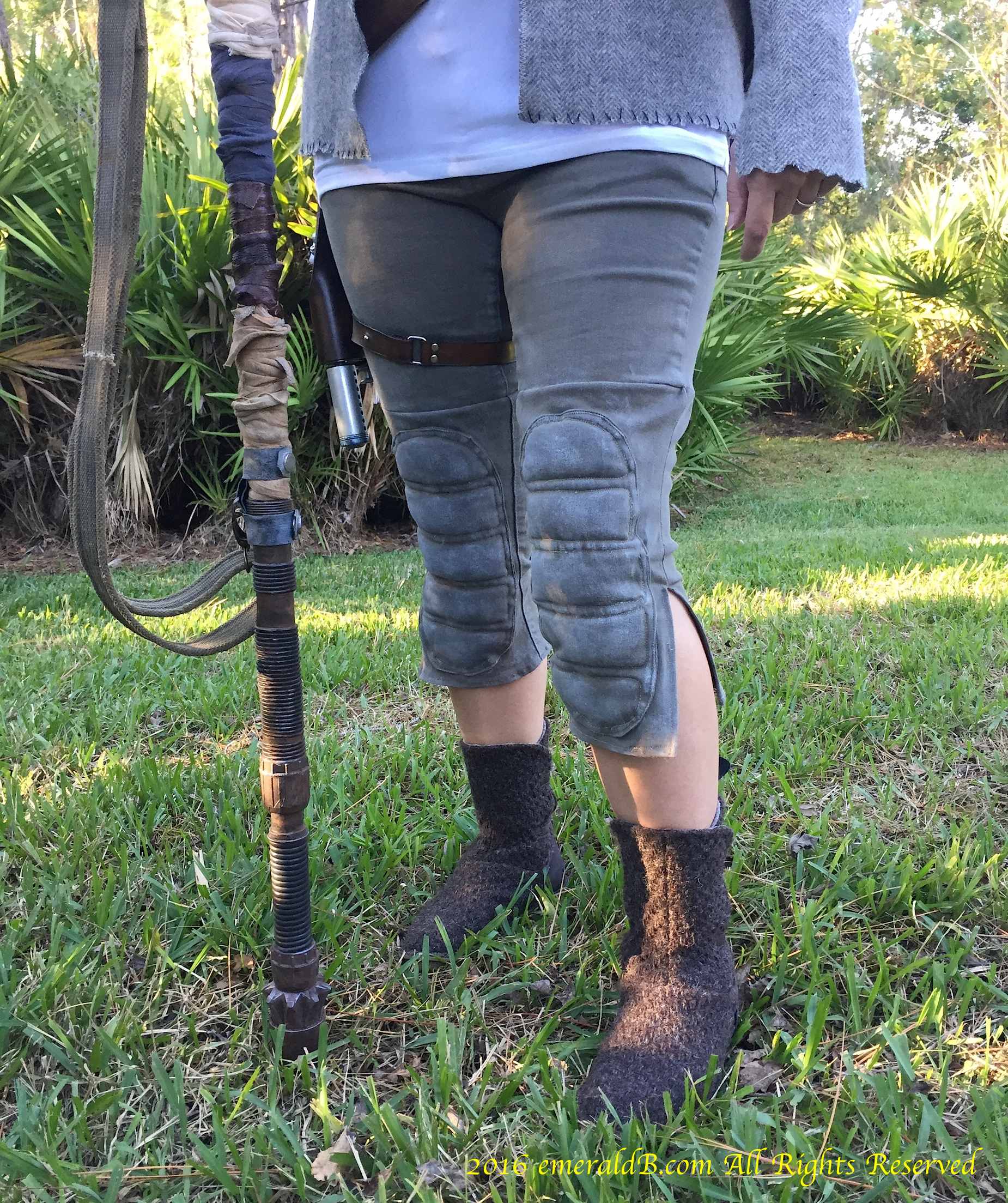

Hey guys! Just getting started on this. Thanks for all the resources! I'm a bit stumped on the pants. The Rebel Legion standard calls for brown but when I'm looking at the references photos all I'm seeing is grey. What pants did you buy?
Link to these ross pants is here, they are sort of olive, but can look gray or brown in diff lights.
https://emeraldb.com/2016/10/24/star-wars-rey-resistance-costume-part-4-pants/
i think they are wrong about brown, i believe i posted something a few pages back showing the pants color in relation to the brown holster and it appeared more gray green to me.

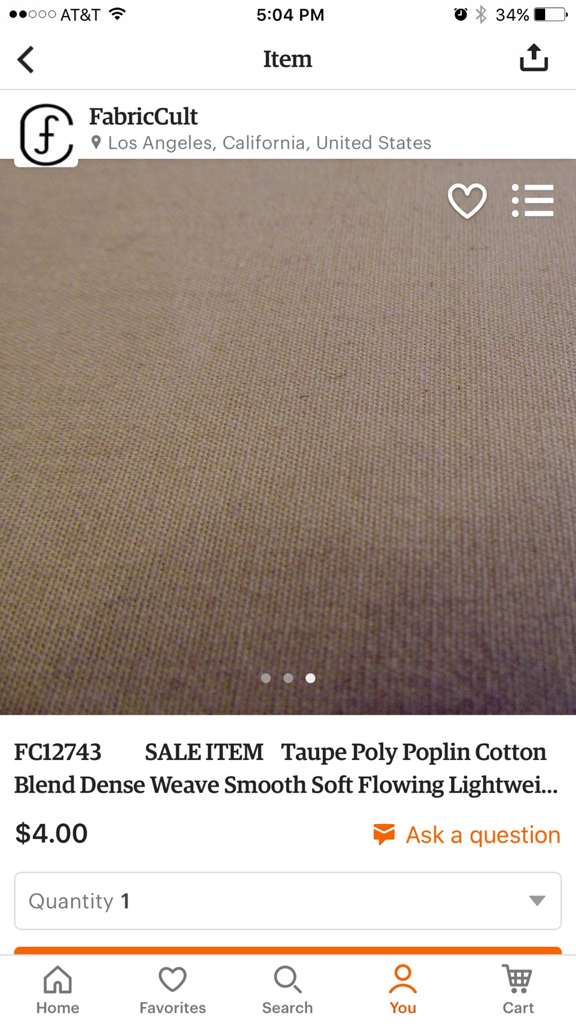

So after looking around for pants that look to be the right color, I think I'm going to order this fabric and try making pants for the first time. I'm feeling pretty optimistic about it.
