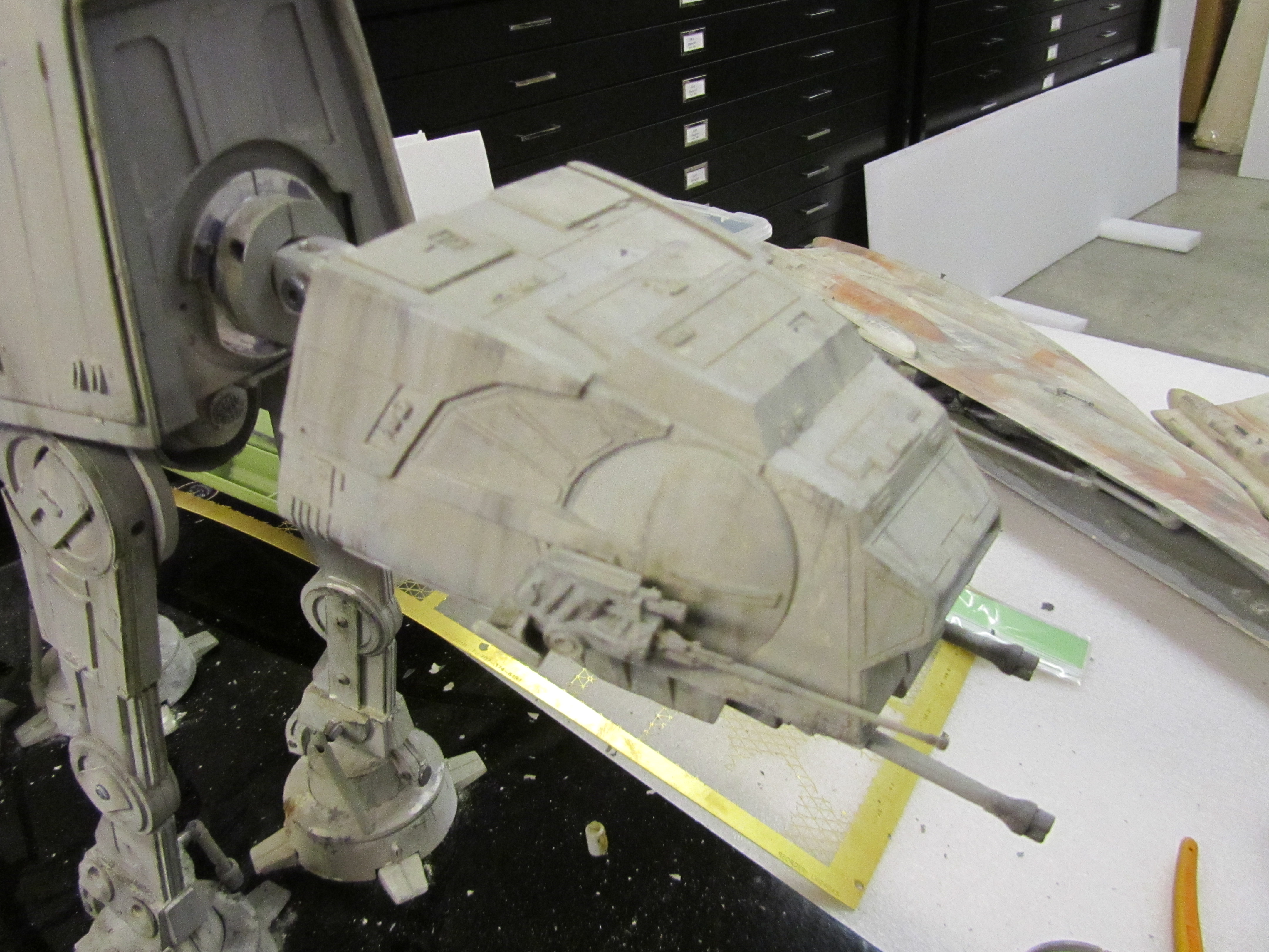

I was having a look at the side guns but am having trouble finding strong reference pics for the studio model as they're broken on the pics on the modellers magic page. does anyone have any good reference pics?

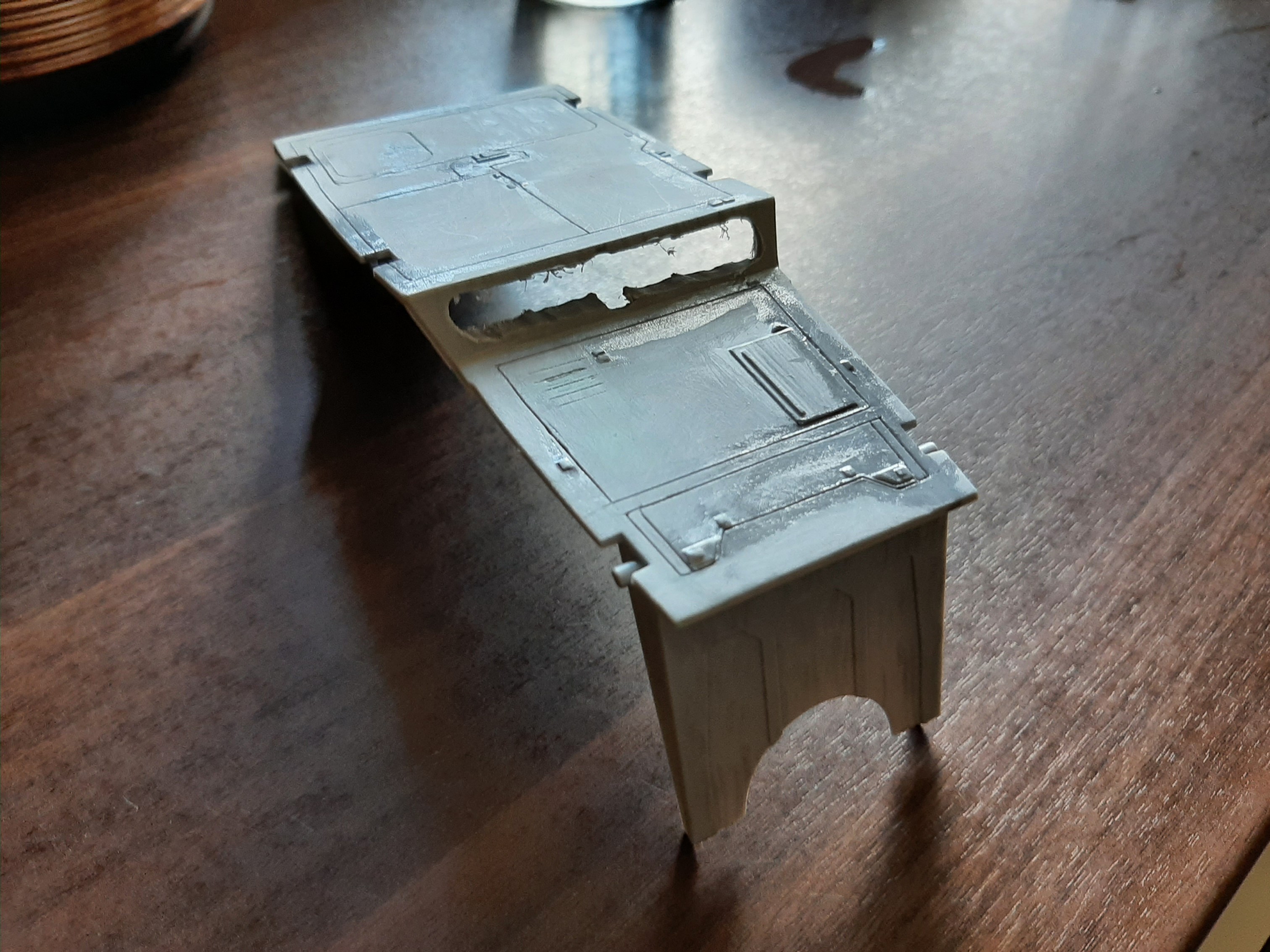

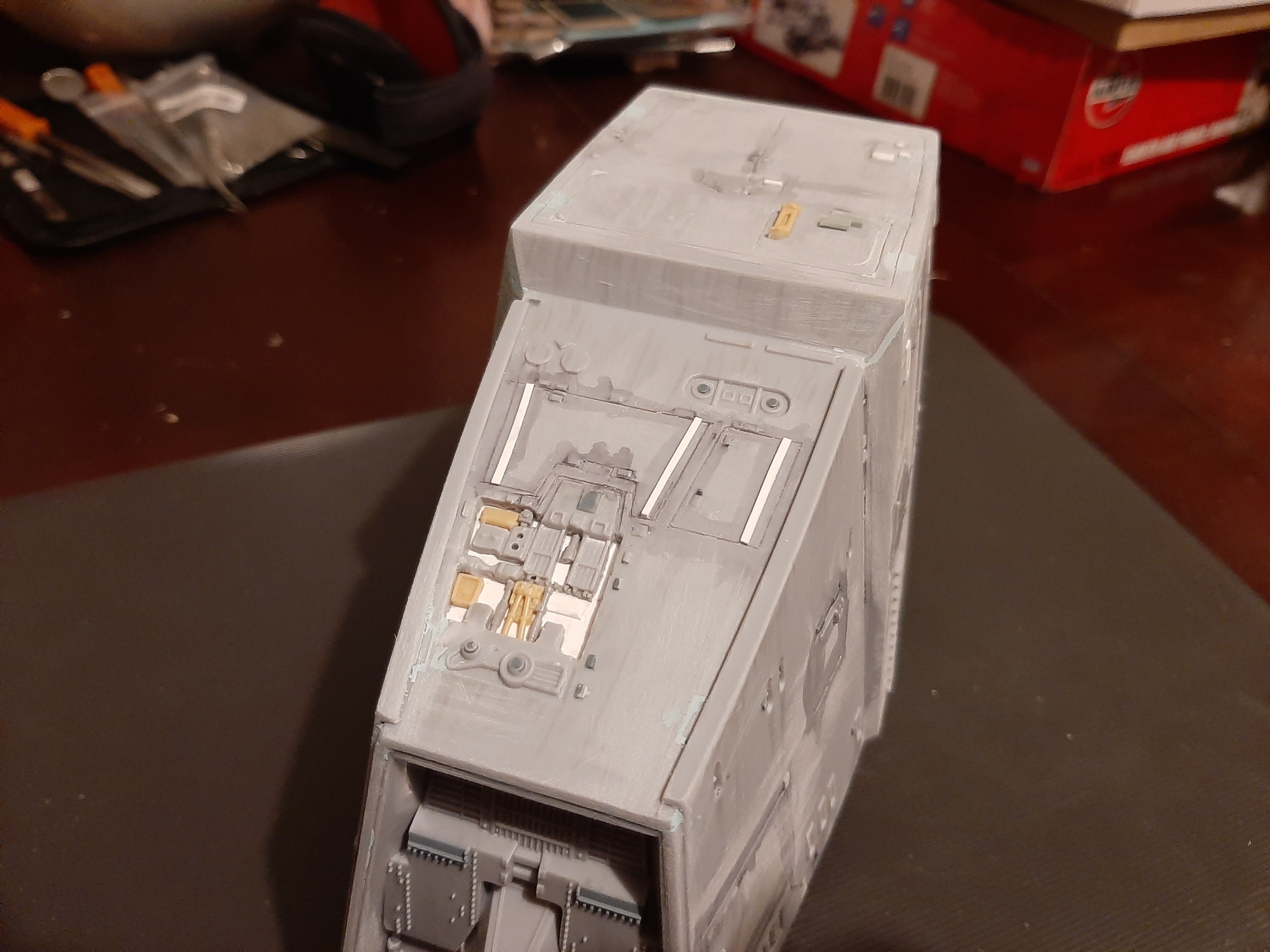

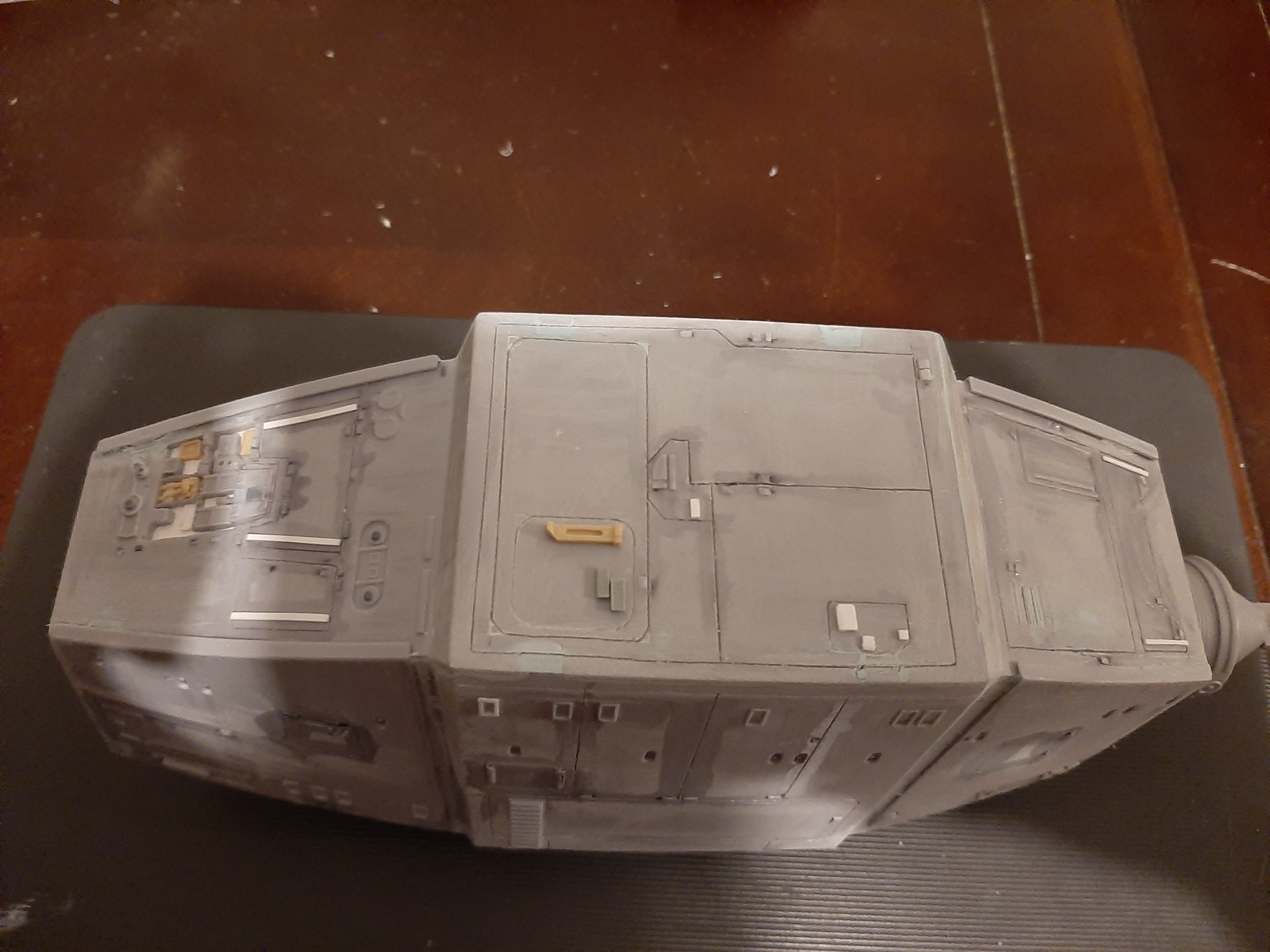

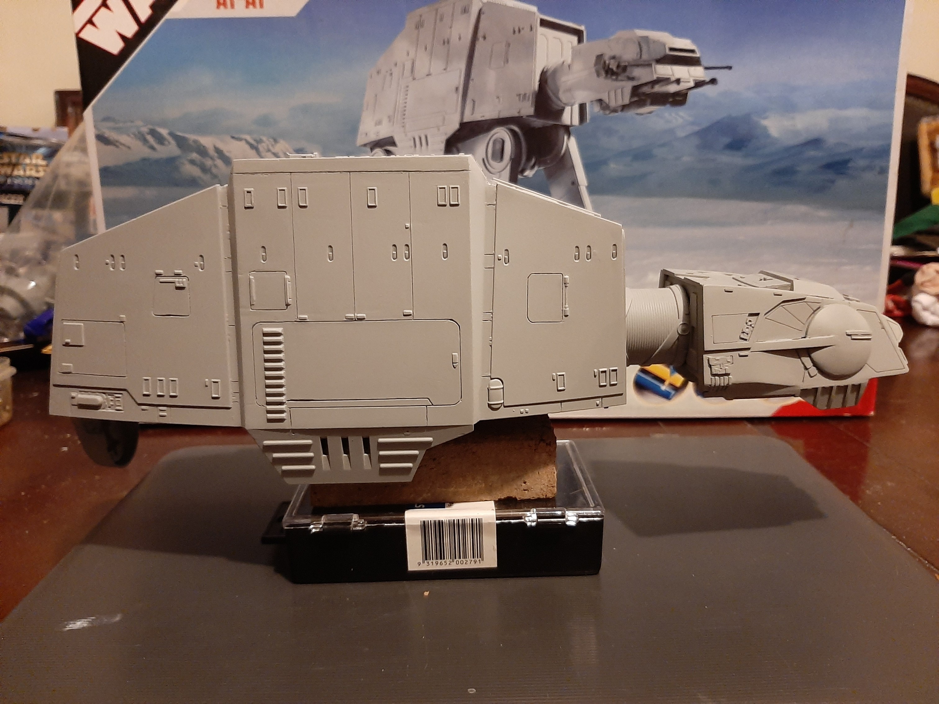

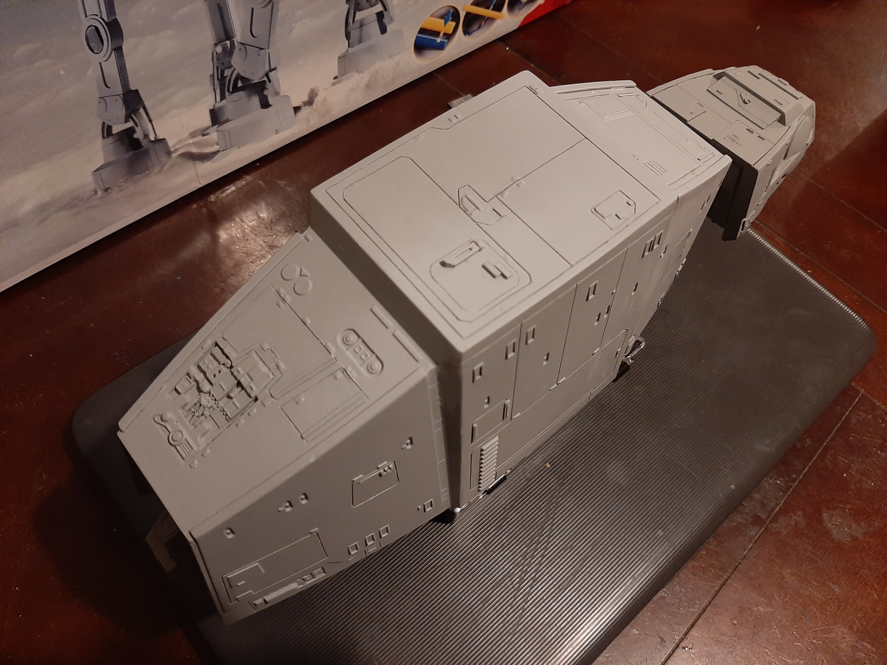

I started work on the body... figured this was all downhill after the head... well, no. A bit more climbing it seems. Again this does not need to be perfect but in an attempt to have it looking half correct the body just wasn't there for me. They actually got most of the details in the right places, an extra door to remove, had to remove a few of the rectangular greeblies and make new ones from styrene rectangular box to put them in the right place. The top hatch detail was mirrored from the studio model so I had to remove that and scribe a new hatch and throw some greeblies in place. All of the panels lines were raised so I have removed those and made a terrible job at rescribing them but it looks O.k. This is really my first model doing panel lines and I am learning but it is challenging, especially curves. Weathering will be fixing some sins, as will filler and primer.

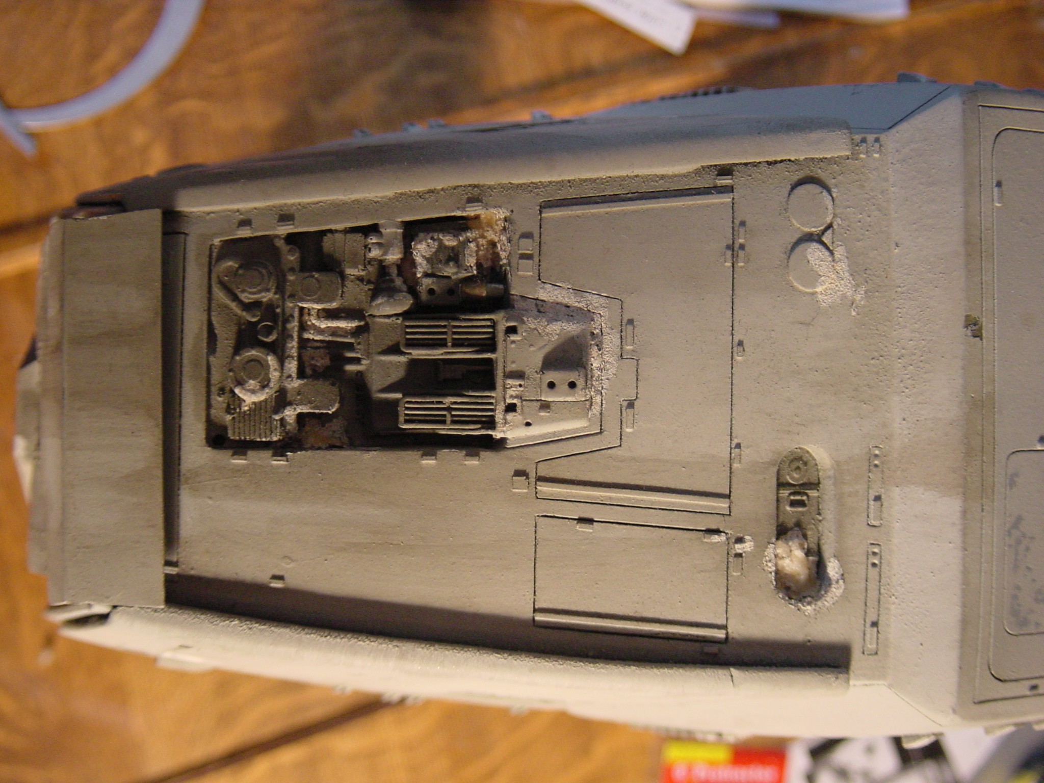

On the rear there's that sunken box section which the details were actually pretty good but it was far too shallow. Save reinventing the wheel here I dremeled, cut and filed around the existing detail which gave the added depth of the kits plastic floor then added a new floor from styrene, popped on a few similar greeblies. It is not an exact match to the studio model but gives it some depth and is in the ball park.

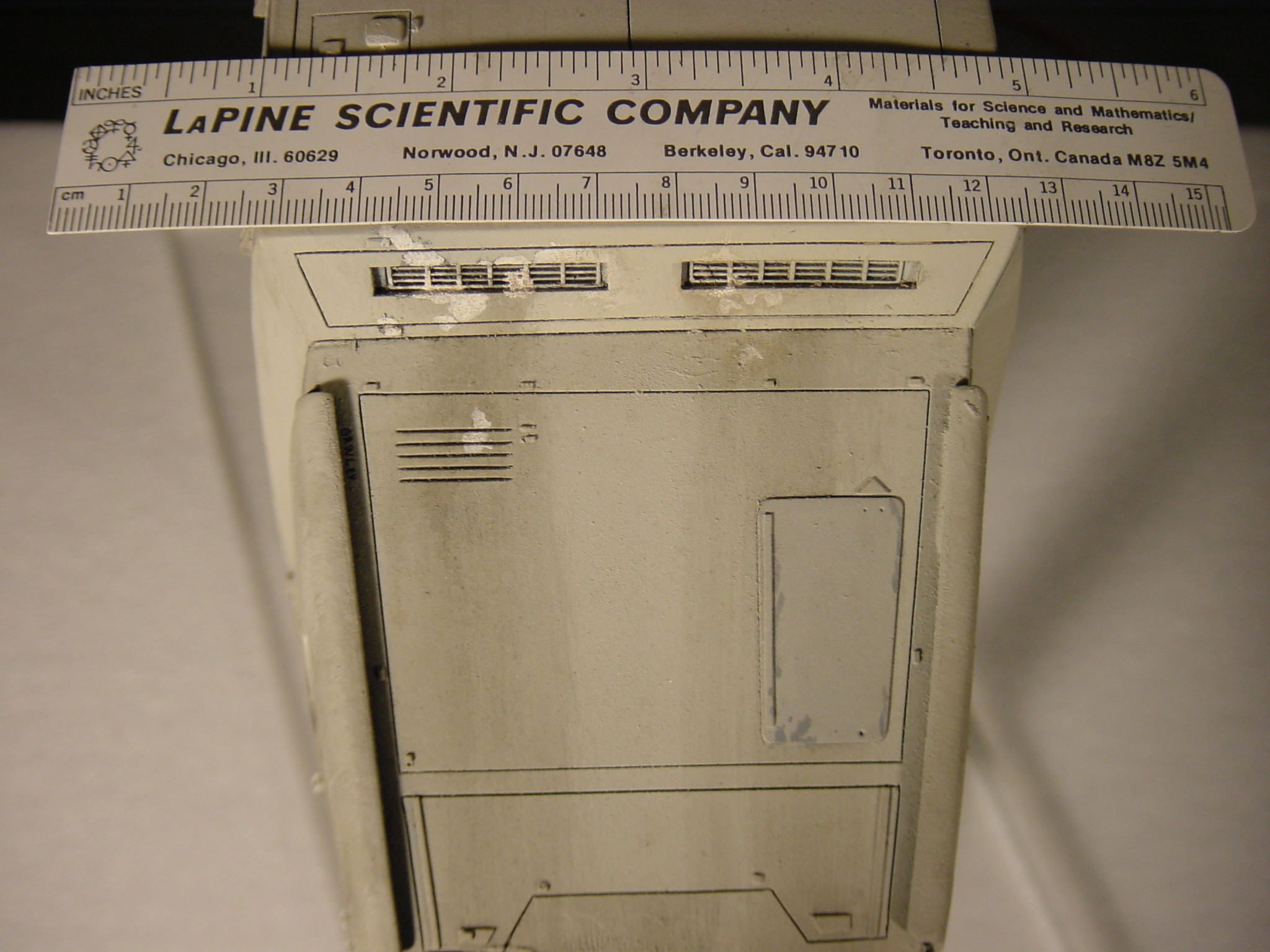

Also working on my replacement panel for the top vents ( but those pics will follow next time).

Funny enough, the Snowspeeder and AT-AT are basically the same color . For me I found Tamiya XF-19 with maybe a touch of white a great match, although I did mix in more white for my speeder since I always perceived them to be more white
And then for that one odd colored panel I used Tamiya XF-20

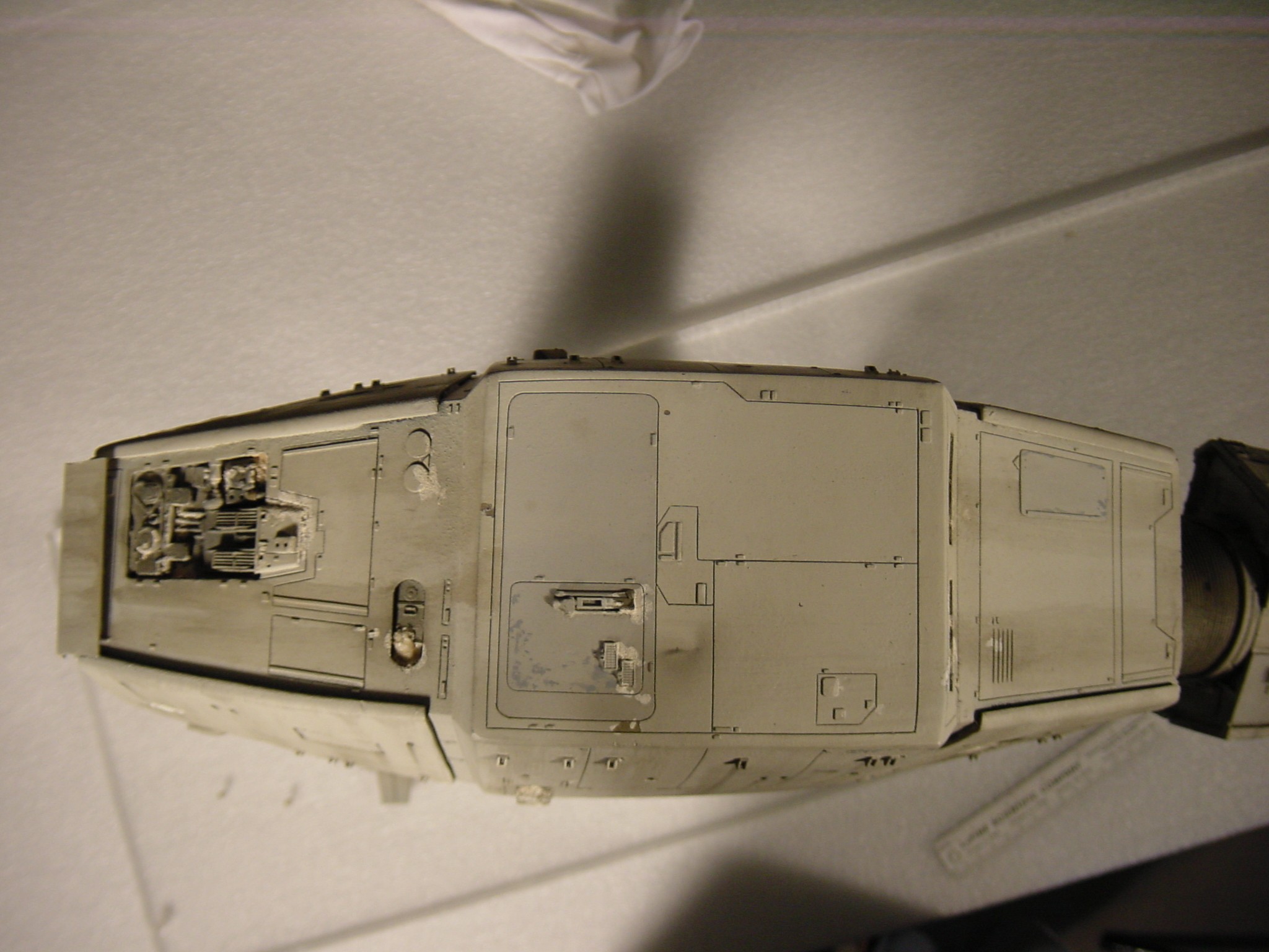

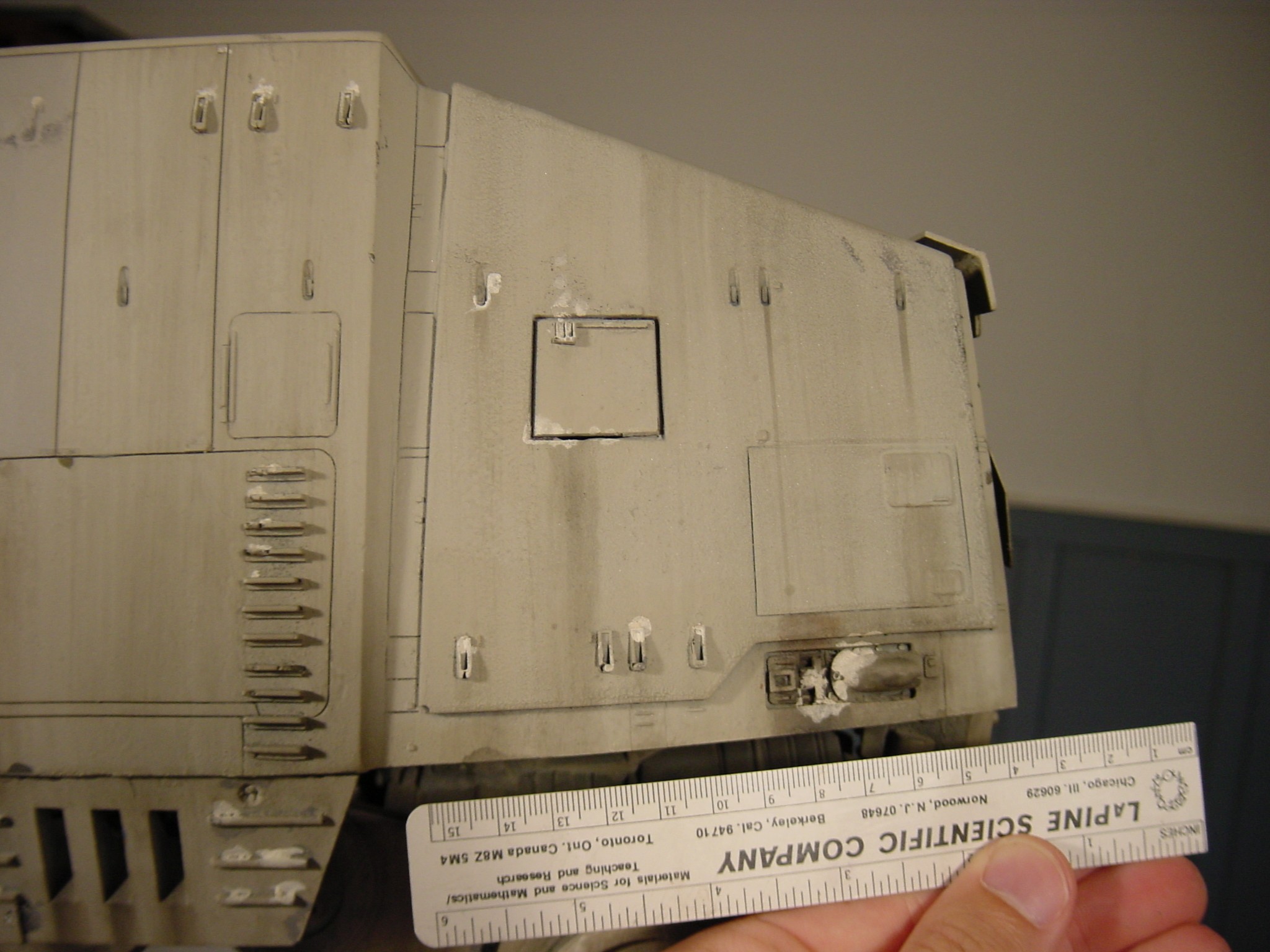

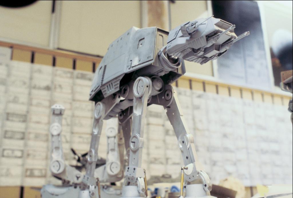

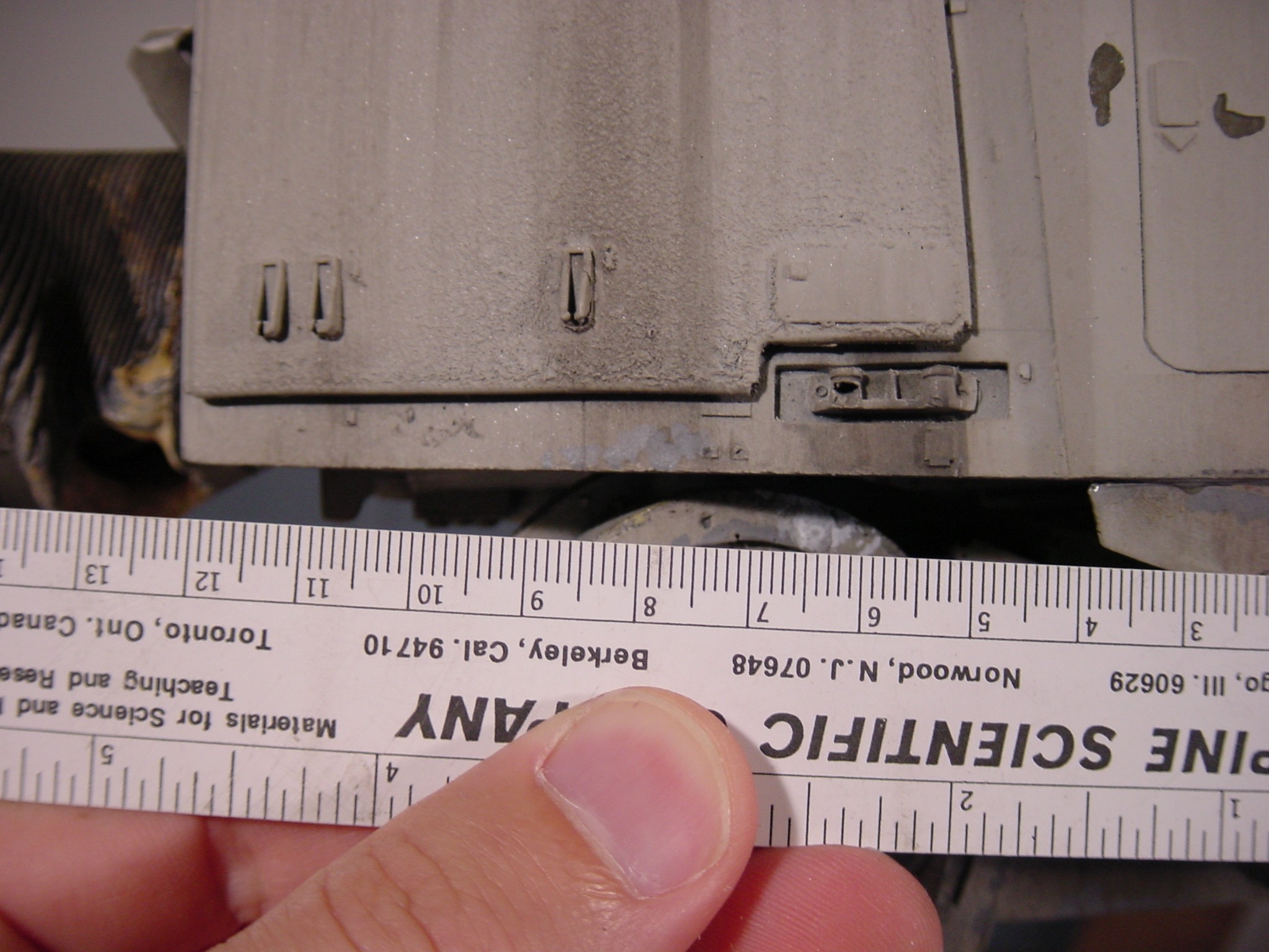

*NOTE These are some various things I collected over the years. Unfortunately I cannot properly credit those who took them and since they are not mine and I will gladly remove any of them if inappropriate to show them here
For my second one, I used this odd colored panel scheme
These came from Modeler's Miniatures & Magic
let me know if there are others you are looking for
At first glance I'd say ...that is an AT-AT. Amazing the amount of detail and adjustments you find to be added when you really look closely. Good stuff here!

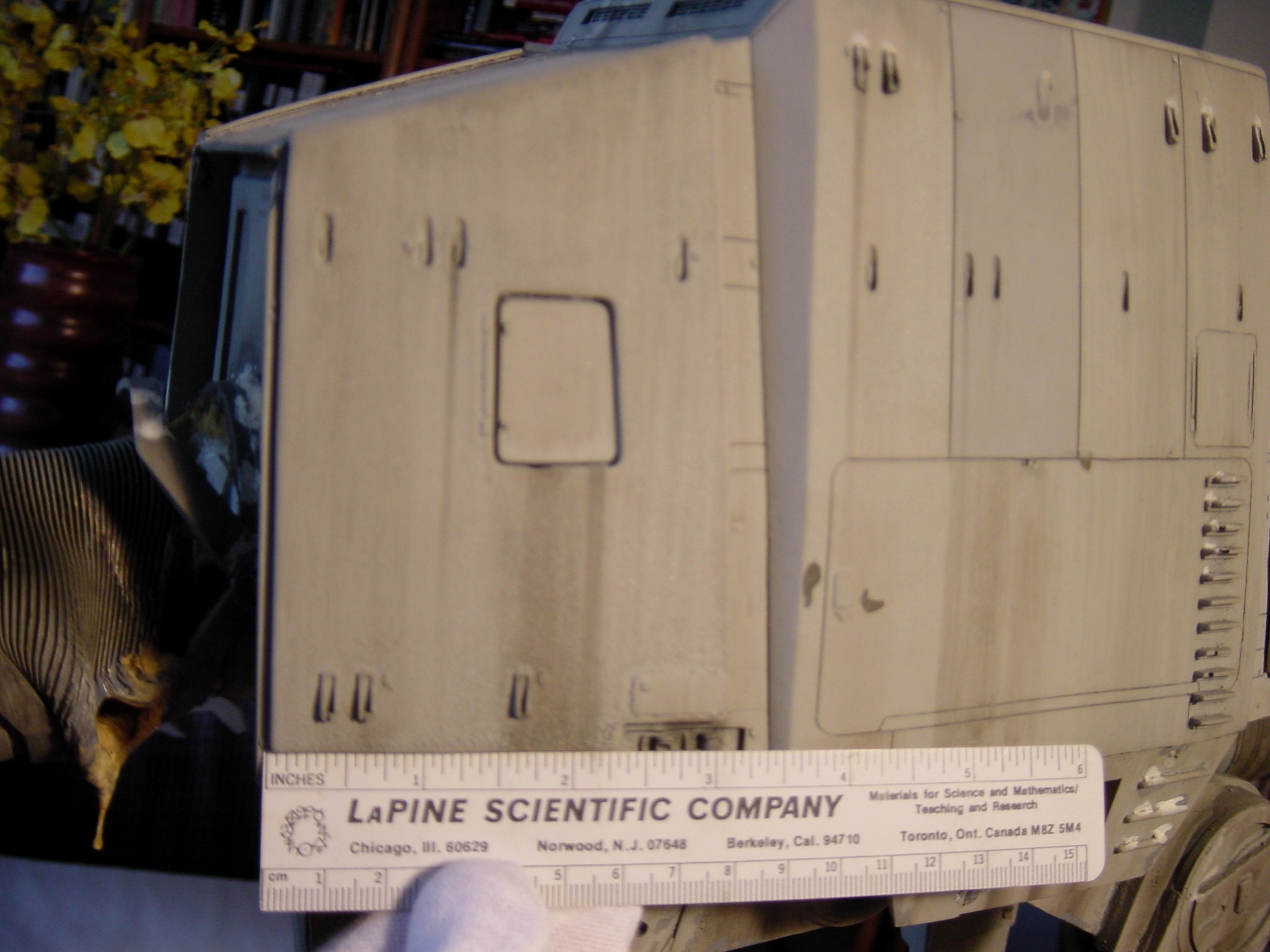

Also amazing how rough of a paint job there is on that too. I wonder if it was intentional or just classic "orange peel" issues
I had noted that finish and it seems like its only on the armoured plates and has that reflective sandy look you get on grip tape like on a skateboard so Im thinking deliberate.
As to why I dont know. Theres no chance for light/ gloss reflection through that texture so maybe on a white backdrop of snow they needed the model as matt as possible so the larger areas recieved this treatment? But every possibility it was intended to look that way.
Cheers
Josh

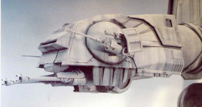

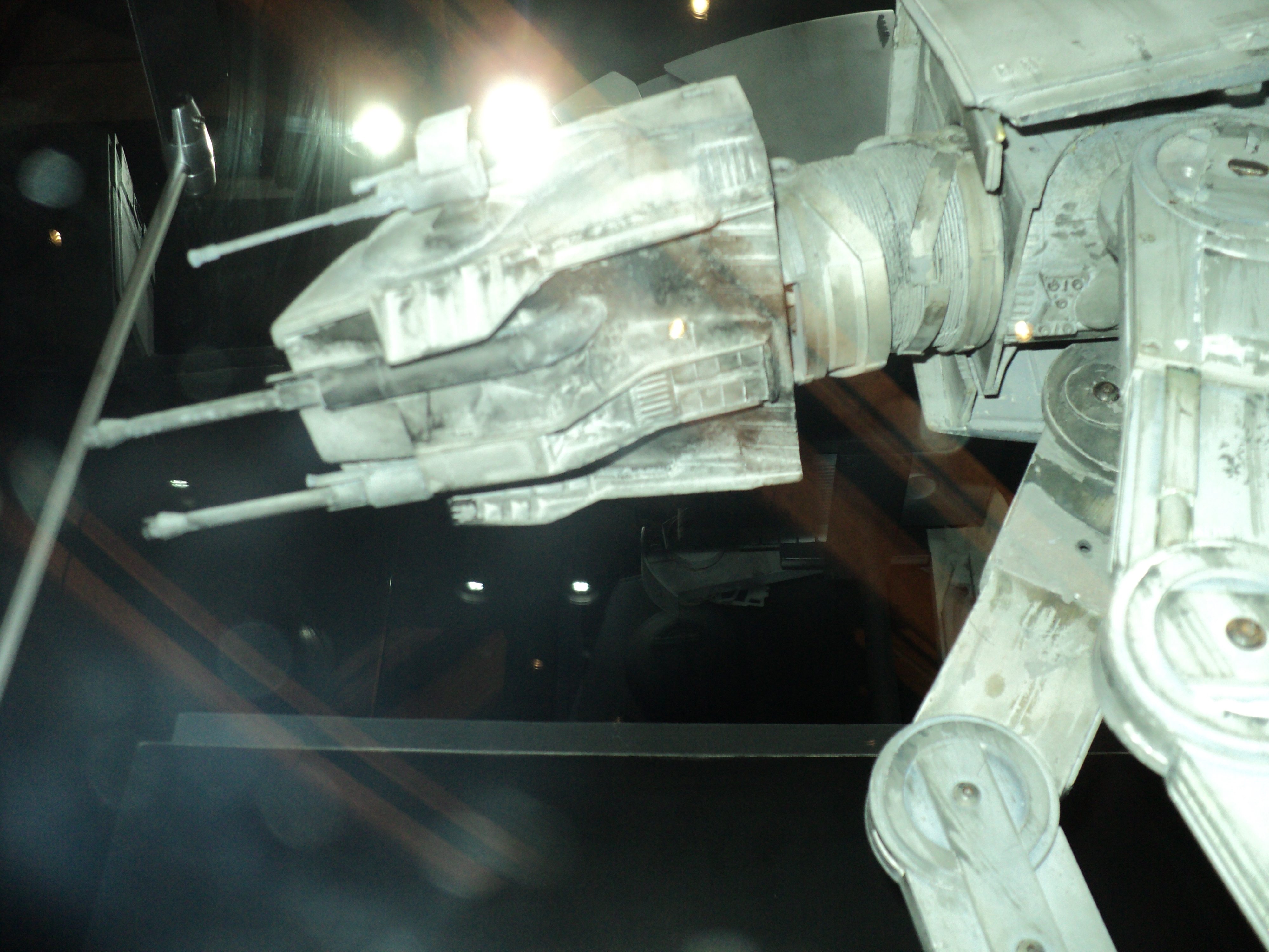

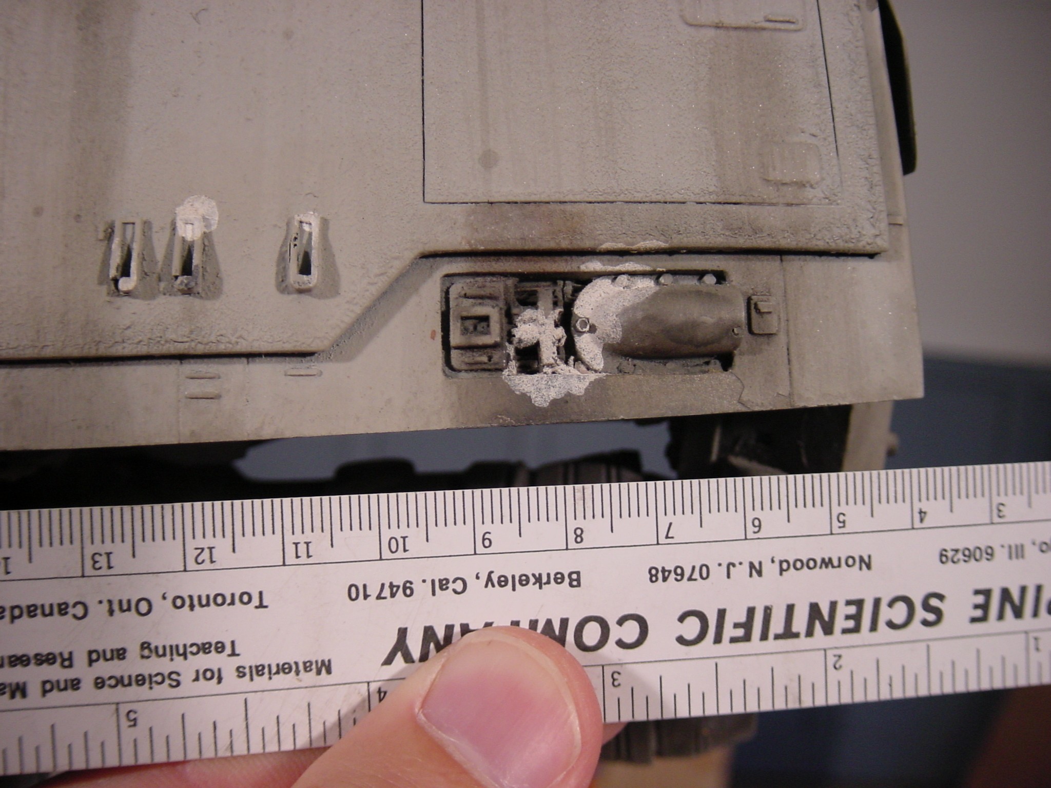

Sorry, I just realized you meant pics for the side guns since it was broken, not that the links for the side pics were broken on that site :lol:
Also note that the one with the broken guns on that site appears to be the ROTJ modifications to the guns as it has the spot light
These are the ESB style
These are the EB style
Hahaha thats ok, I appreciate all the pics and information... and the info on painting the speeder was mostly coming next anyway so well done!
The gun has a spotlight! Now I understand. I couldnt work out what was going on in the reference pics so thankyou for clearing that up. Maybe not so bad once going but making these guns sure feels intimidating.
Im guessing we're seeing 2 different models here as the fins ( atleast thats what I call them, behind the side guns) are different. One sets scribed in and the others are overlayed. I saw pics of another build with the overlayed fins and thought it was an odd way to approach them but he obviously had the other model as reference. So seems a little open for interpretation here. Cool that it shows the neck mech also.

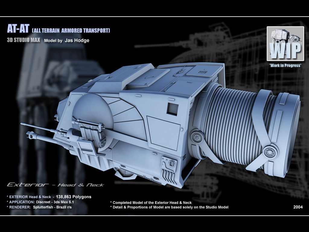

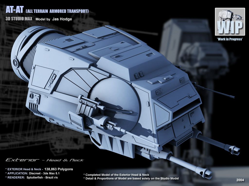

And with these sweet renders why is no one busting these out on 3d printers?

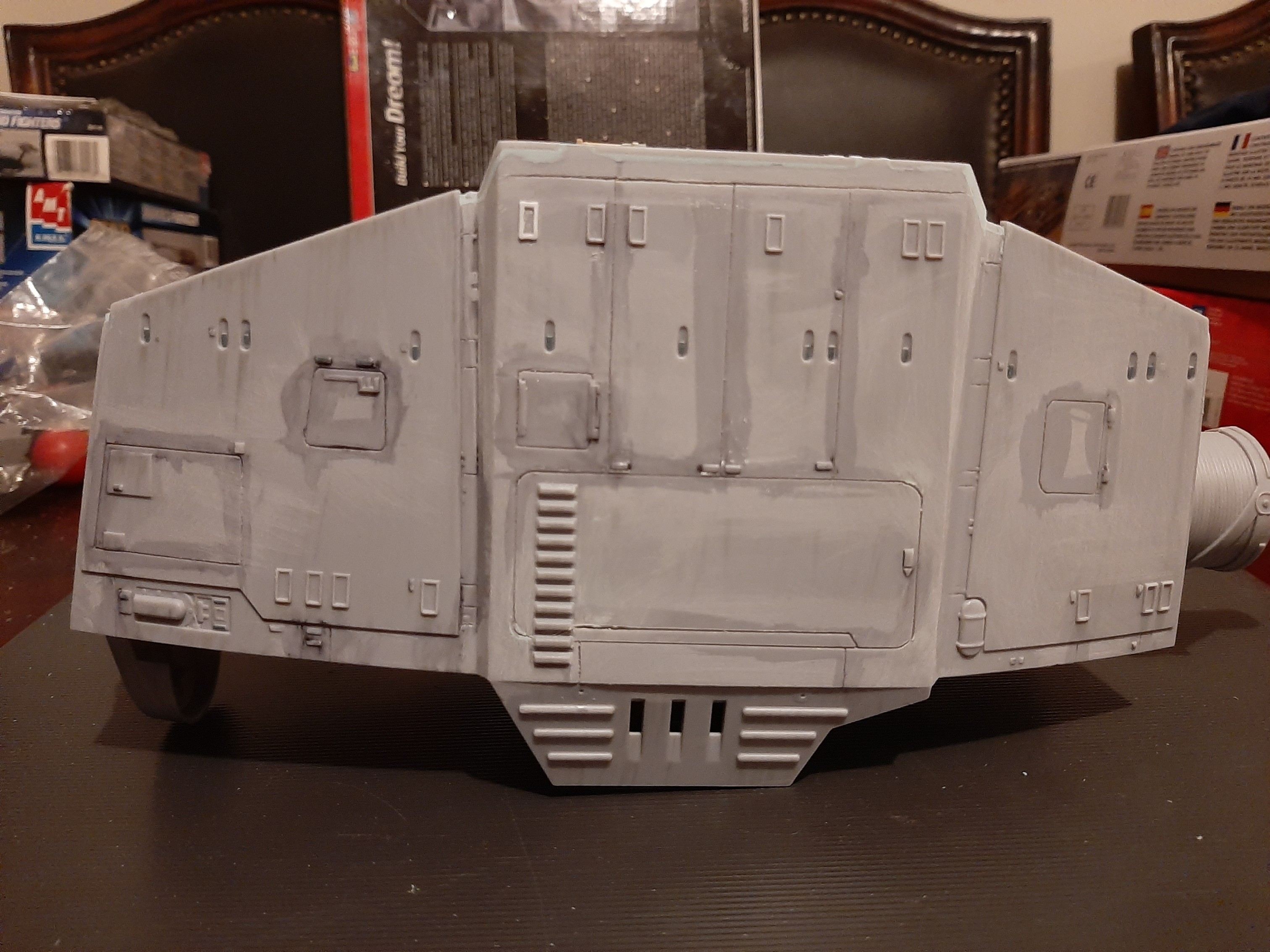

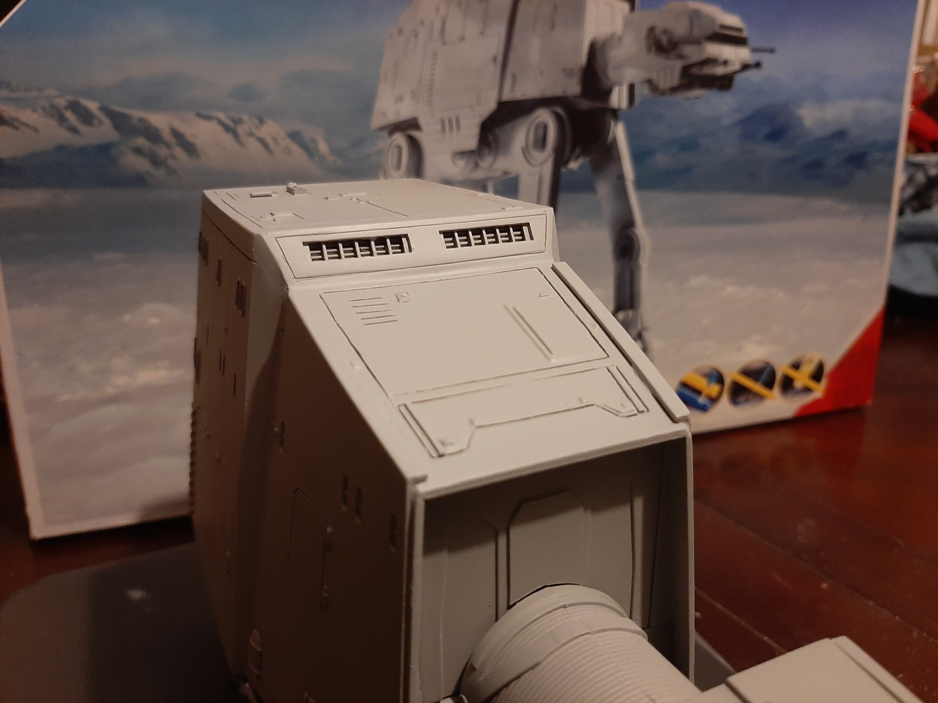

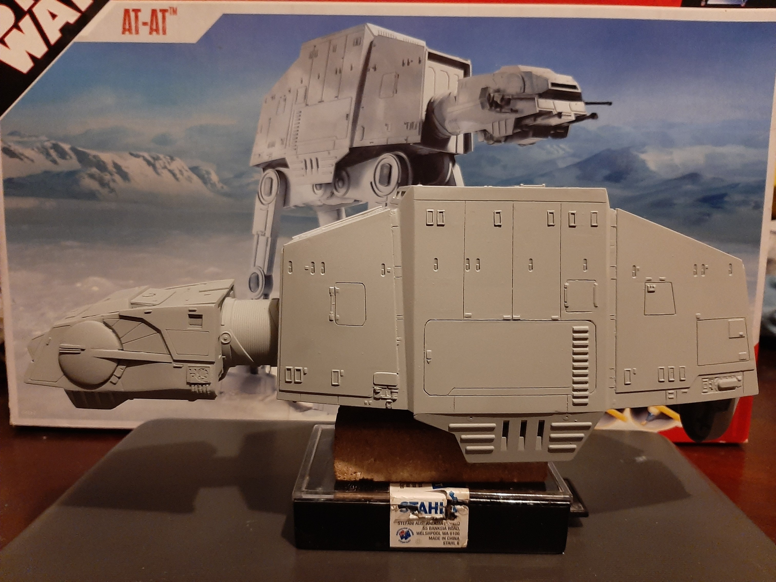

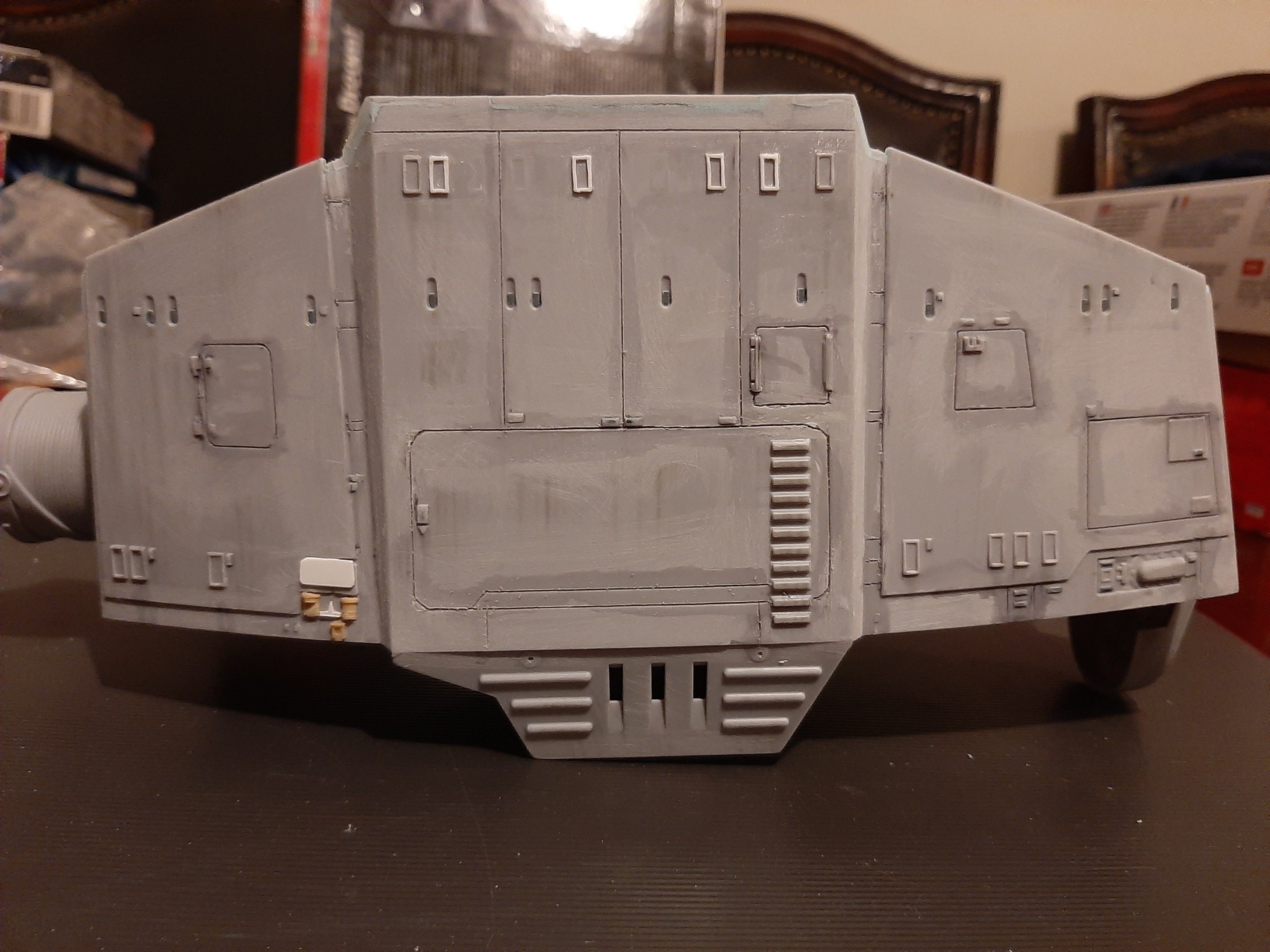

Ok so got the body in primer today.

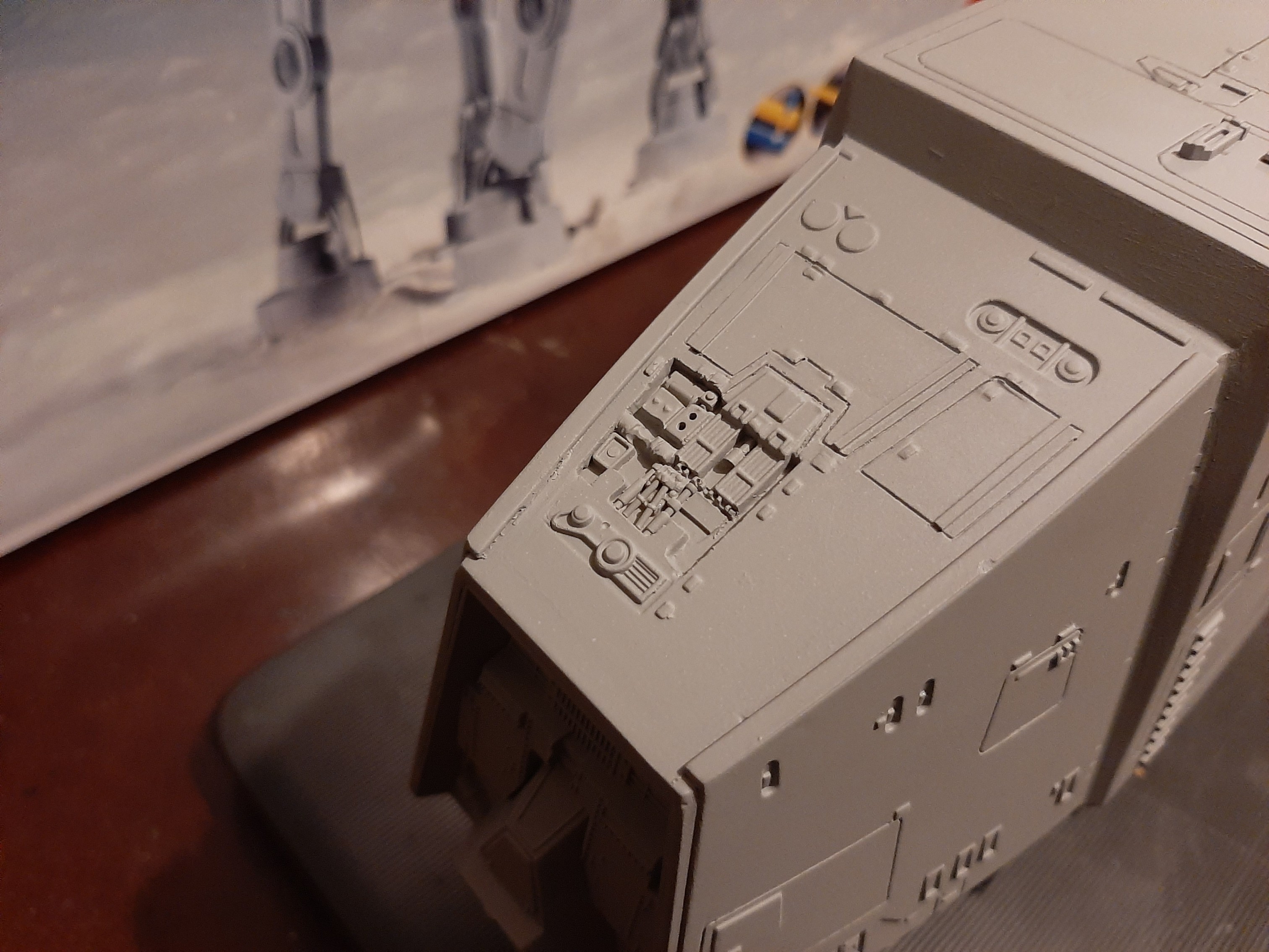

So had a bit of work on the grille. A blury shot but here is the Revell offering:
I really didn't want to get too excited but there was little option, drew a new file and then did some plastic surgery...namely cut a huge hole

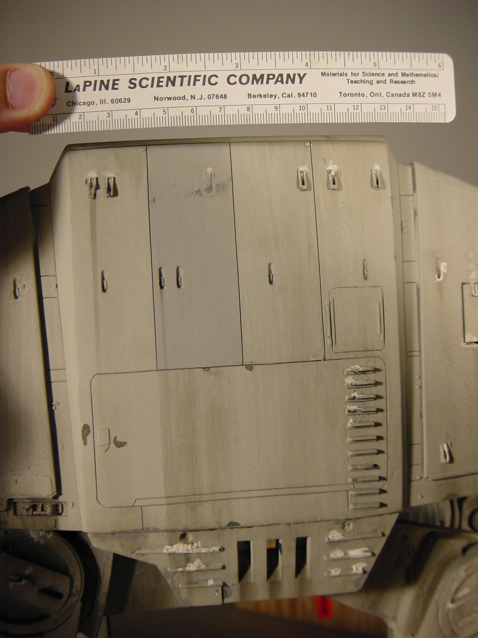

cut some new pieces and glued them together, then glued the new strip over the existing section and filled the sides. Here's the new offering and the studio model:

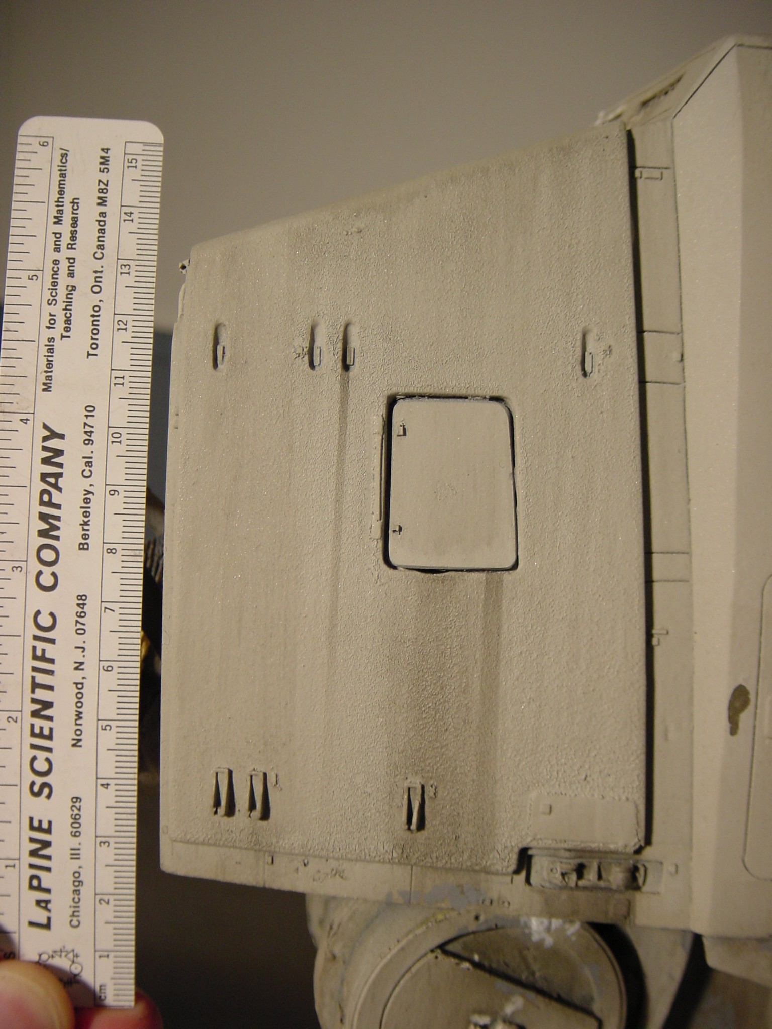

My rear cut in detail is not 100% but is a huge improvement. My model and the studio model:
and here is the top and side details against the studio model, the Rectangular box on the sides was too big but I decided to live with it just trying to keep them in around the same spots, save me making all new pieces:
Hopefully this gets most of the details in around the right places. I tried to keep as much of the more correct Revell detail as possible to save work which served an issue with scribing new lines as there were bumps in the way of running a ruler to scribe against, do this again I would probably flat sand and replace everything.
cheers,
Josh

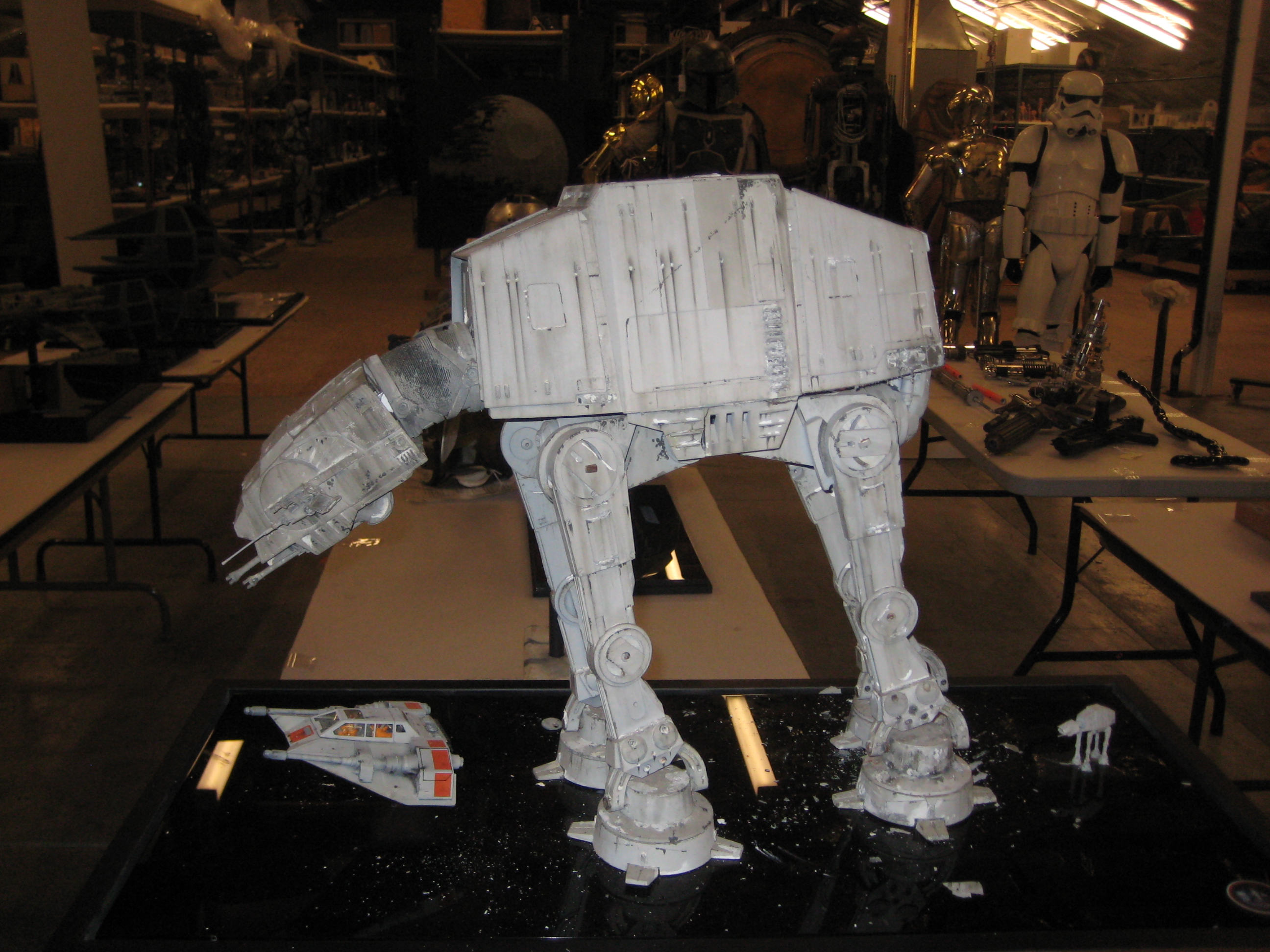

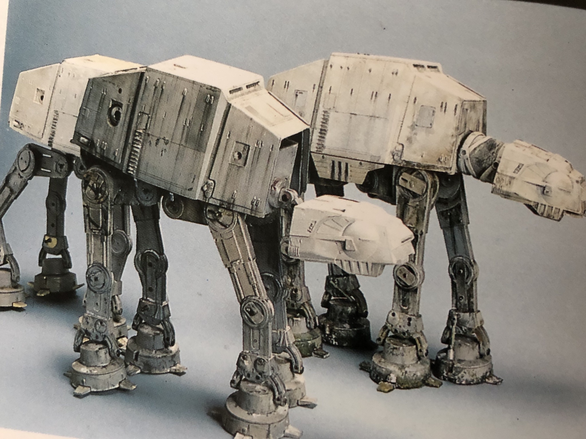

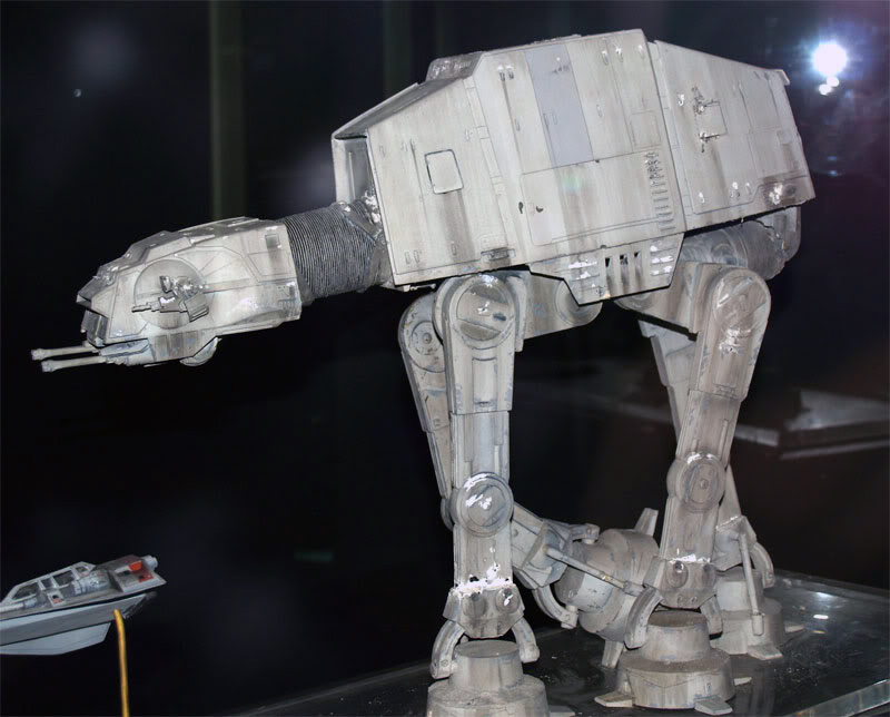

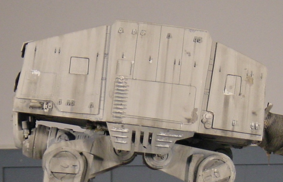

Great improvements indeed ... I believe this is a picture of one of the Studio-scale AT-AT's ... as you see most of those vertical scribed lines become almost non-apparent after a sloppy paintjob :
Chaïm
IIRC That one above is one of the resin cast ones? The side gun "shields"are a little different and the chin guns are very different from to stop motion originals
View attachment 1455732View attachment 1455731
Well that explains a lot. And something for guys building a perfect model to be aware of as well, be consistant with your reference material. And edit to note.... while simplified the Revell guns seem to match the ones of this model Analyzer.... I'm guessing that was their reference. So theyre not necessarily wrong.
I know there were a number of walkers made in differing sizes... partly to cheat perspective on the studio stage and a large model used for the high speed shots like the walker falling over with its legs tied before Im guessing being swapped out for a pyro model.
But how many at this scale were made? We seem to quite often be focused on 3 walkers and there's plenty of studio shots of the 3 walking across the snow... atleast 2 of these when attacking the rebels have their heads looking to the left suggesting there's atleast 2, can we say Hero models?
Then some resin cast ones that seem a little less detailed. Those pics referenced from modellers magic definitely show a resin cast walker and resin cast neck so will not have full movement. The information provided suggests this was the model Master Replicas copied however the MR seems to have the added detail on the armour behind the side guns so perhaps they had other information.
I was wondering on that Modellers Magic model the addition of what you pointed out Analyzer as the RoTJ side guns. So this brings 2 questions to mind.
1) you posted a shot of 3 walkers.... seems parts missing.... but one on the right definitely has green painted around the feet suggesting this was a model used on Endor ( interestingly the middle one has heavy black weathering and looks like the model Sym-cha posted) and it also appears to have the lack of detail around the armour plates suggesting this is a resin cast model.
So is the Modellers Magic resin cast and with RoTJ side guns the RoTJ used model and its had a restoration at some point or
2) Is the MM model just one of a few resin cast models that had bits stuck on left over from RoTJ?
Seems in that pic of the 3 models many parts are missing and I'm guessing being used more recently in filming they had one more complete model which wouldn't surprise me if had a restoration done for publicity shots.
Again does any of this matter? Not really, just interesting banter. But again the information is good to know depending on what your trying to reproduce and if your wanting to do a RoTJ, Esb hero or resin model you need to be aware of the variations.

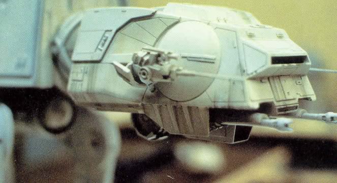

Actually I might be mistaken about the ROTJ one
The guns were different, but they did not have the "spotlights" looking things like I thought. Although I am a little perplexed as to where those side guns came from. Maybe it never made it on screen?
The ROTJ ones look like they are upside down compared to the ESB orientation and it is hard to tell from these shots, but maybe stubbier guns?
