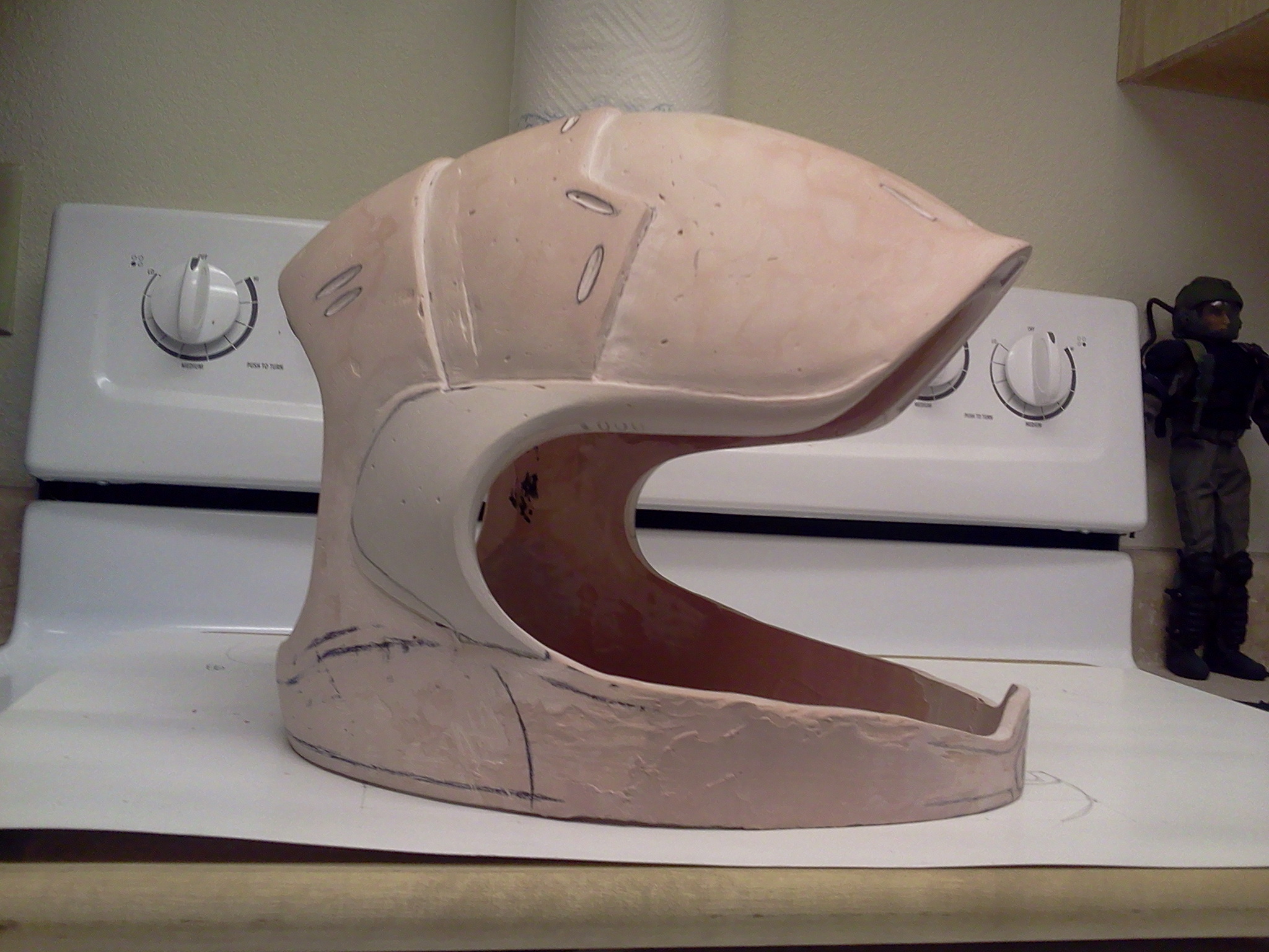

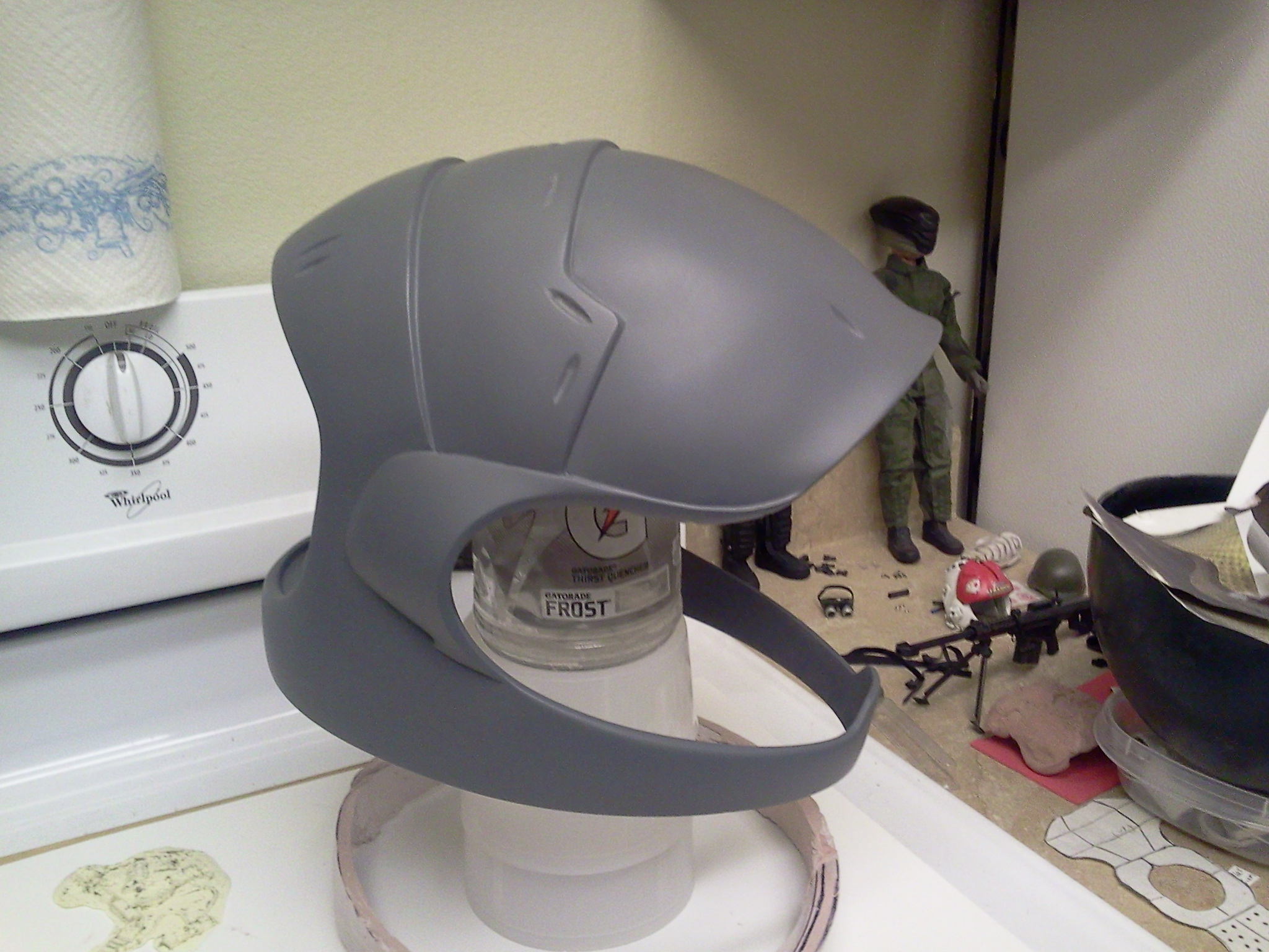

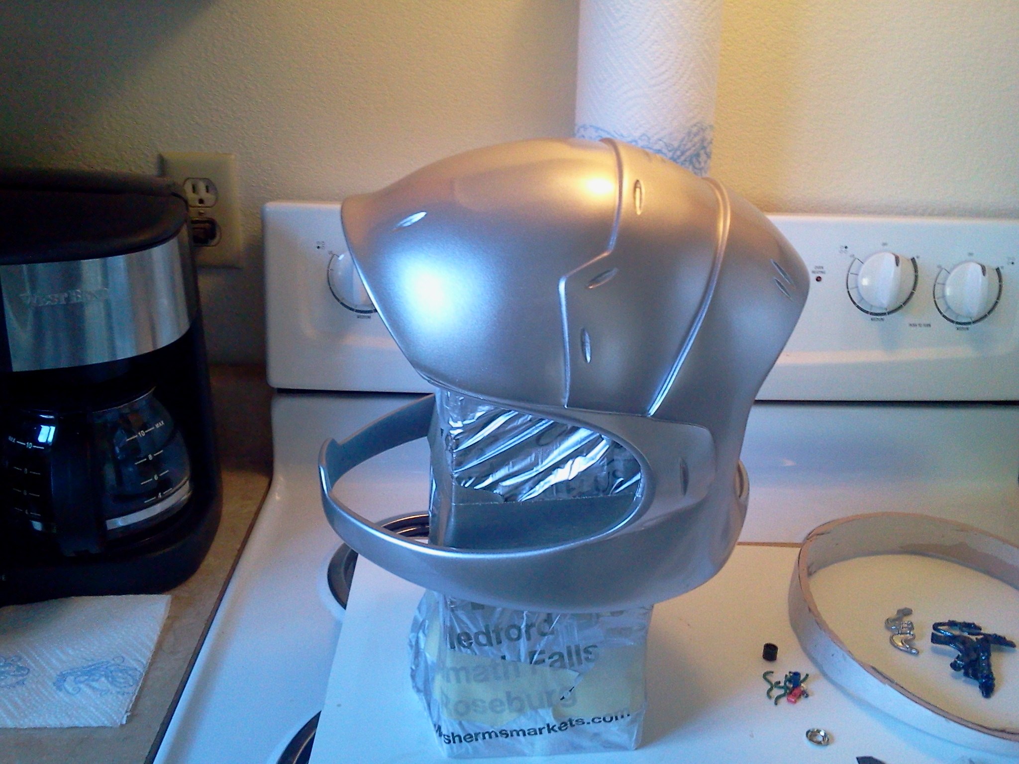

huge red planet fan and always liked there suits and helmets. 2015-02-07 22.21.25.jpgand here we go!! 2015-02-07 22.22.29.jpg 2015-02-07 22.21.37.jpg 2015-02-07 22.21.51.jpg 2015-02-08 22.18.51.jpg 2015-02-08 22.19.07.jpg 2015-02-08 22.19.32.jpg

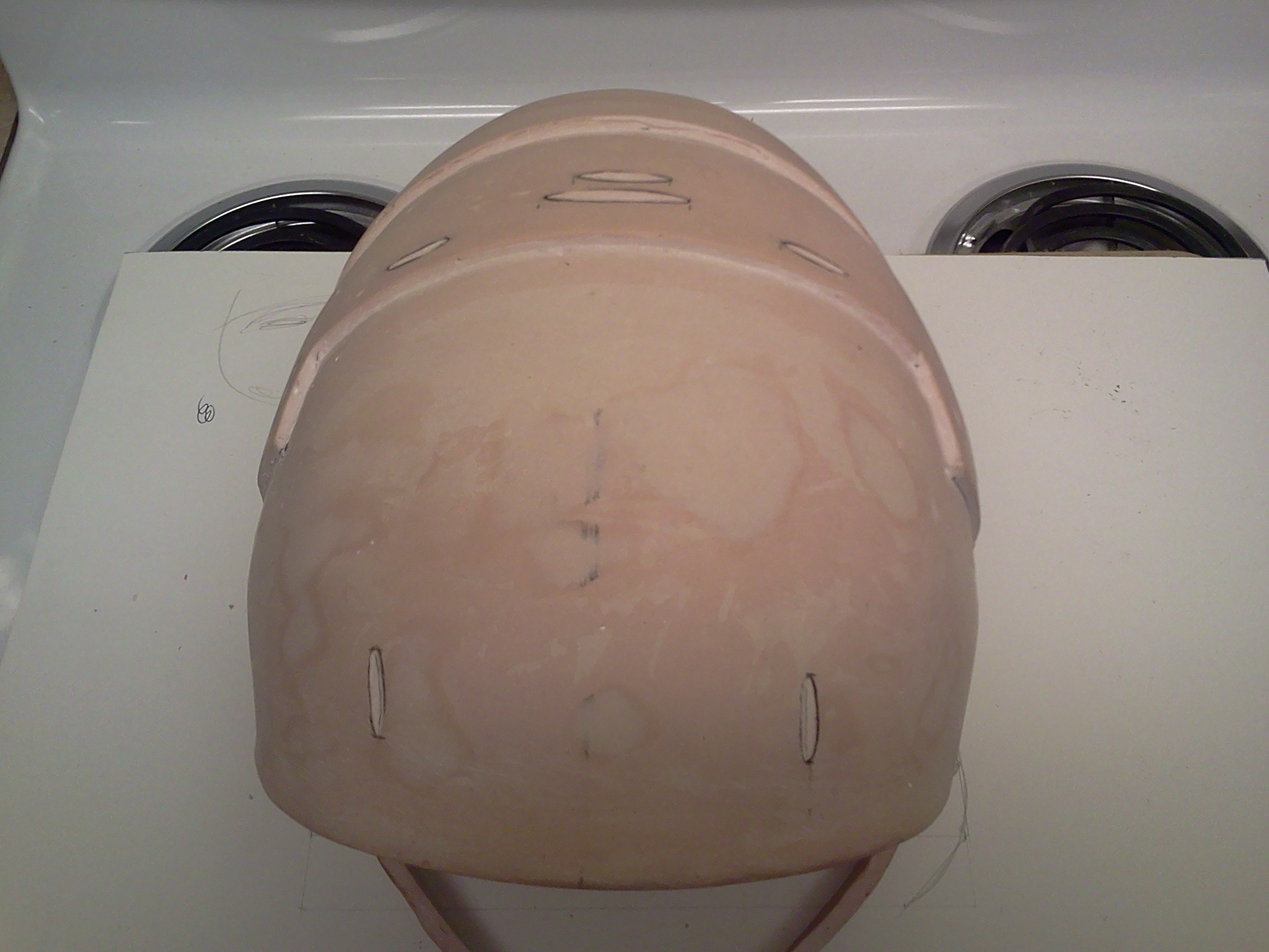

Wow, this is super impressive! So you created a rough form, covered in in bondo and then lots of smoothing it down? It's looking fantastic!

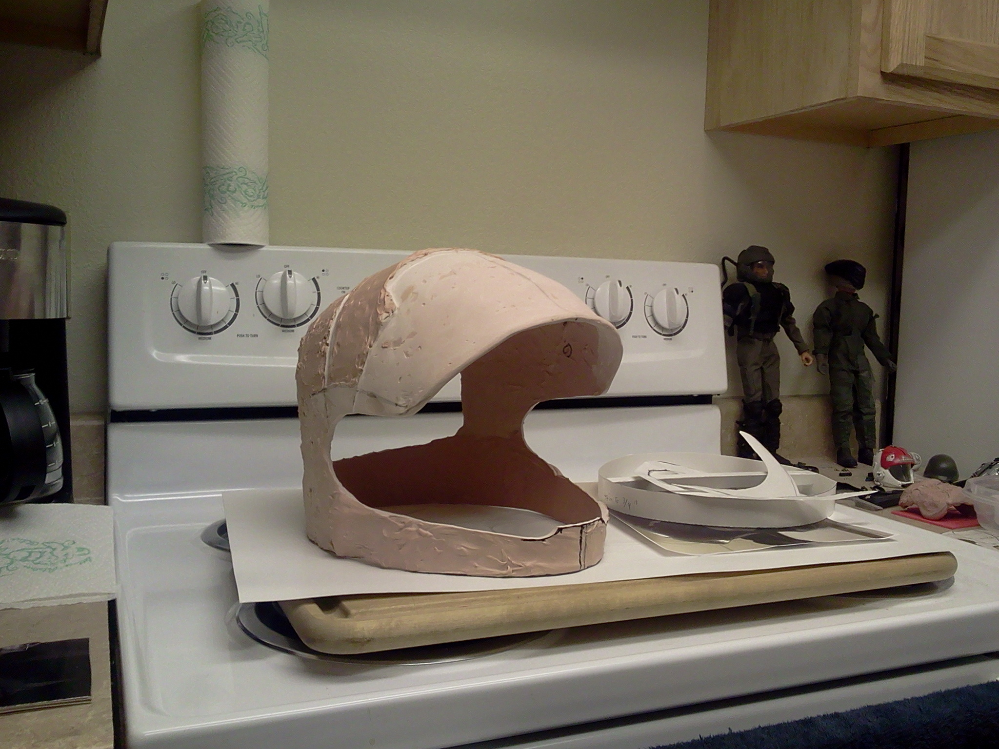

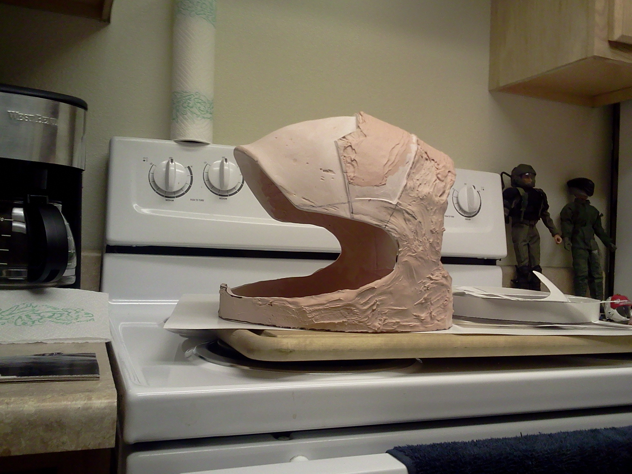

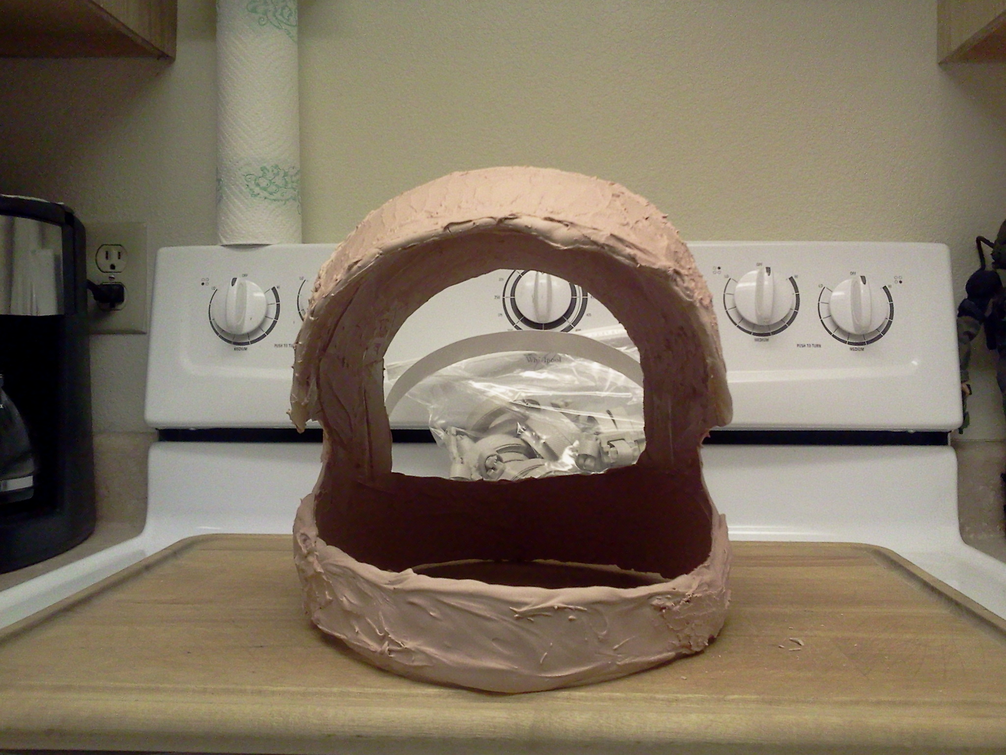

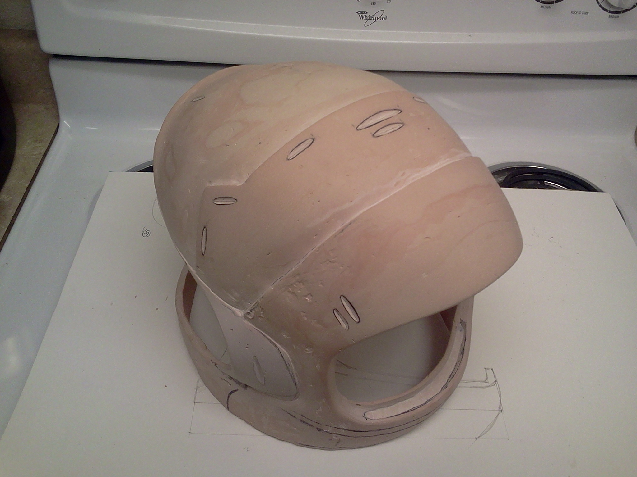

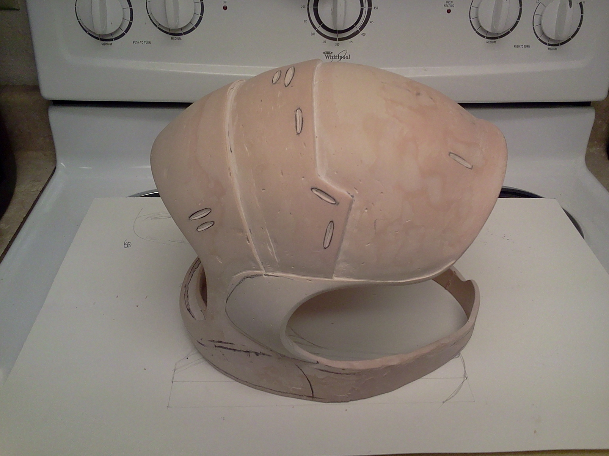

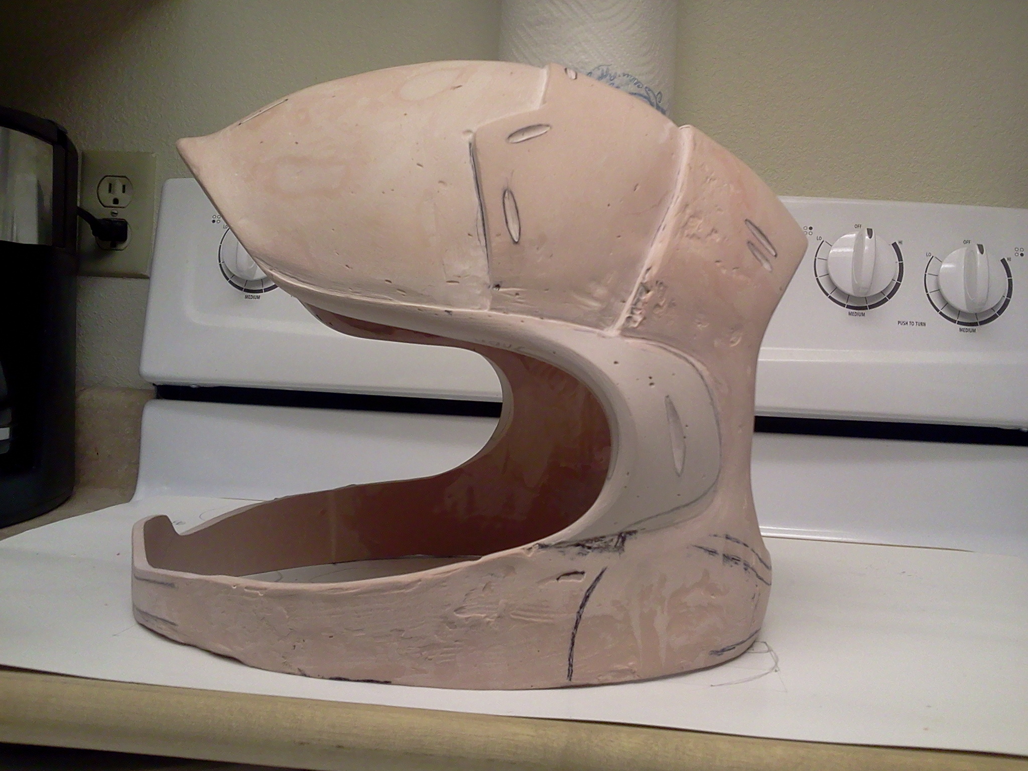

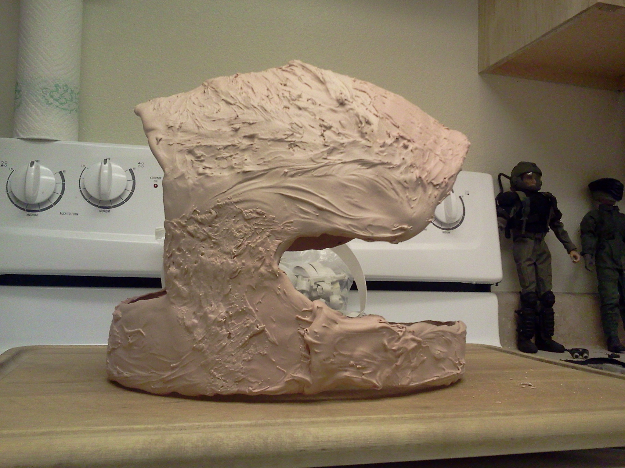

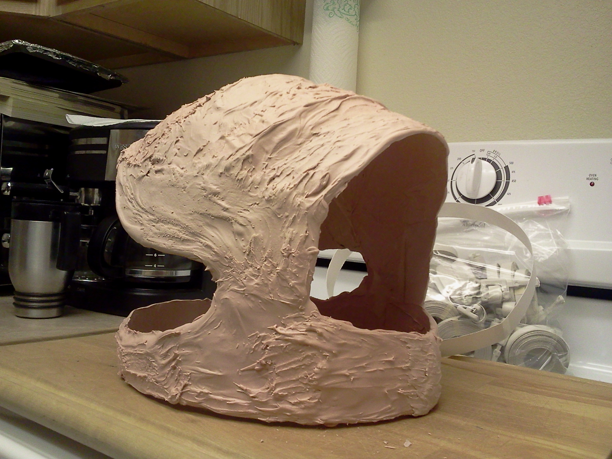

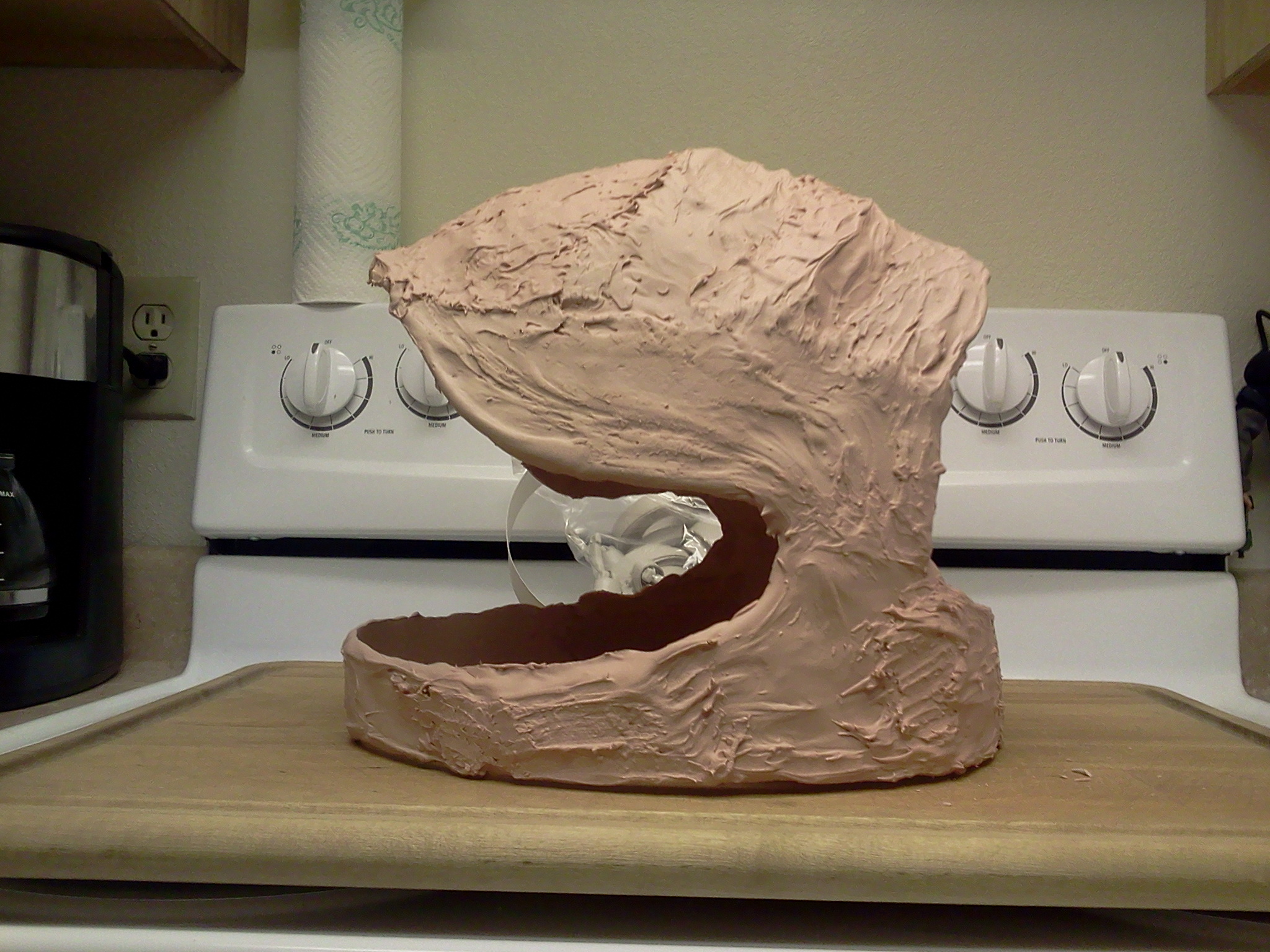

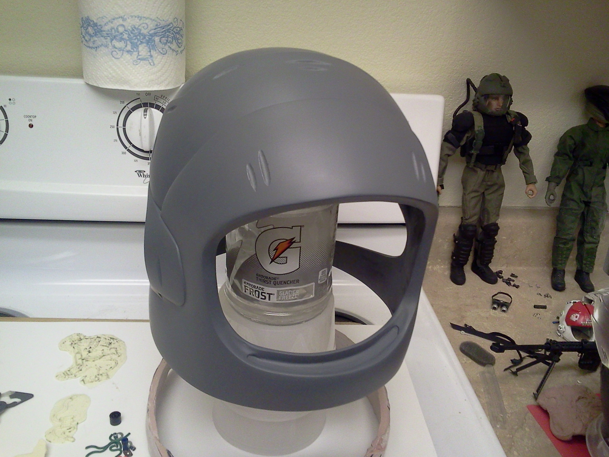

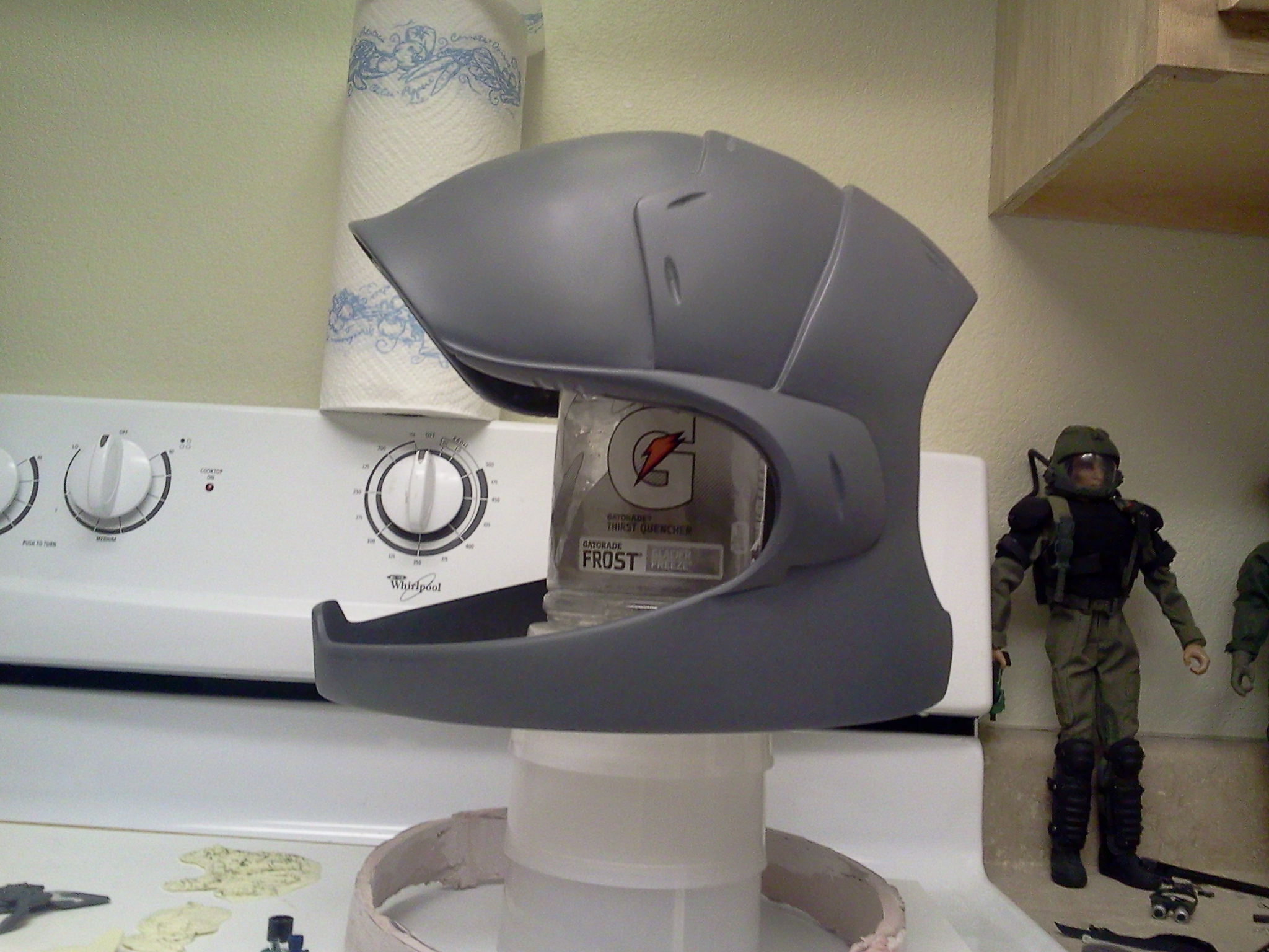

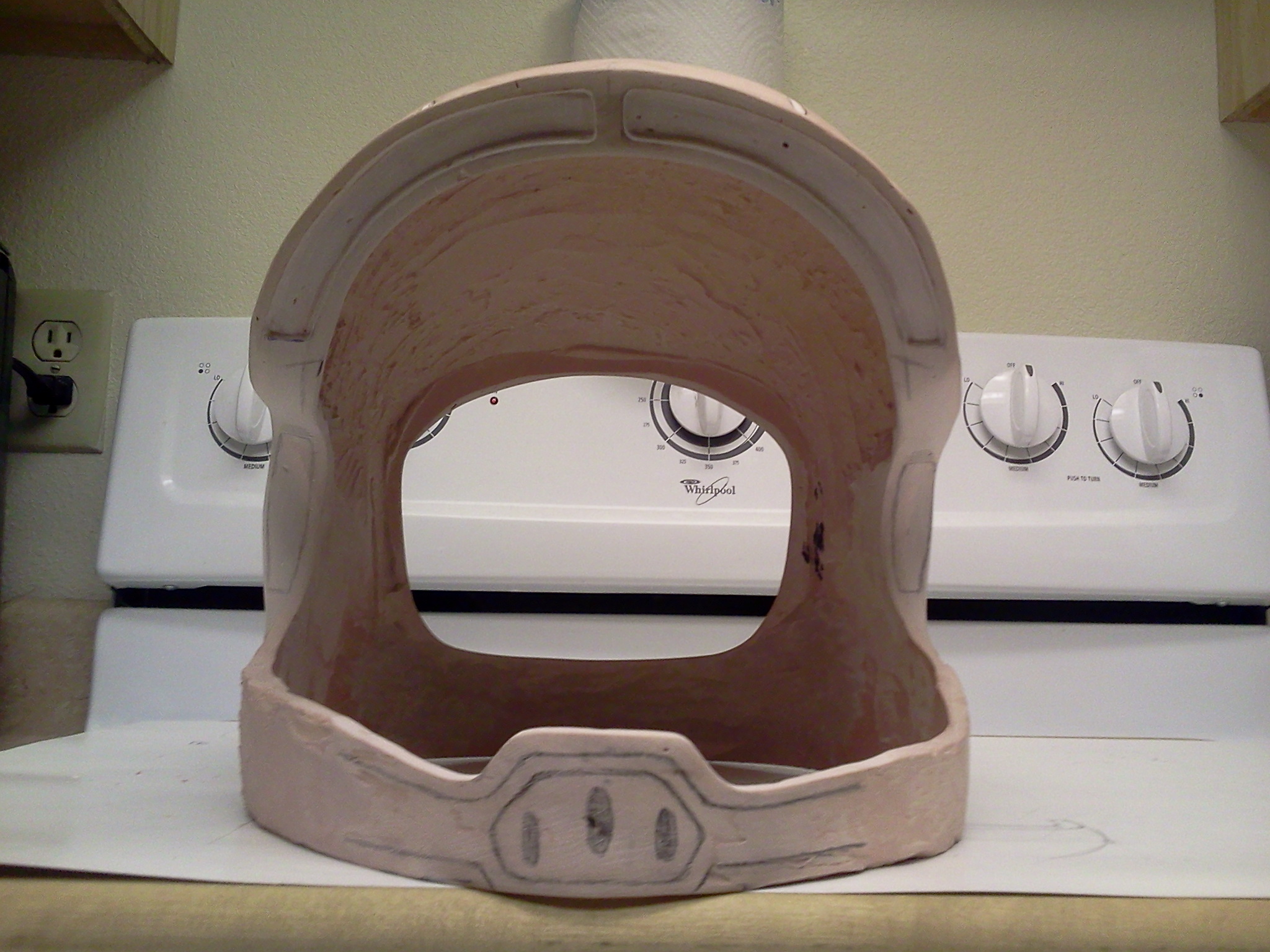

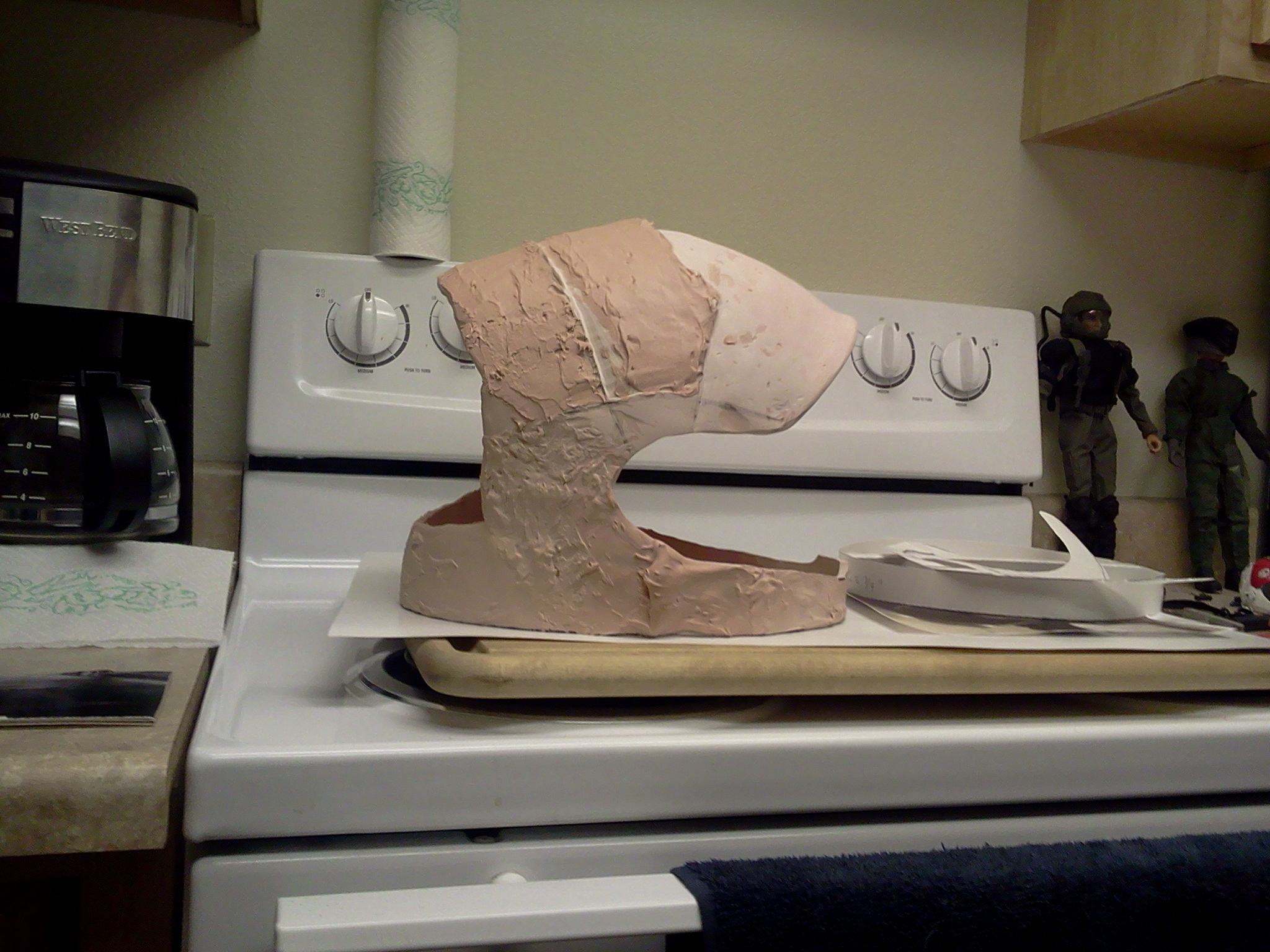

thanks guys. I used an old baseball helmet as the base. then made a very crude poster board mock up and covered it in 2' clear tape. then the bondo, after it cooled I was able to pull the board and b.b. helmet out. then a whole lotta dremel work. 2015-02-24 00.29.29.jpg 2015-02-24 00.30.29.jpg 2015-02-24 00.29.54.jpg 2015-02-24 00.31.22.jpg 2015-02-24 13.45.19.jpg 2015-02-24 13.45.40.jpg 2015-02-24 13.46.01.jpg 2015-02-25 15.38.37.jpg 2015-02-25 21.21.27.jpg 2015-02-25 21.22.16.jpg 2015-02-25 21.22.34.jpg
Your sculpt looks great! Very impressive work.
You said you removed the baseball helmet, so is the thing entirely made of Bondo then? If so, I am doubly impressed, but be careful with it. Bondo is not the strongest stuff. It'll shatter if it gets dropped. Are you planning on molding it? A fiberglass or urethane casting would be much more durable. I'd hate to see your nice work crumble from a simple mishap.

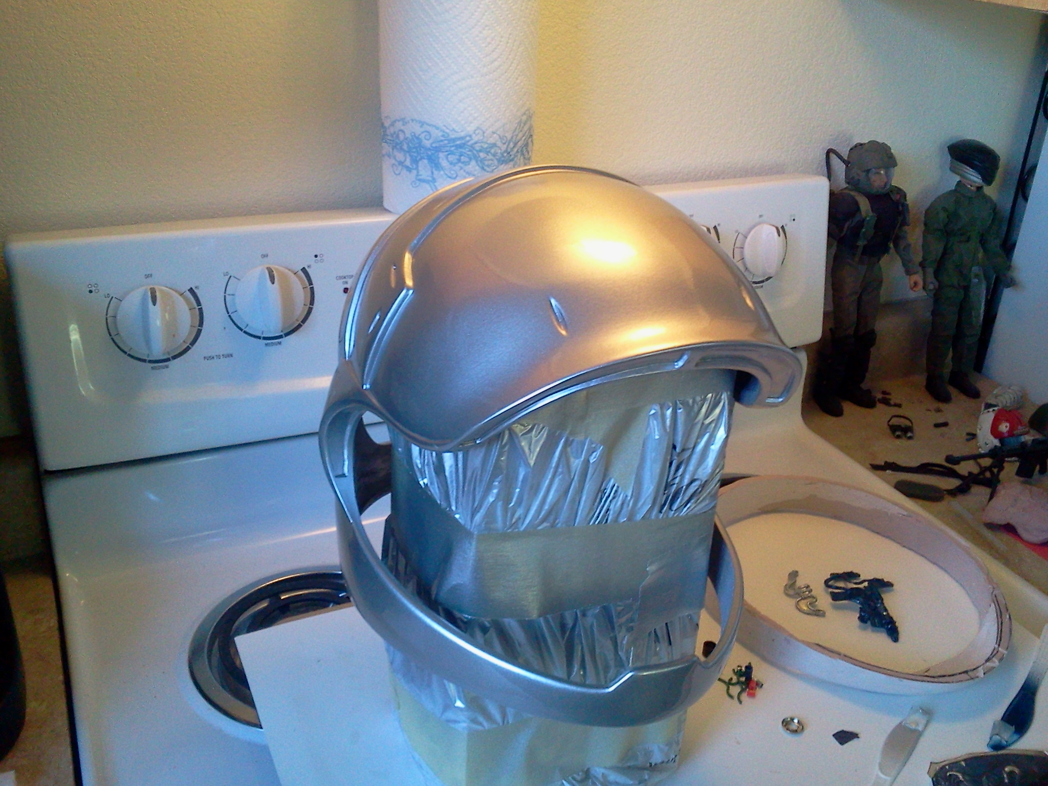

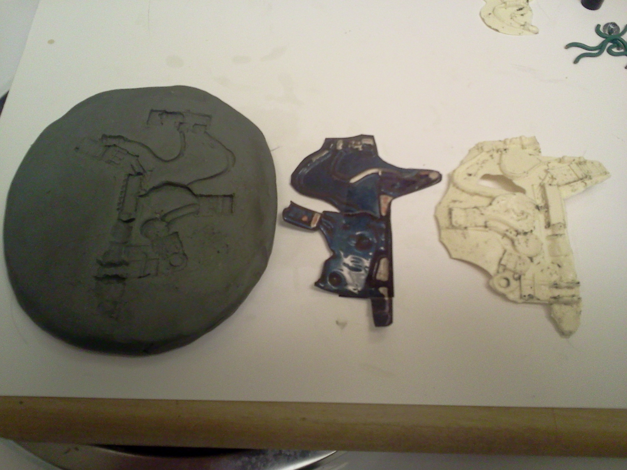

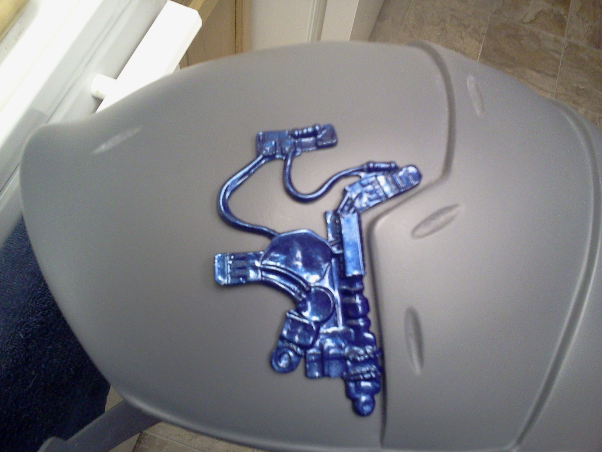

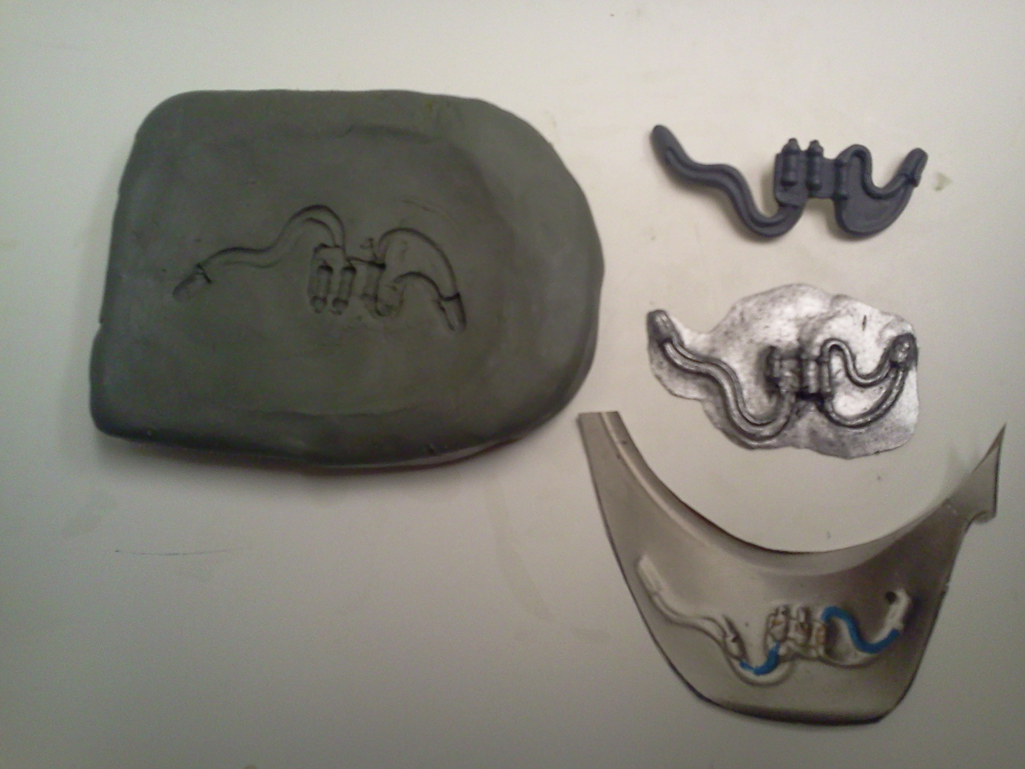

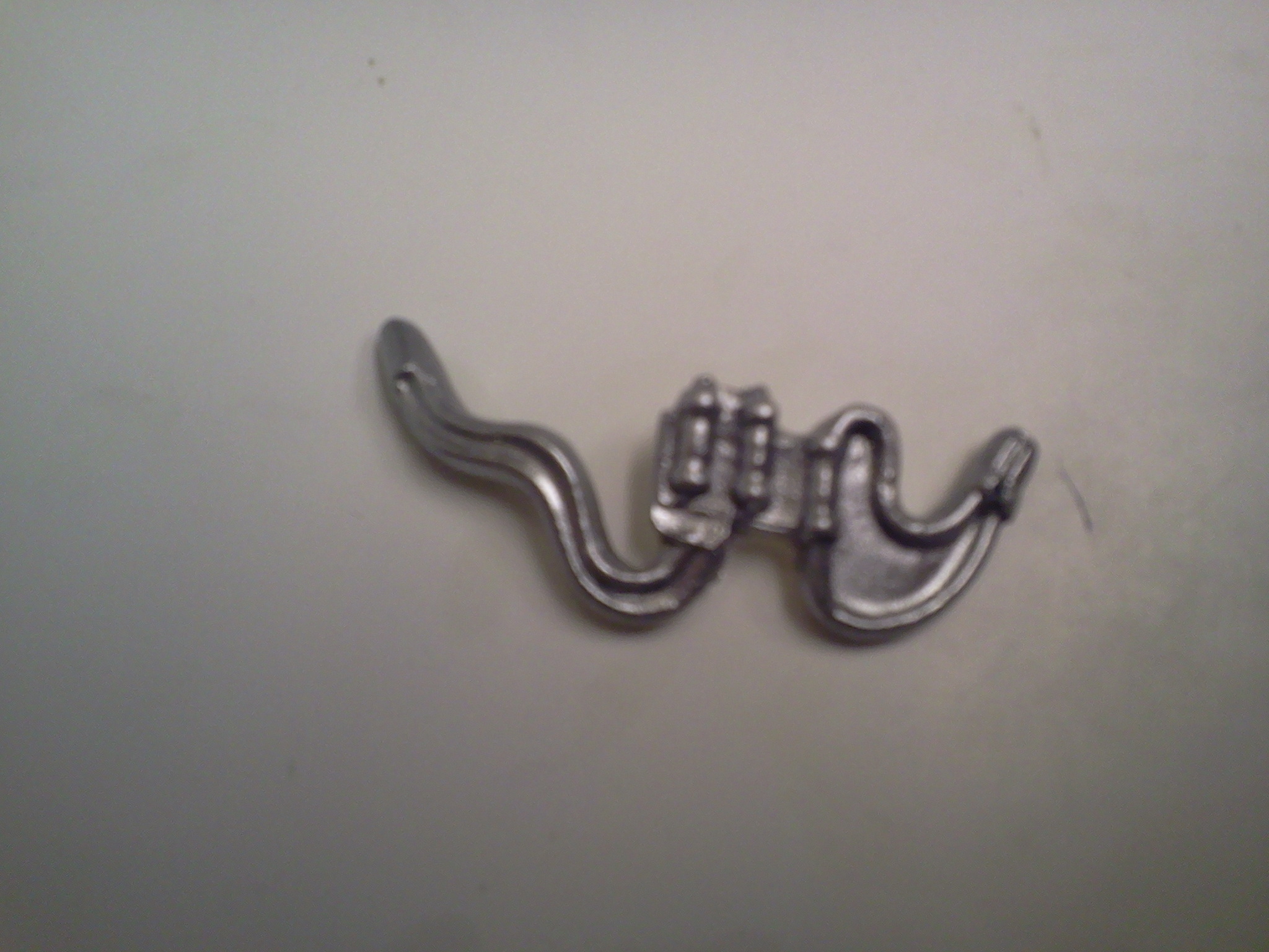

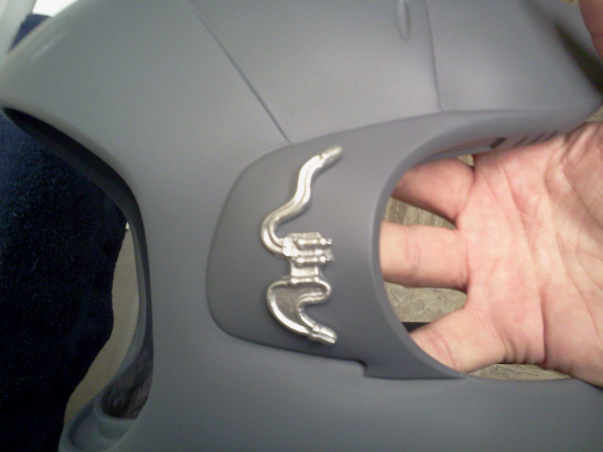

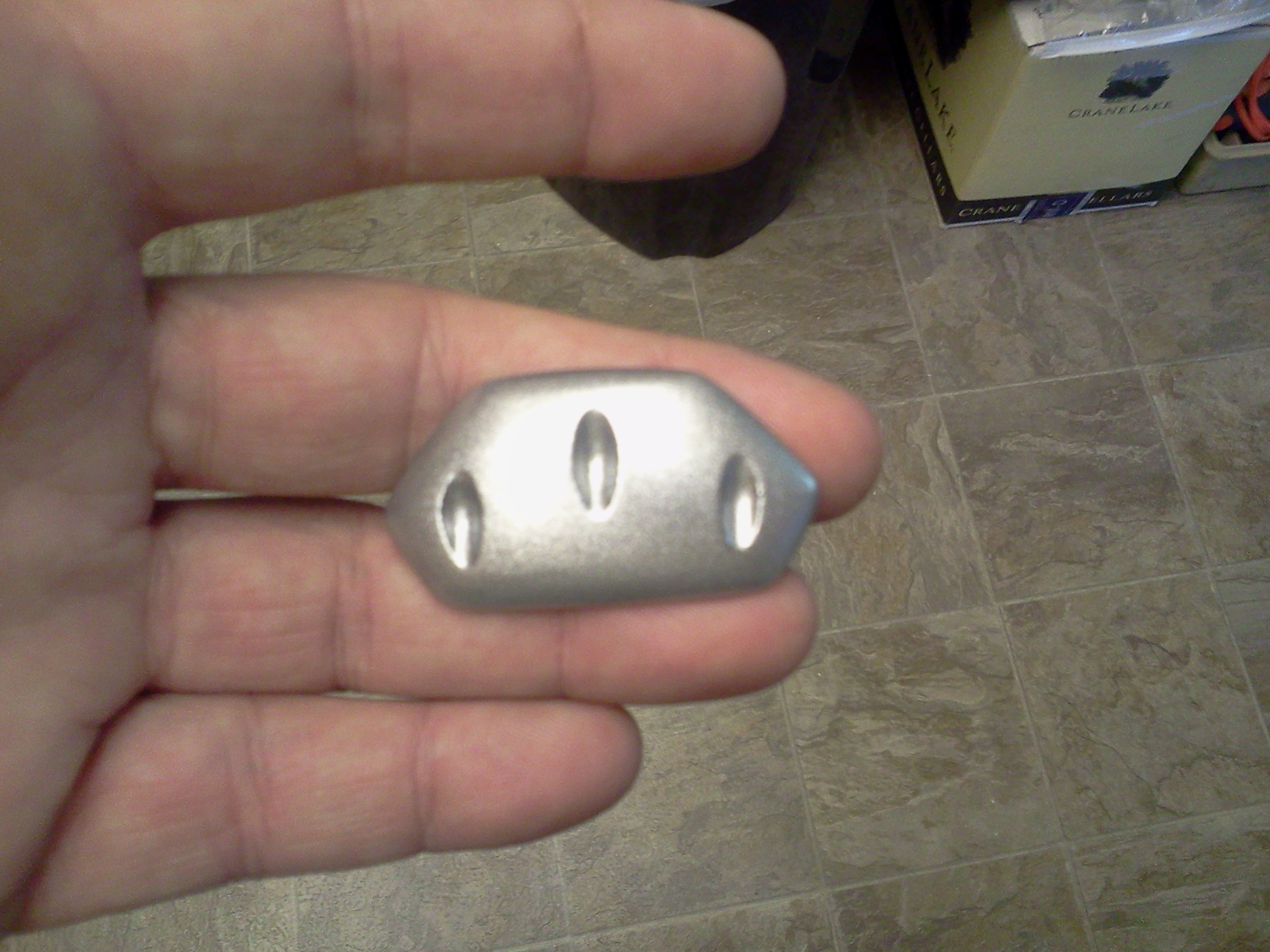

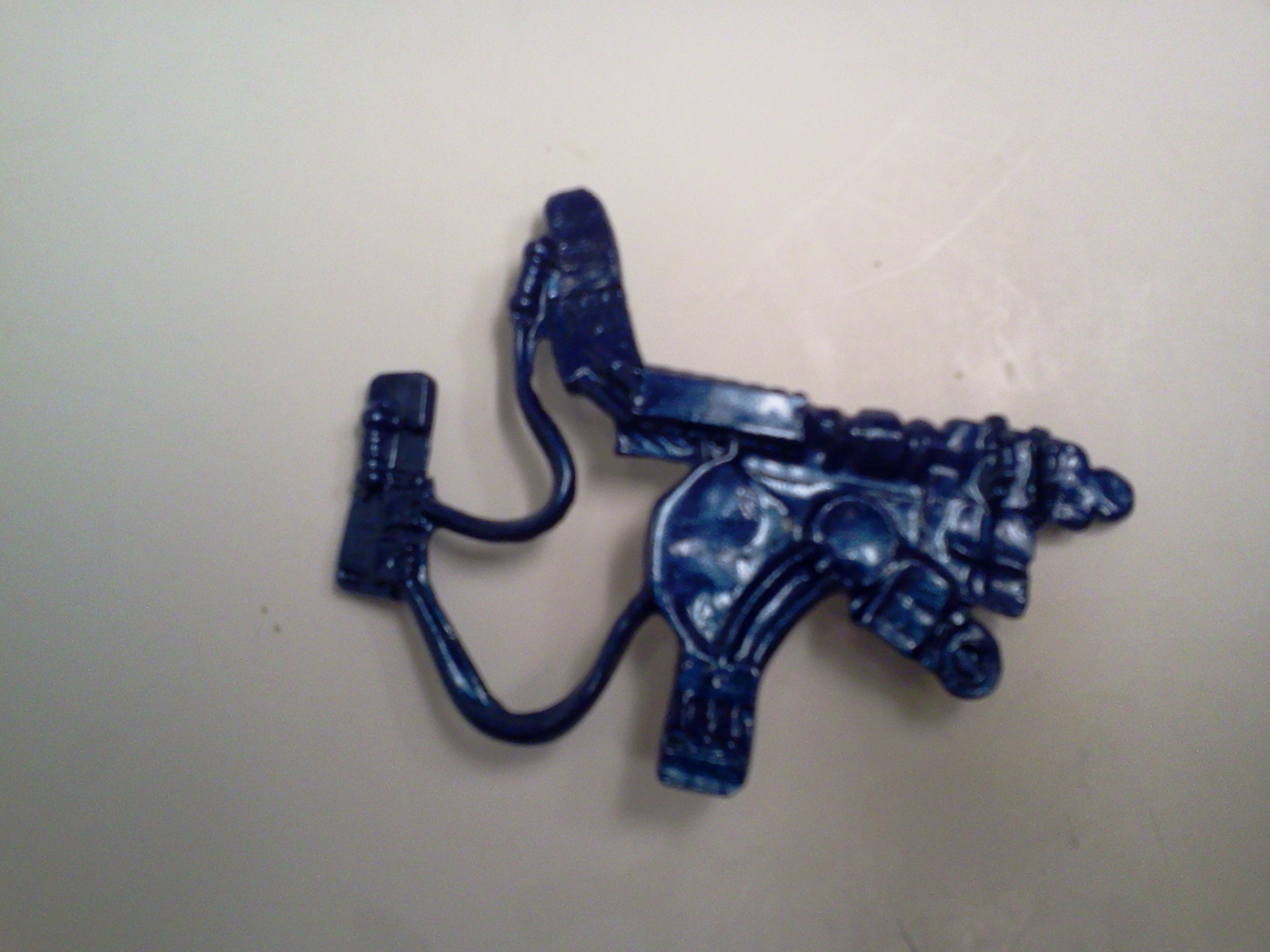

thanks for the positive comments guys. yes it is completely sculpted from bondo! I absolutely love the stuff. the "greeblies" are cast resin, I waited till they set up enough to pull from the clay and gently layed them in position on the primered helmet to get a proper curve to the helmet.

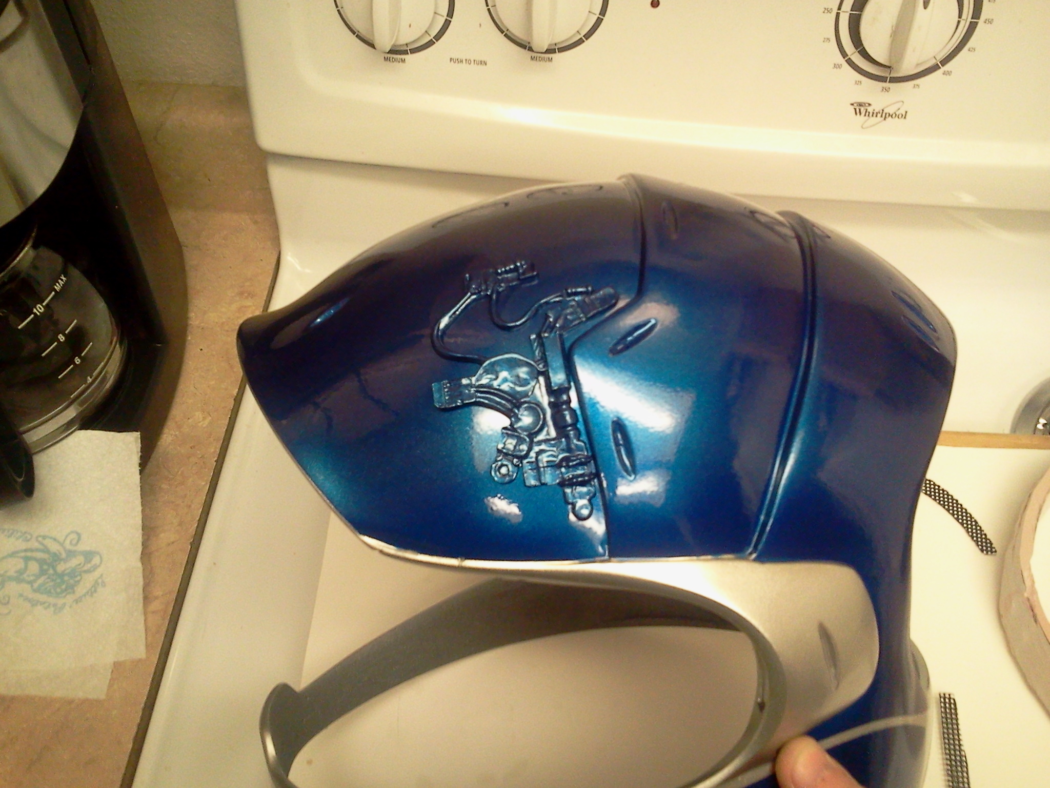

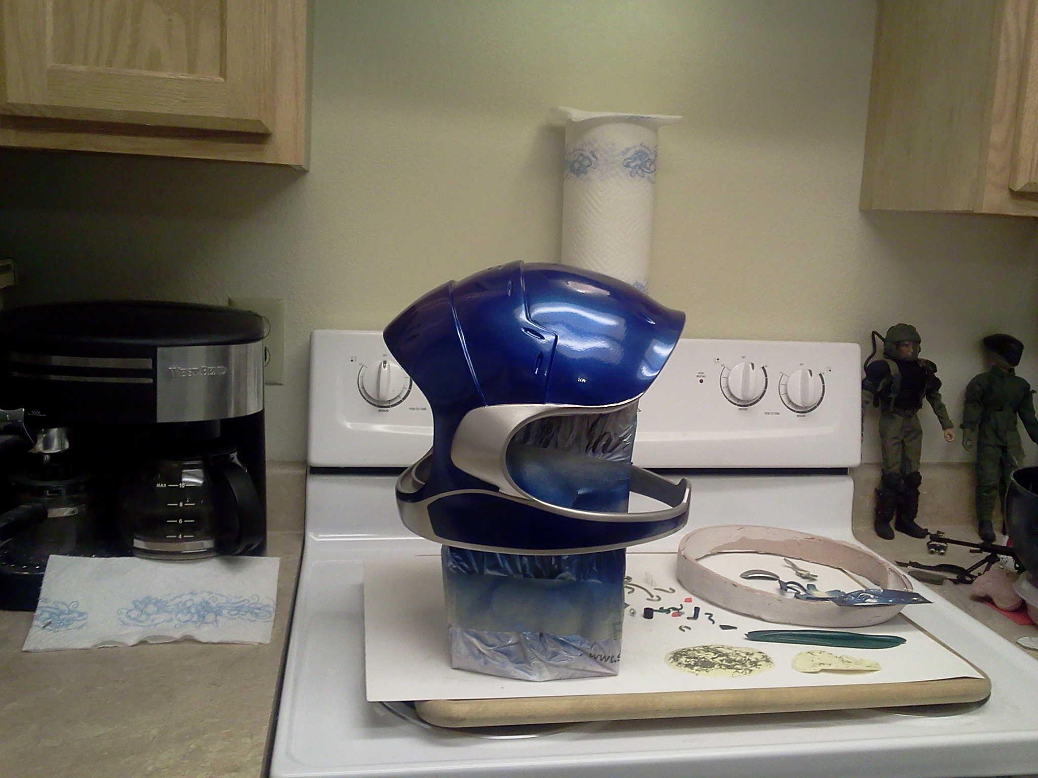

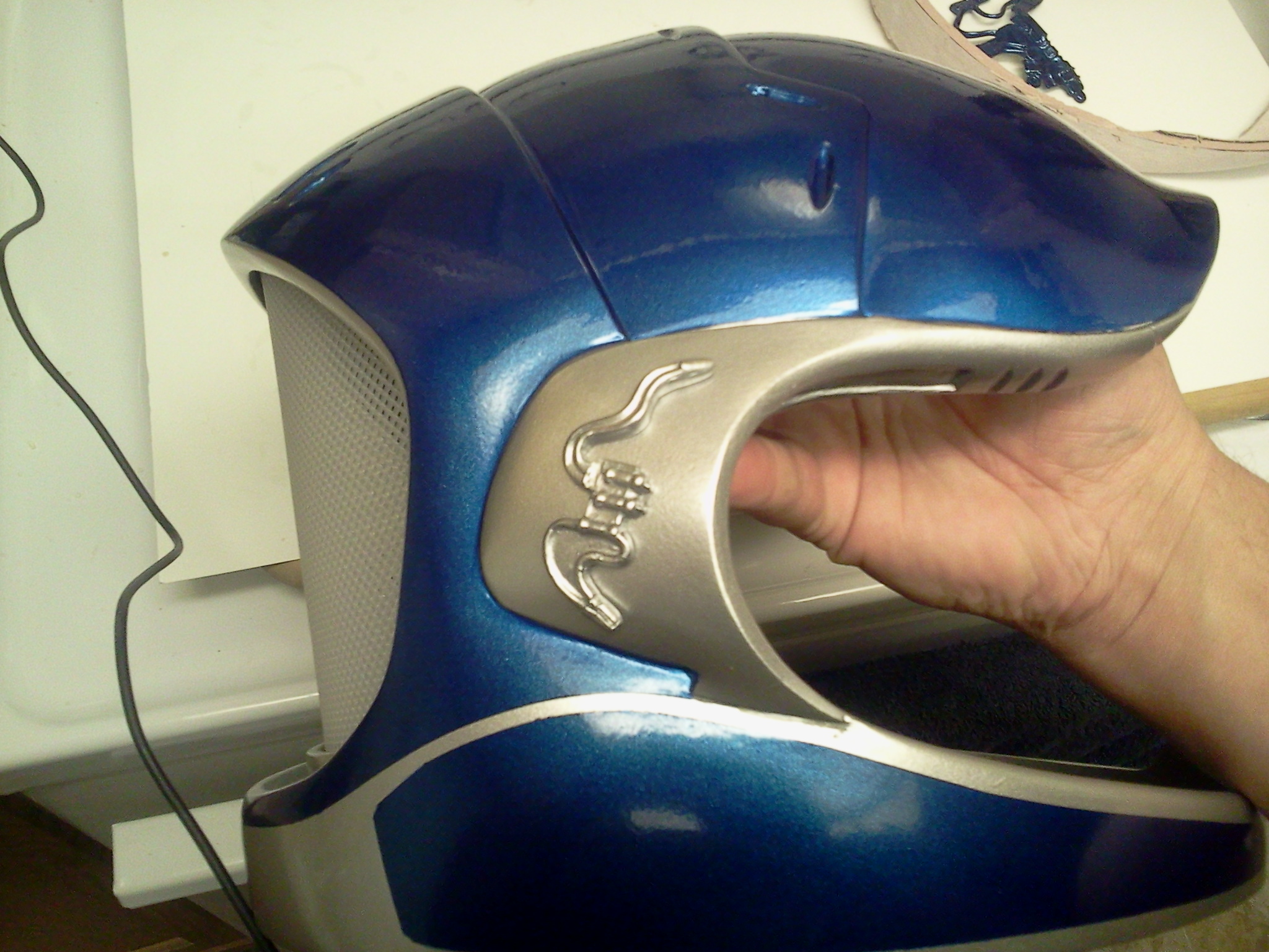

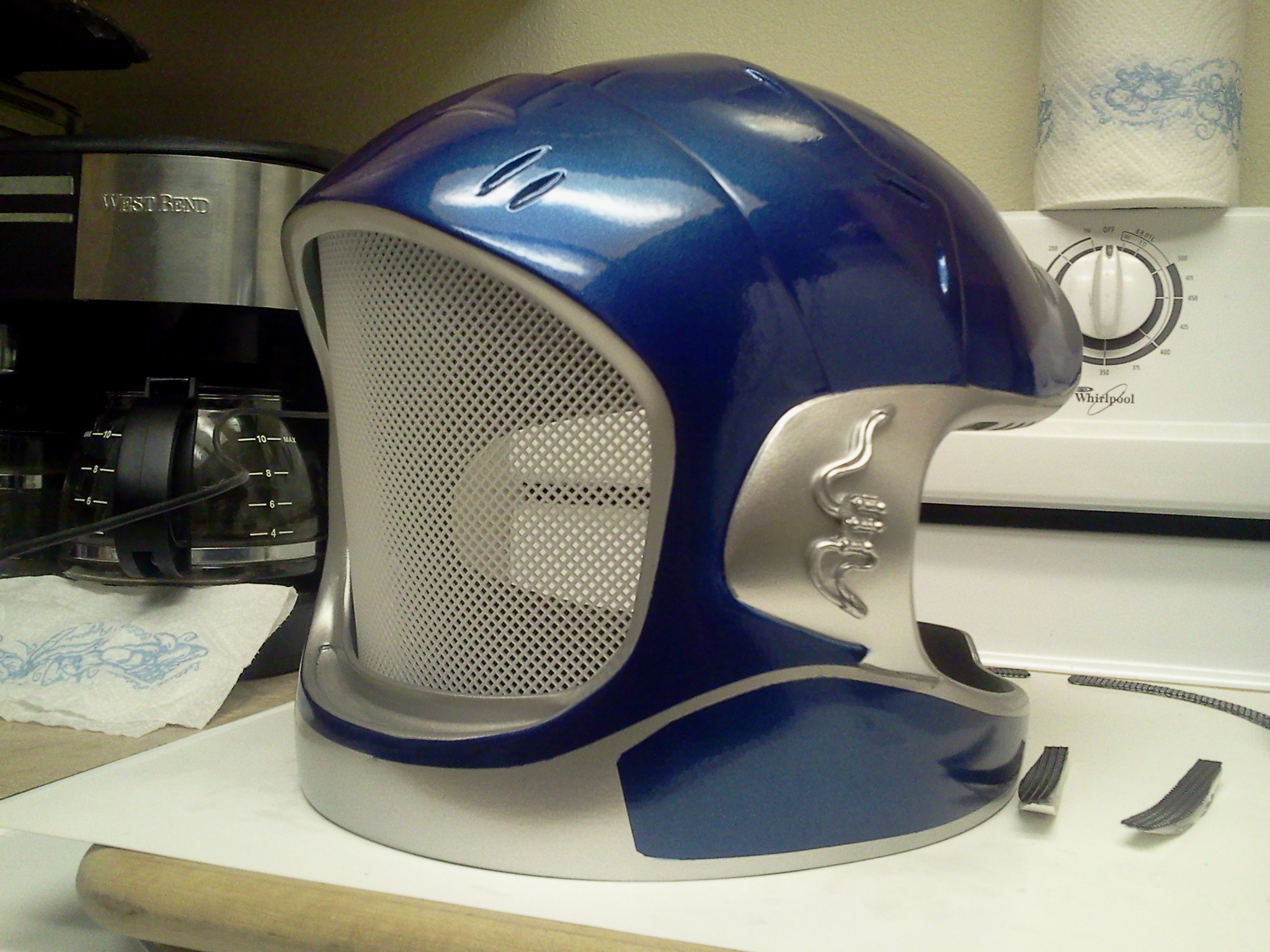

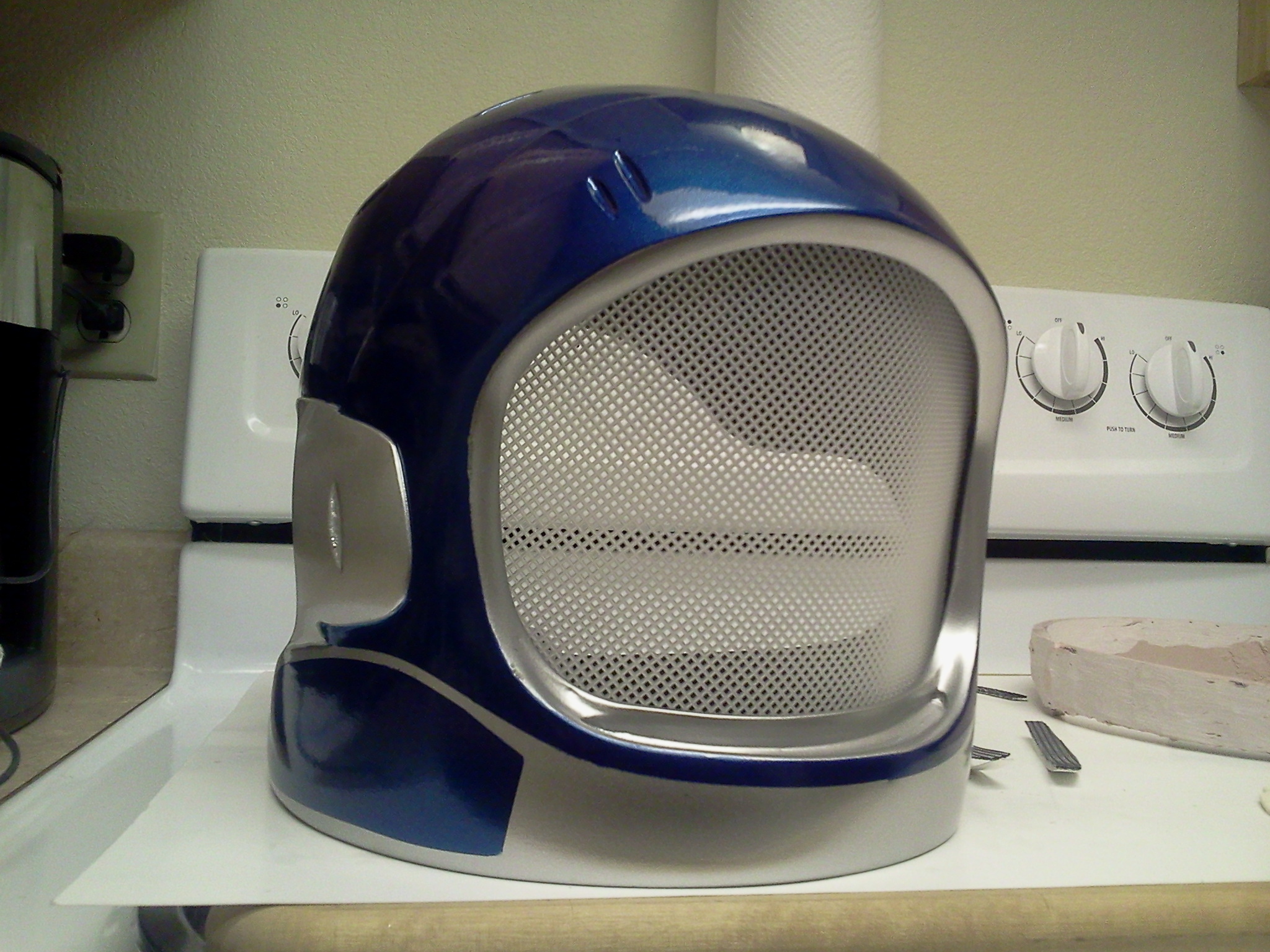

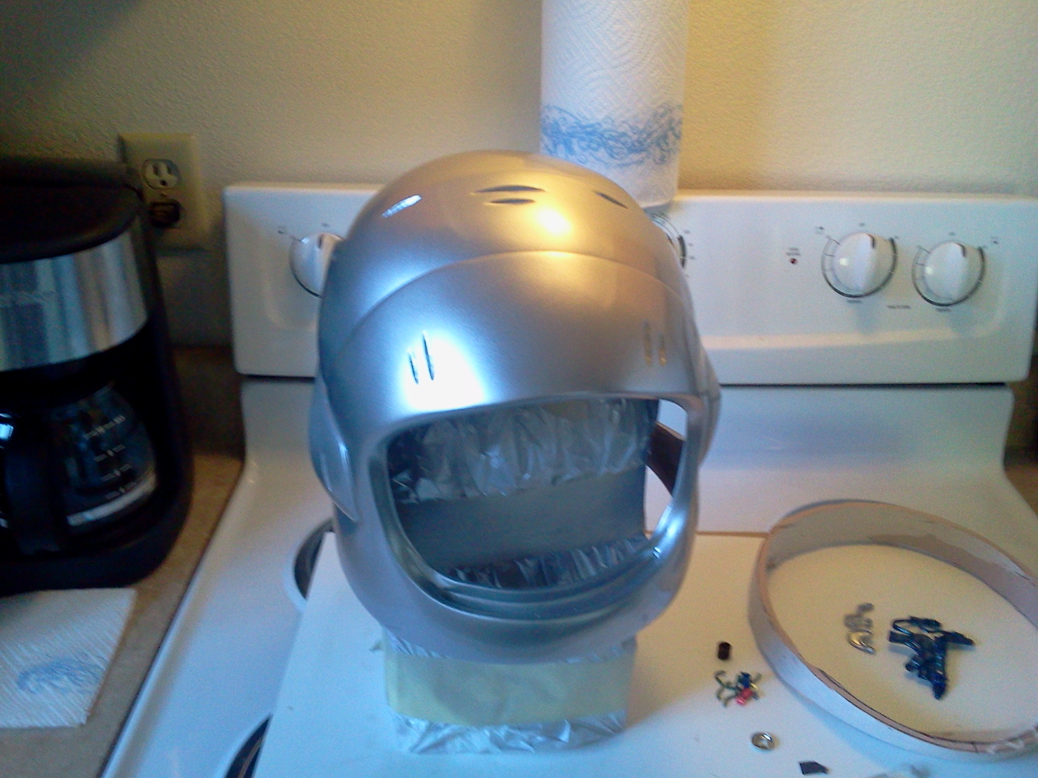

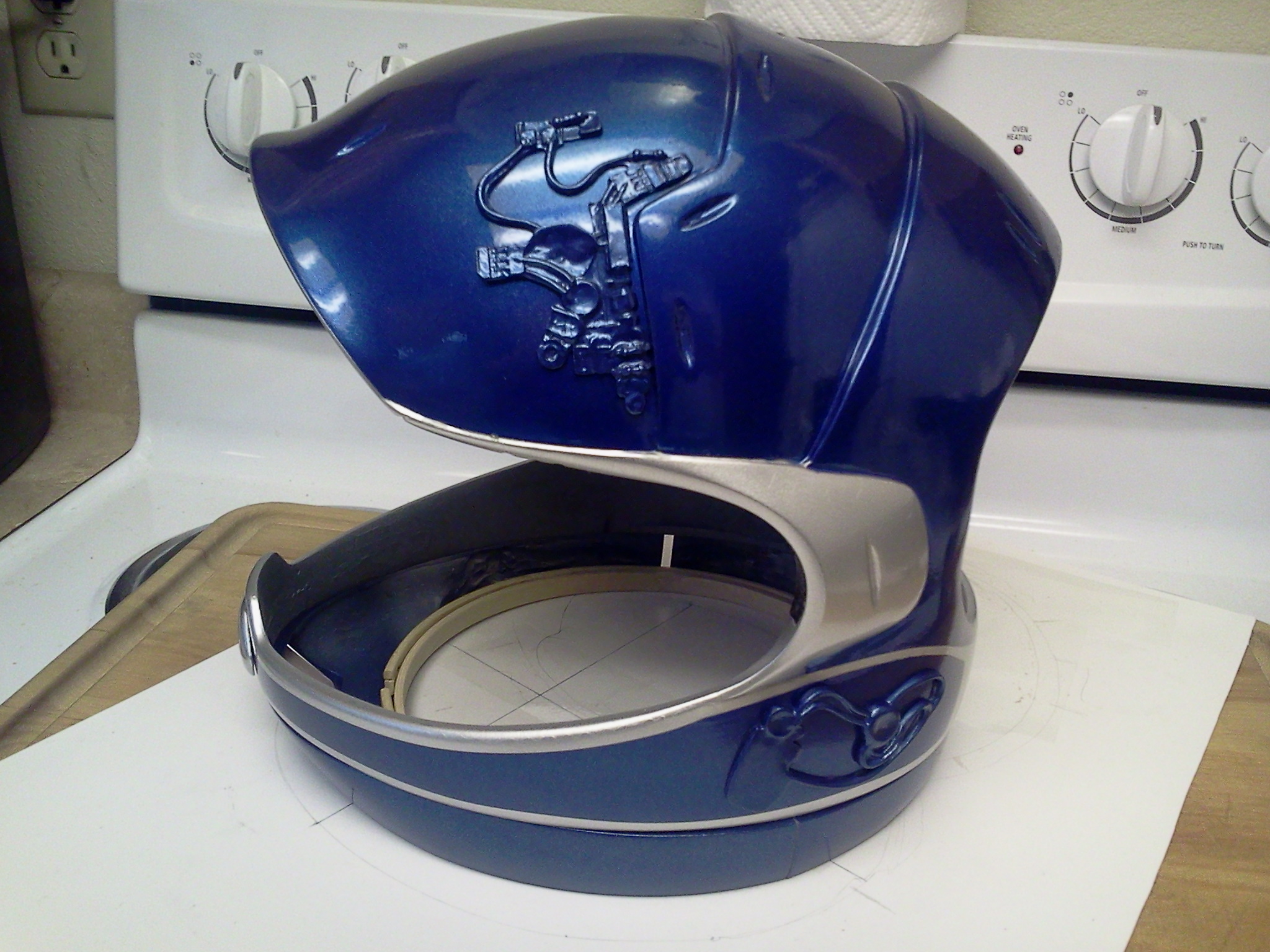

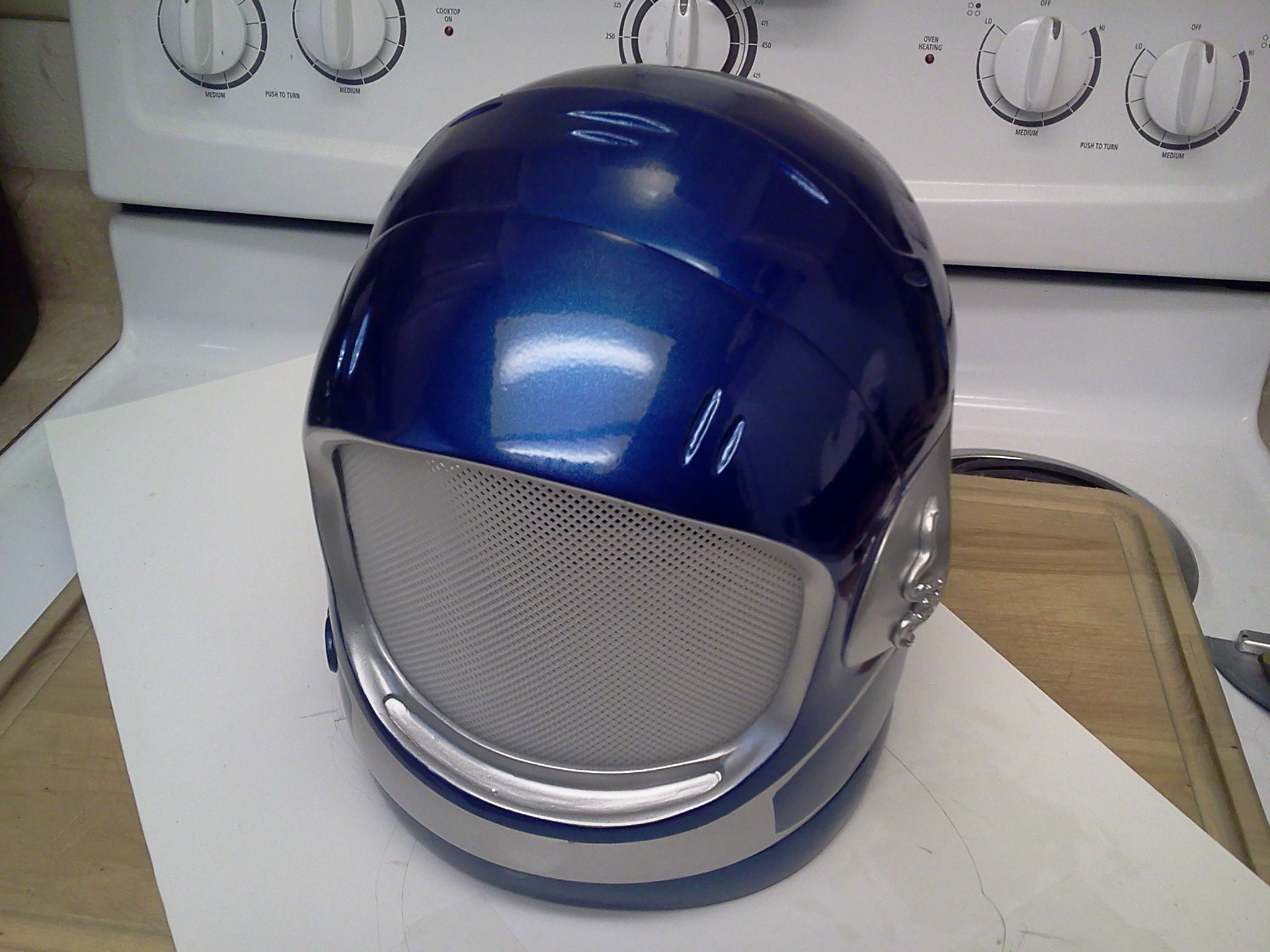

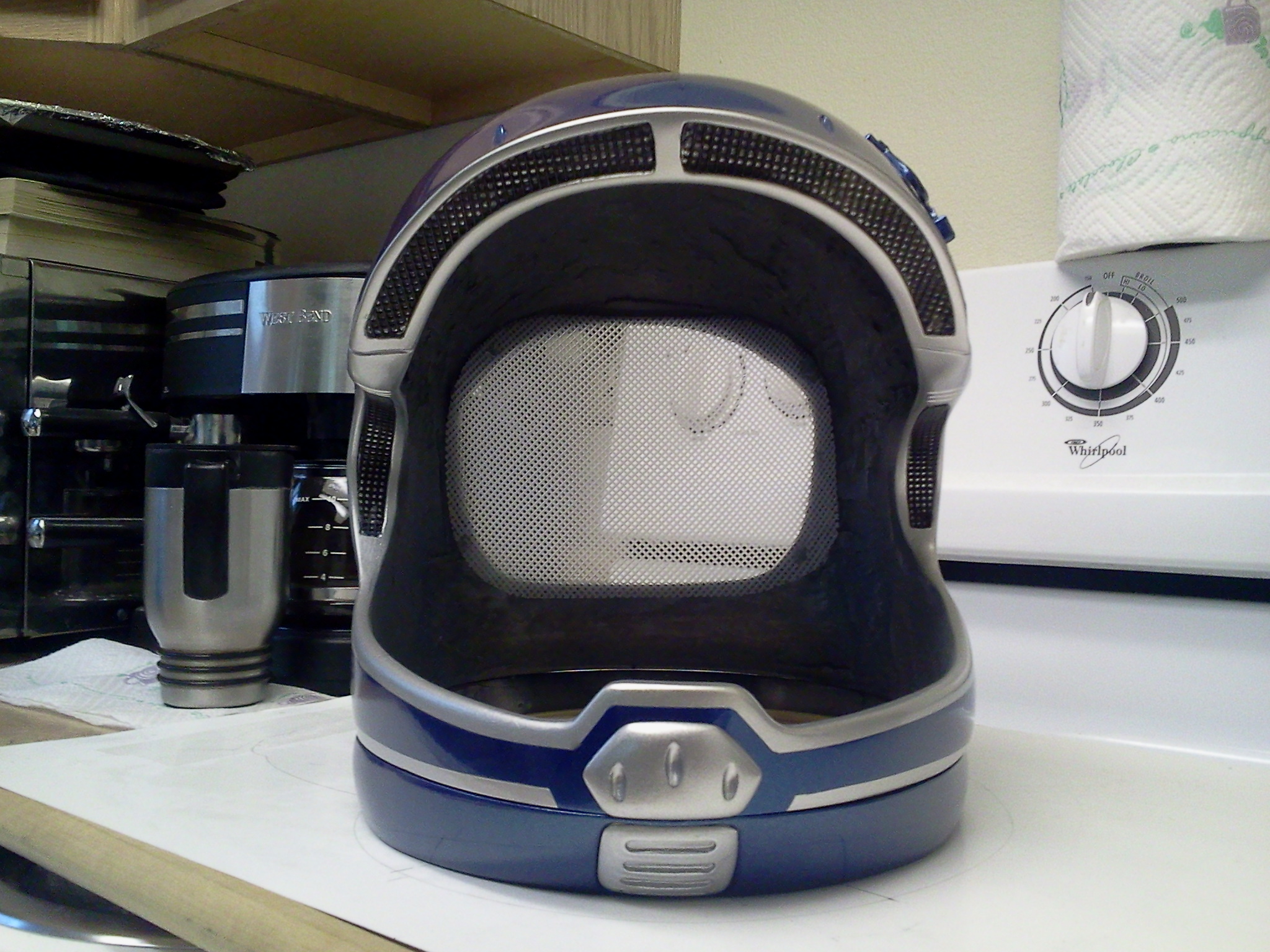

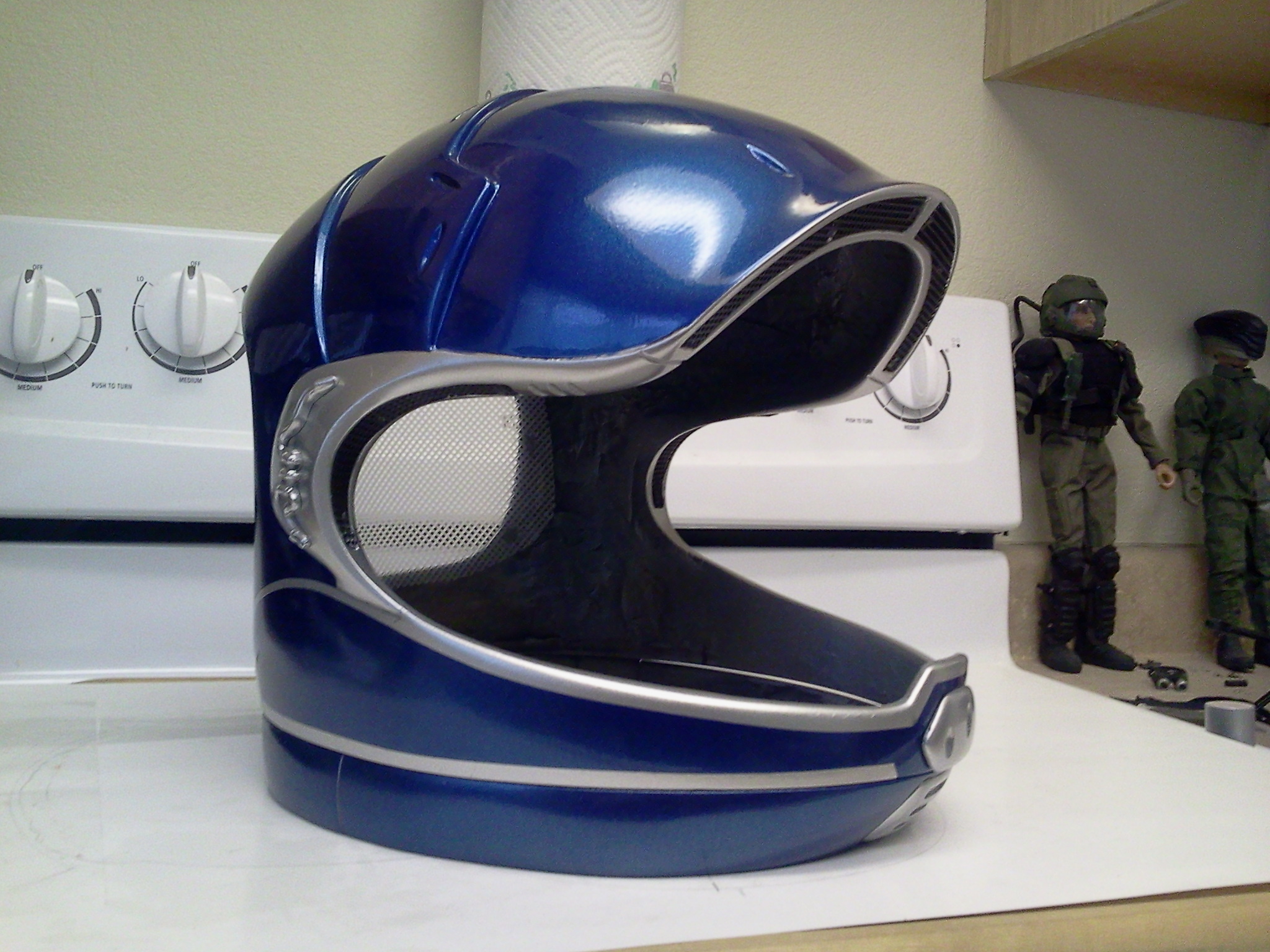

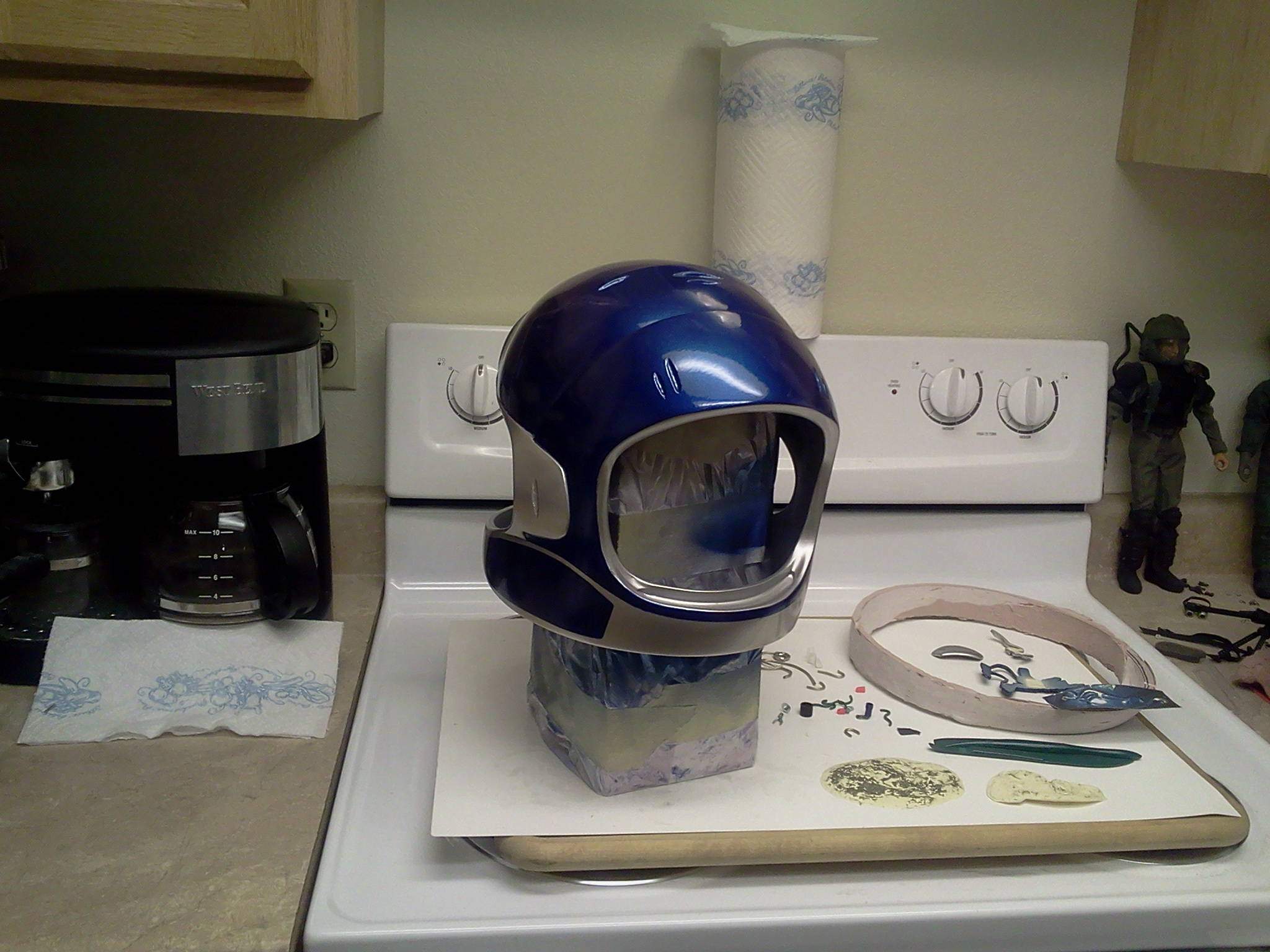

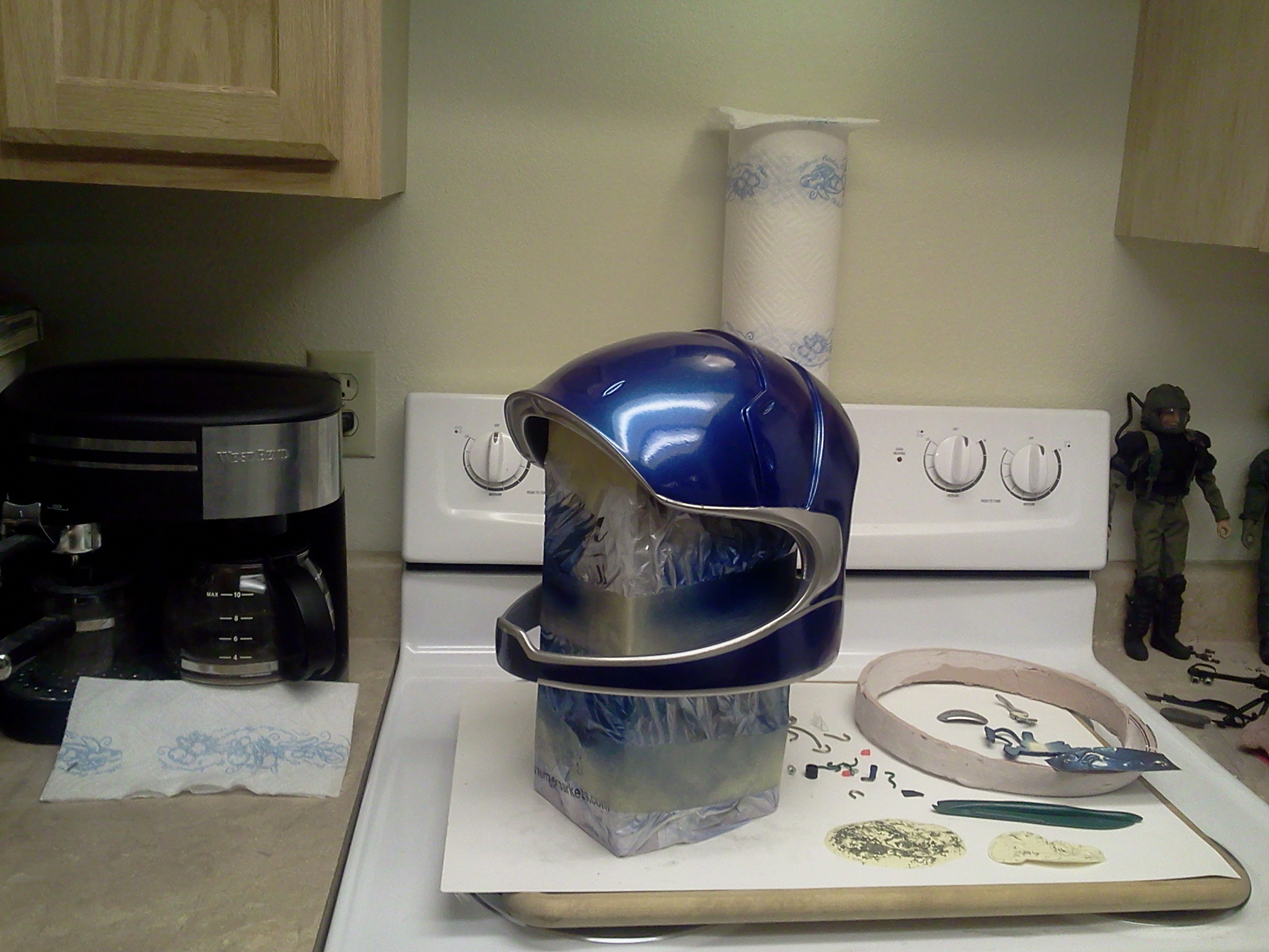

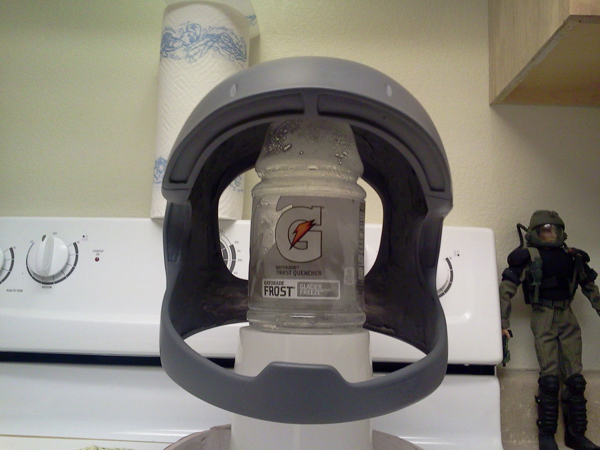

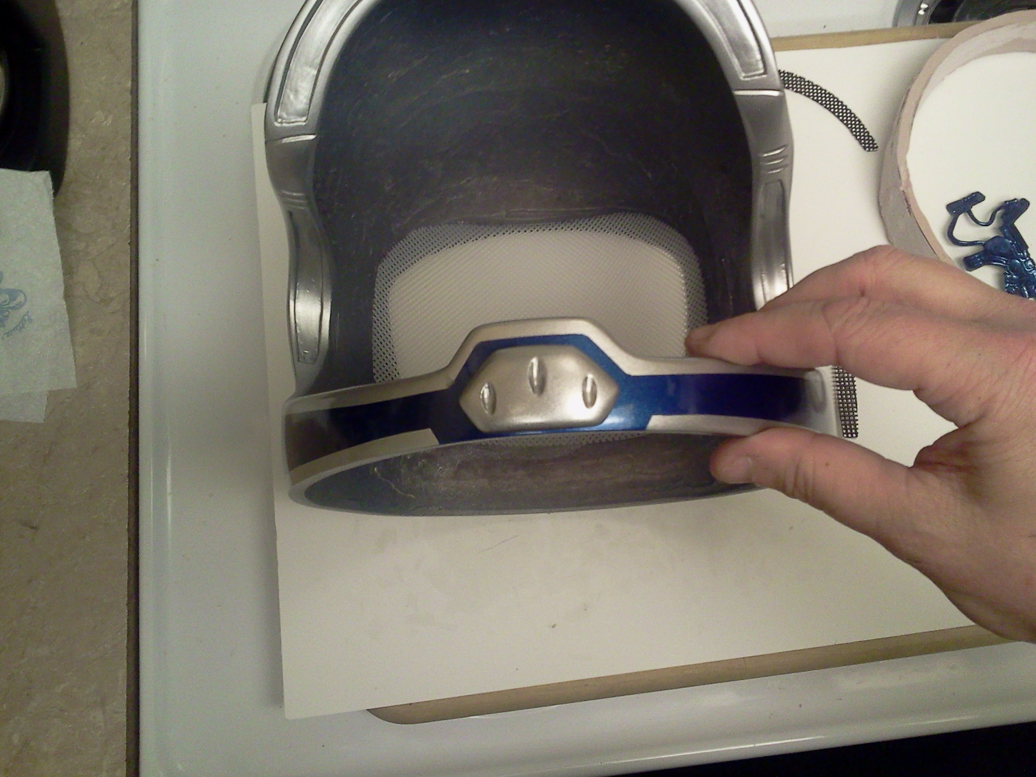

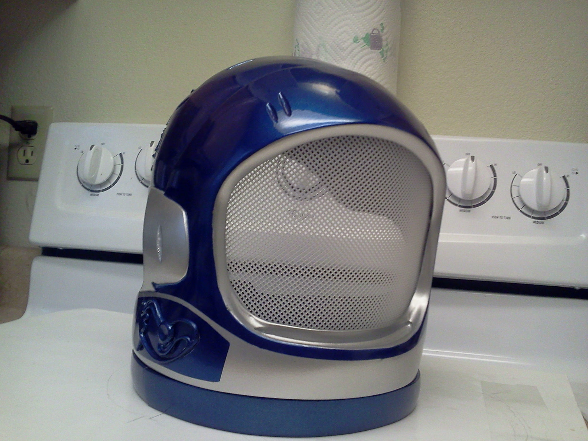

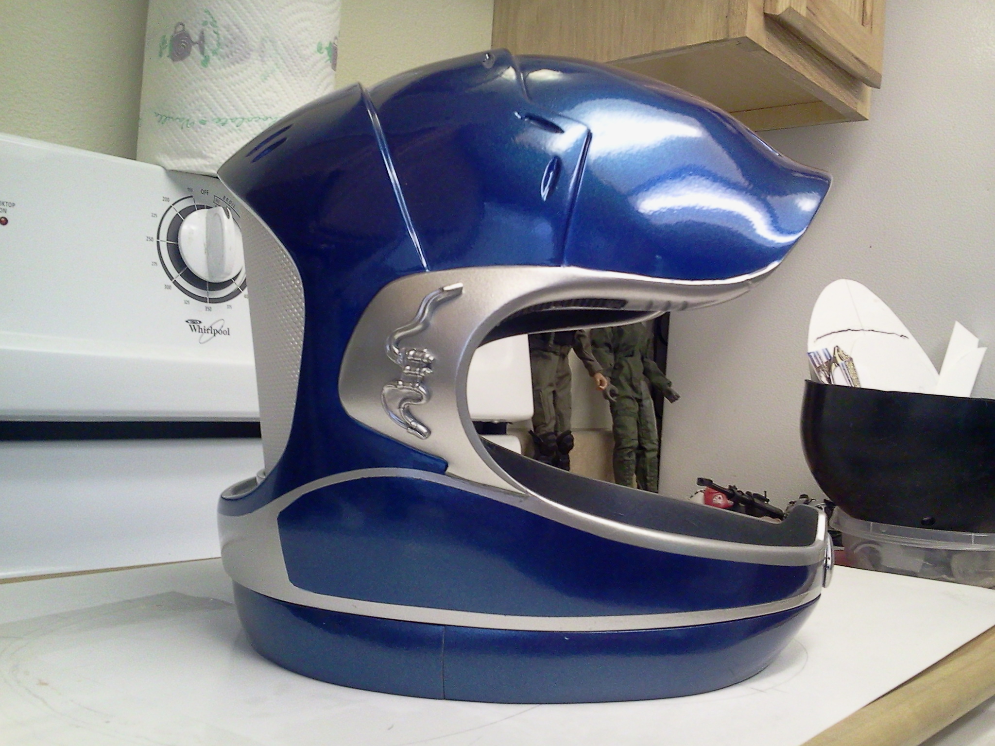

this is were its at now. ive got some magnet's for the neck ring and have a crude mockup for the amber face shield. just need to figure out were to get plastic, and the easiest way to make one. thanks again for your comments and for looking everyone!! 2015-02-26 17.58.24.jpg2015-02-26 17.59.49.jpg2015-02-26 18.00.55.jpg2015-02-26 18.02.37.jpg2015-02-26 18.03.46.jpg 2015-04-11 14.09.11.jpg2015-04-11 14.09.33.jpg2015-04-11 14.10.11.jpg2015-04-11 14.10.34.jpg2015-04-11 14.11.03.jpg2015-04-11 14.08.45.jpg added plastic vented mesh to the rear, and black mesh to the front accent pieces.
thanks man! it was alotta fun. ive got magnets im gonna use to hold the neck ring pieces together and mount to the helmet. the hard part is gonna be making the colored visor...:facepalm

thanks! its a total labor of love. as posted before I bounce around to different project's. im stuck on the helmet until I can figure a way to make the amber visor. I cant find any plastic close enough to invest in practicing. I might have to use clear plastic and then dye it. ive seen a couple people do visors here and they look really good.
