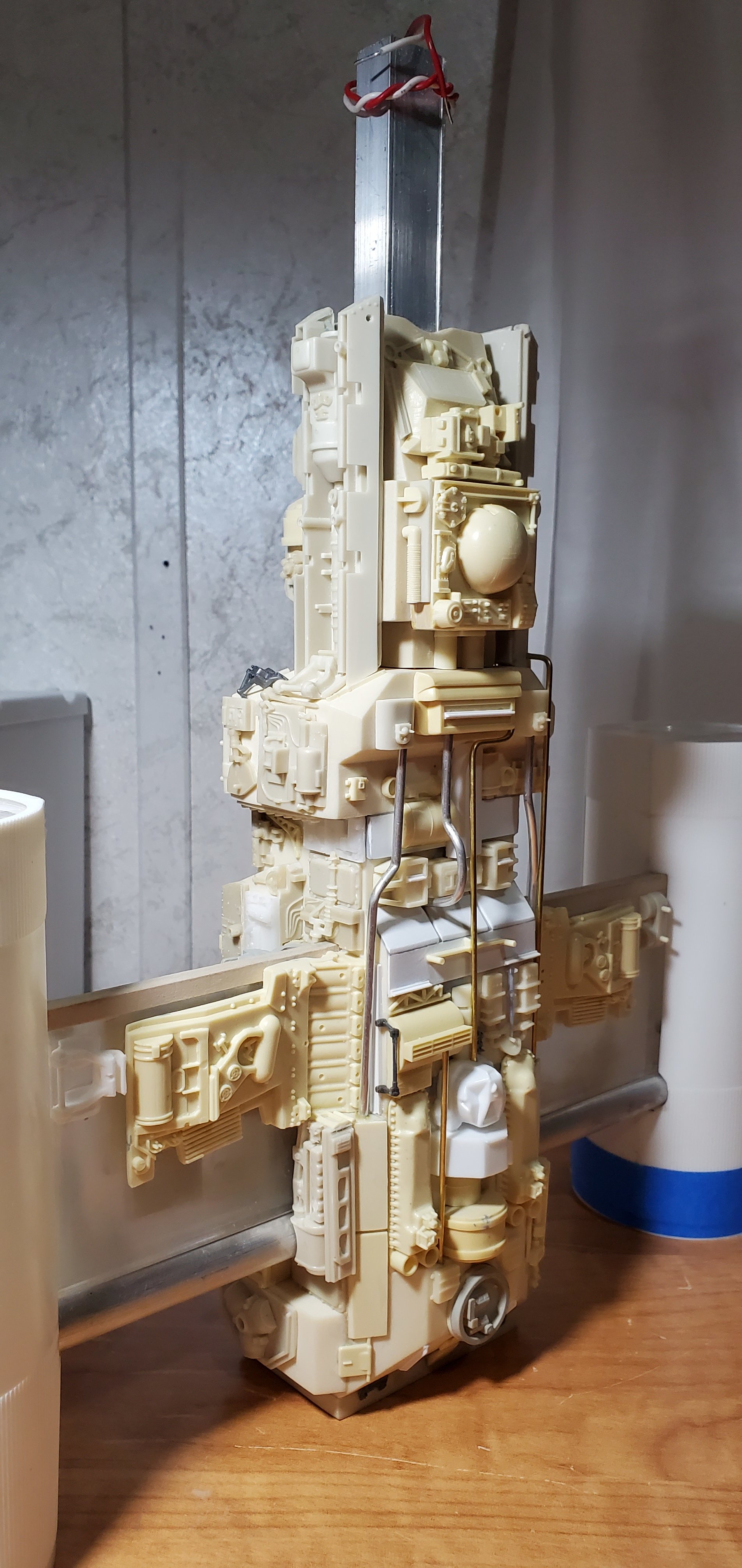

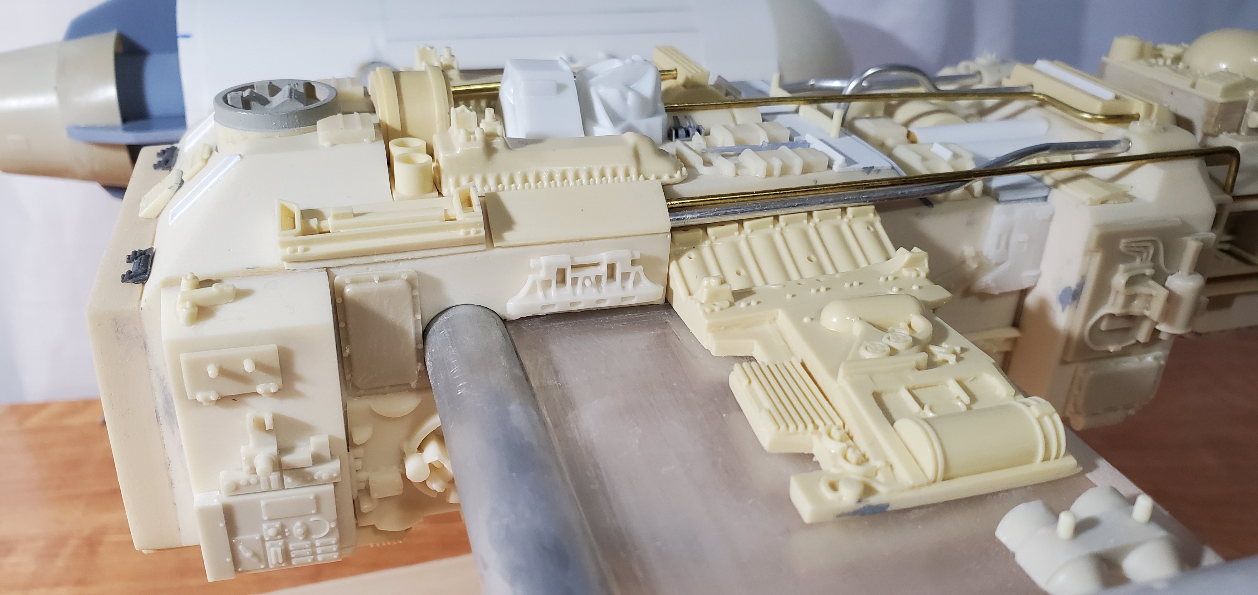

Made more progress today on the port side.
I had to scratch a couple tiny bits but otherwise the greeblies from Studio Kitbash are phenominal.
So much more to do. Yet, I am in no hurry.
Real metal piping? Man, you have WAY more patience (and skill) than I had -- I tried it, but got nowhere close to remotely plausible with any of my bends, so this is really impressive. I used the DuBro metal pipe bender, had both sizes, but still didn't get anything looking as good as your pipe bends. What's the trick?
Lots of errors. Lol
I stopped and will order solid not hollow tubes. Much more uniform bends.
I have two different pipe benders. Combination of them and pliers without teeth helped a lot.

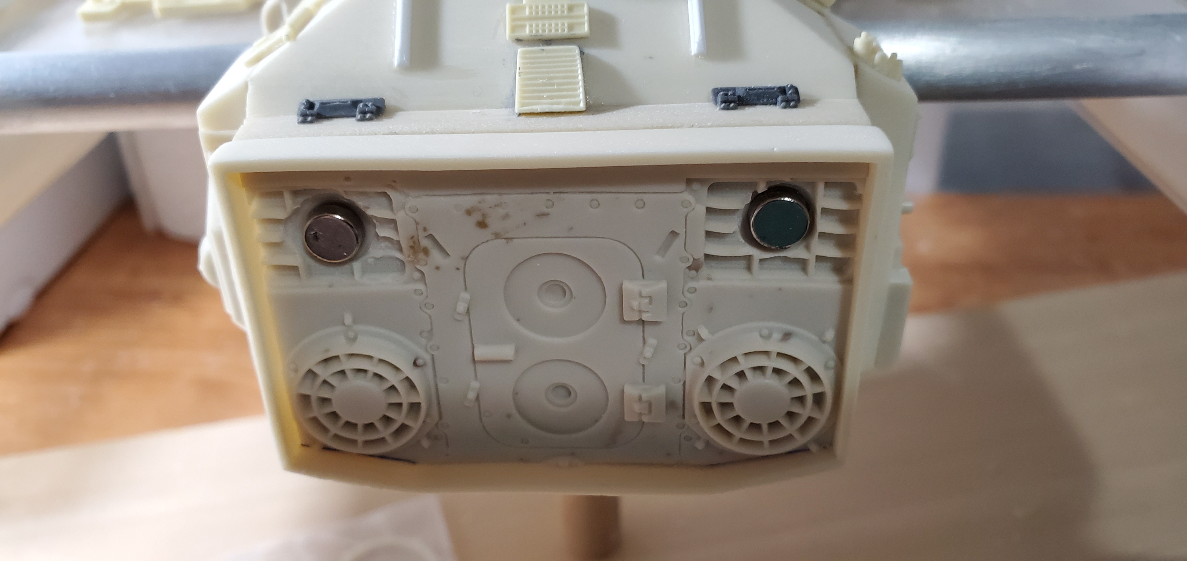

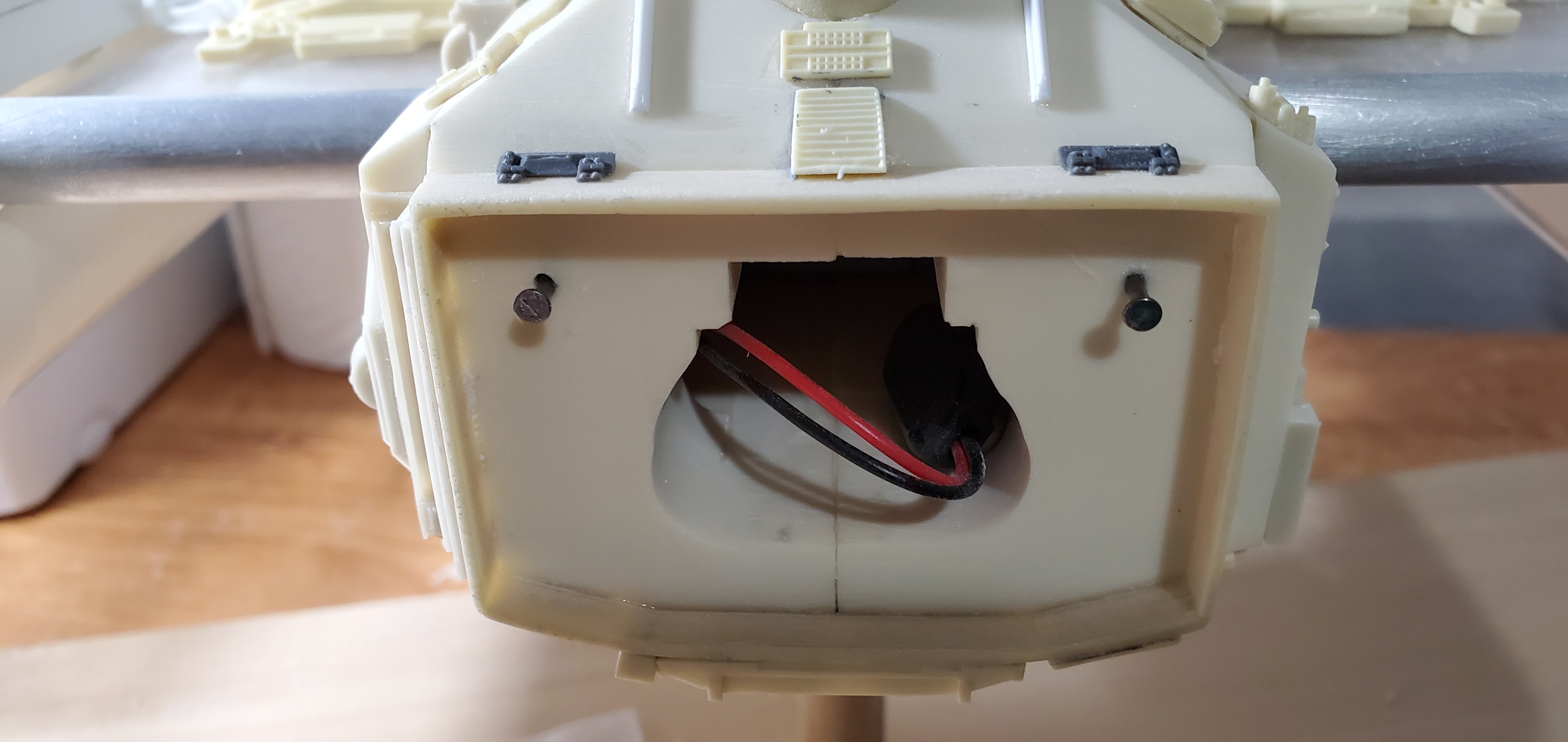

Engine thruster progress and test fit.
They fit perfectly!
I printed the two 'cores' and eight 'fins' for the thruster assembly on our Photon resin printer.
I also molded and cast parts needed from an original Saturn rocket kit. They came out perfect for my needs.
All parts are glued together.
Next up: I need to add the greeblies (from Studio Kitbash).
Then wire in the led's so both thruster assemblies can be permanently installed into the engines.
Please see attached photos of the fully assembled thrusters and my test fit into the y-wing engines.

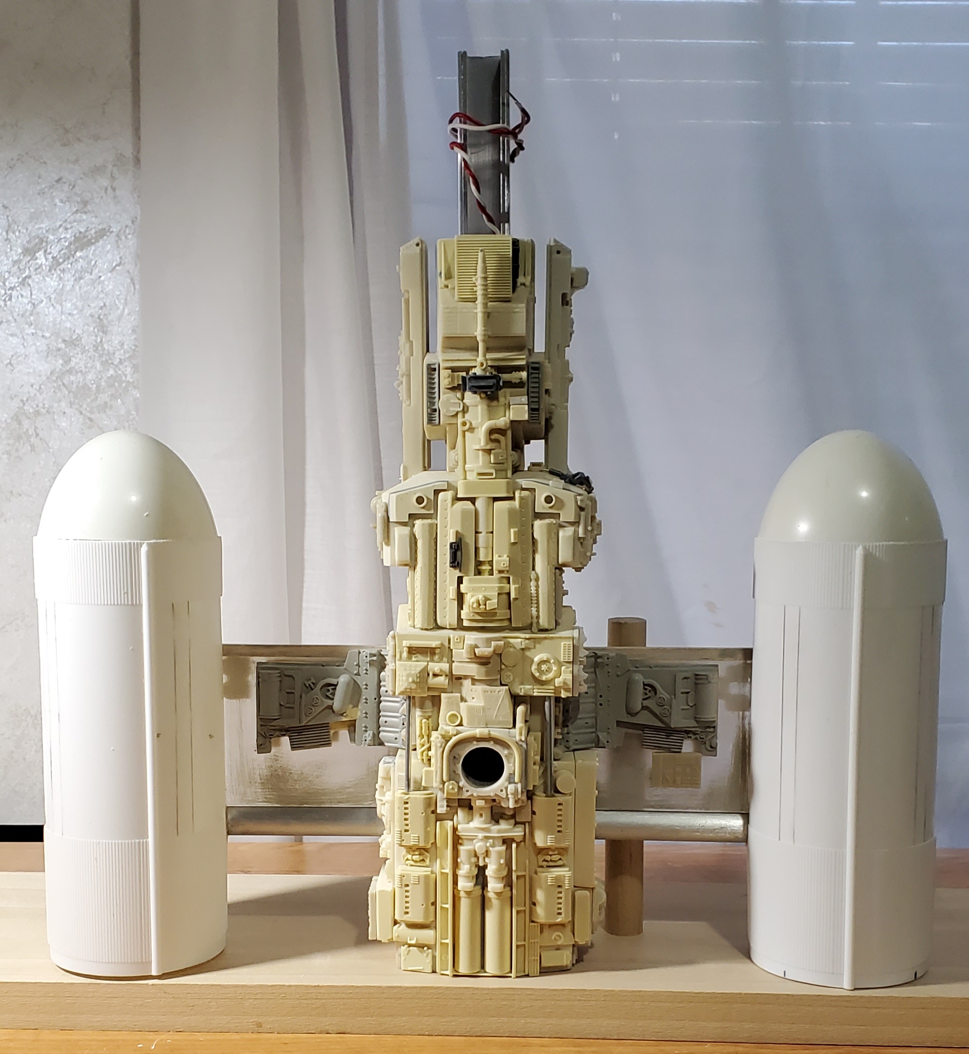

Main body of the ship just needs a few small pieces of polystyrene chips added here and there. I will add more pipes once I get more of the kit done (such as the engines). Otherwise, I think the main body is finished.
A few parts are still unknown to me so I scratched them or made due with a different greeblie that was 'close enough' for me.
I will be working on the engines next!
