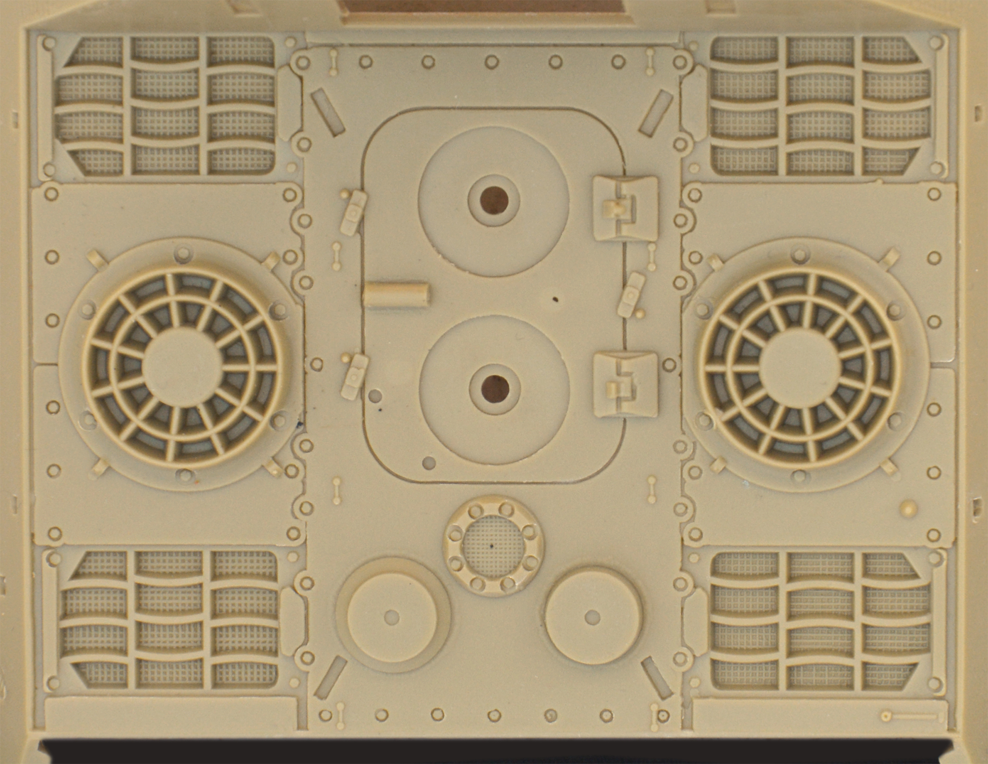

Another closeup on the Jagdtiger:

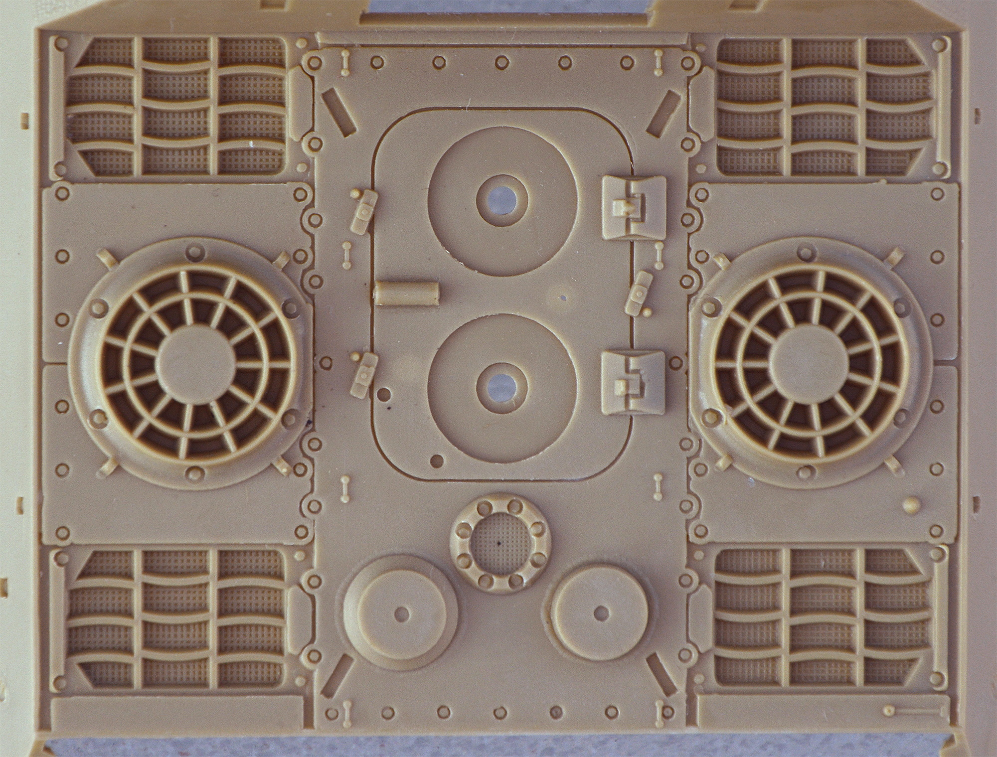

I see it now. Definitely the Jagdtiger. I'm sorry for the confusion last night! I thought I saw something closer in the Tiger II, but the markings in the corners of the circular vents are what make the jagdtiger correct absolutely. I will revise my image back to its old state now! It was tough to see the piece too well in the image from the kit scan section as a shadow was being cast on it mostly. Thanks stonky for that awesome close up, if you don't mind I'll use that as the part example in the map when I revise it!
Are we sure for the brand? Dragon and Tamiya have a version too. I believe Dragon's version has the hatch separated. :)
I have updated the first post image of the rear engine panel now! It has a few new mystery pieces based on seeing that back panel casting on the first page of the thread. The jagdtiger is definitely the donor kit. The image of the rear panel cast and the closeups provided by stonky and vector make it clear. The biggest giveaway to me is the 2 holes in the bottom left of the middle panel, and the 4 tabs that appear at the corners of the round vents on the left and right side of the middle panel.

The Tamiya Jagdtiger details don't match, the Nichimo is a dead match (IMHO :) ).

1000% agree, substitute to taste. That said, this thread is about IDing the donor parts which is why I wanted to present the best evidence to that case. Your question was "Are we sure for the brand?", and I believe that in this context the answer is yes, yes we are. :)
