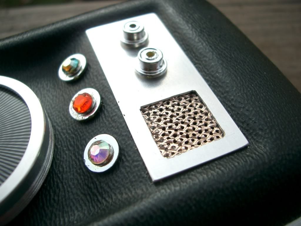

I noticed your moire ring is different. Did that come with the kit?
No, I machined it myself to match the screen caps of Friday's Child. Its an idealized version of the best features of different comms from the show. I also sanded the shells as thin as I could make them and still be able to fit a stopwatch in it. Its a real fun kit to build!

Well here is the finlized version of my Idealized TOS comm.
Wow Steve, great looking comm. Looks just like the real deal (which strangely enough is fake :lol )
