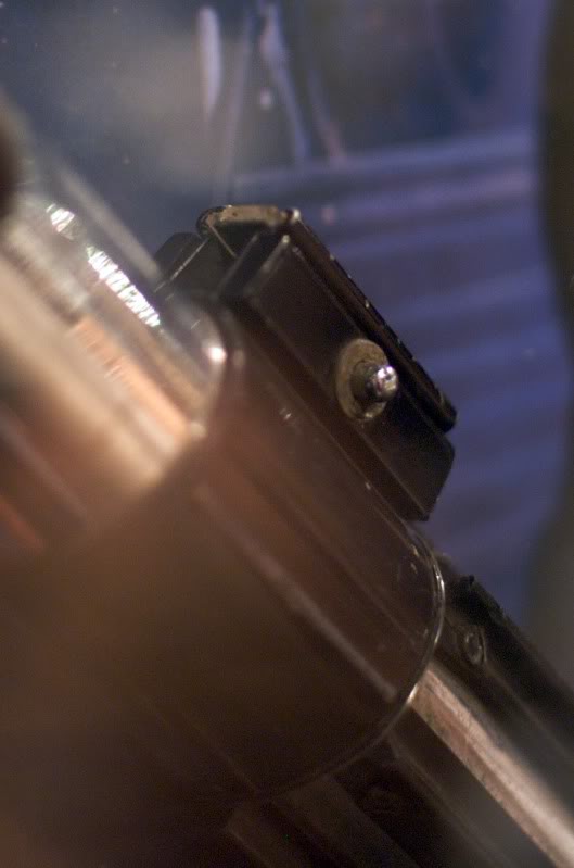

I'm just seeing this thread for the first time, but for future reference there's no need to bend open your clamp rails if you wanna put a piece of circuit board beneath your bubble strips. On the ESB/ROTJ prop the circuit board is cut narrower than the bubble strip and glued to the bottom of the bubbles. It doesn't make contact with the inside of the clamp. I've seen it with my own eyes and this is the best photo I could get to illustrate it.
So, basically, the Vader Hero uses the pinch method.
The bubble strip is "in" the clamp. It's just that the circuit board beneath it has been trimmed down (and presumably glued to the underside of the bubble strip) so that it need not ever even make contact with the clamp. Make sense? I cringe when I see these mangled clamps because people think they need to cram the bubble strip AND the circuit board into the clamp's slots.
Sort of haha, it makes sense to me if the circuit board is wider than the bubbles, so to say. But thinner? What does the clamp grip if not the bubbles?
He's saying the clamp grips the bubble strip. The circuit board is narrower so it's not wide enough to fit into the clamp. It 'floats'. Lol! Anyway, it was just a secondhand Parks that I mangled. We don't even know if the ANH saber had a circuit board in it.
OH! okay, thats...weird haha, thank you! carry on..
