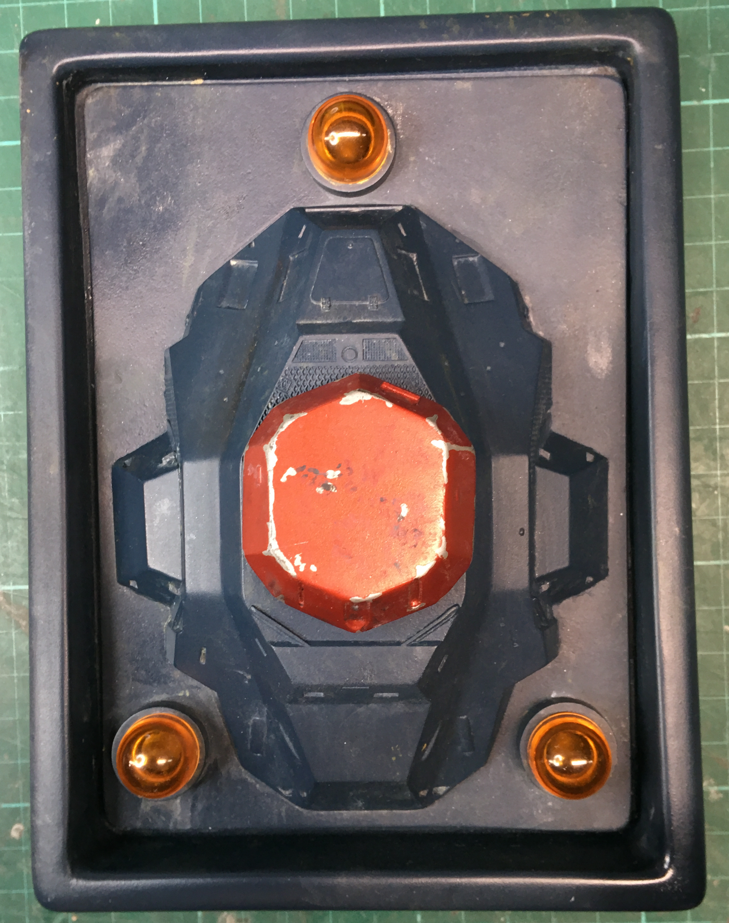

It came with 3 resin parts: plate, round edged frame and switch plate; and 3 fluted, amber light domes w/ a knurled edged base.
Looking at the 3 frames we have as reference, I didn't see a fluted dome, but rather a smooth dome.
Also, the base of the domes seemed smooth to me.
Therefore I purchased 3 smooth domes, and replaced the base w/ scratch-built capped tubes.

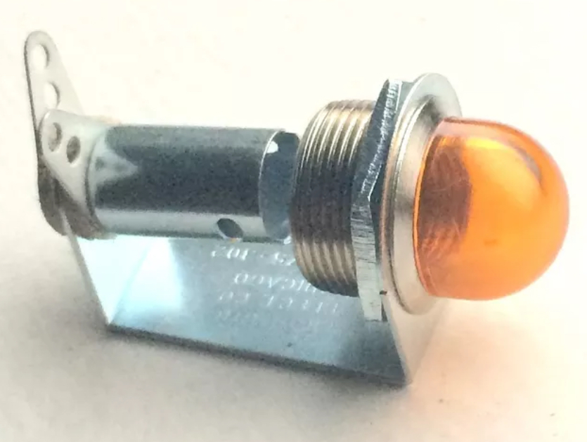

The switch is a pushbutton STDP, CES 66-2460-1PK, which means the current is constantly on.
The middle contact is ground, with the dual LEDs in parallel on one side, the single LED the other.
Much grinding of resin ensued to allow the switch be mounted close to the face.
I used a chain I had as a means to hang it on the wall, and ran the power cable through the wall from the closet it is hung next to.
Daytime I have 2 lights on and at night only one, again as a nightlight.

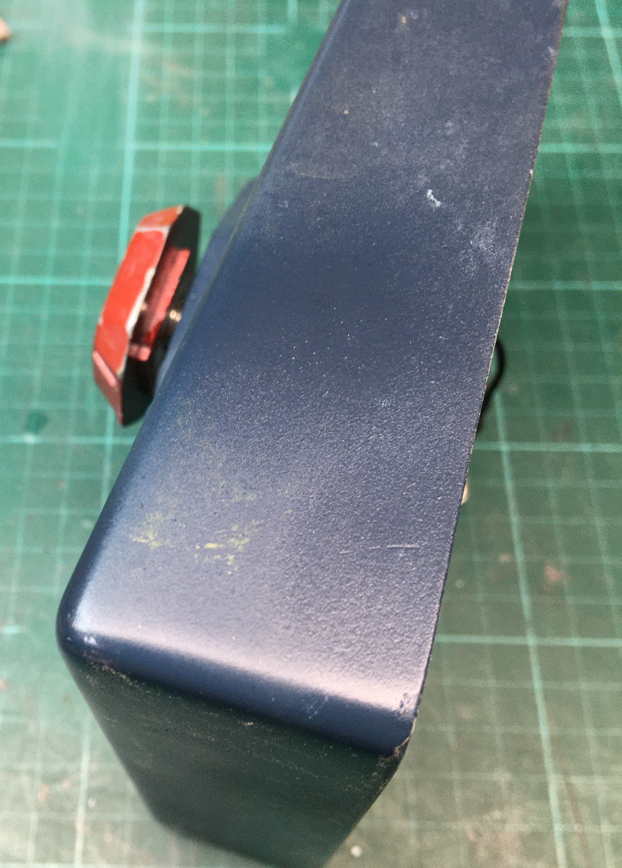

I saw this as a dark blue. Is it? I don't know for sure, but why not?
Until a BTS color photo pops up I'm going to keep it this color.
Light weathering was done w/ acrylics, as that allowed me to wipe away any mistakes.
All in all, I'm satisfied w/ how this turned out, even if the domes and color turn out to be wrong.
At night you can't tell:)
