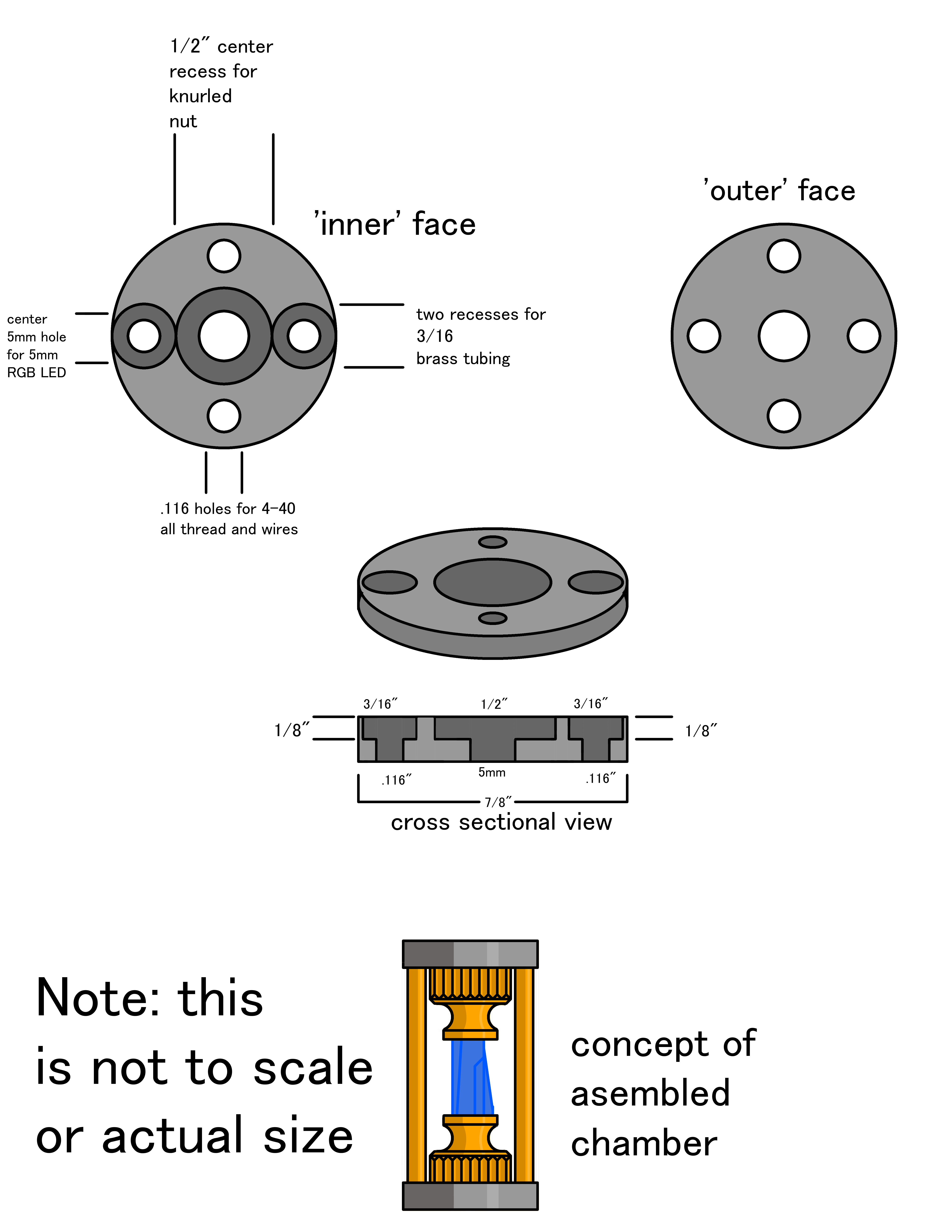

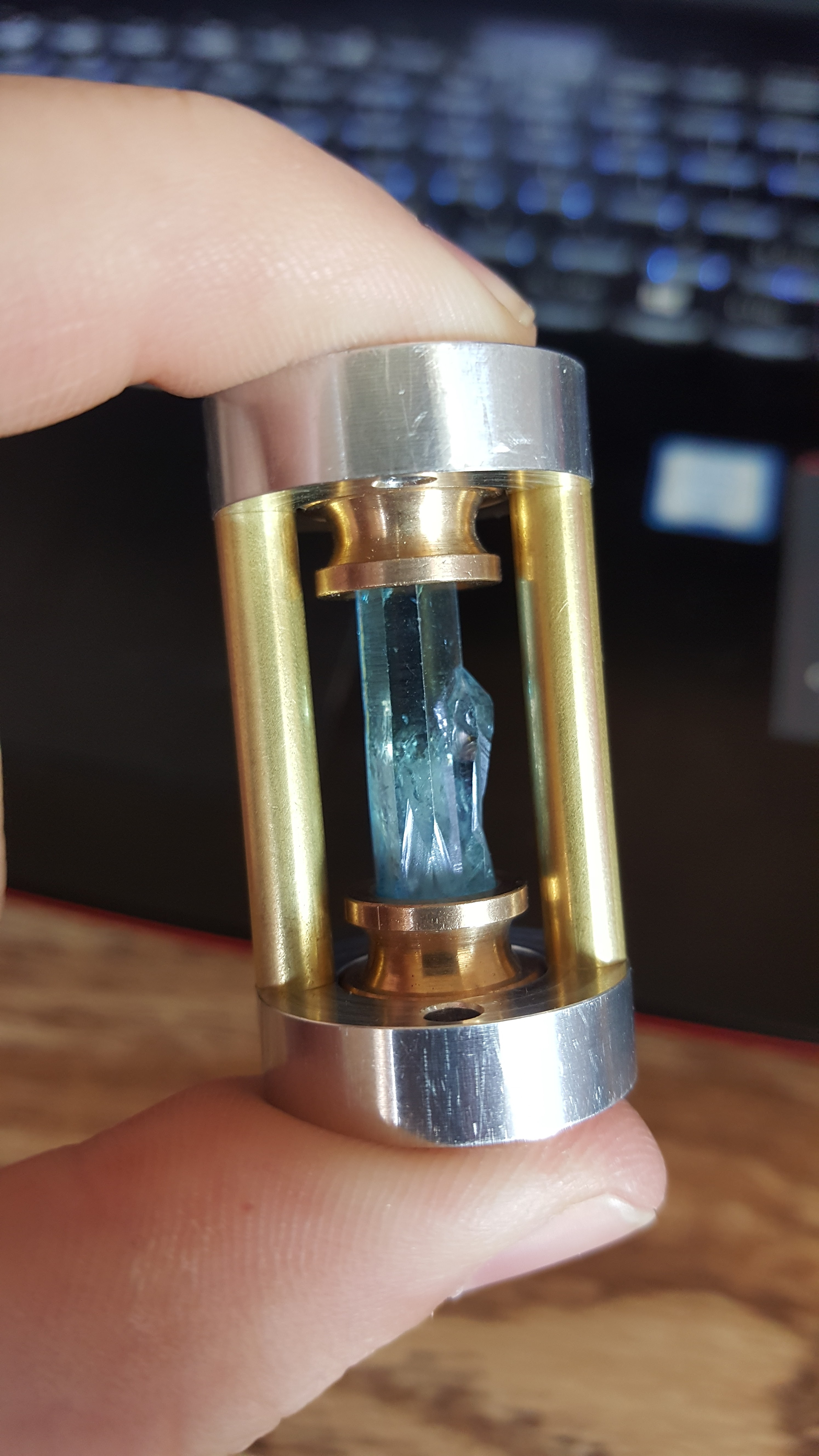

Or you could try and make your own. Here's a simple one I did. I had Tim at The Custom Saber Shop machine me some parts. This was the concept I came up with.
Typically you want a tip and bottom. With some holes for 4-40 all thread to hold it together, or other chassis parts. Then some tubing to hide the all thread and wires. Or you can go with exposed wires. I used knurled nuts drilled out to hold the crystal.
I also made some designed some discs and had them printed through shapeways for another saber I'm doing. Those turned out okay. I needed to make the recesses for the tubes deeper.
