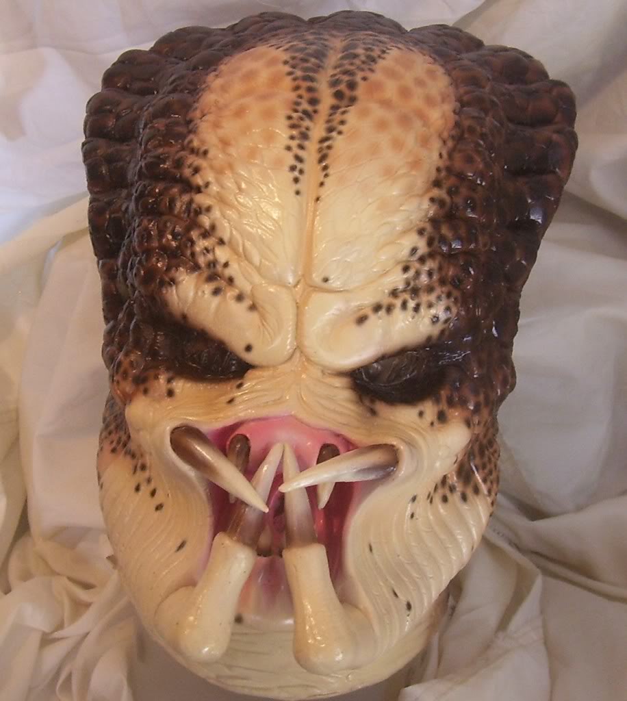

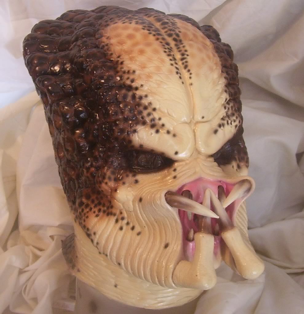

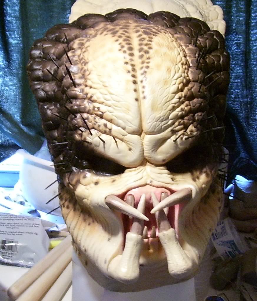

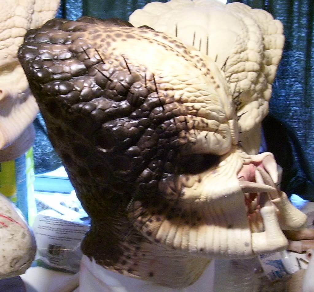

Ok paint update! Sorry to throw this in during dread making but i wanted to show what other paint options there are. I had a special request for a darker paintup and a more solid color near the outside so here it is. How do you feel about this paintup?
MASK4ME
This is unbelievable.....I saw this and had to register and make a comment on your work.Its outstanding. You are eat up with talent my friend.I love the step by step process you shared of making it.Keep up the great work.

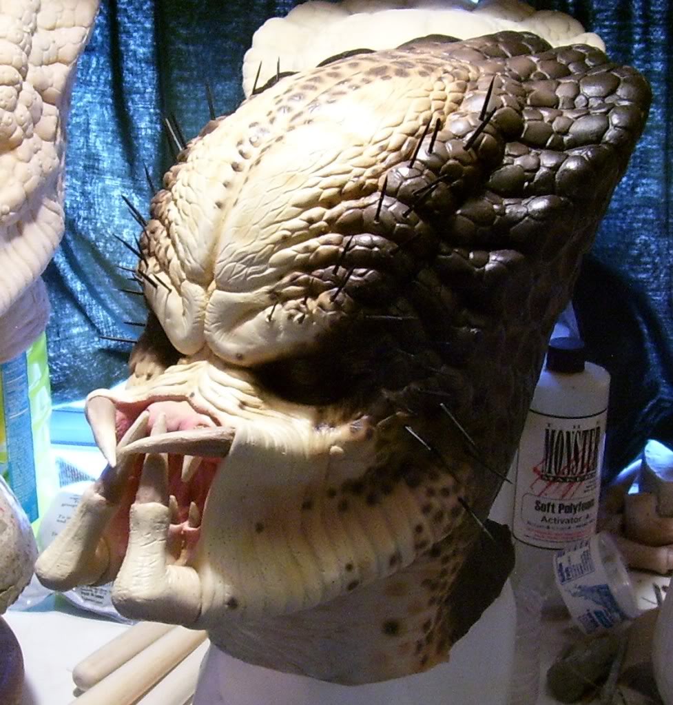

Sorry, i just got my order of latex in so i have resumed casting latex in the molds. The polyfoam infill is hopefully ariving today so i can start foam filling heads again, and the silicon for the dreads is supposed to be here wednesday. I will post updates as i recive my supplies. My friends and I are starting filming on a super low budget zombie movie in the colorado springs area if anyone wants to come be a part of it. I will post updates on that too in another thread eventualy.

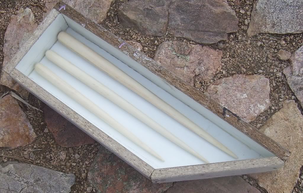

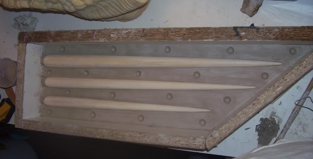

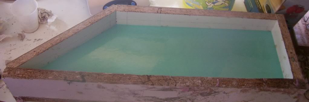

Ok, i built the box that i will mold the dreads in. It is all 3/4 inch melemine (or however you spell that) and sealed with hot glue to make sure the silicone cant leak anywhere. I scrapped the smallest one because i realized it was a waste of precious silicon because i can just fill the tip of one of the others and that will work just the same... I need to build up WED clay all around the dreads but it looks like the silicon pour planned for today will have to be pushed back a day. I have heavy monsoon rains coming in today and the temperature suddenly dropped and silicon doesent like cold or moisture. SOOO maybe tommarow i will pour the first side of the mold, weather permitting. The silicon is a mold max 40 from smooth on and the form i made will also be the mother mold when its done. More soon! Damn colorado weather... :D
Termokk

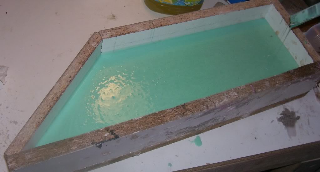

First side has been poured! As you can see here, i filled in around the dreads with waterbased clay up to the halfway point and then cut little scoop keys into that to lock the two pieces together. After a good coating of clear sealer it was ready to pour!
And then comes the mint green silicon. I dont have a vaccum-degasser like most of us, so to help limit the bubbles i poured the silicon from up high so it squeezes down to just a thread and pops any bubbles. Once its in the mold you can LIGHTLY bang your hand on the table and it will further dislodge any airbubbles and as they float to the surface you can blow on them and they will pop. I am in the process of popping the bubbles in this pic.
And finaly today it has set up. All the bubbles are gone, and shes smooth and clean. Gotta carfuly flip it over and get it ready to make another side.
xdmray
hey corey i thought silicone cured with water. or is it only the caulking that cures with water? when i did the silicone caulking tube method, i had a tip to mist it with water, to help it cure faster. mold looks great man, i love molding pics
Termokk
Its a chemical reaction in the 2 part silicons like this i beleve. (tin cure) This is smooth-on's mold max 40 a semi ridgid pourable casting rubber. I havent tryed the caulk method but i am curious to try new things.

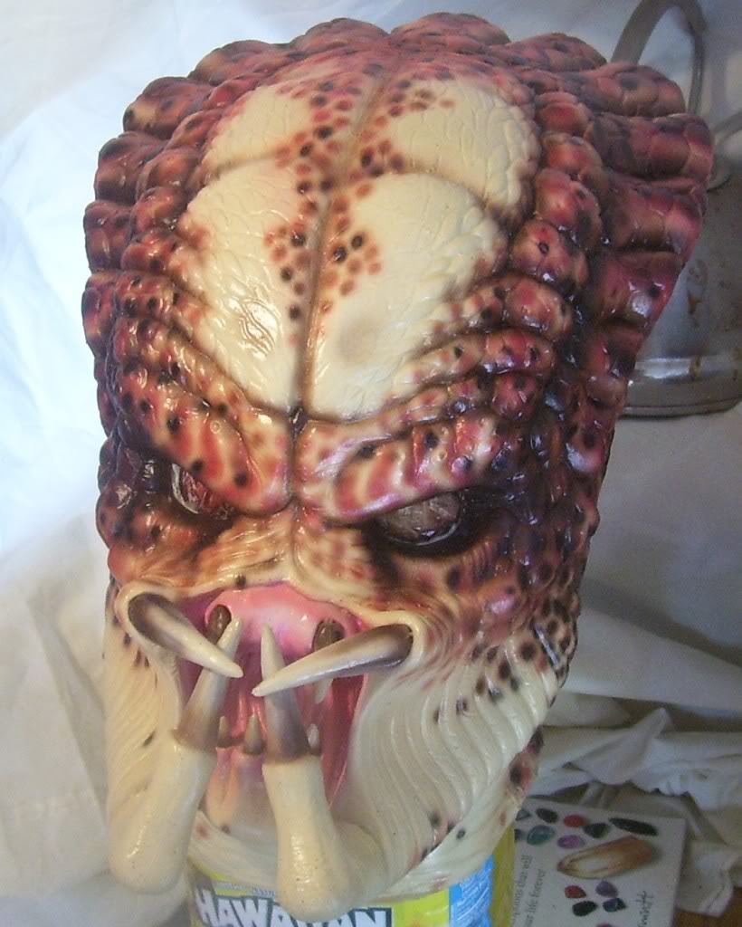

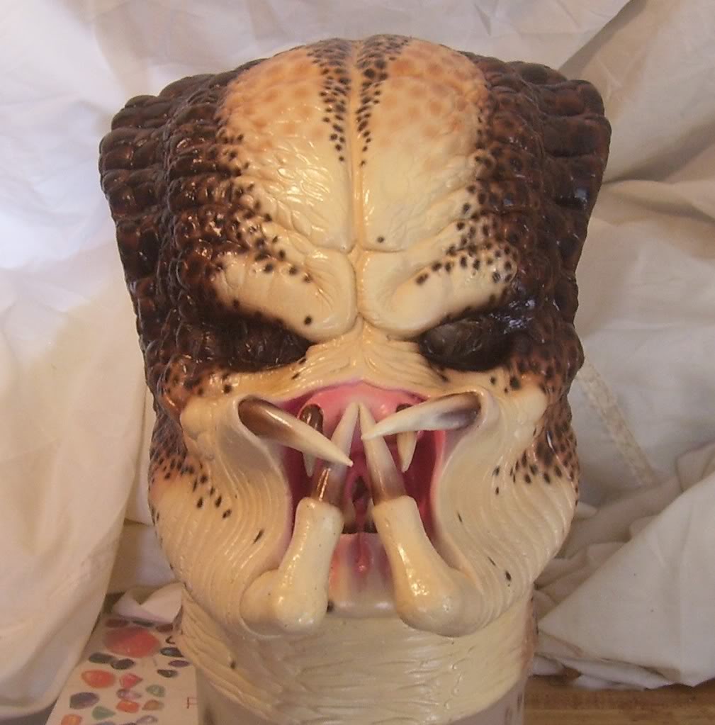

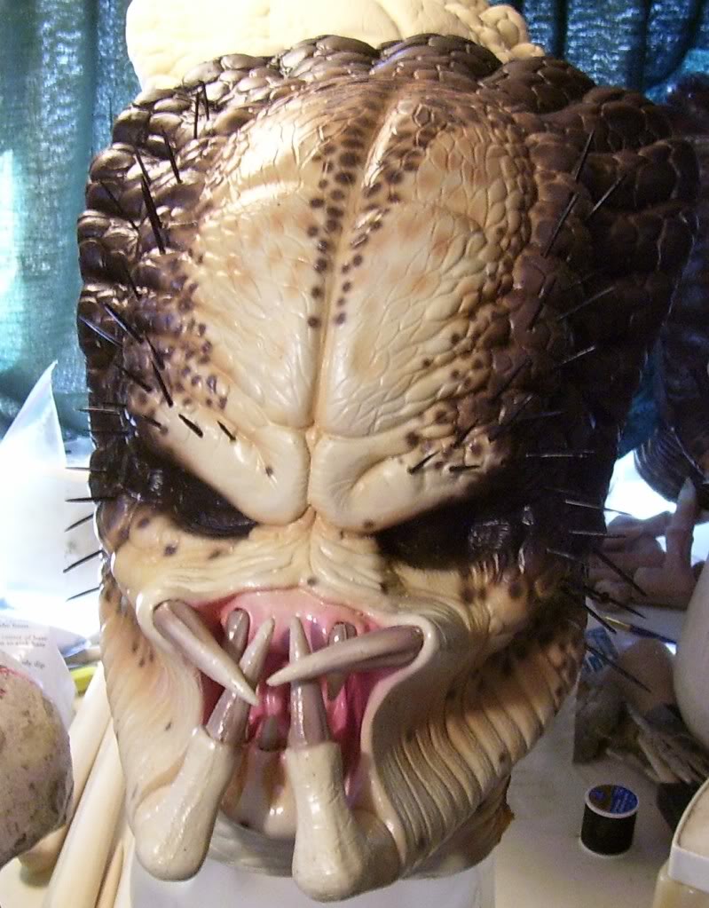

Here are two paintups i did recentaly. The P1 is a mask for me and i will post pictures of me wearing it once the permawet is dry. The other mask is a combination P1/P2 using the P2 colors and the P1 design. Let me know what you think.
