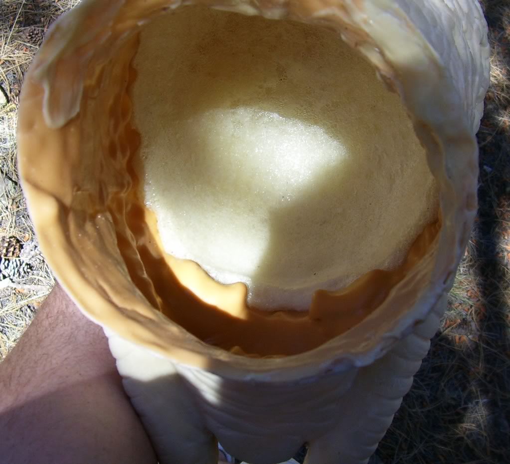

Thank you all for commenting! It is the fuel that keeps me going! :) Well i have been experimenting with foam filling my masks, so i wanted to discuss it with everyone and see what you think. Idealy, i would have a hollow head cast with a hole drilled on the inside to act as a pour spout for the polyfoam wile it is still in the mold BUT, my headcast is solid so that rules that out for now until i can make a beter one later. So what i have been doing is covering my headcast with a layer of vasaline (to keep the polyfoam from sticking) and pouring the polyfoam into the head and then sliding it back onto the headcast, wile the head is hanging upsidedown to prevent the latex from sagging. I have been expirimenting and i have found that just foam filling the crown of the head down to about the eyes is more than enough. The rest of the face is supported and where the dreads will attach is all supported but the rest of your face can breath, not to mention that polyfoam leeches oils because it is a petrolium product, that can irritate your skin. So having the area around your face and neck open underneath its a little less hot and uncomfortable to have on for long periods. I am not saying this is "the way" to do this but this is what i have found that works best for me. Because it cant be in the molds when i do it, there can be slight variations in the mask, but it never goes out of symmetry because the latex it to thick to allow it too. Well here is a simple picture to demonstrate a foam filled head... Thanks for looking.

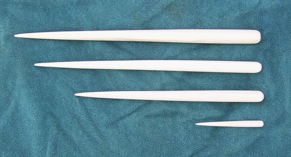

Ok and here it is, the first progress pictures of the dreads that are made to fit this head. The biggest of the dreads is about 1 inch around by 19 inches long, down to the smallest one is 7/16 of an inch by 5 inches. I decided i wanted to make them out of self skinning expanding foam so i will be molding these in silicon. I have an order in for some supplys and once they arive i can get started. These dread bases are dowel rods i took to the belt sander to rough it out, and my handheld sander to smooth them down so they are hopefully smooth as glass. I have a tiny bit more sanding to do but the basic shapes are there. I cut down on the size of these dreads because of the lessons i learned from my last set of dreads- The last set was so long it got to be to heavy on the head and would pull the latex and make distortions. These are about the same length as the P1's and with makeing them out of just foam this time they will be very light and bouncy and comfortable to wear around. Thanks for looking.
