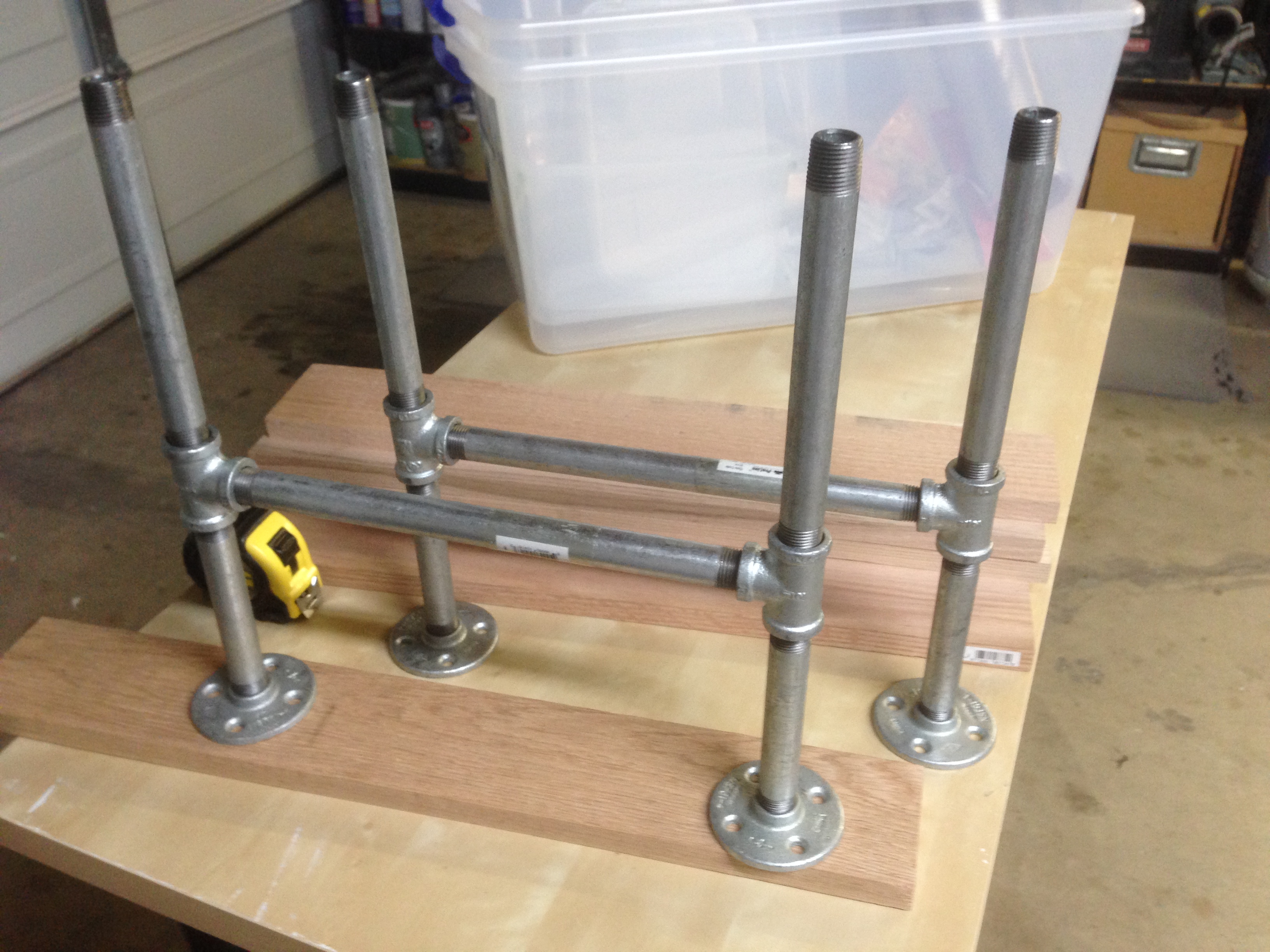

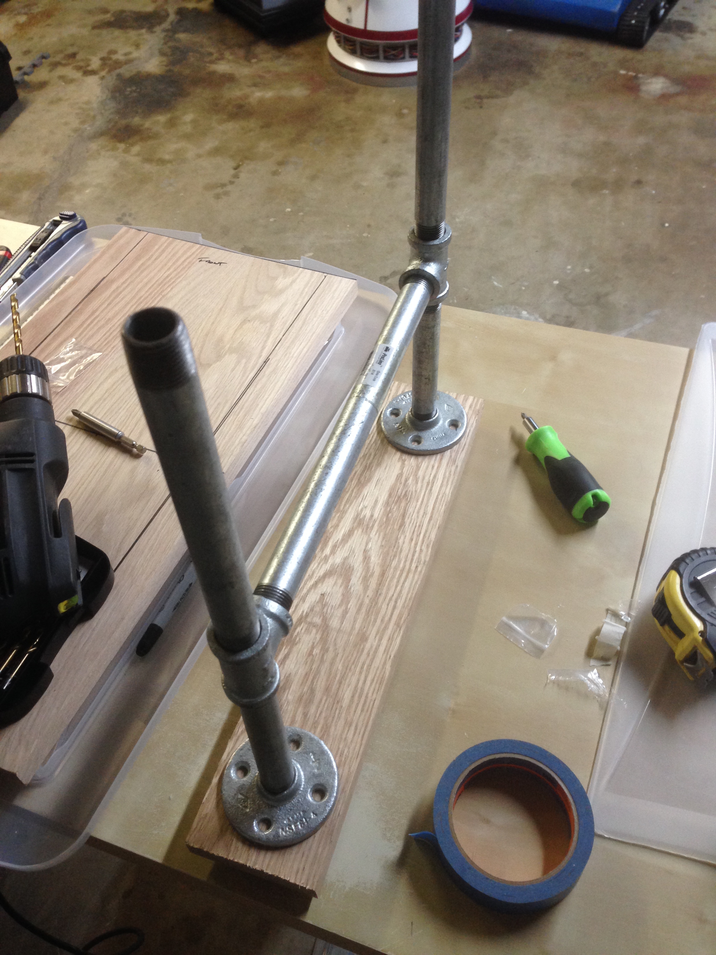

Jumping in I purchased some 1/2 inch gas pipe and fittings to act as the legs of the droid. I simply assembled these and set aside.

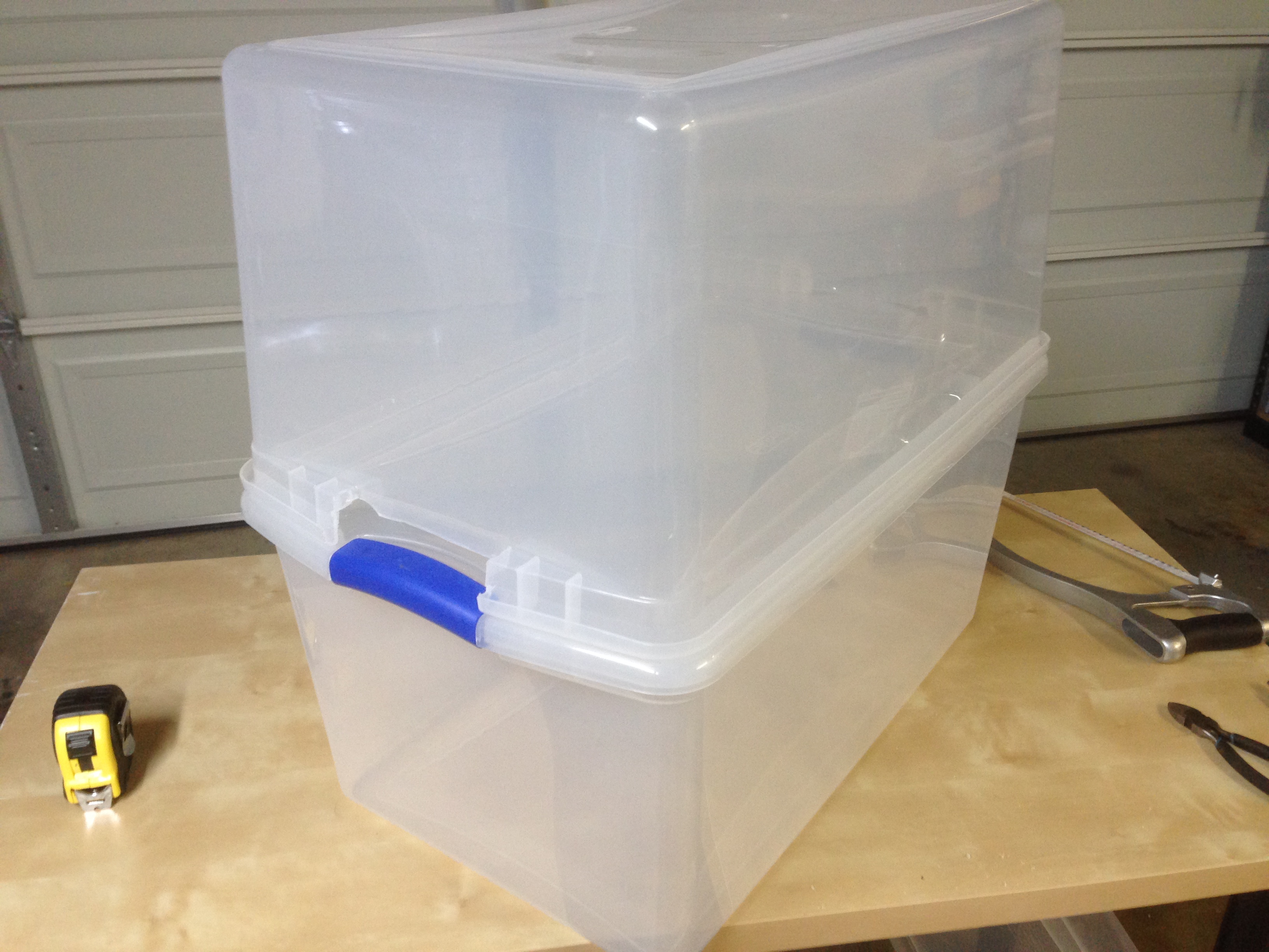

Next is a test fit of the two bins I plan on using.
I am planning on using the lid of the lower bin to act as a shelf inside the droid for my chargers. So I will cut the handles off the upper bin.

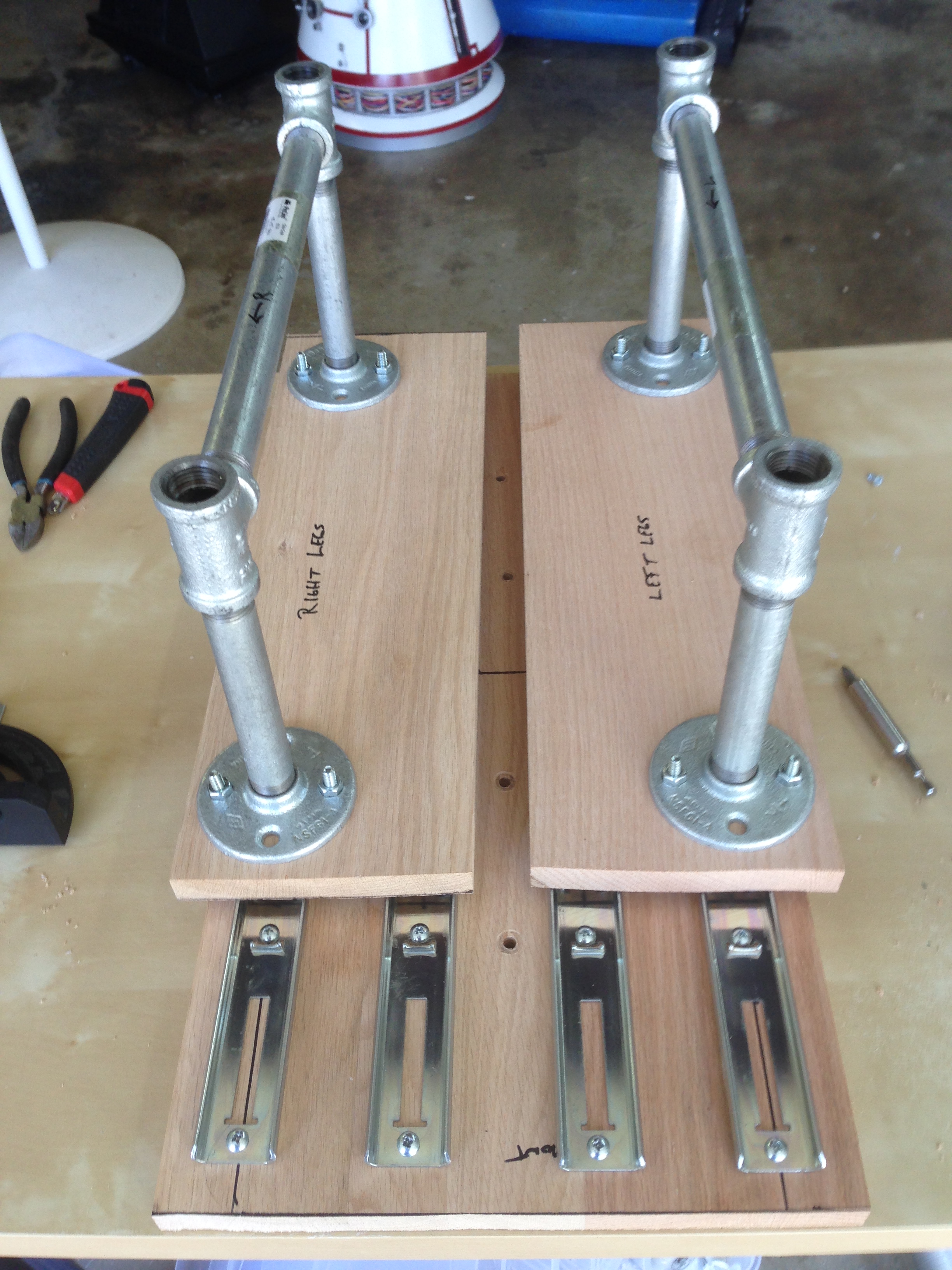

Next I am using 16 inch under mount drawer slides to allow the legs to move forward and backward. The drawer slide is attached to a 4-inch piece of oak.
The metal legs I assembled yesterday are bolted through the 4-inch piece of oak and the drawer slide is mounted to the larger board.
2014-06-07 21.45.48.jpg 2014-06-07 21.51.59.jpg 2014-06-07 21.54.51.jpg 2014-06-07 21.55.12.jpg

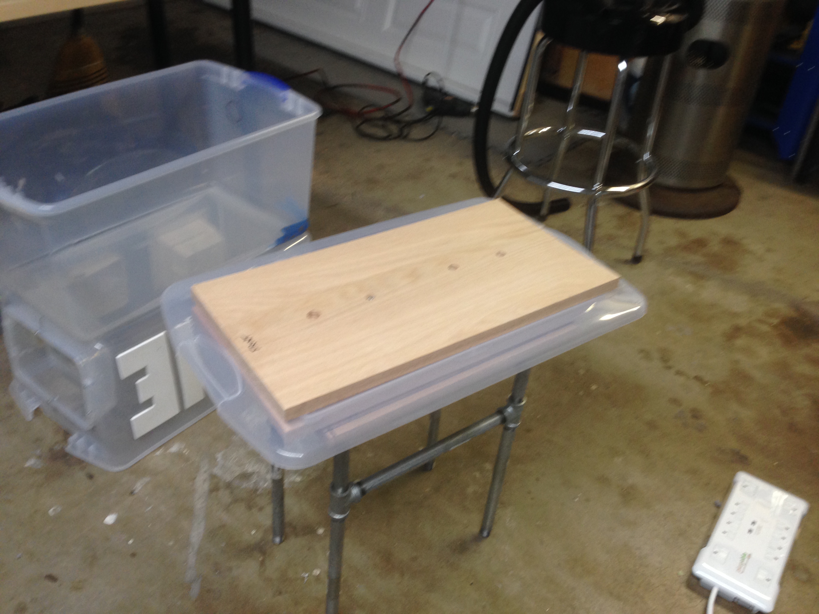

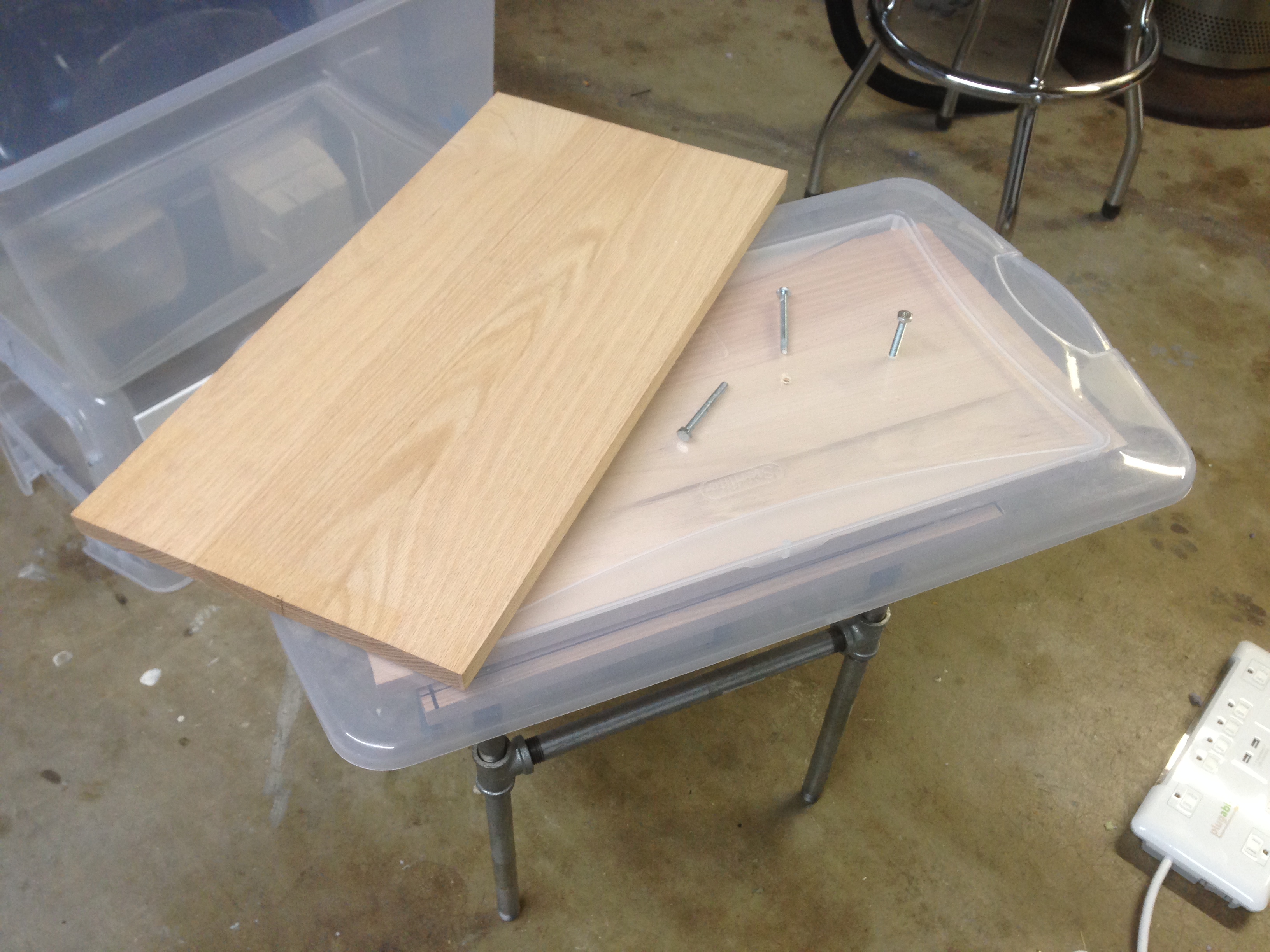

Once the legs were attached, I bolted the lid onto the board. I connected the lower bin just to get an idea of what it will look like.

After finishing I noticed the single drawer slide is rocking side to side and making the whole droid a bit wobbly. The slide will surly fail once I add weight and movement.
So I disassembled everything.
And rebuilt the slide mechanism with two drawer slides per leg and used a six inch piece of oak instead of a four inch piece.
2014-06-08 16.41.49.jpg 2014-06-08 16.42.02.jpg 2014-06-08 16.54.00.jpg 2014-06-08 17.01.31.jpg2014-06-08 17.01.36.jpg
I also decided to make him a little taller, so I replaced the eight inch gas pipe with twelve inch pipe. I then reattached the lid.

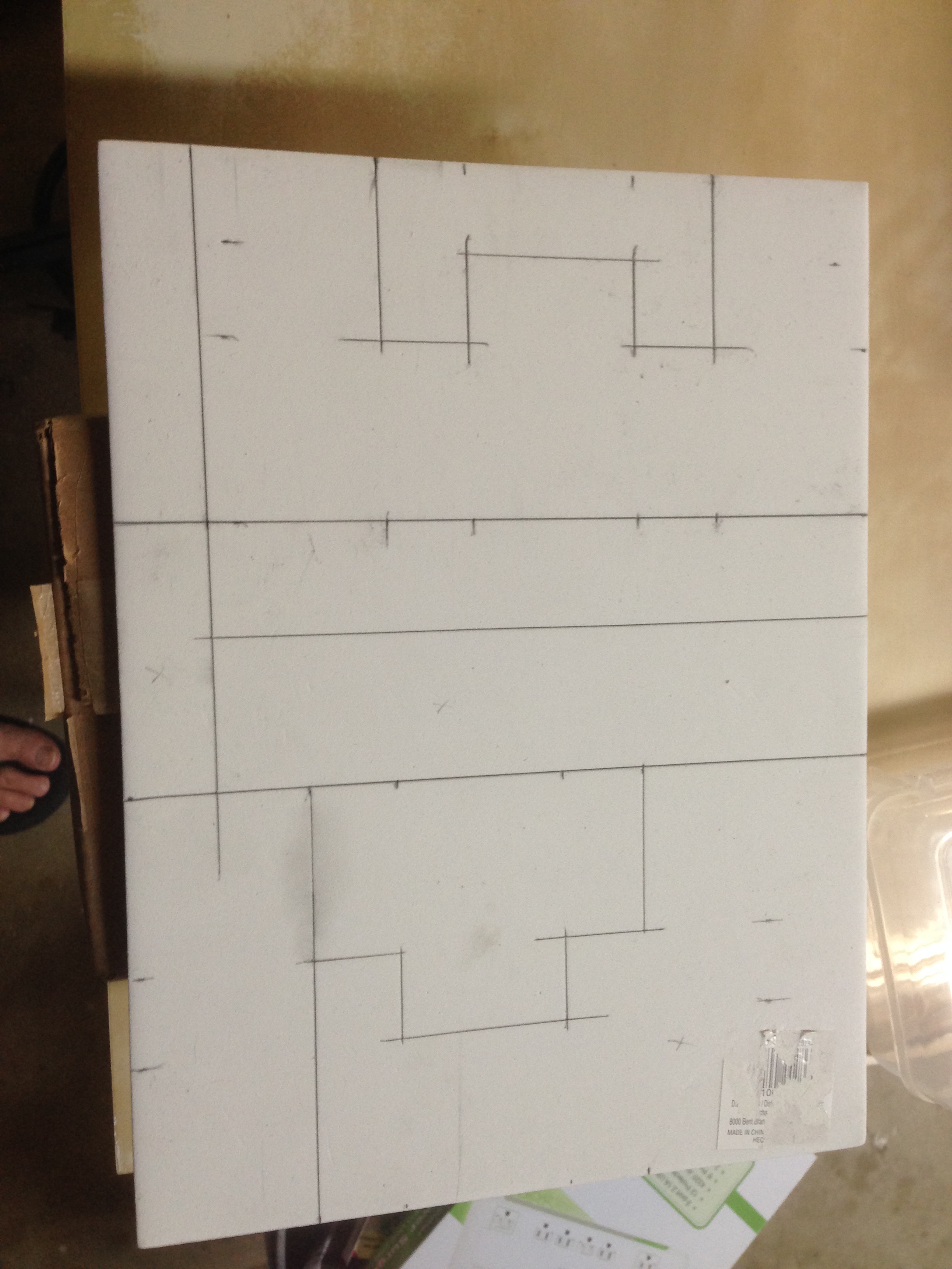

so started this weekend with drawing out the backwards E and other details in foam.

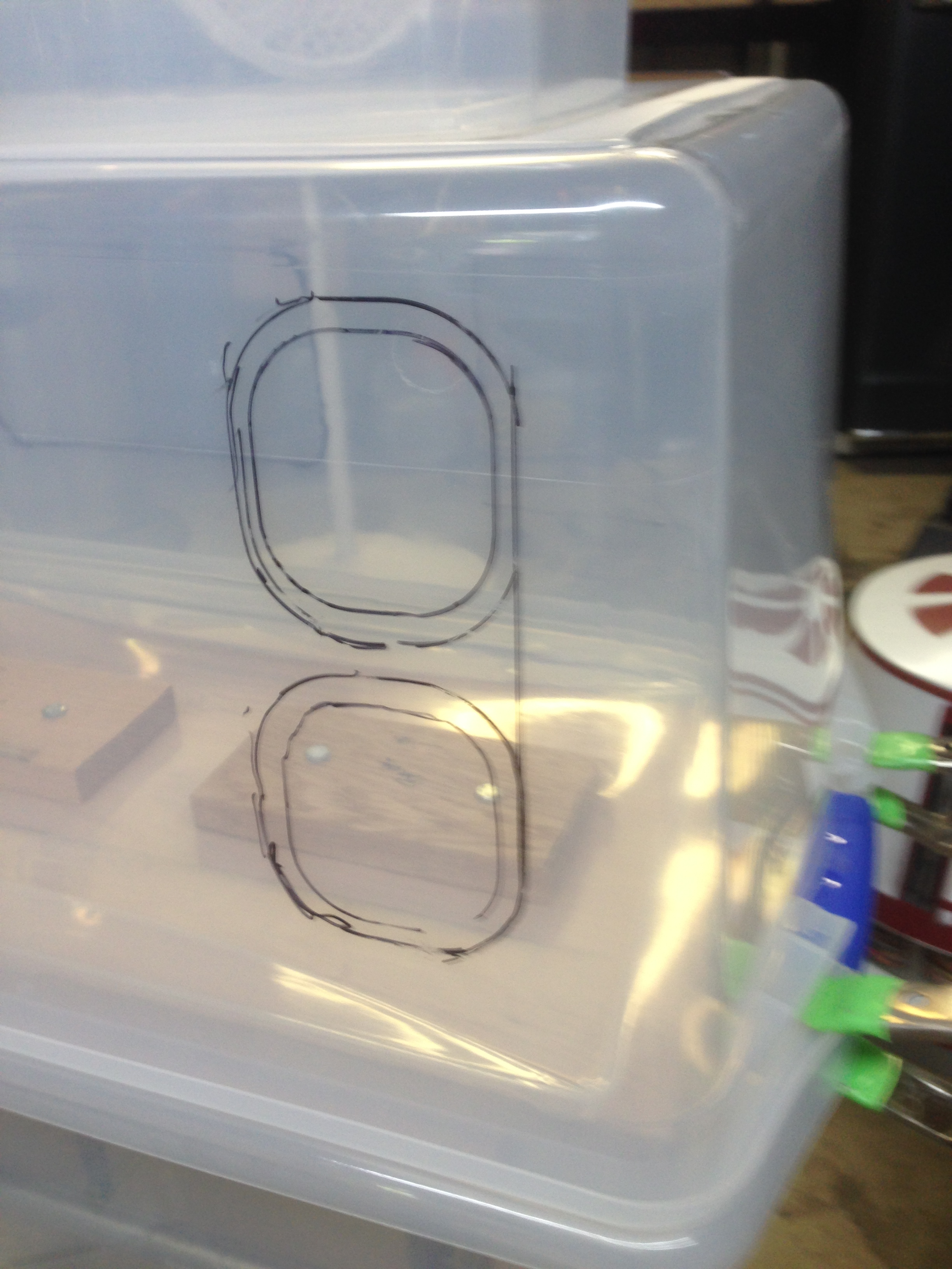

Next, I marked up the upper bin with most of the penetrations into it. Starting with the face.
Followed by all the rest of the openings. I did not do the hose or the opening for the nozzle head. I don't have those parts yet.

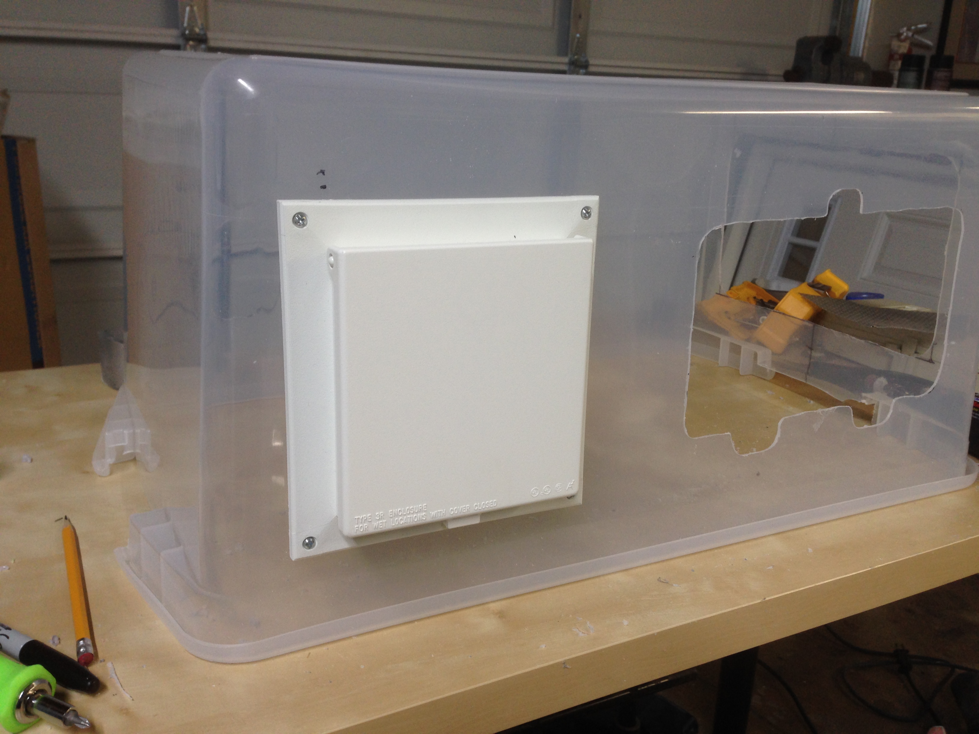

Attached all of the different parts, starting with what will become the external outlets. I will be able to lift this cover and plug in anything requiring 110 volts AC.

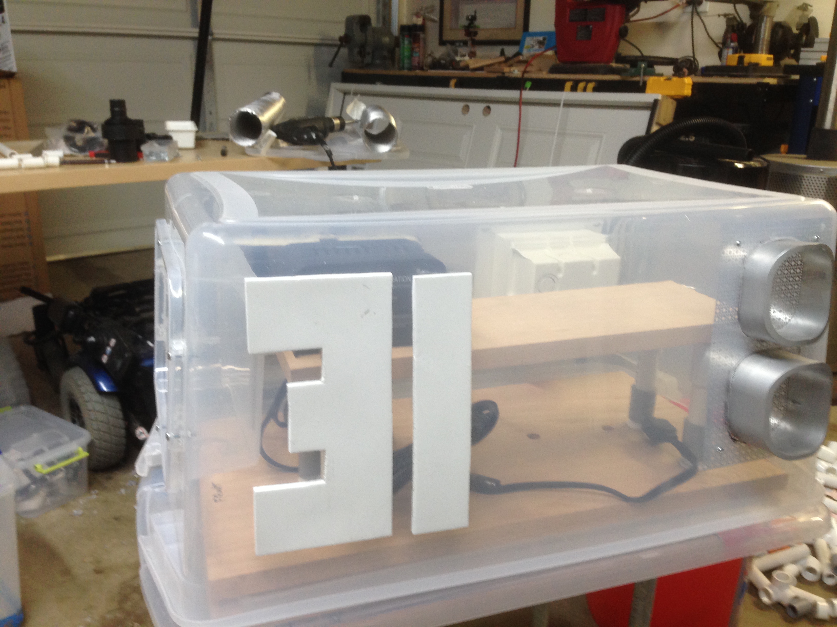

I cut out the backwards E and other shapes, but didn't take pictures. However, I did take a shot of it being glued on. At the same time I glued on the panel that will lead into the main body.
Here is how the droid is shaping up.

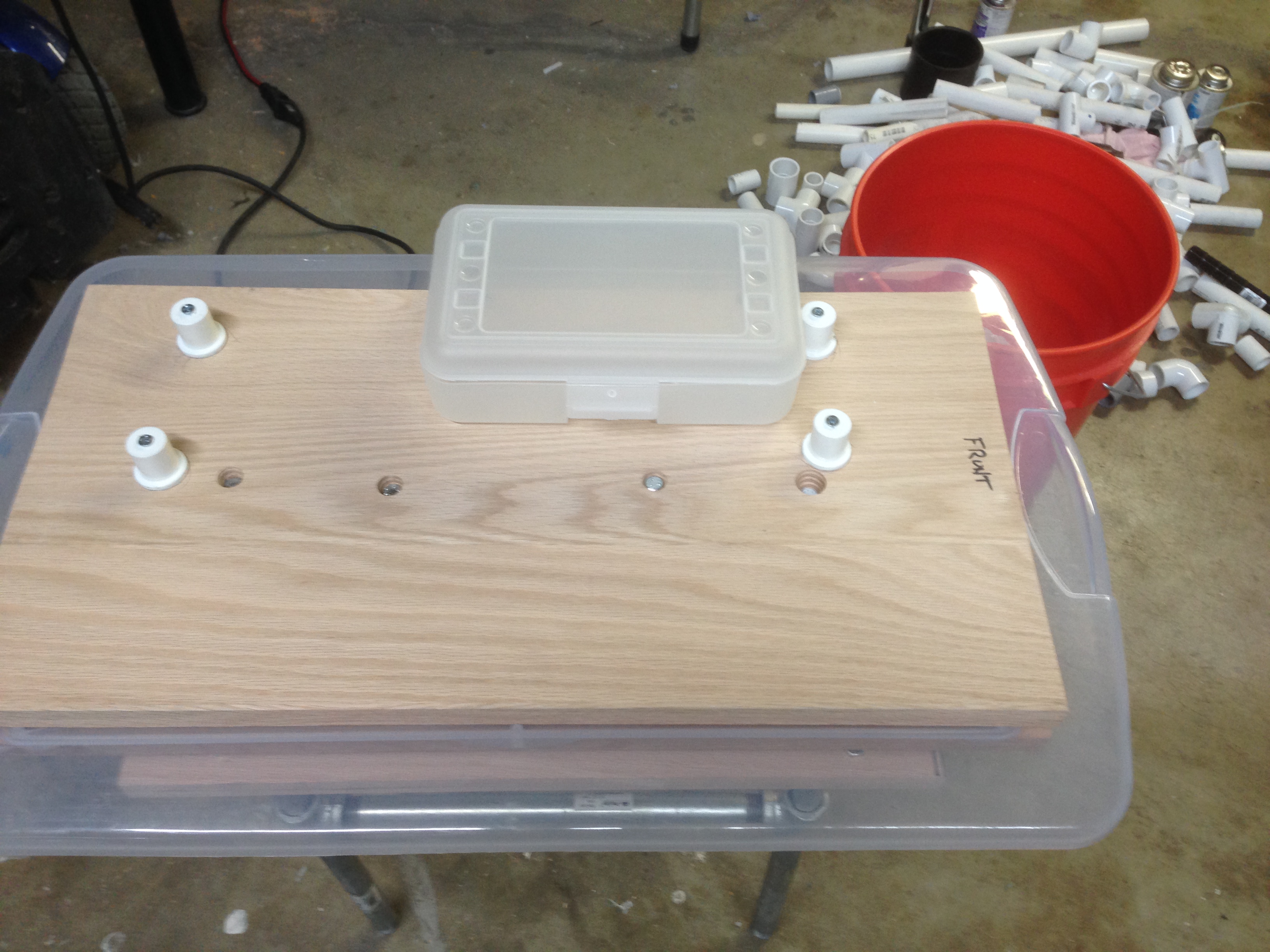

Doing a little work on the inside. I thought I would make it even heavier and use more wood. The first step was replace the two top pieces I used to secure the lid. Instead I am using a single large piece to create a flat surface inside the droid.

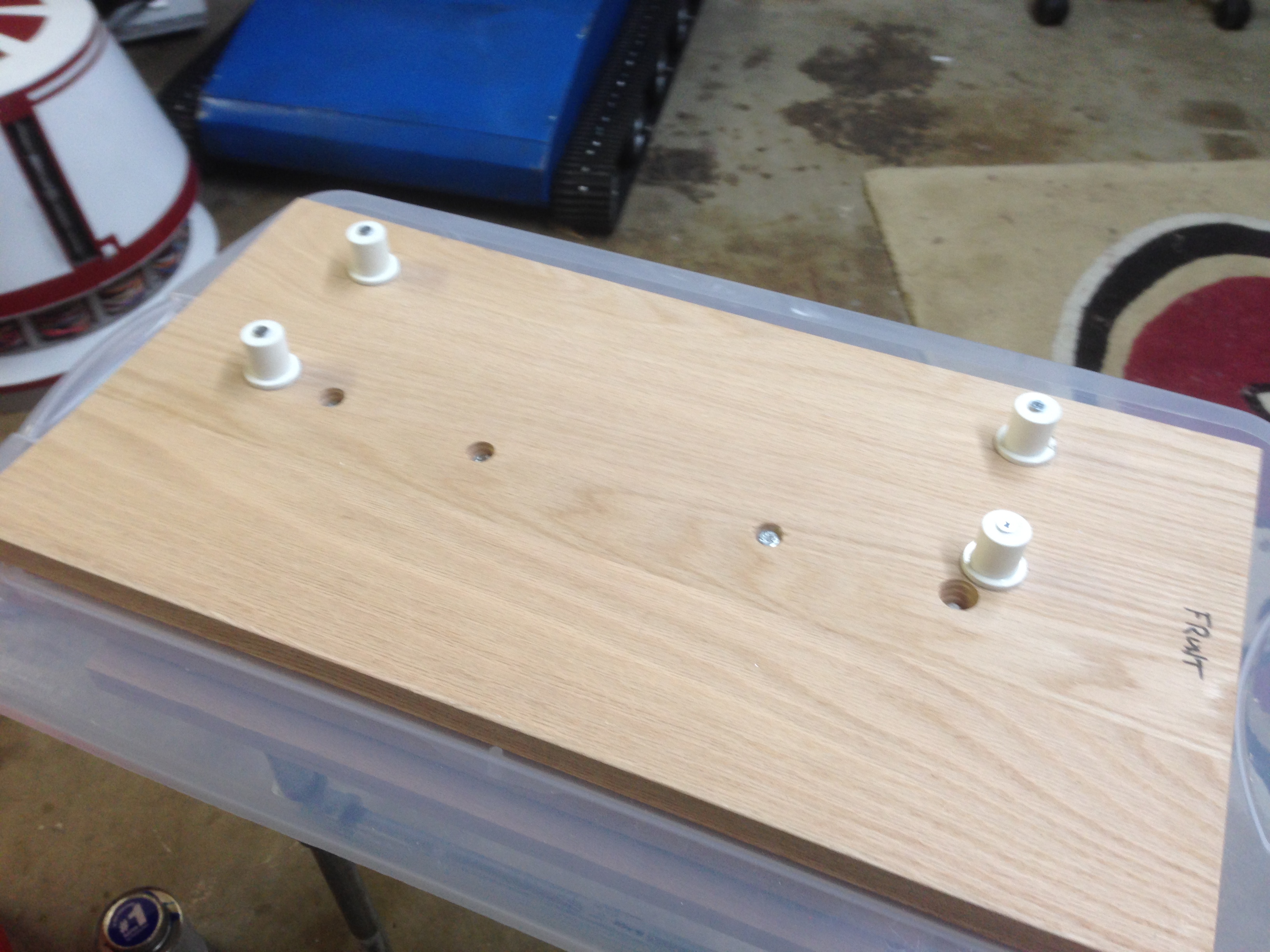

Next, I created a shelf with a 6-inch wide piece of wood. This will serve as the platform for my chargers. I am using half inch PVC plugs to secure PVC pipe.
I simply drilled out the plug for a screw and attached it to the base and to the shelf.
