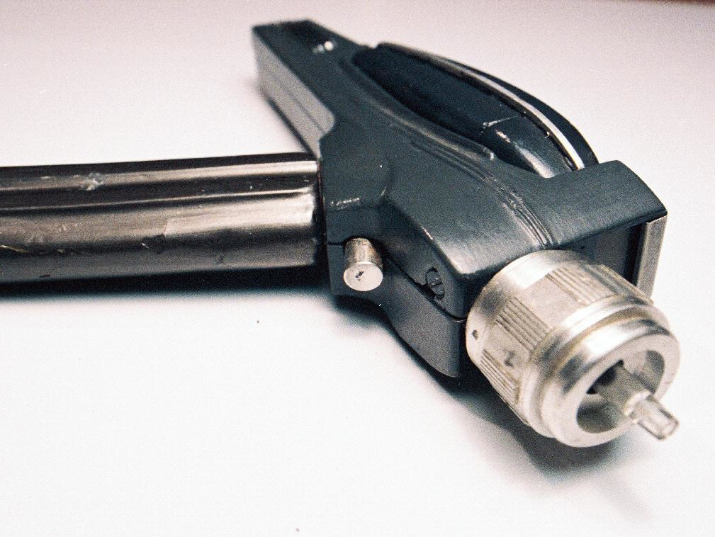

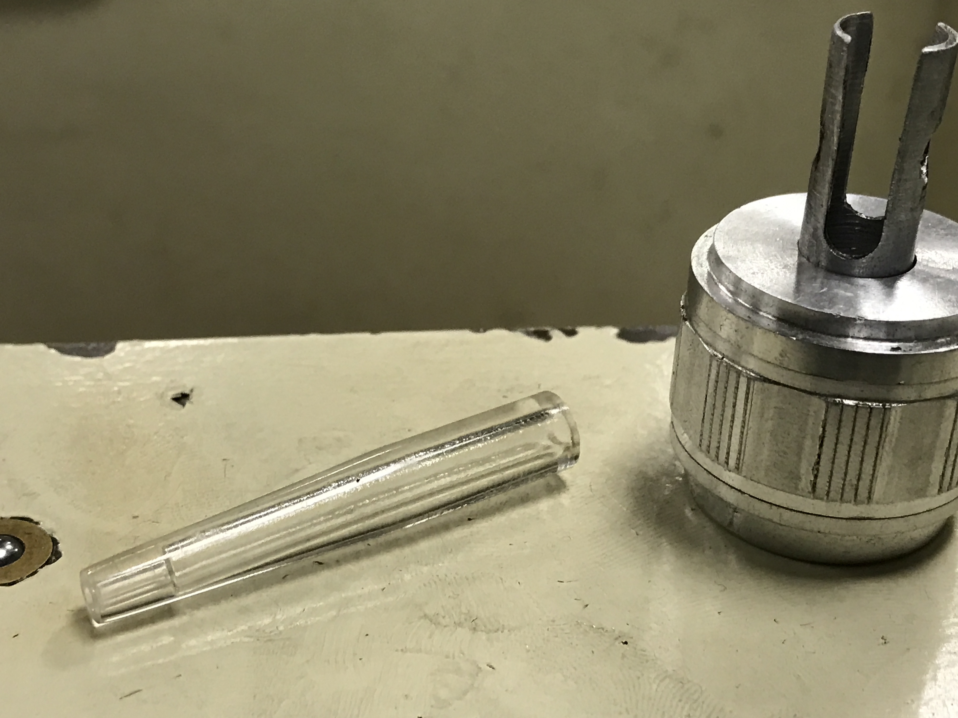

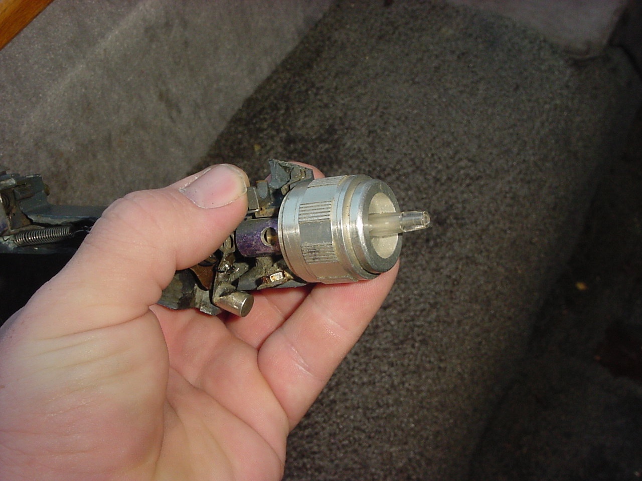

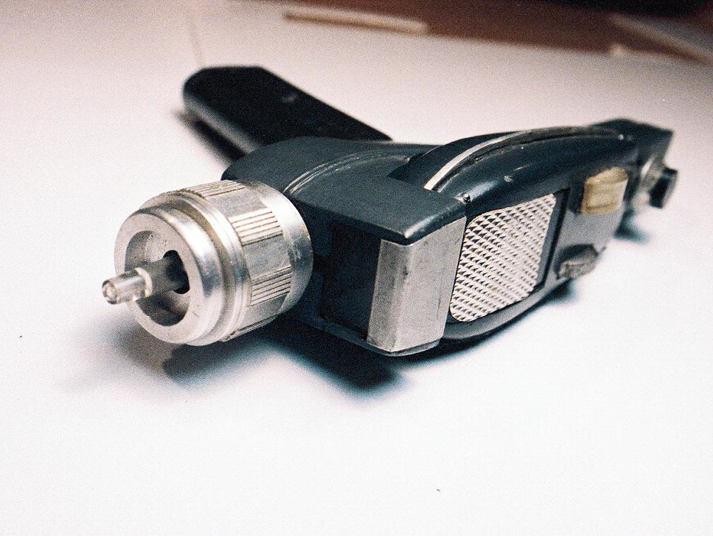

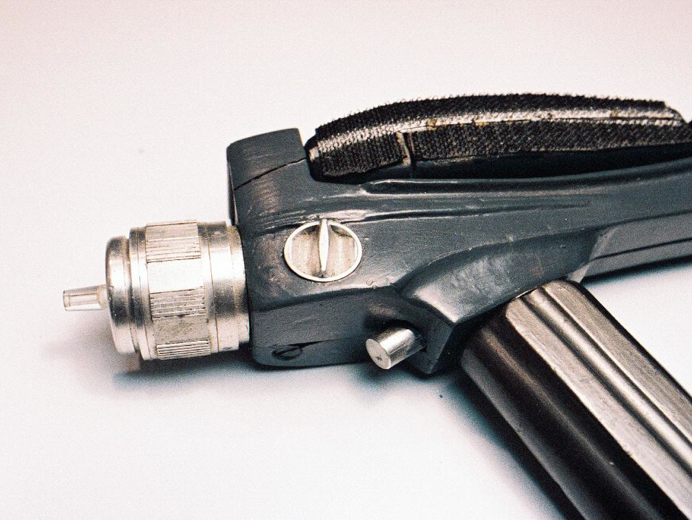

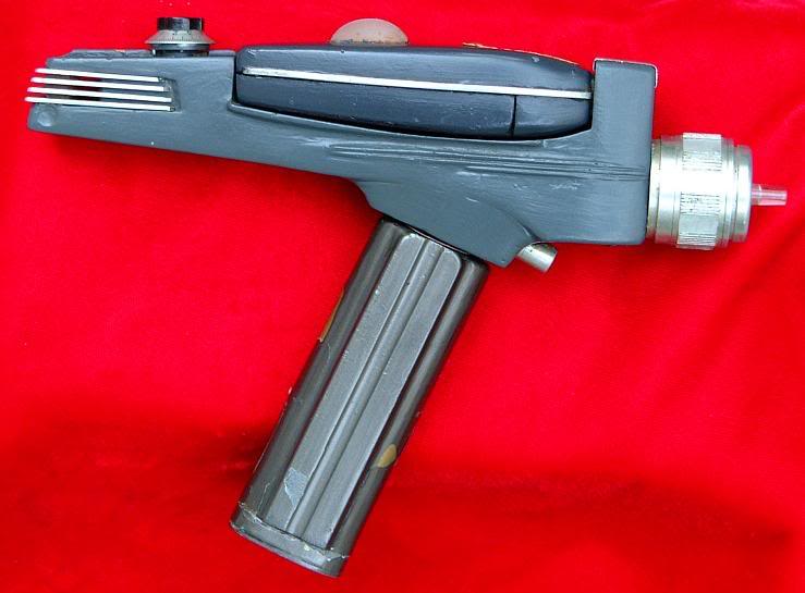

So let's go back to the look I'm trying to match. I just want to be clear about what I'm after, and maybe some of you might see it differently. I admit my eyes are pretty crossed at this point, so opinions are definitely welcome. So here's what I have on hand showing the tip on the GJ original:

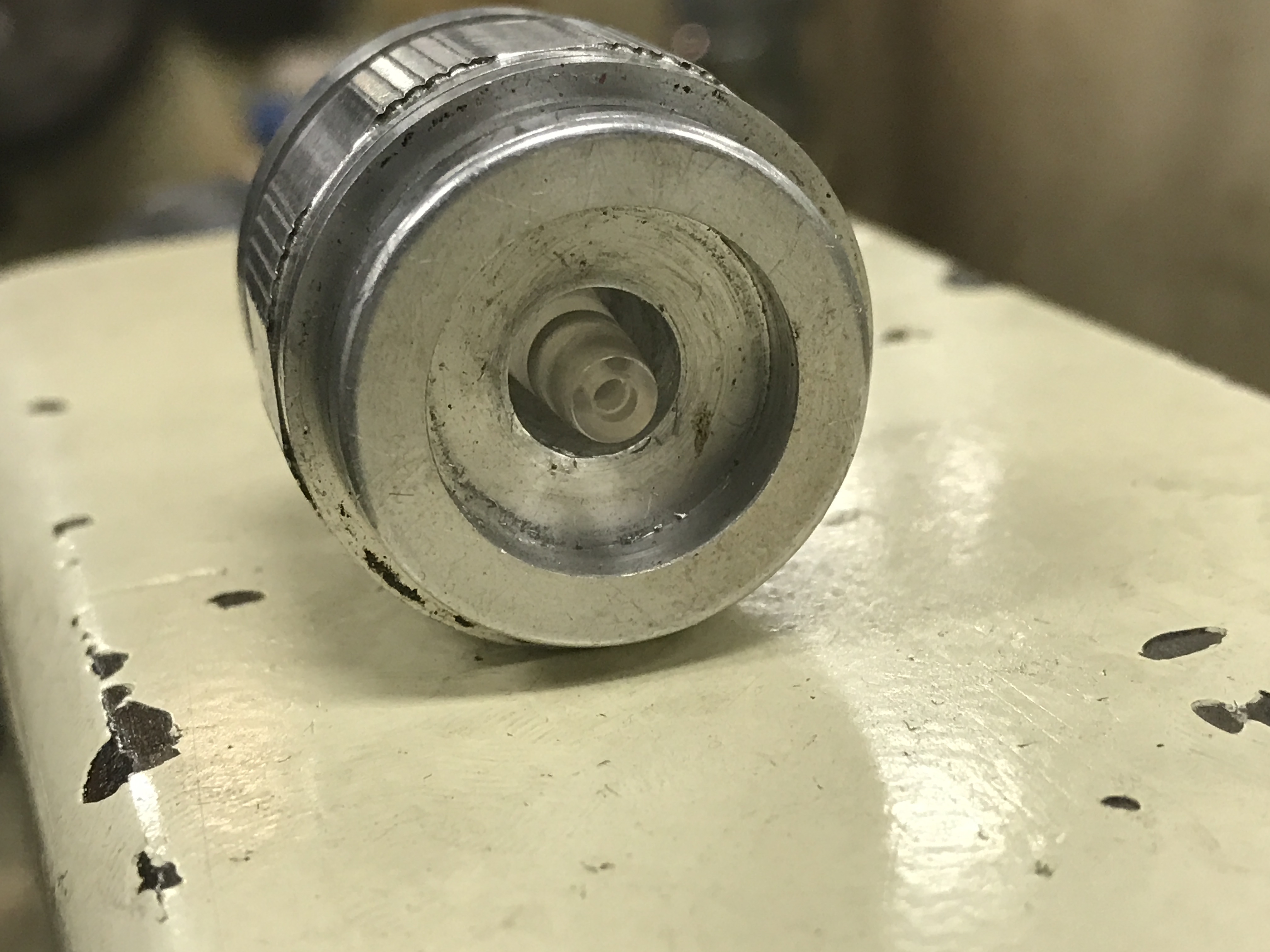

Far as I can see (and that's not as far as it used to be), that back hole is so wide it it appears to go right out to the edge. At 1/8" and a 3 1/2º taper, I'm still not quite there. But there's more than one way to skin a cat.

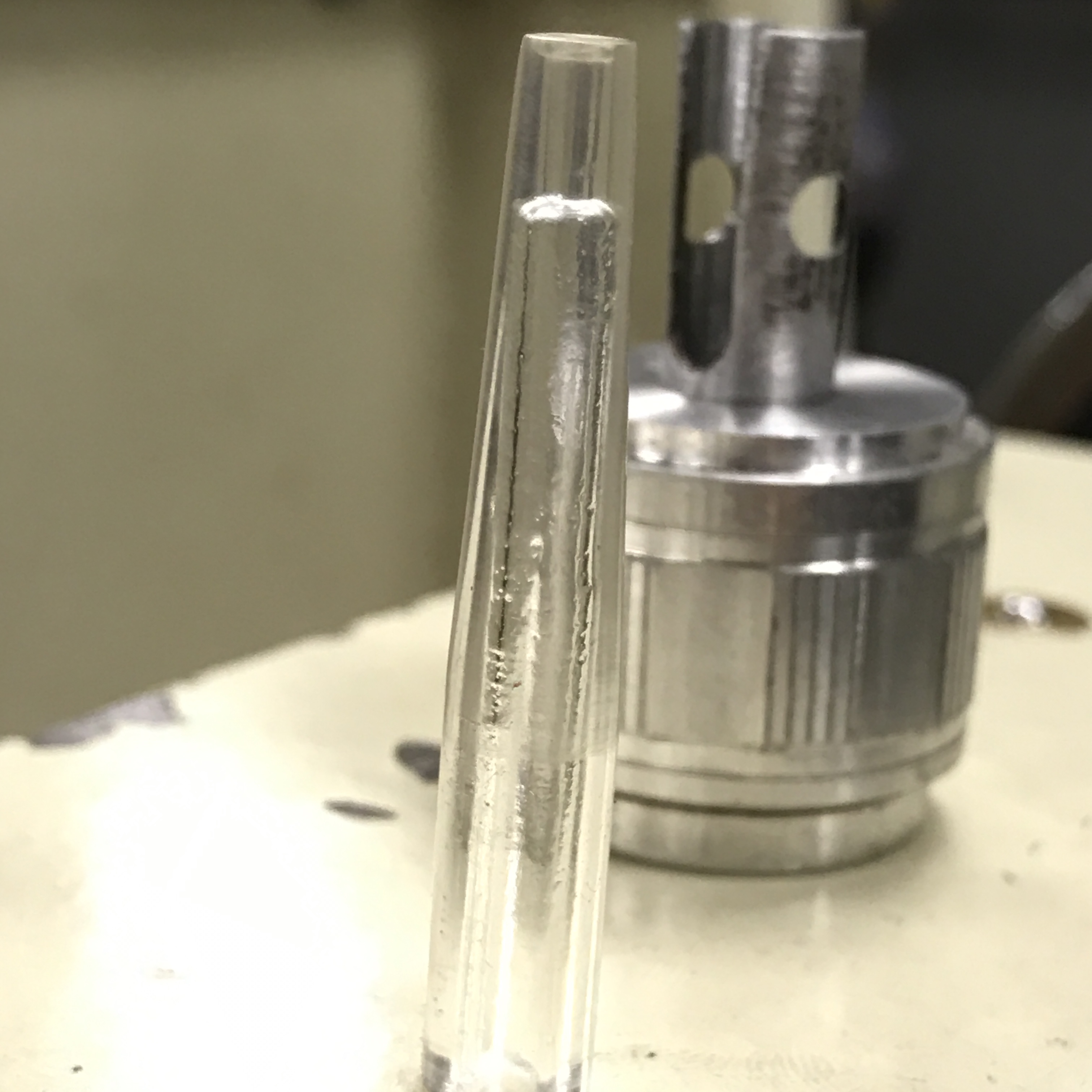

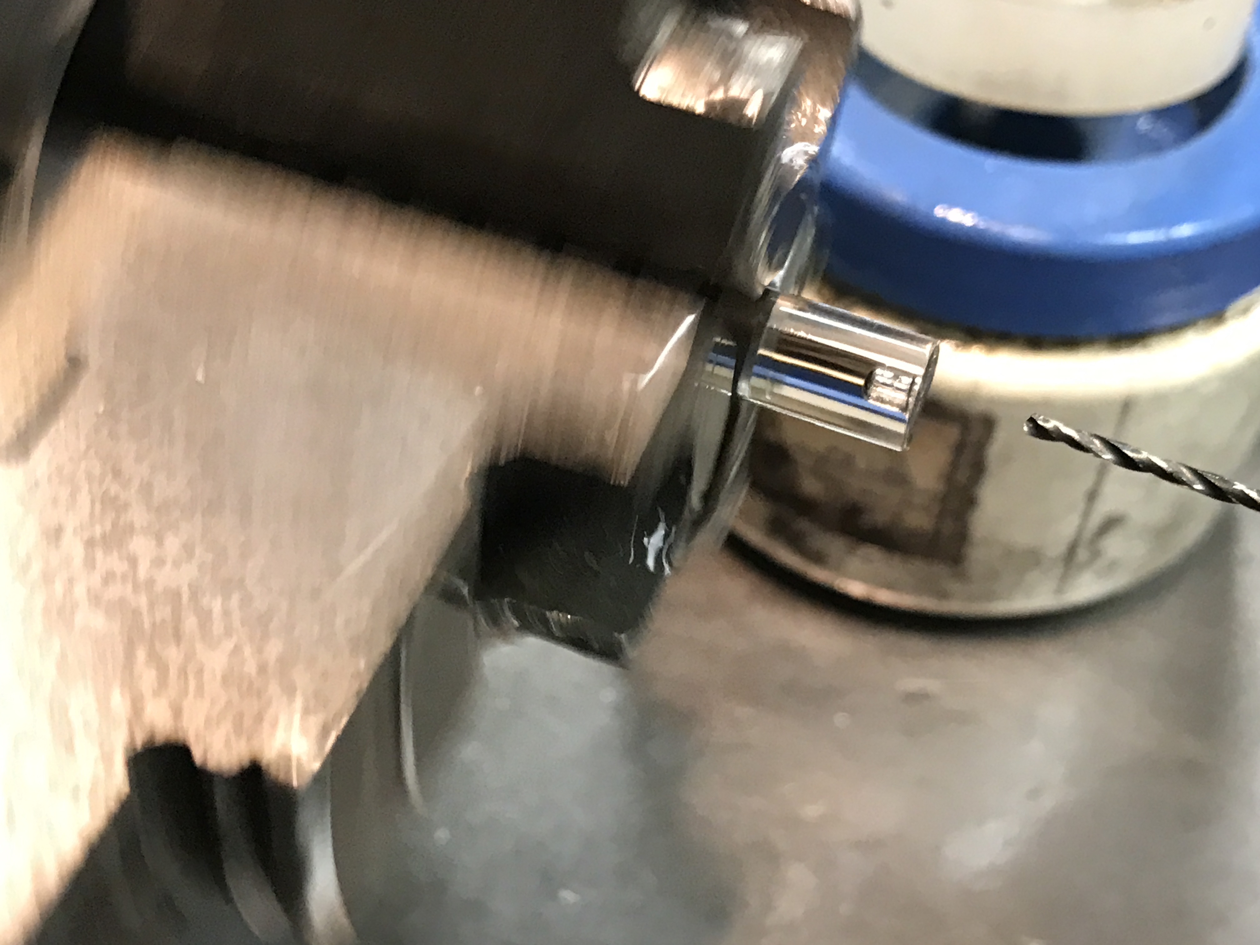

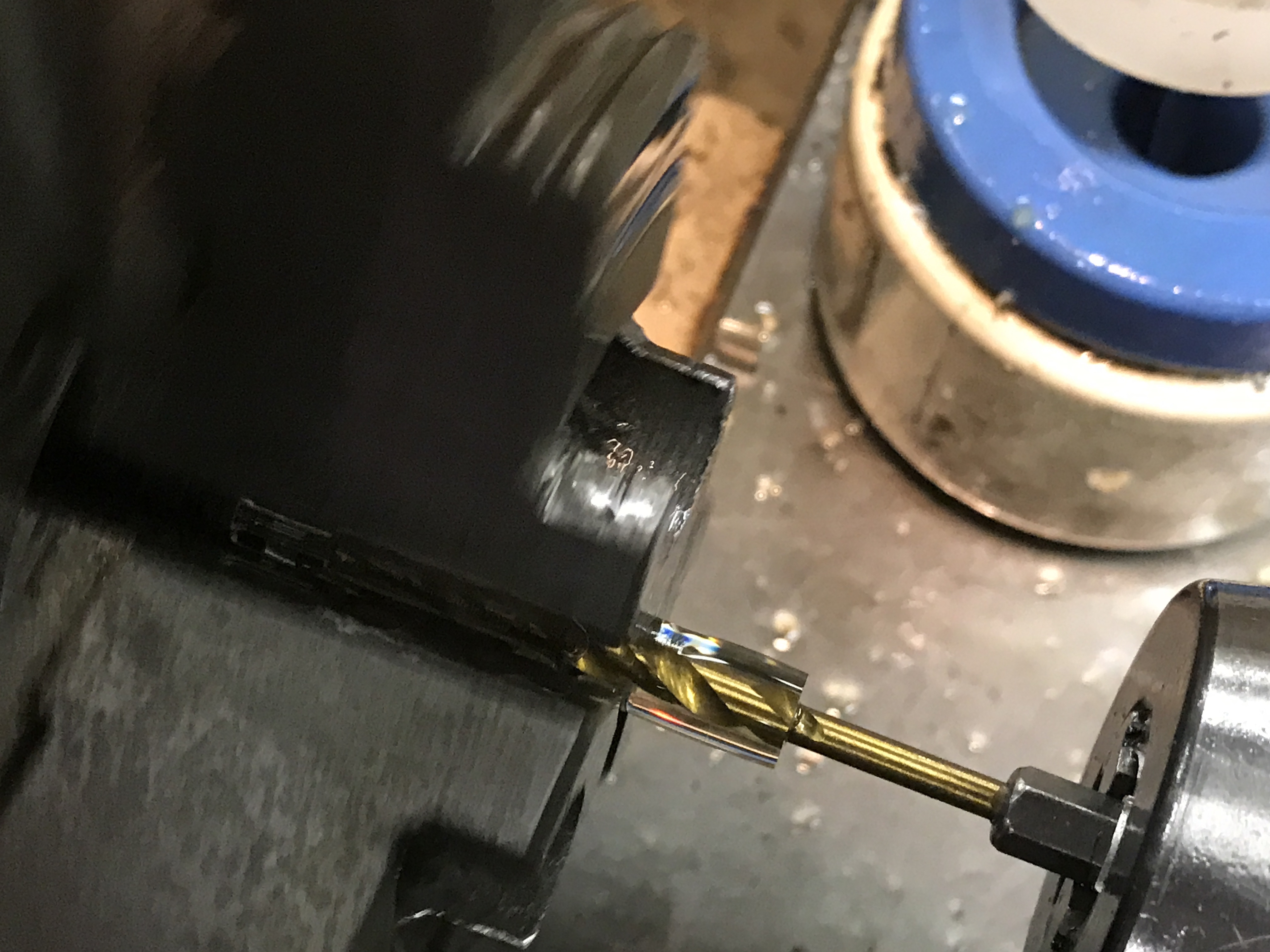

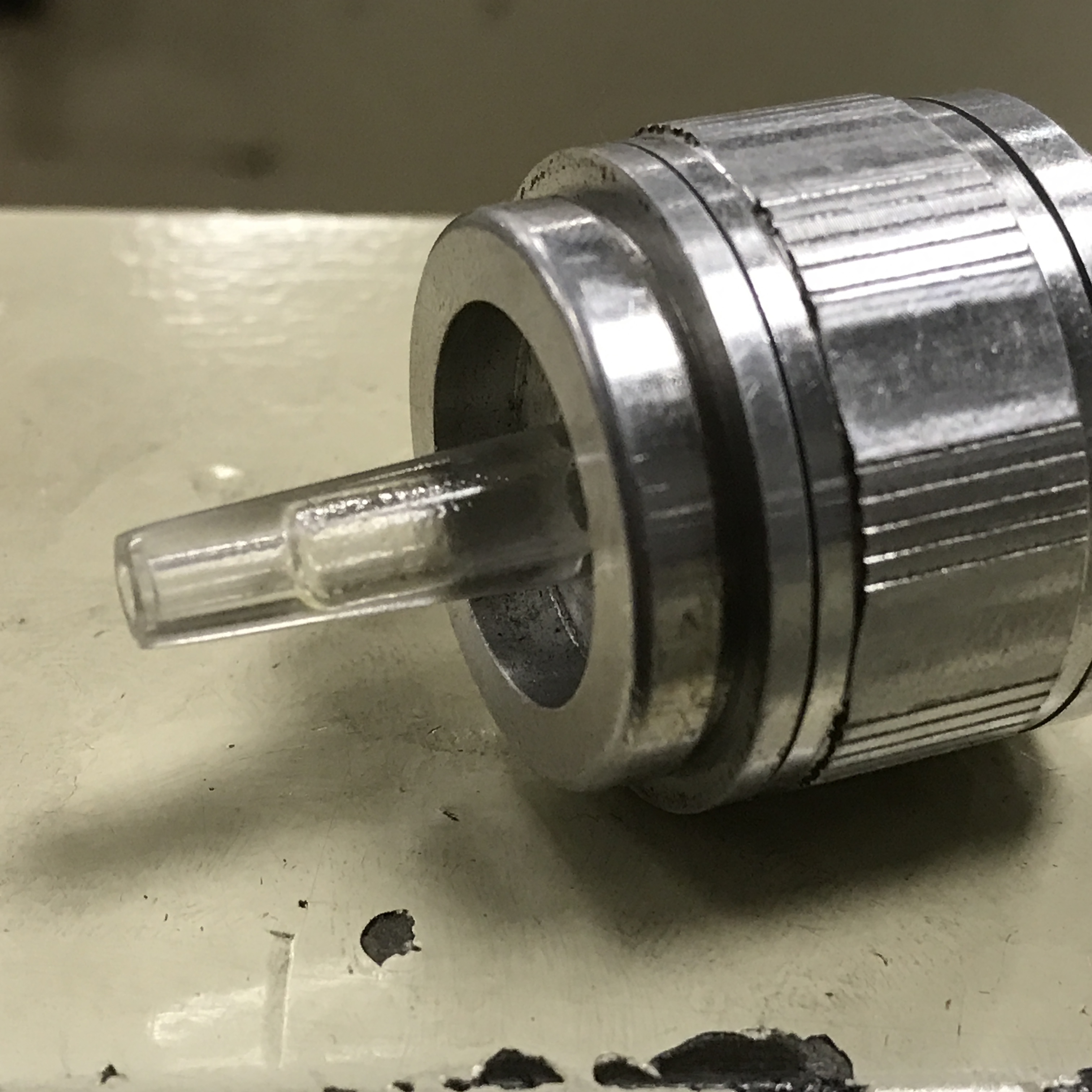

So I figured out a way to come up to it incrementally, rather than try some calculation and then screw it up, as entertaining as that might be. :p

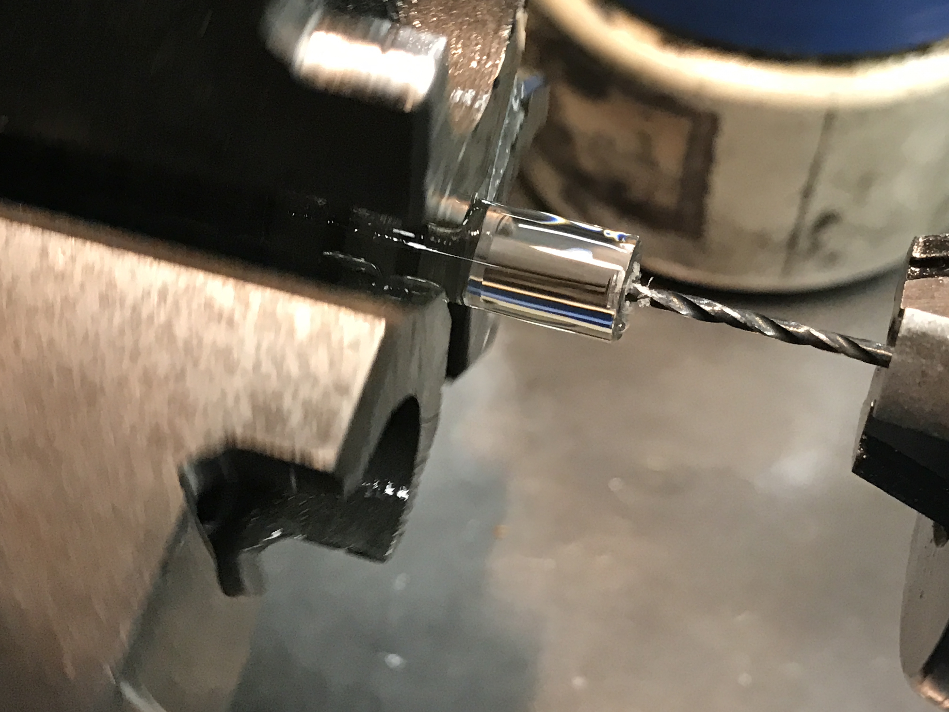

I started drilling first, this time on the lathe again. The bits are still wobbling, literally from the moment they touch the acrylic. Still haven't figured out why, but at this point it's too small a variation to worry about with the naked eye. It's only when I start getting geeky with the magnifigation that I start getting all flustered.
Too close?
:p
Somehow, I don't think Jimmy Rugg had a 12MP phone camera in mind when he made those things.
Anyhoo, I decided to drill the holes first, beginning with a 2" long piece of stock. I did the 1/16" hole on one side, and flipped the piece in the chuck to drill the back hole out to 1/8".

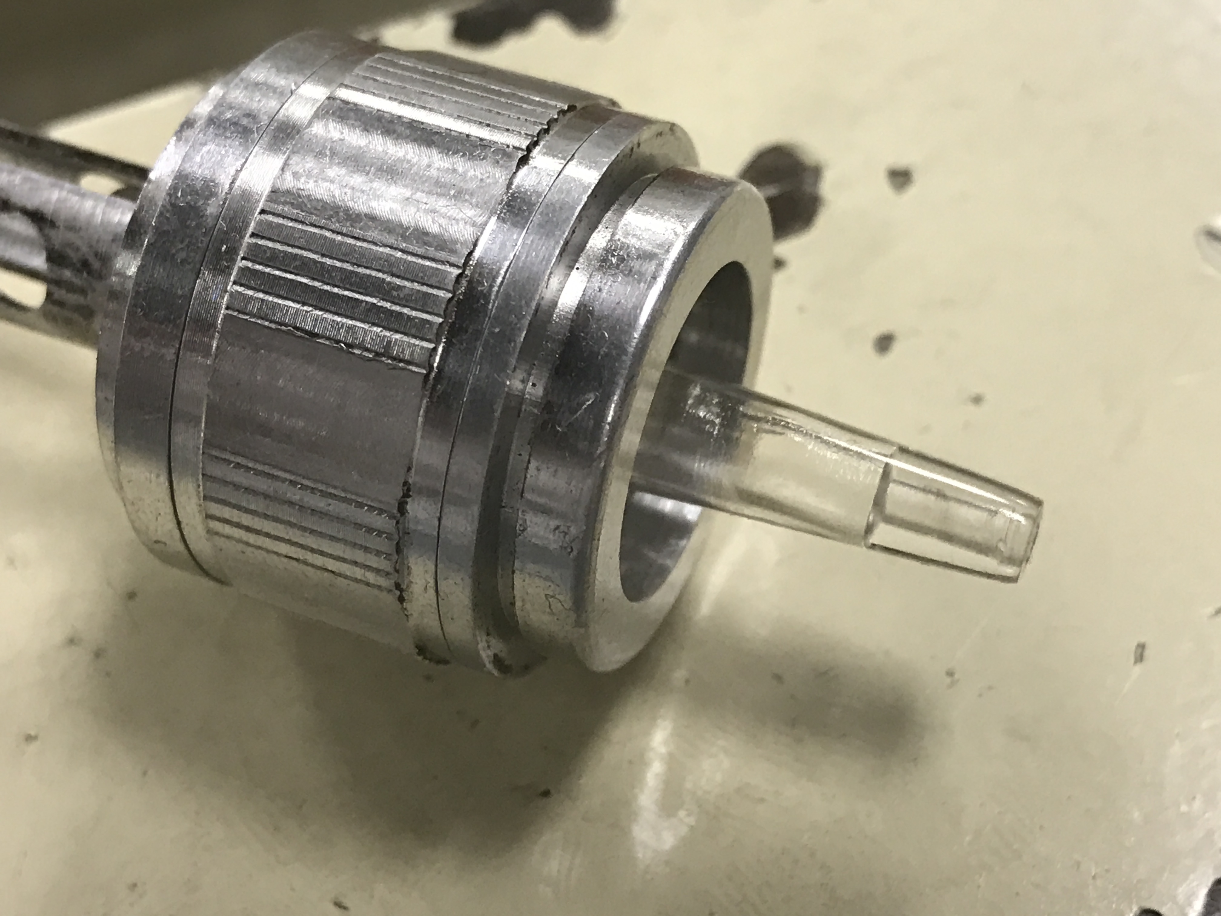

Then I turned the taper at 3 1/2º (or thereabouts -- it's not exactly an aerospace-accurate part of the lathe). Since the interior hole was already there, I could check my progress visually. This became important toward the end, since I could flip the piece around to drill the back hole a little deeper as the taper got closer to where it needed to be. So at the end, I would taper off a few thousandths of an inch, then flip the piece in the chuck, drill the hole a couple thou deeper, flip it again and do another taper pass, and so forth. This allowed me to get much closer than I ever have without screwing up the piece.
At the very end, I left myself just a smidge of excess to allow for sanding, and still I'm not quite there. Also, the last thing I did was to just tap the drill bit into the tip with the 3/32" bit to create the divot.

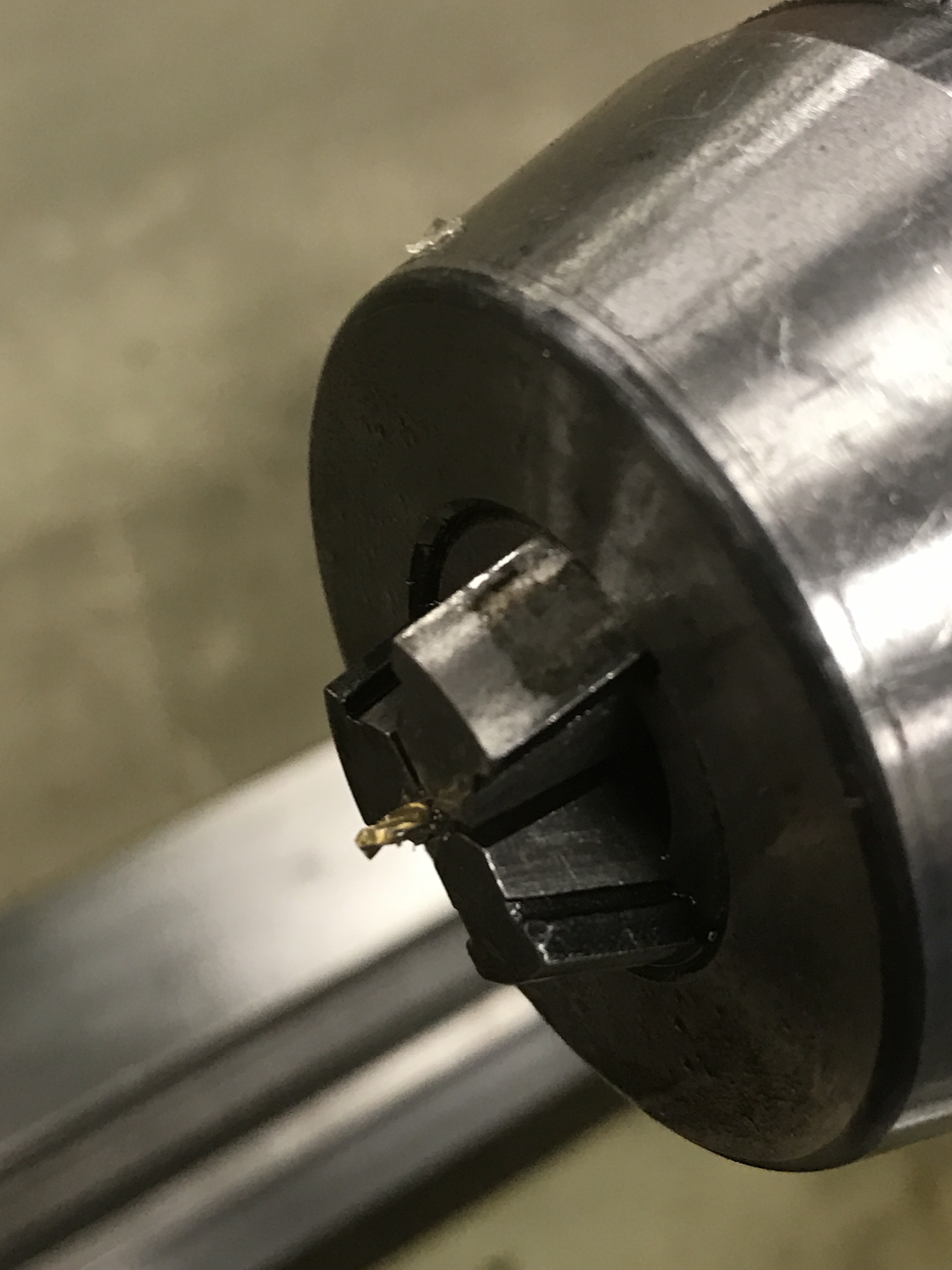

I have one suggestion that might help stabilize the wobbly bit. Try choking up on the bit in the chuck as much as you can to start the hole. Then incrementally extend the bit out of the chuck for more depth. With it hanging out as much as it is in your picture, I can imagine it's all over the place.
That was exactly my plan going in! Unfortunately, the chuck has a shallow throat, and what you see in the photos is as chucked in as I could get it. I was hoping to have the bit just sticking out less than 1/8", which I was sure would take care of it. Totally forgot to mention that in my post.
I've gotta either find a shorter bit, or cut one down.

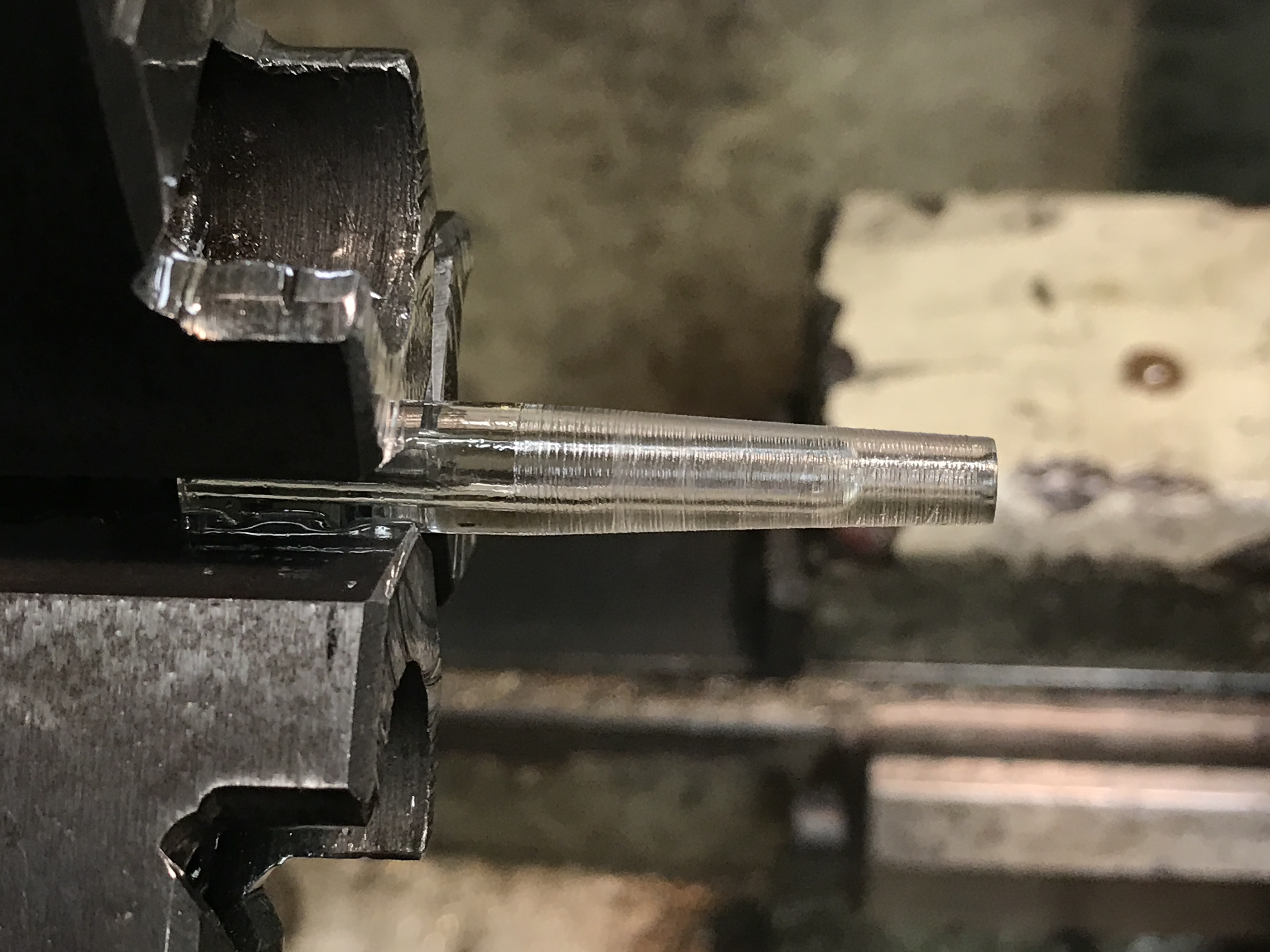

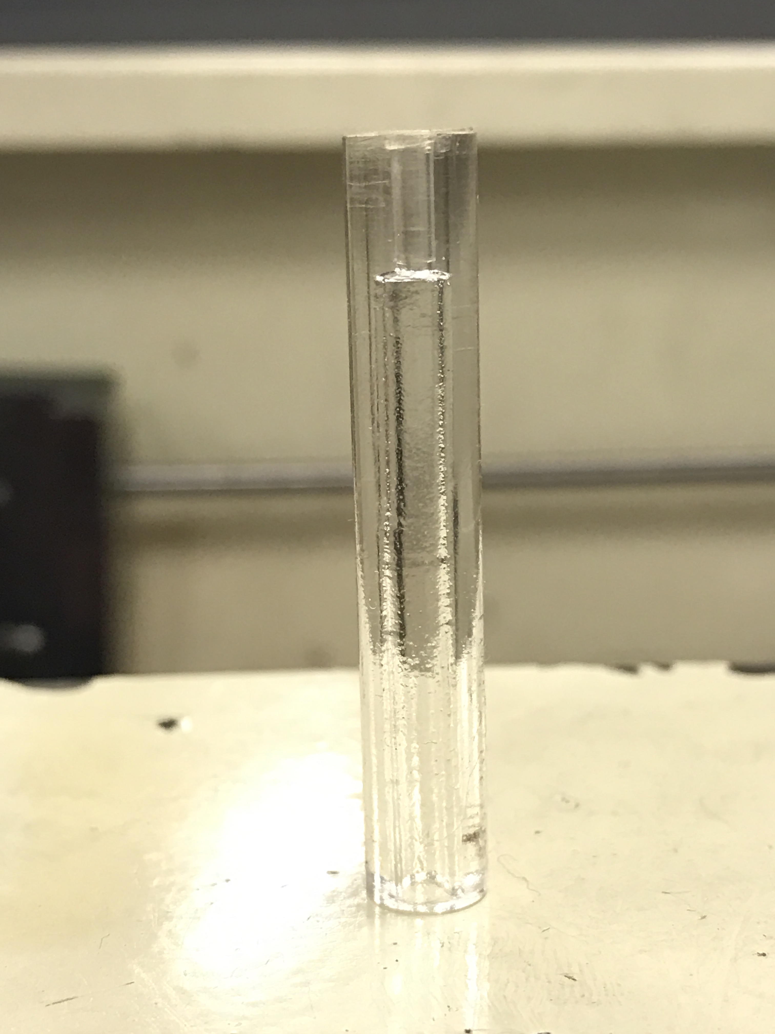

Well, it's been a very interesting evening. On the one hand, I've got my recipe for the hero emitter down.
On the other hand, this thing isn't gonna work in acrylic. So after my little work break, I'm switching to polycarbonate (Lexan).

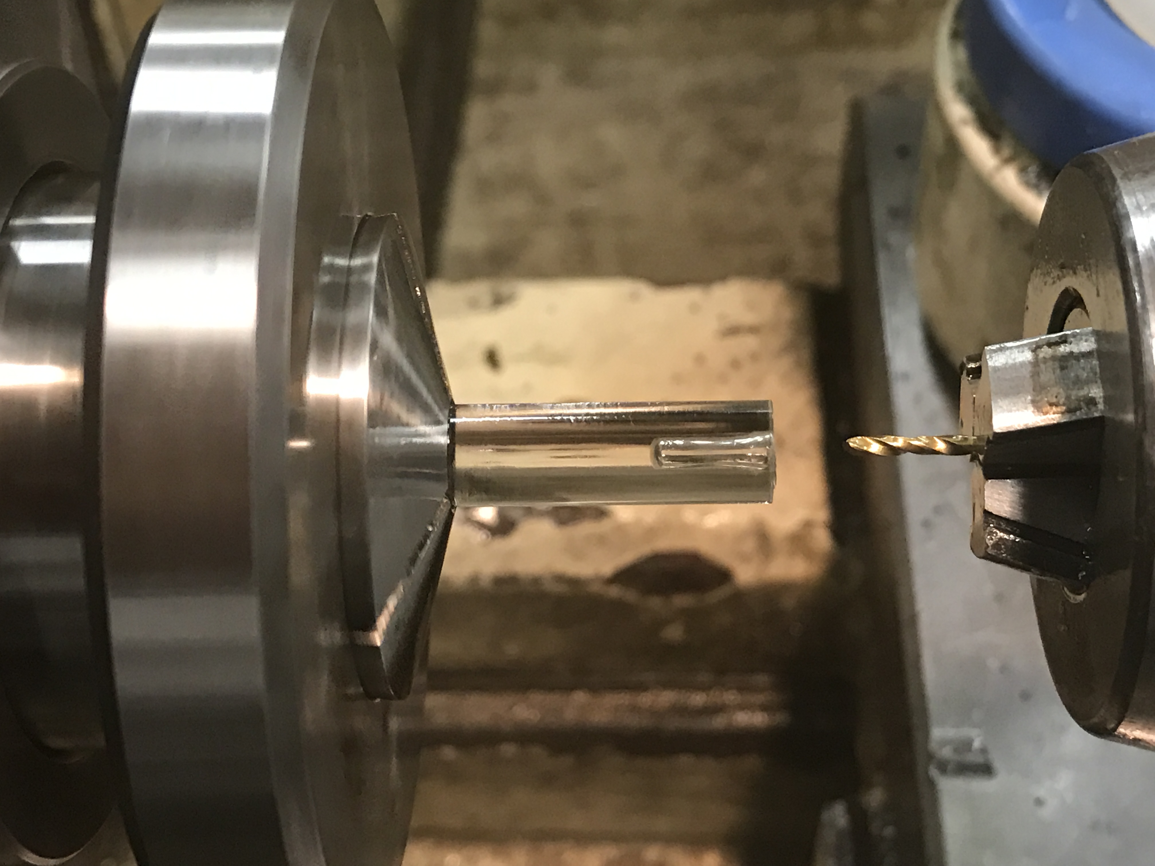

So here's how things shaped up tonight:
I started by cutting down one of my 1/16" bits with an angle grinder (the bandsaw was in full butterknife mode). Then I chucked it WAY back, and commenced to drillin'. I pulled the bit out a couple of millimeters after every plunge, went really slow, and dumped OPEC's entire supply of oil on it as I went. Got a pretty good result. Yay!!
Sadly, this result was not to be repeated.

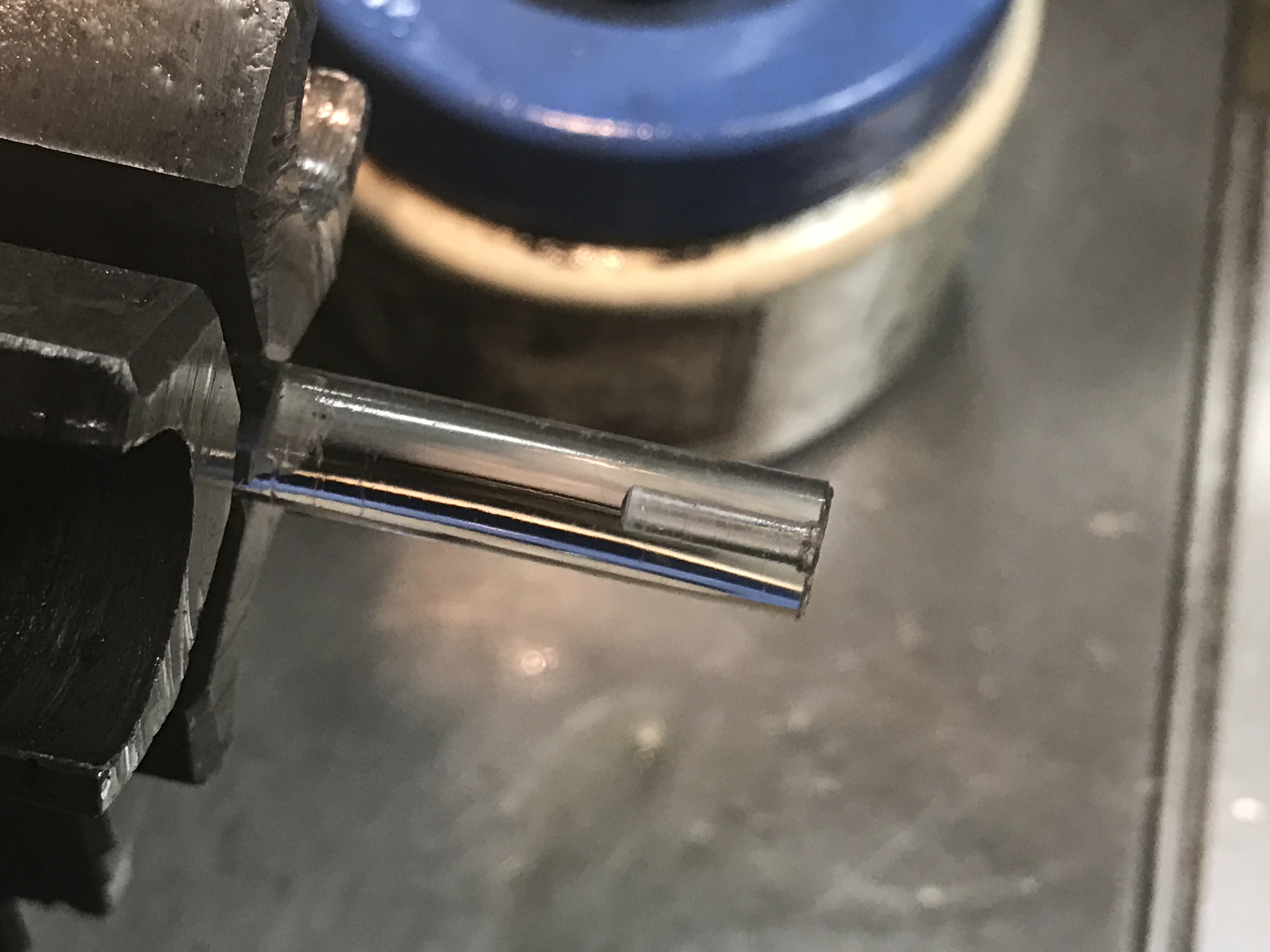

Yup. That ain't just a little wobble. That's a frakkin' helix. TF? WT actual F??
But I really wanted to get at least a finished prototype -- helix or no, I needed to get these measurements figured out. Holes, taper, the whole... uh... the whole... uh...
Ball of wax. That was it.
:p

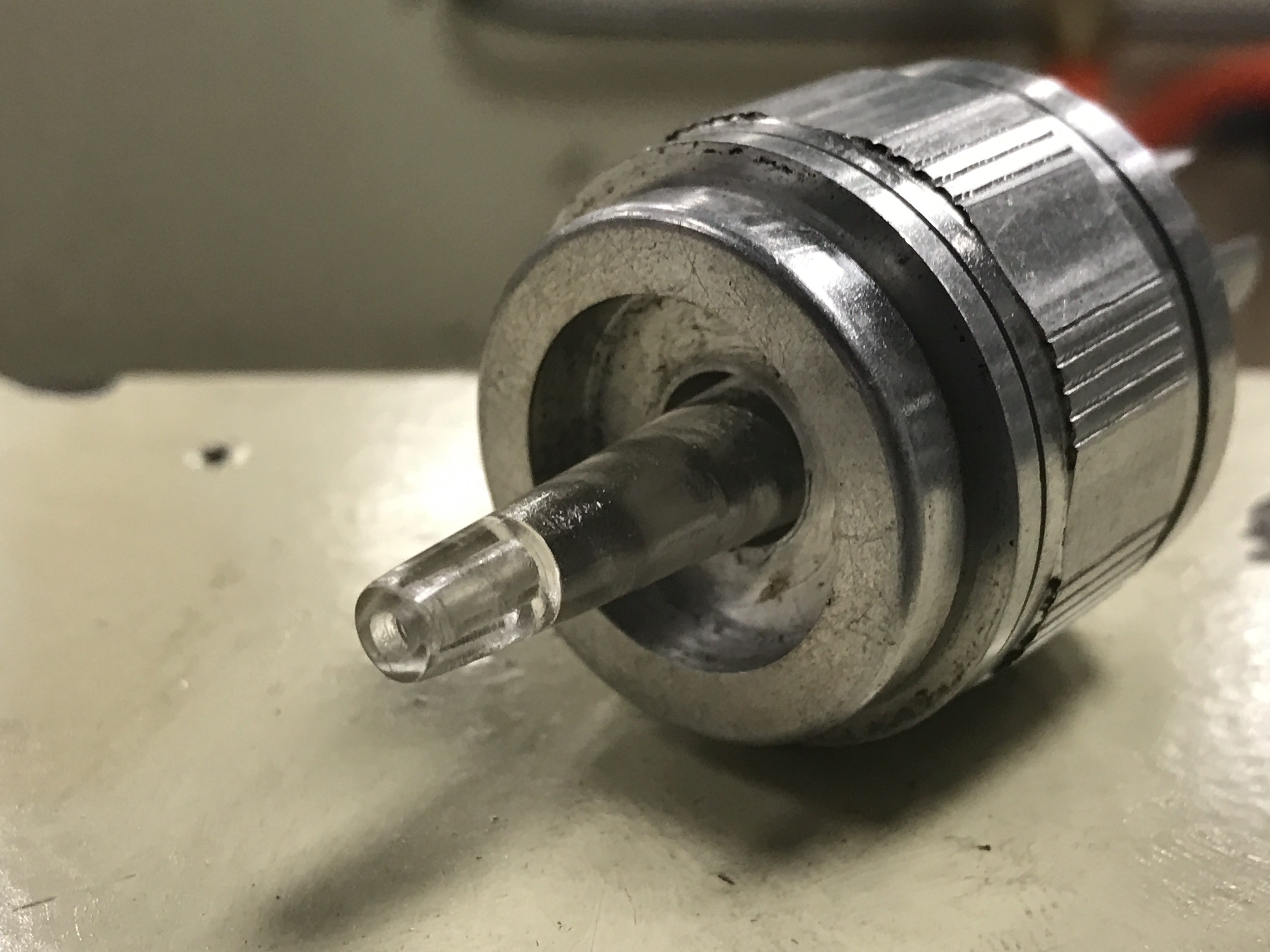

So as you can see, I repeated my drill-taper-drill-taper thing, except this time I only had to do it once. This definitely looks right to my eye (except for the whole wobble thing), so my finished pieces will use these measurements.
So without further Apu...
Cuz he's off to vote early for Trump...
:p
Here's the final taper specs I'm gonna go with (until I get better measurements of the original):
Taper: 4º
Taper length: 1" (ish)
Front hole: 1/16"
Back hole: 9/64"
Tip divot: 5/64"
Tip diameter: 0.2" (ish)
Shaft diameter: 5/16"
Trust me, baby, it's 5/16" of pure awesome.
:p
The final length and rear profile are still TBD. I have to basically make that up out of whole cloth, since nobody's ever X-rayed the inside of the nozzle (that I'm aware of). So I'm going to play with the prototype emitter and the 3D-printed prototype brass piece till I figure it out.

What's all this about doing these in polycarbonate?
It just so happens that tonight I ran into Adam, the nice mechanical engineer from Post #366 on Page 15.
And here I had this amazing, accidental pile of helical art in acrylic. So I thought, hell, why not walk the ten feet or so to the nearest mechanical engineer and ask him, like, WTF, dude?
He took one look and asked first if that was acrylic. I said yes, and his opinion was that it was a thermal problem. In other words, the plastic is overheating and pulling the bit out of whack.
Adam had an interesting solution:
"I avoid acrylic whenever possible."
My whole life has been a lie!!
:p
Lexan, he explained, is WAY better to machine, and doesn't get these problems at all. Also, it's generally much stronger, and way more scratch-resistant than acrylic.
He also told me about vapor polishing, which is apparently really easy with acrylic -- maybe its only advantage over Lexan. You suspend the workpiece in a closed container over a small amount of acetone. The vapors liquefy the outer layer of the acrylic, causing it to re-flow. When it re-solidifies, you've got a smooth, clear finish again. Great way to take out machining marks (yup, that would've saved me a ton of work a year ago).
But after our talk, it was clear the vapor polishing wasn't going to smooth out that frakkin' barber pole inside my emitter, so... Lexan it is!!
So that's how this is gonna go. I have my dimensions now, so all I have to do is lay in some 5/16" polycarbonate stock and get back to work. I think this is where I finally see the light at the end of the tunnel with this piece...
